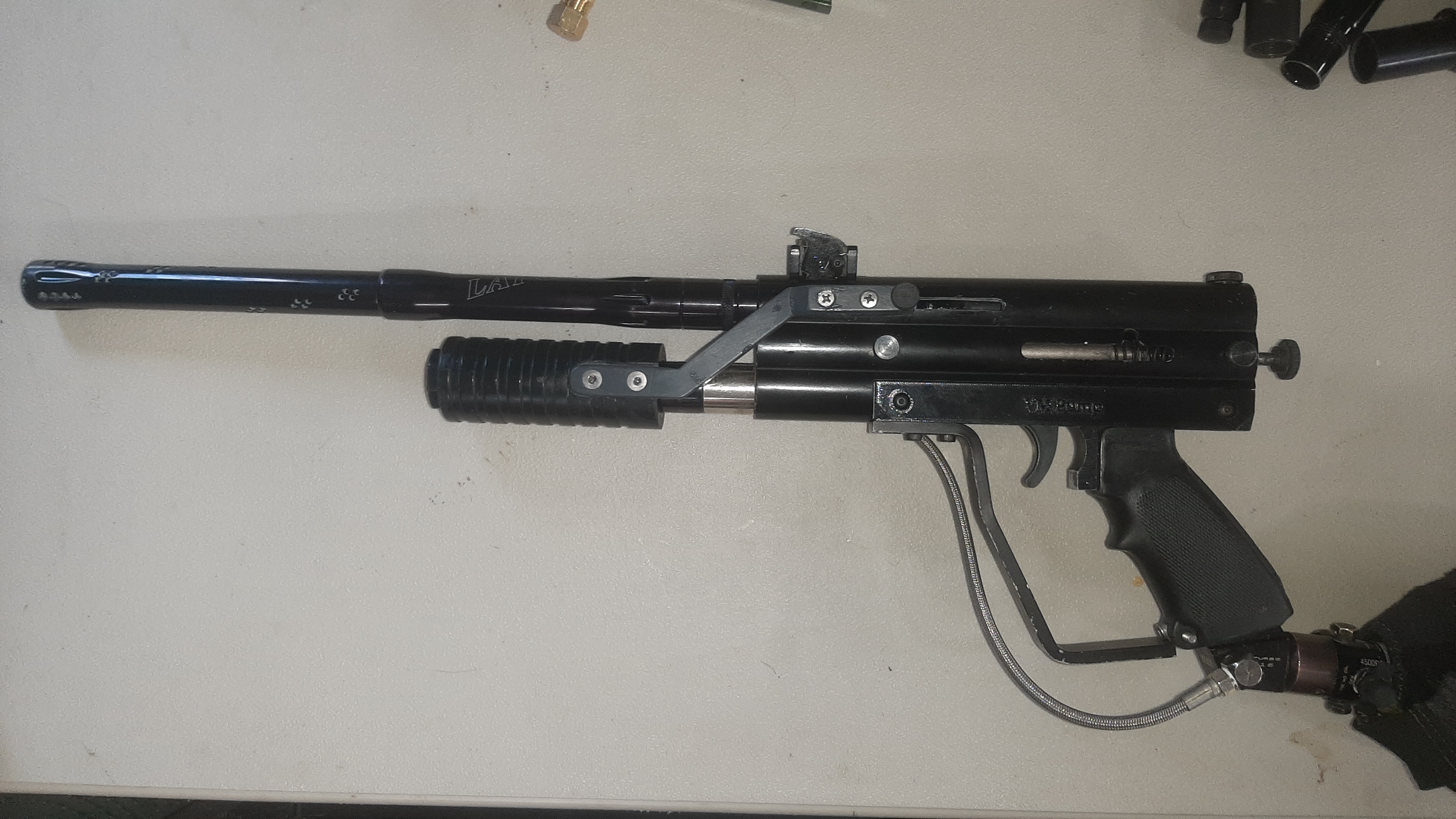

    VM68 Pump, cuz why not.
    rear velocity control, spring return pump.
    possibly they heaviest pump in existence.

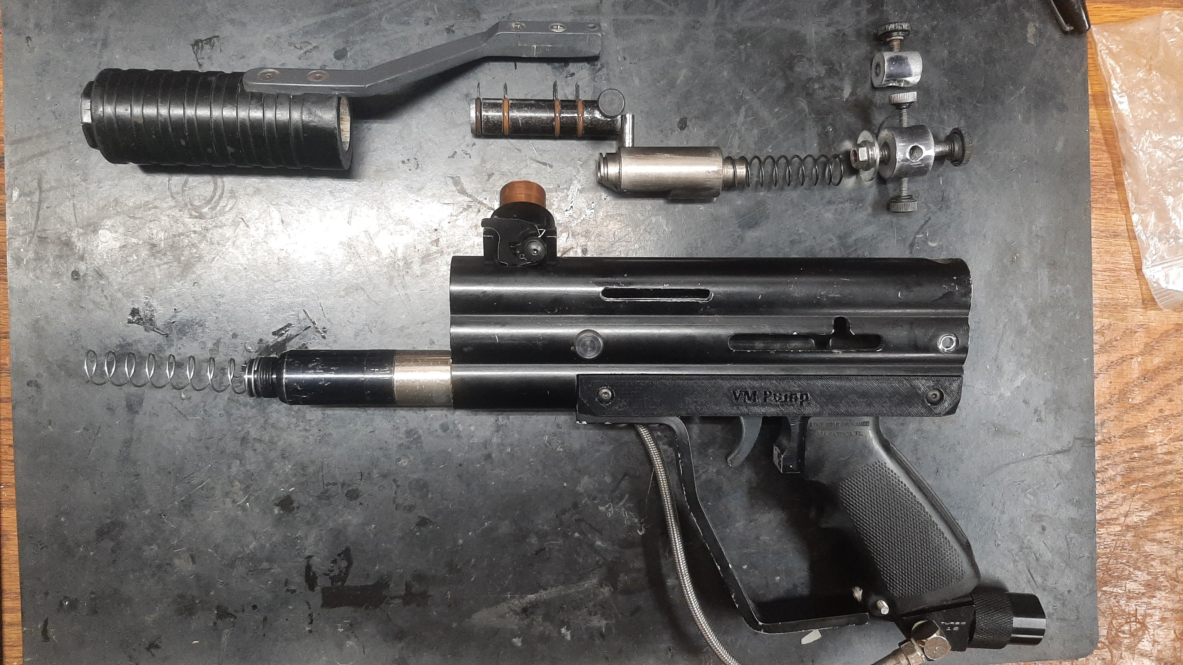

    Added some breakdown photos.
    I have had the desire for a while. I had a body laying around and plenty of parts, so i took a hammer that was missing the back and ground off a bit at the head to reduce blowback. Took a broken connecter pin, and put it in. Removed the rear piece off the bolt and tapped for the pump handle connector. Drilled and filled a slot in the body. Cut the main spring and moved it to the bottom.drilled and tapped a velocity screw.
    The "pump guide" is an old sledgehammer reg that is blocked inside to plug the front asa. I tapped a hole for the hose on the right side and ran it to an old wwp asa.
    pump handle came off a nelpot, some kinda homemade job. Capped the front to hold hold the return spring. I did a homemade detent for doubles, and i use a cocker barrel adapter withe 3d detent for rollouts. My buddy Bryson printed the new trigger panels. Thumb screwa for everything cuz they were there 20260104_155756.jpg 20260104_155514.jpg 20260104_155538.jpg
    Velocity is 280s after cutting the spring a few times.

      Looks good, have you got a chance to use it? How did preform?

                    Update: Played today and it shot great. Didn't break any paint and got a few kills. Super consistent over the chrony with 387 for 5 shots. lol after dialing down my dial a welt, it shot 280s.
                    Just need to tighten up the asa as it moves around way to much.

                      Was witness to the awesomeness of this gun. She was hungry and accurate. So cool.

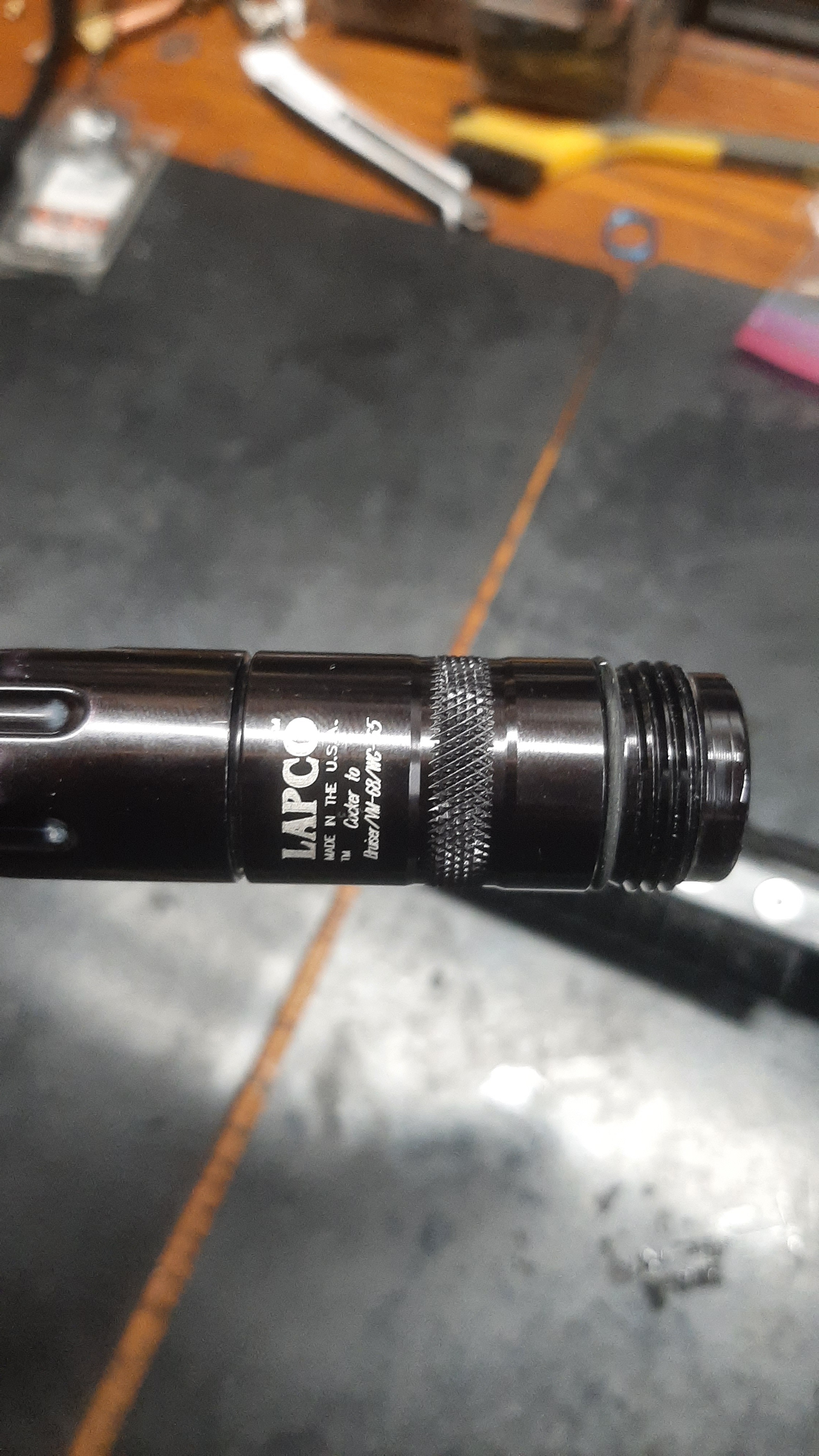

                    That lapco adaptor is a dream lol. Haven't seen one in like a decade.
                    You might want to try an automag spring conversion. Could make it less kicky.
