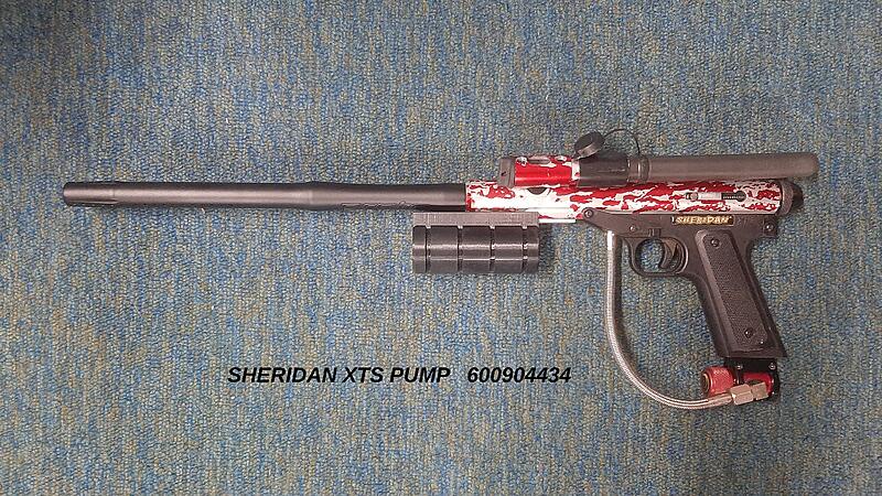

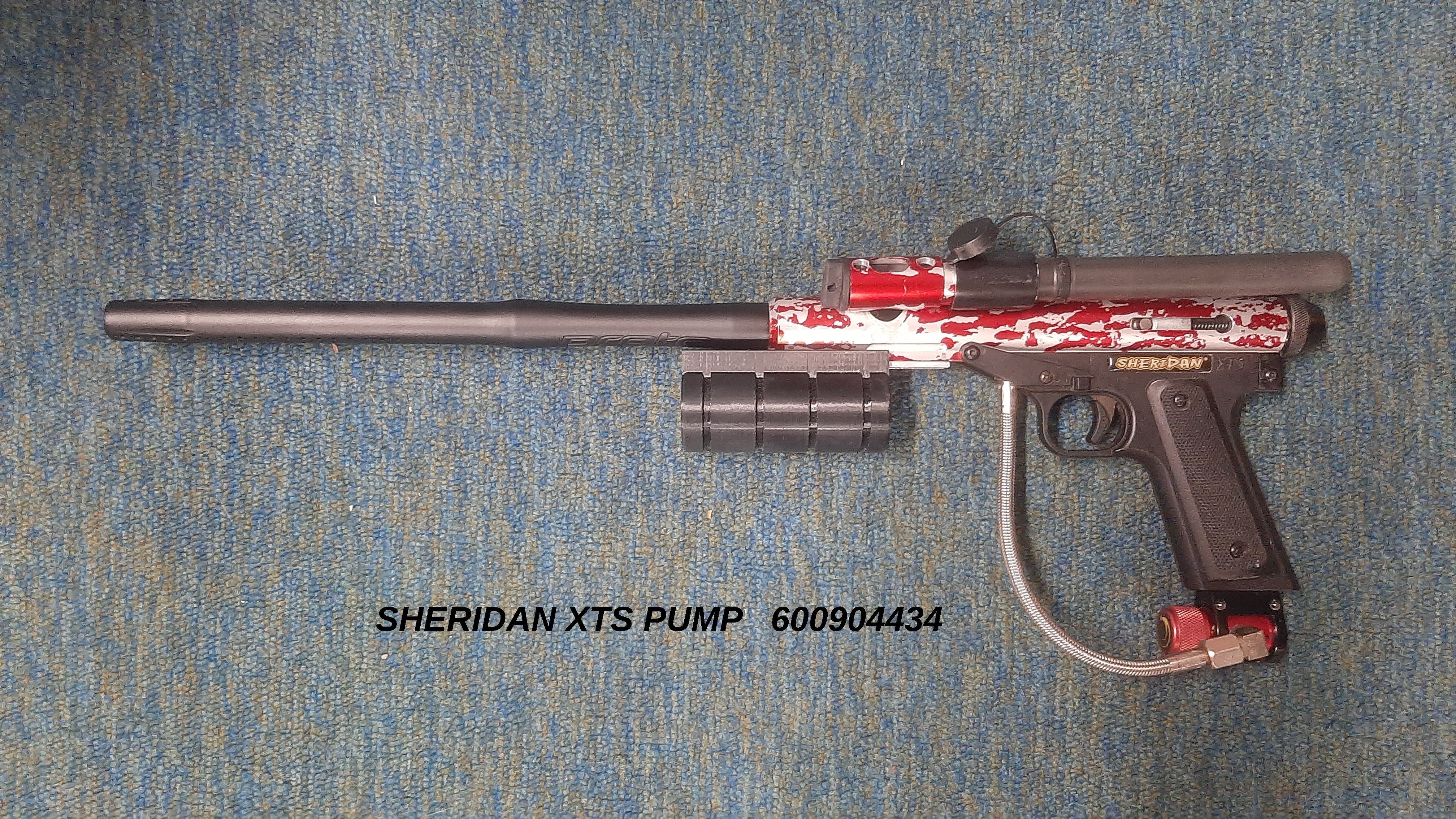

      I did a similar mod with my XTS Pump. the pump is attatched to the bolt from the bottom, ascrew is threaded up into the bolt SHERIDAN XTS PUMP.jpg
      • Magmoormaster
        Magmoormaster commented
        That is remarkably close to what I'm going for
