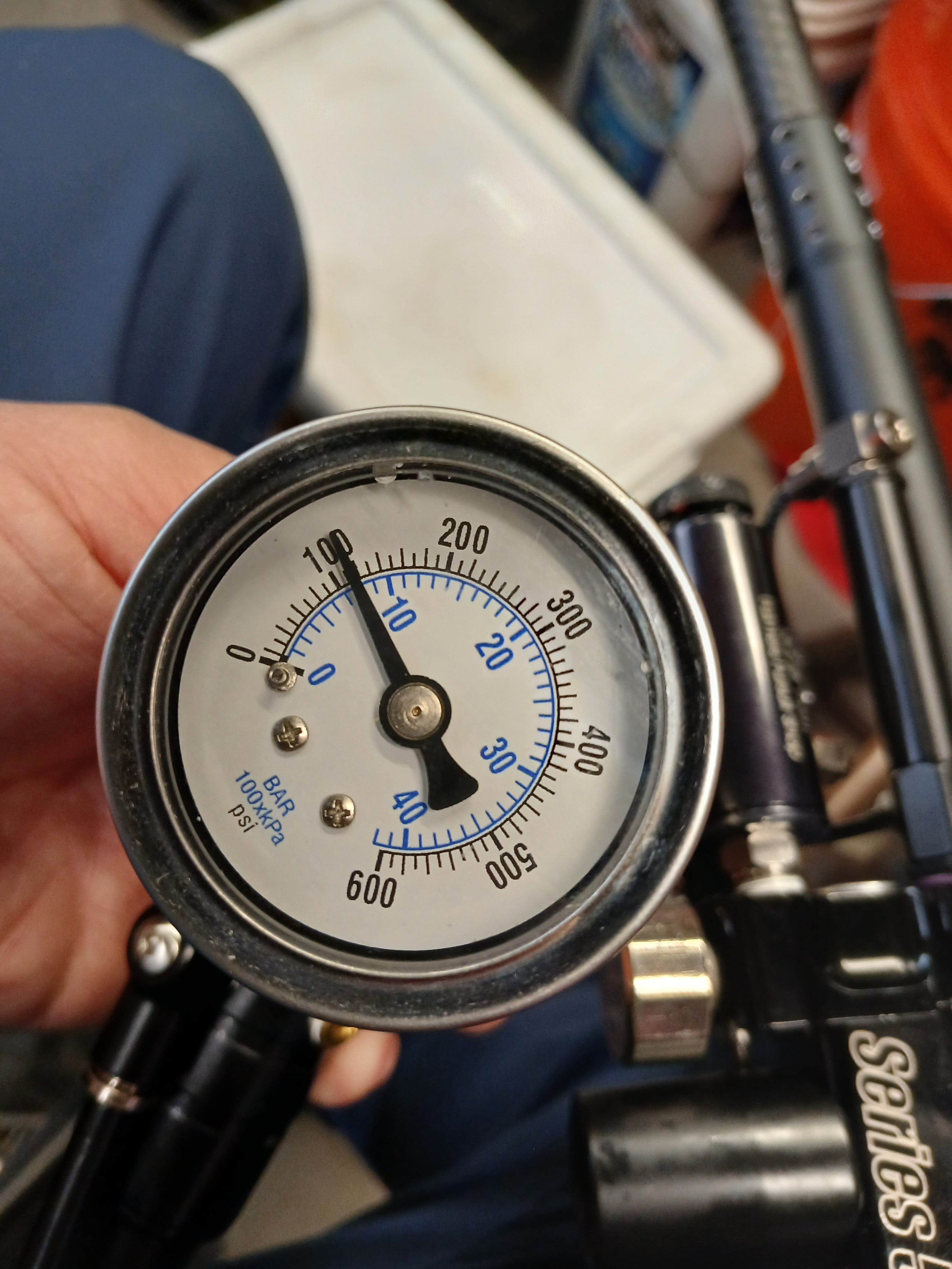

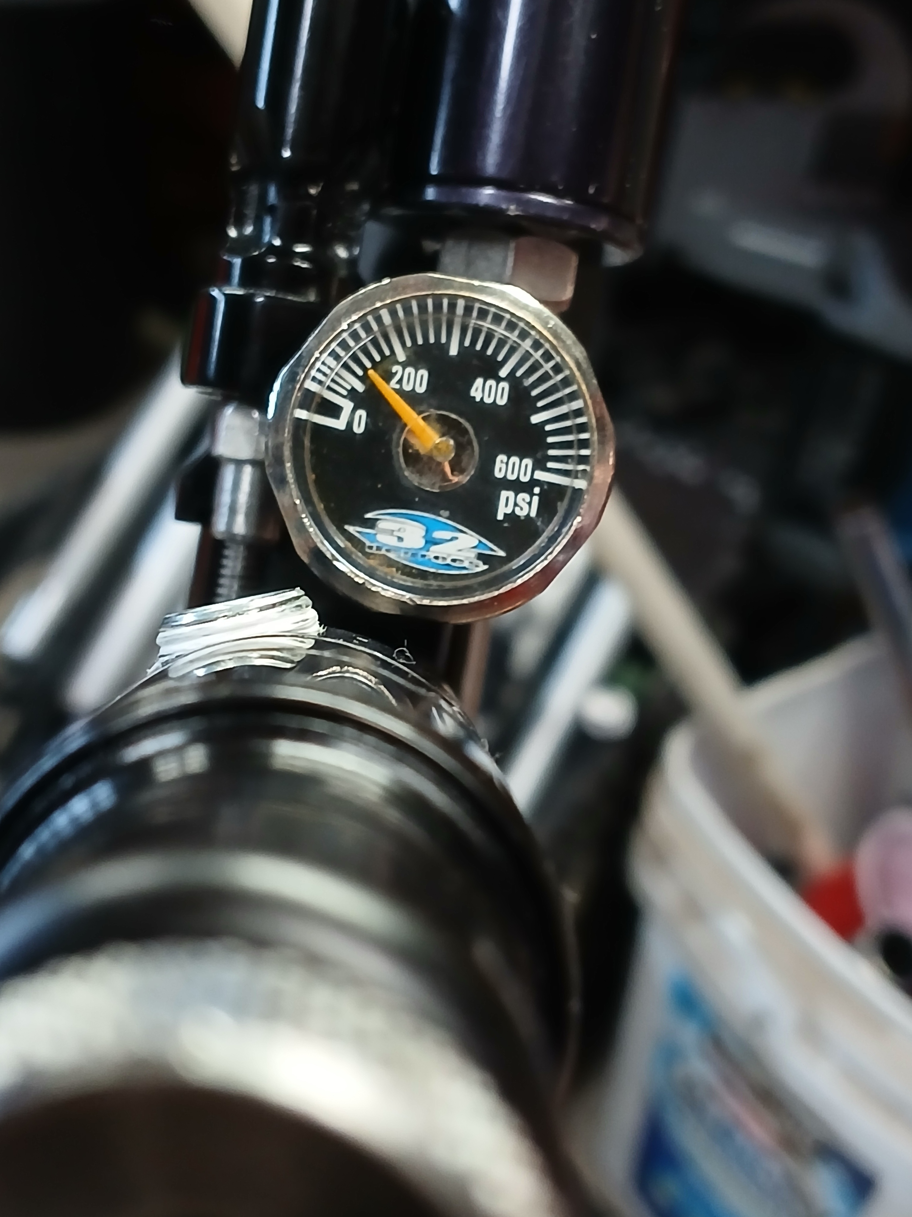

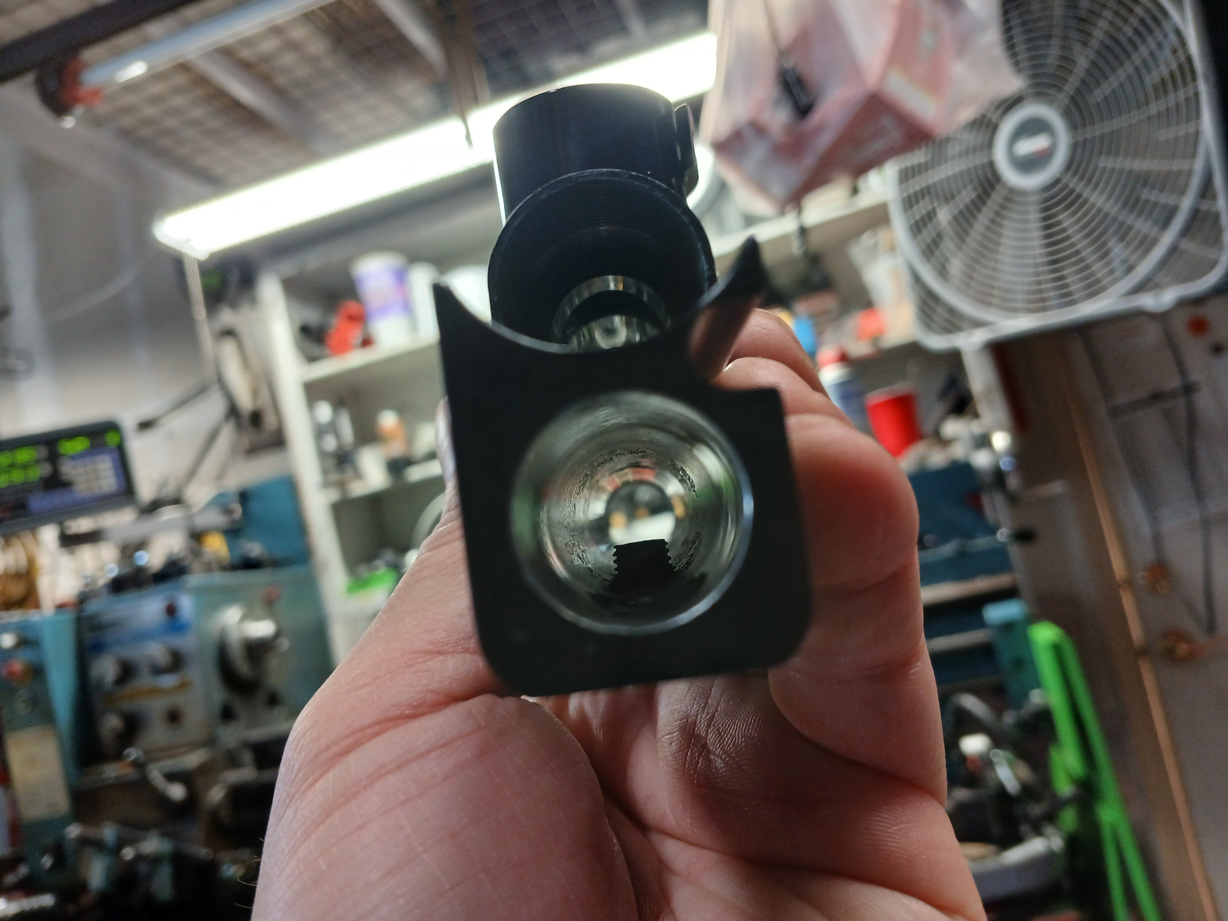

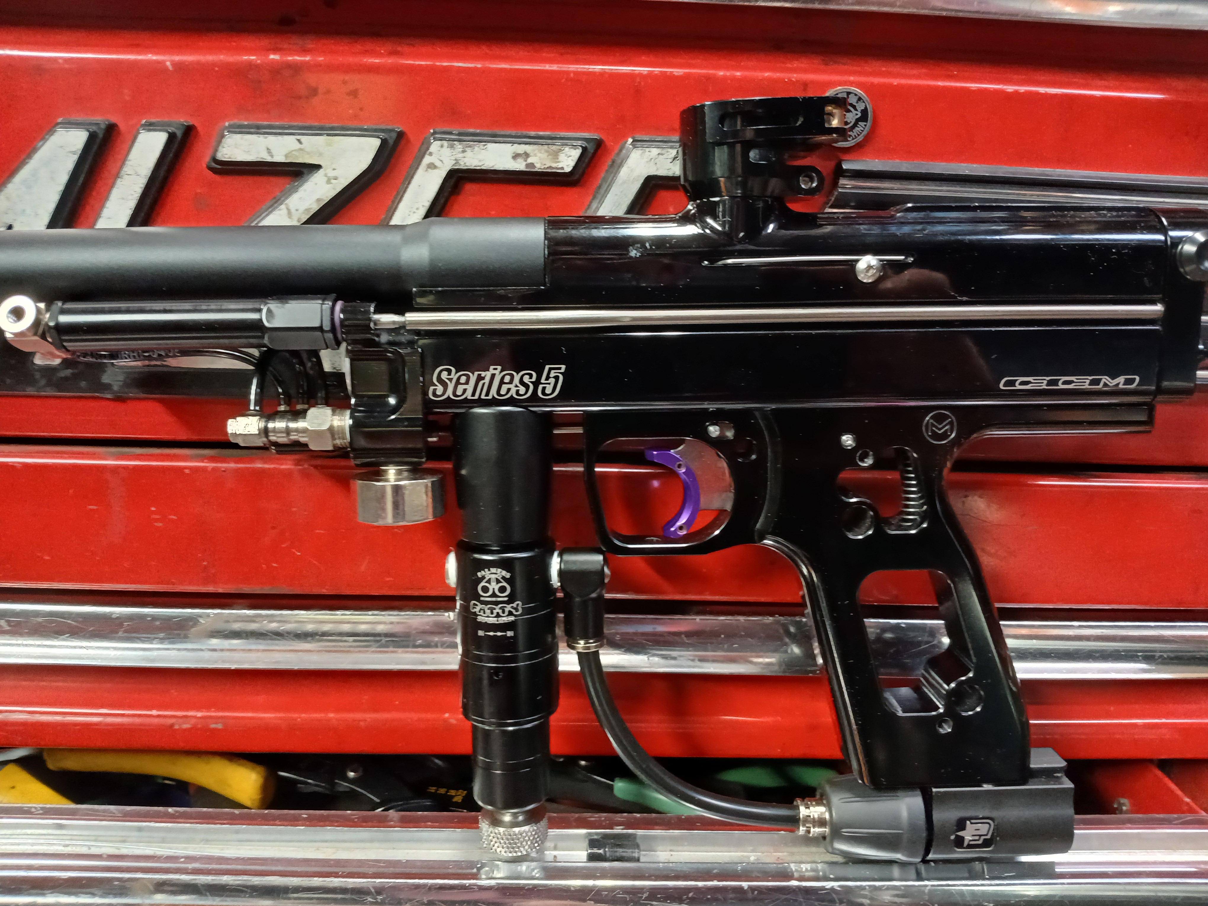

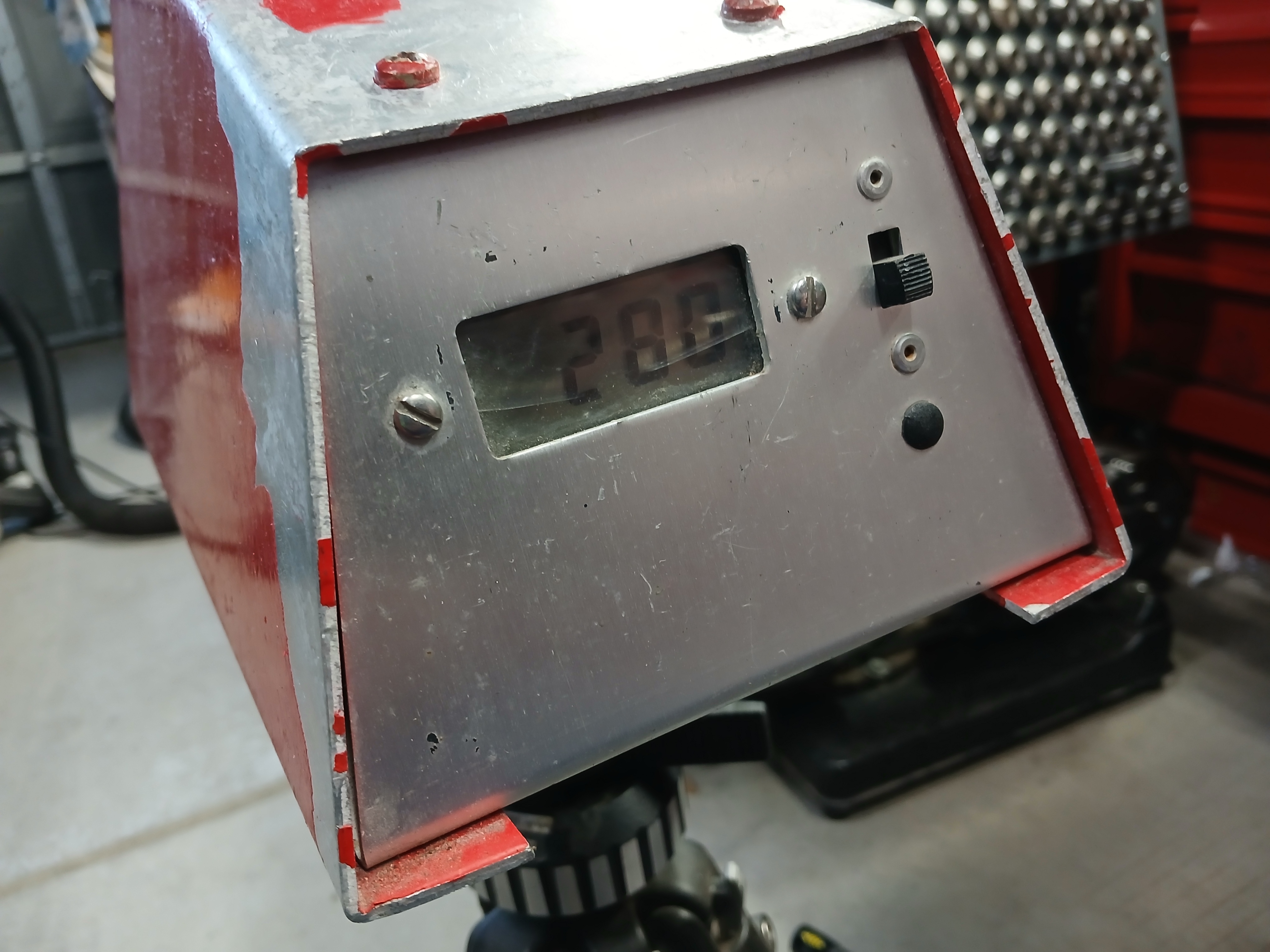

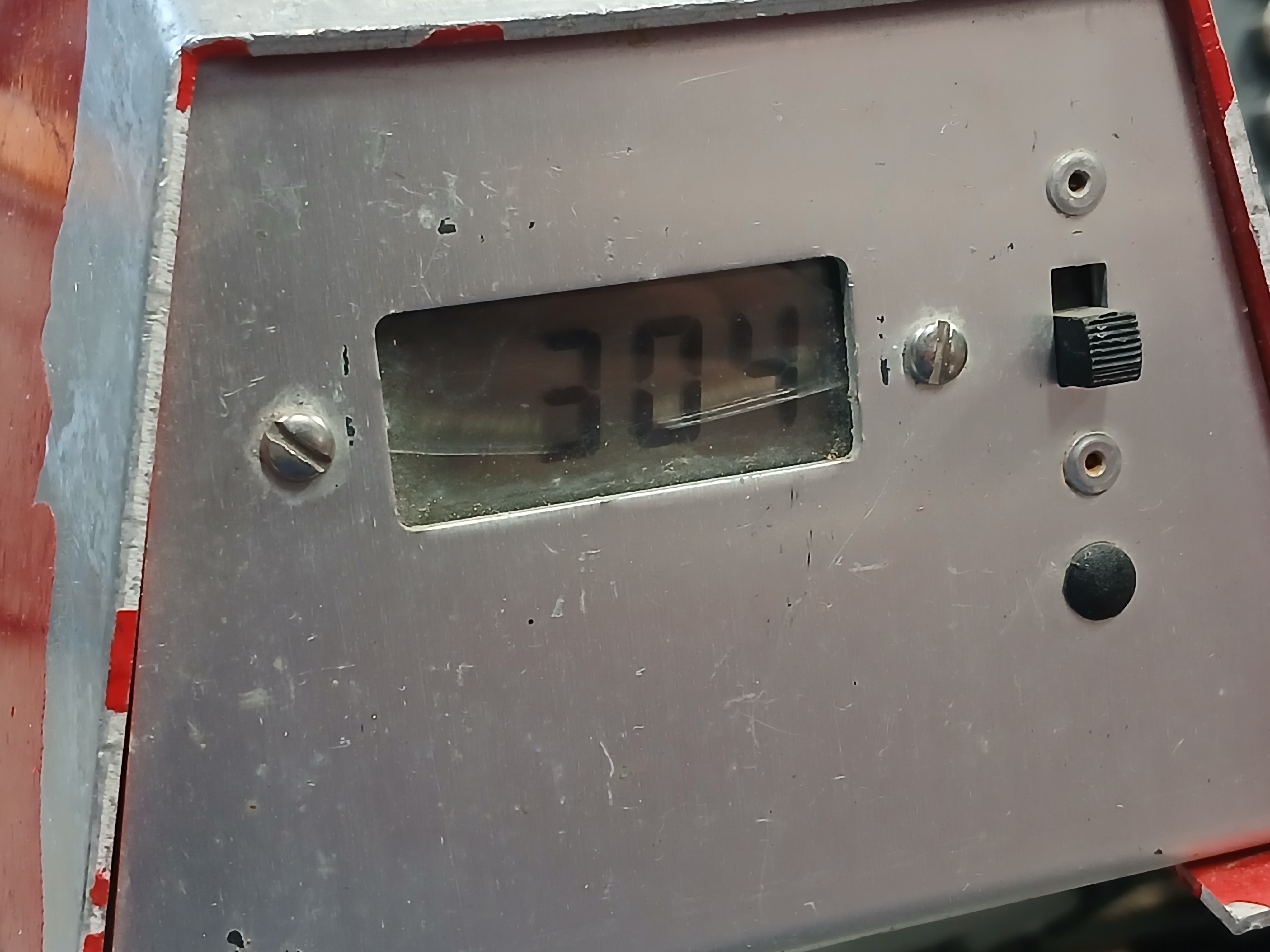

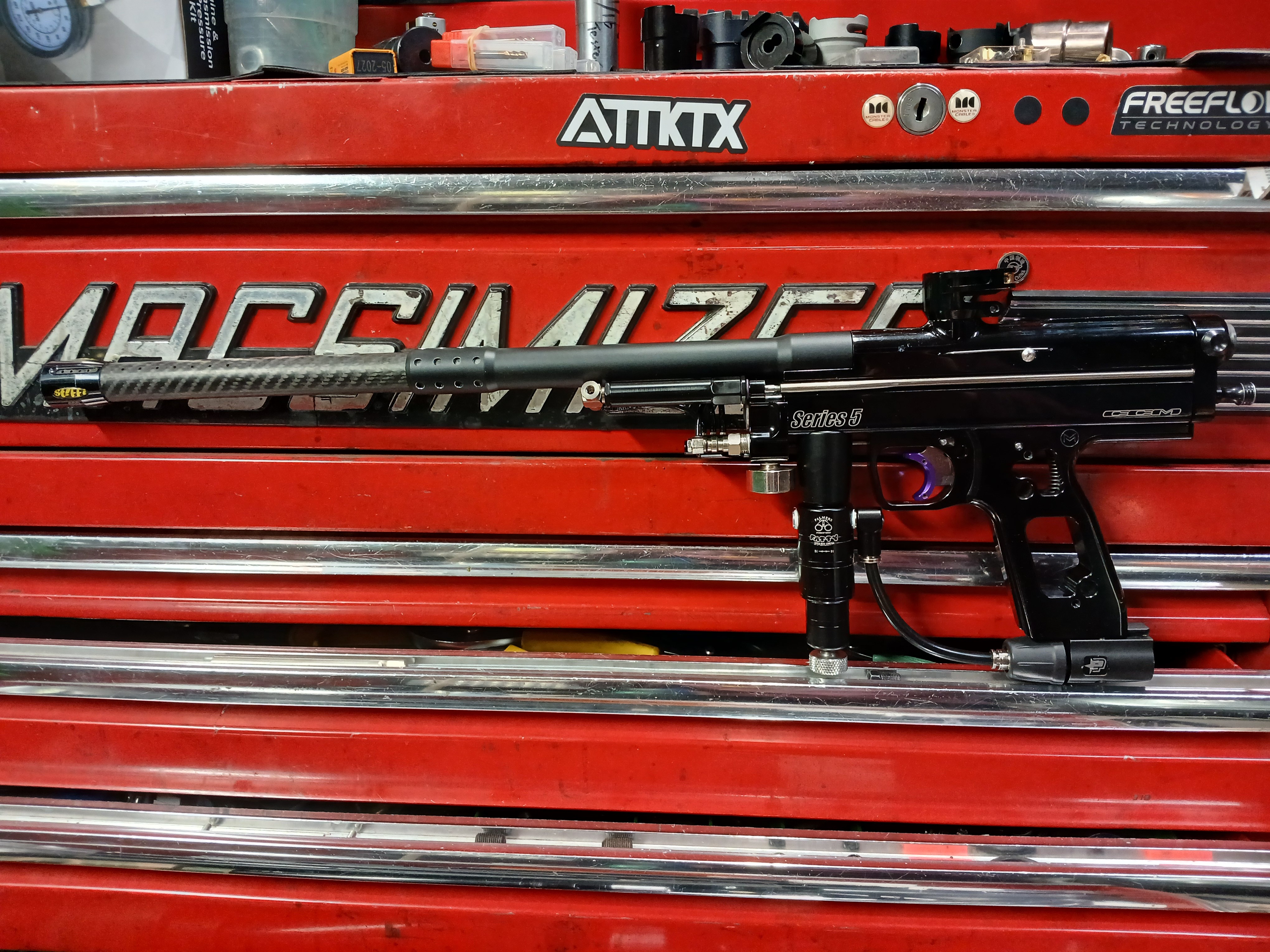

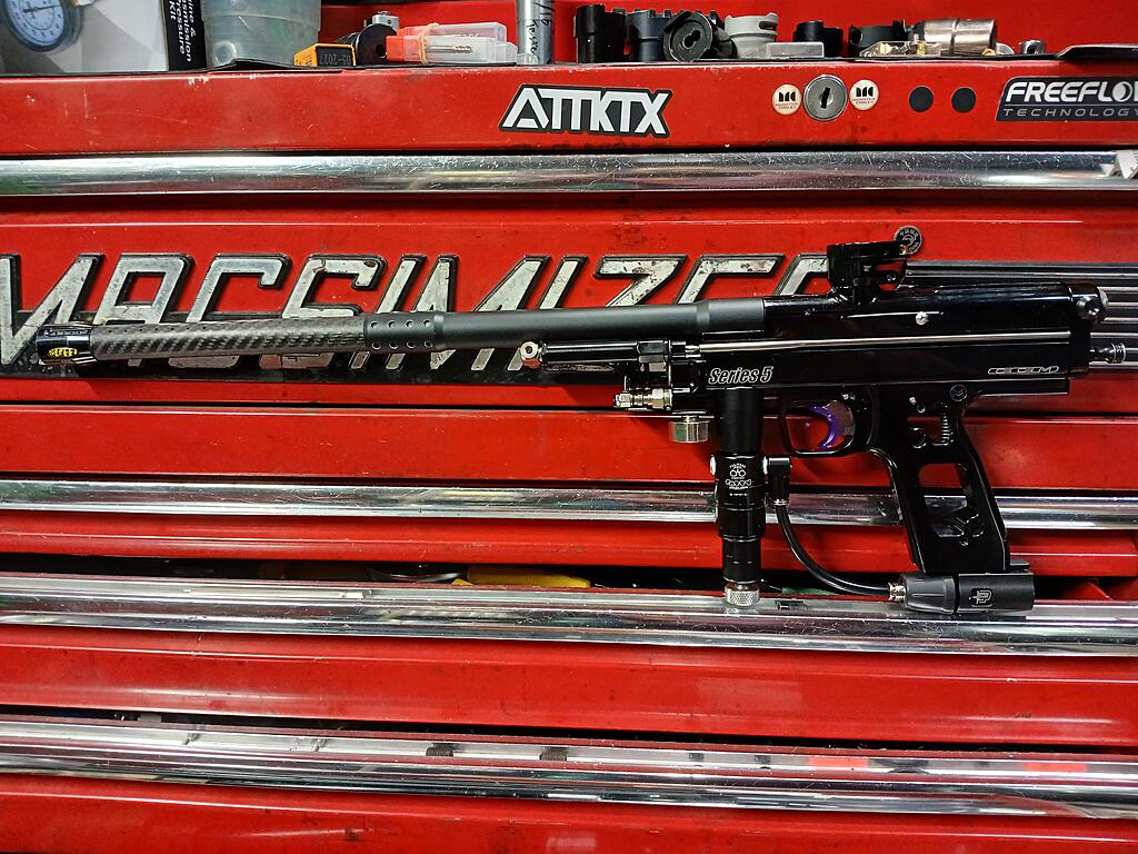

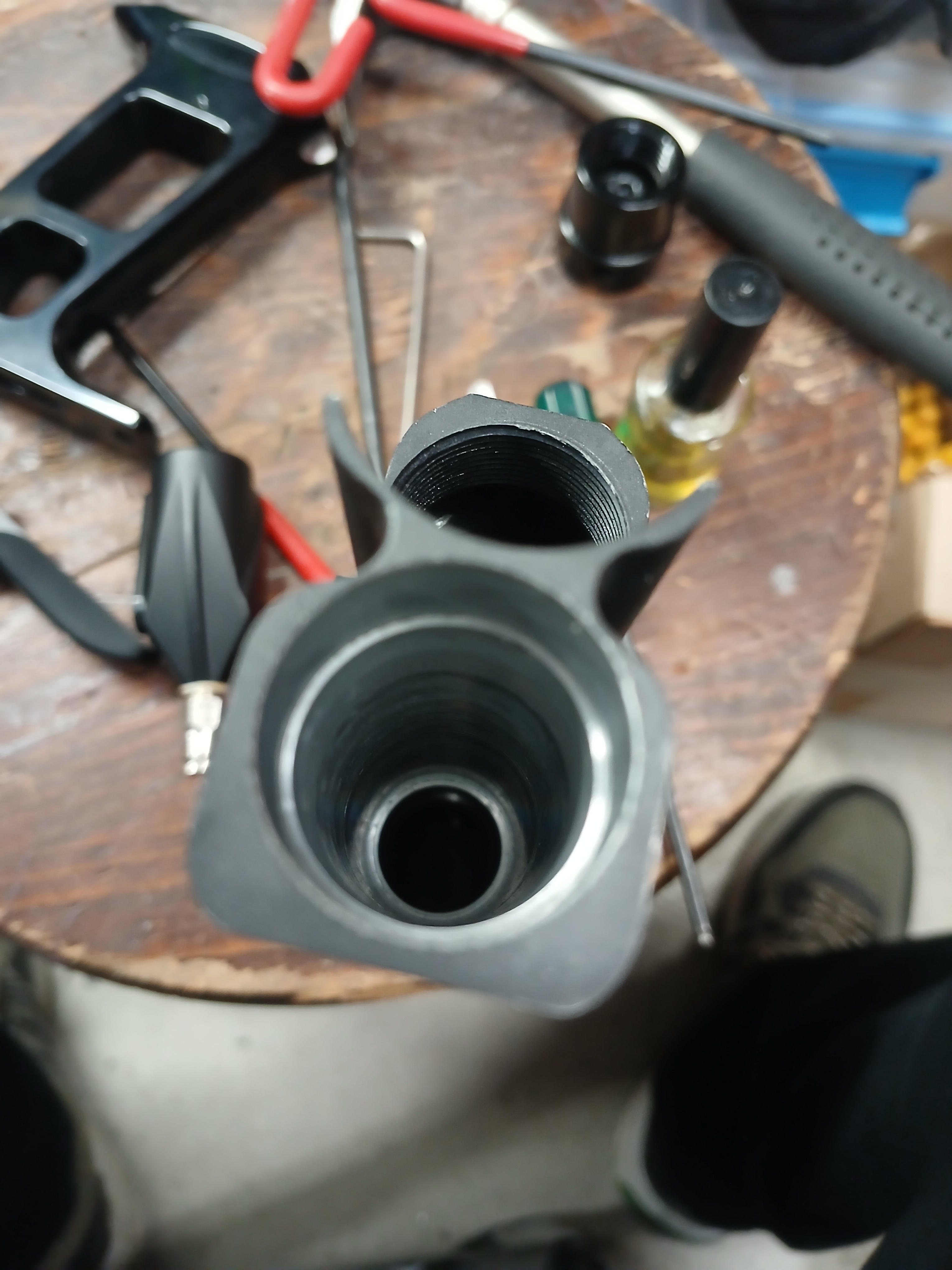

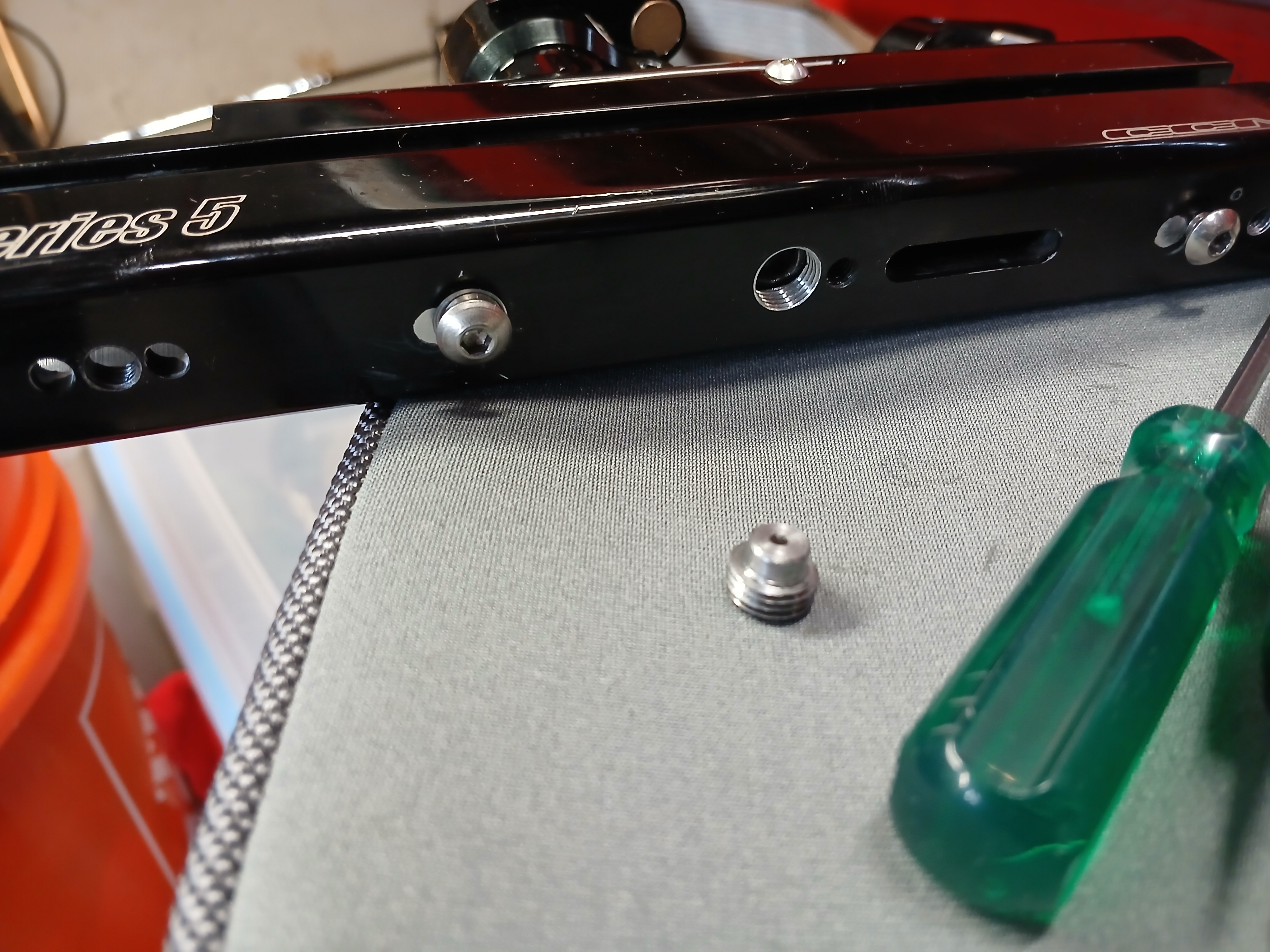

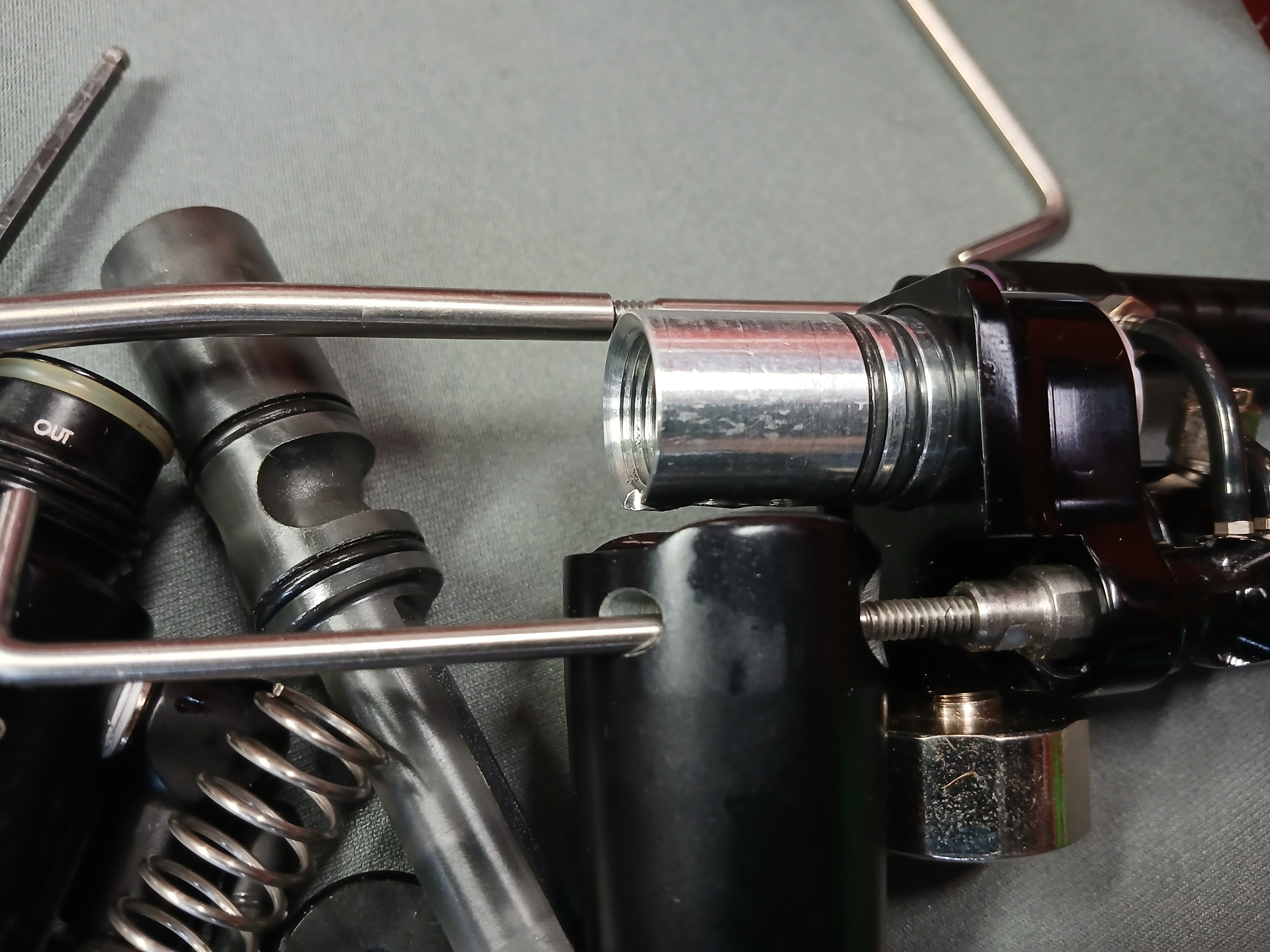

    Autococker pressure are between 110-120 PSI which gets me 304 fps with reballs and 280fps with paint. Body lower tube is bored 11/16 all the way thru for more air volume. Transfer port between the tubes is drilled 21/64" to better match the dye Lazarus valve port opening. Frame is moved back about 5/32" for longer hammer throw.

    What pressure is this running at then?

      Emek stock barrel turned into a barrel back is nifty

      I have a very similar setup i was working on. Have you tried swapping to a shocktech style bolt?

        I don't have a ShocKtech bolt in 2k length. I'm running what I believe to be a Slik nylatron bolt.
      • superman
        superman commented
        I ask as the shocktech bolts generally fair pretty well as they have a longer tip. Though depending on the setup you may have to run a shocktech ram as it has a longer stroke length too.
        That does look lik ethe Slik bolt

        Thats awesome. Man that is a low operational pressure for an autococker. Bravo!

            Wow, nice set of mods! I thought about trying to bore out the body of a Ressy with a Laz valve but didn't think about all of this other stuff you did.

              Hey so what are the actual LT dimension when you bored it out? .690? I was thinking of doing a similar build but with an Attktx gold chamber that has a spring perch. I was going to use a different valve set up. Cool custom CCM build! Doesn’t the LPR delete make trigger pull harder with it at 120psi directly to the switch and ram?

                I drill out the lower tube with a 21/32" (0.6562") drill bit and then finish with a 11/16" (0.6875") reamer to get a smooth finish.
                I don't feel a difference in trigger pull with the marker air up and not.
                I run the softest hammer spring from the inception master spring kit with a delrin hammer.
                The frame is sprung pretty light with springs out of the SLP spring kit from maggot on here.
                I set my LPR pressure by holding the trigger back and then trying to push the bolt forward by hand. Should take a firm push. LPR pressure to low can cause blow back up the feed neck and/or lower velocity.

                      How important relatively do you think the frame moving backwards is?

                        When testing the frame set back on the s5. I saw 15-20 fps increase, but while trying to replicate the results on another body. I didn't see any increase in velocity.
                        Also more available air volume doesn't automatically results in lower operating pressure.
                        I have this wgp 2k body bored out to 0.807" right before the front sealing oring of the Lazarus valve.
                        I saw no increase of velocity and it operates at the same pressure (150 psi) as before i drill it out from 11/16" (0.687") to 20.5mm(0.807").
