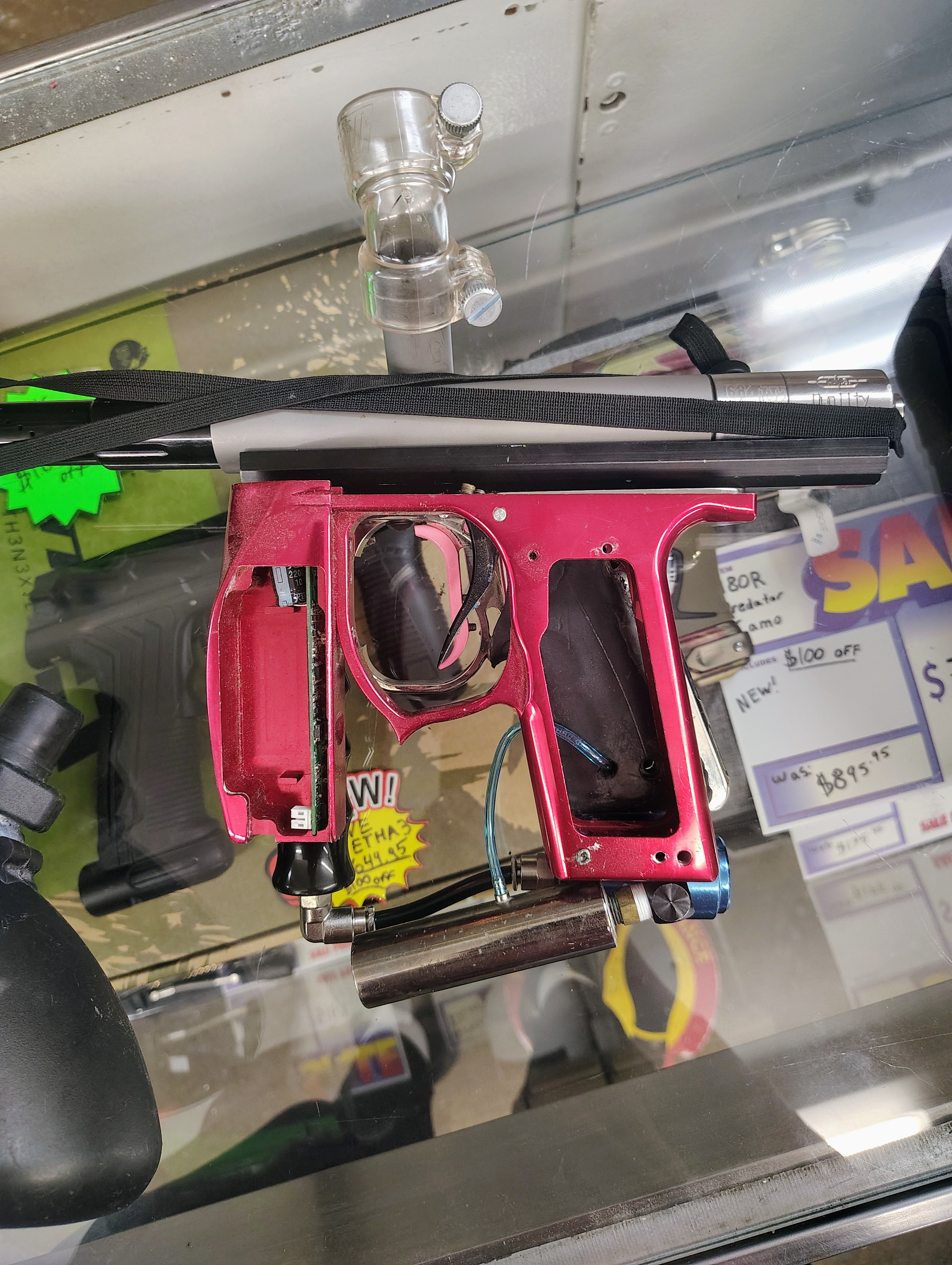

      Not that it's needed, but here is another vote for leave it mech.
      I feel like the best name is just Mini-Mini Mag GS....that's just me though.

        Took a look at the original mini frame, the screw holes look like they'd line up. I didn't have time to take the frame off and all that, but it's probably the same deal as what had to be done with the GS frame. However, the original mini had that proprietary regulator ASA thingy, which didn't use any standardized ASA mounts. One option could be to use the large center thread to attach some sort of dovetail block, but at some point it's better to just try and get a different frame

            YeOldeSliggity any further notes/updates for us.
            I have a GS coming in mail I may put to the knife for giggles....
            • YeOldeSliggity
              YeOldeSliggity commented
              Sure!
              I tried really hard to make it an electro pnuemag.. there just isn't enough room.
              It's real easy to make it a Mech, you just have to drill the mounting holes out a little, and you need to shape up the frame a little bit where the field strip screw goes, using a Dremel or a milling machine. Have fun!
