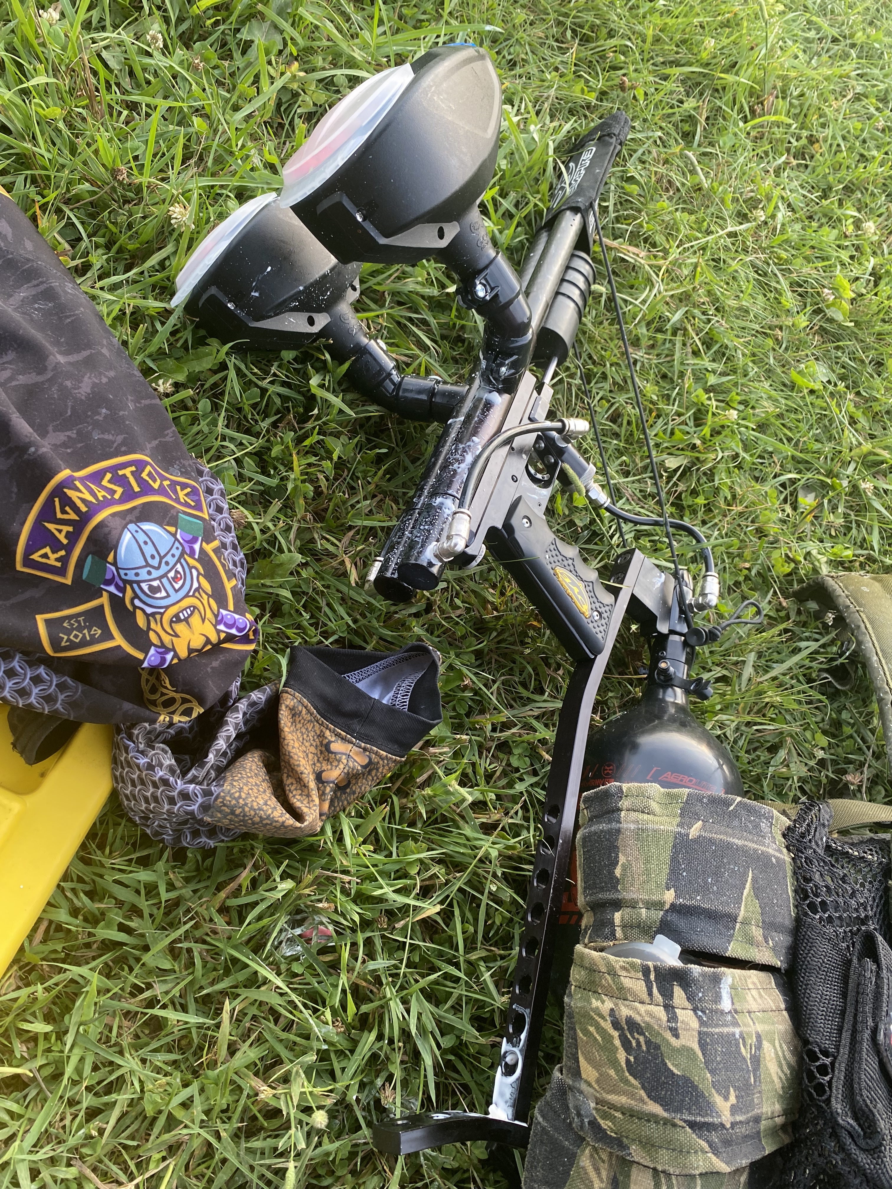

    Just shoot my double at ION last weekend.
