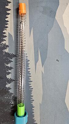

    If designing a magazine, is there a rule for springs regarding tension or perhaps some salient advice on space for the stack/load? using roundball and typical spring stock.

        Yah, there are engineering equations using the spring tension factor k. But if you're just tinkering start with a normal spring and start cutting it down until you get the tension and load stack you want. Keep track of the cuts because you might reach a point where there's no longer enough spring tension and that will be your no-go zone.

          Looking for a 12 round capacity.
          I think my spring may be too strong.
          Im gonna load some rounds and see if they deform.
          woohoo its a 15 round feed and works fantastic.
          I was trying to get by without the green alignment sleeve but for getting the tension to lock I needed to create a line lock so thats it. the spring retainer line is Kevlar however the first version used common waxed dental floss as I wanted something that wouldnt knot. I dont suspect the kevlar will snag and knot.
