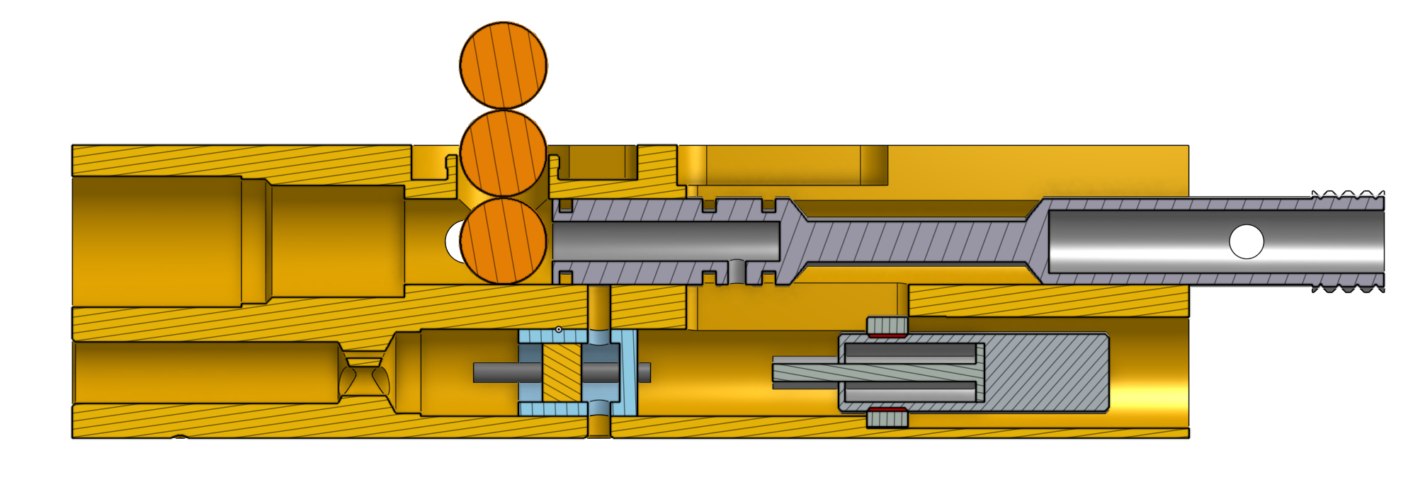

    Had an idea stuck in my head for actually almost 15 years now but only recently had the knowledge to even think about following through with it.
    ​The ultimate end goal is to design an open source paintball marker that anybody can order from a standard parts catalog and build in their own home!​
    It started with wanting to make a Tippmann EBolt with a FASOR cylinder from McMaster but has since evolved.
    image.png​

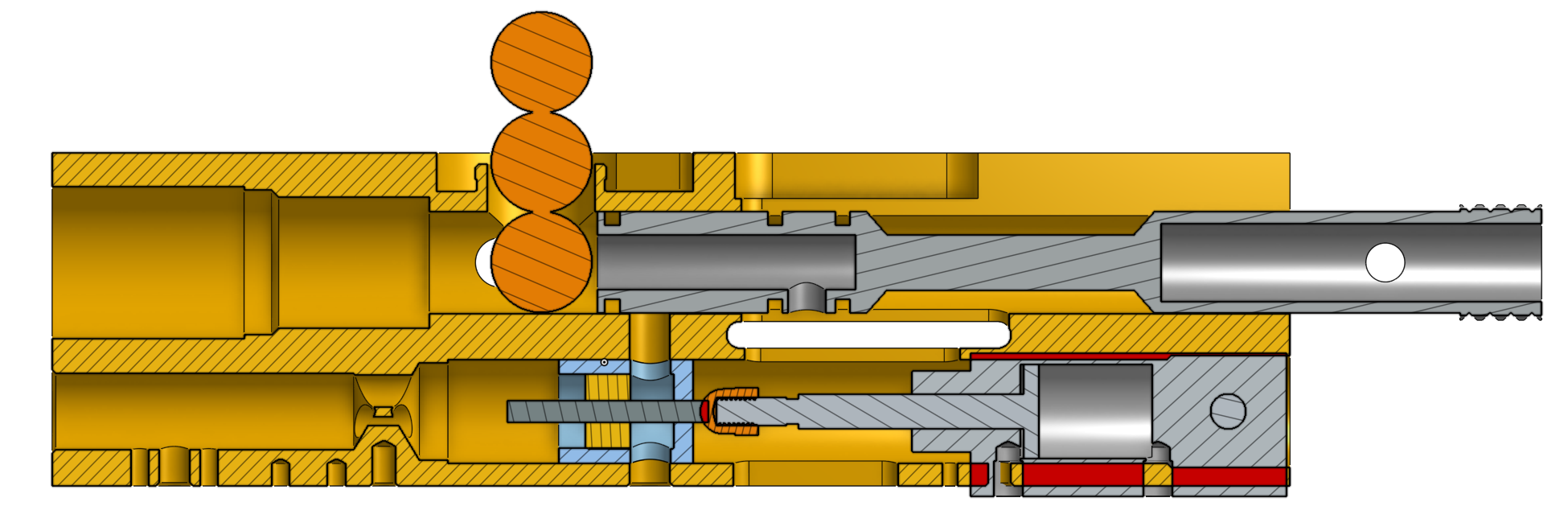

    The idea is to take the FASOR cylinder and a Tippmann/BT/inline blow back valve and install it into a 3 piece body with a pretty bog standard stacked FASOR design not unlike some of the contemporary offerings.
    I'm anticipating doing something ​with an A5/X7/FT12 with the original ebolt design just to understand pneumatics more. My engineering domain is electrical, so I'd have more experience designing the control board, which I also need to do!
    The end goal is to have:
    1. an ebolted tippmann, just like 15 year old me always wanted
    2. a cheap to manufacture and assemble stack tube FASOR marker with as many off the shelf parts as possible
    At the end of the day this is basically just a Spimmy, but using more common parts.
    The body being designed around the requirement instead of shoehorning parts into pre-existing parts should also help.
    This is going to be a loooooooong process, but little by little I'll have something!

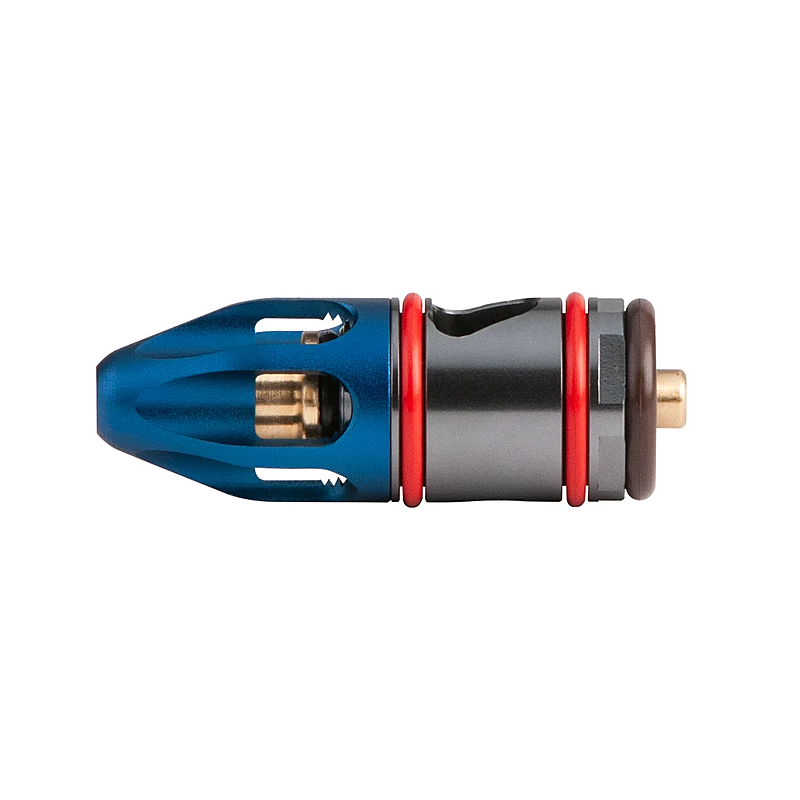

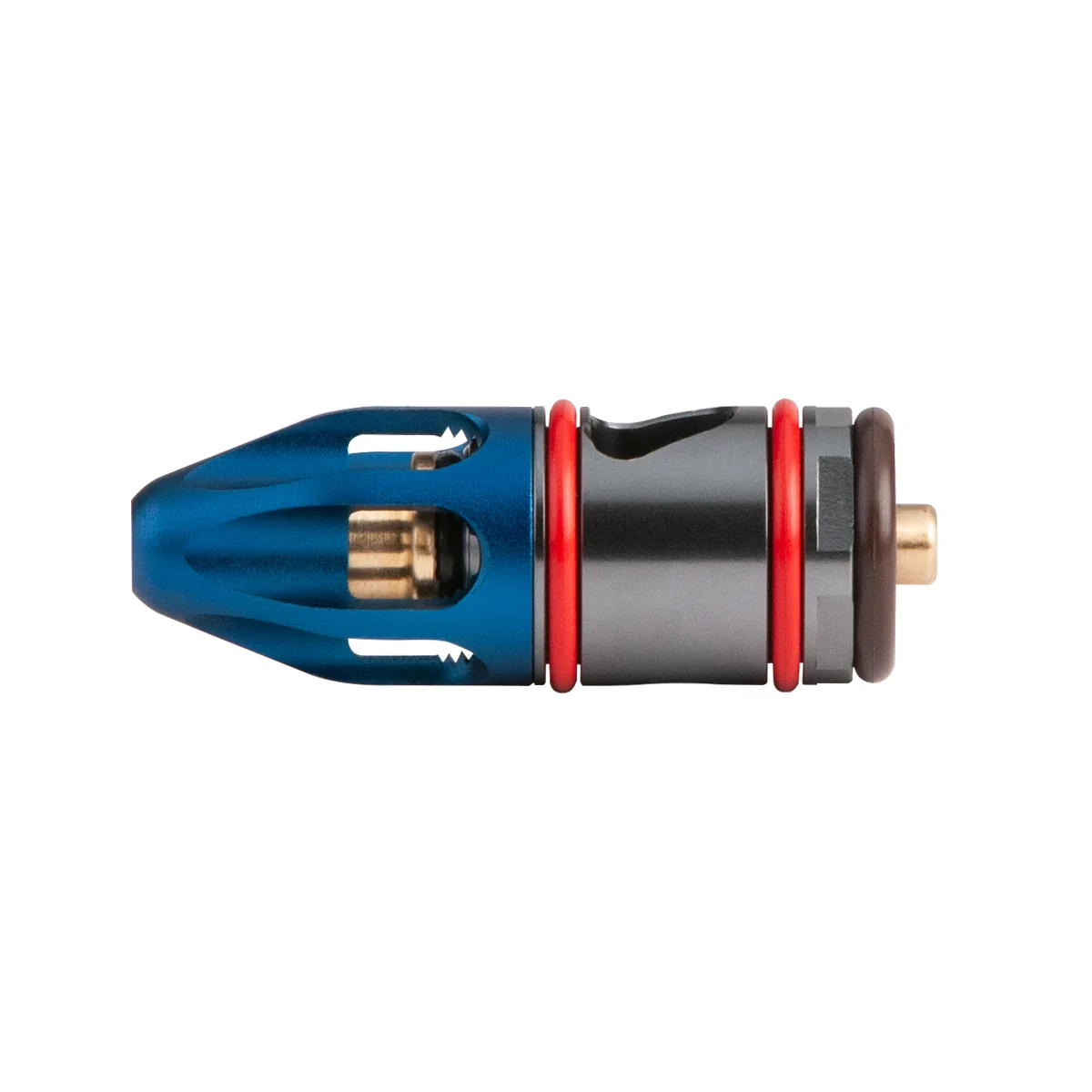

      After some digging I'm thinking the relatively recently released Dye Lazarus valve might be a good valve design to design around.
      Autocockers have a large following, so even if this specific valve is discontinued, compatible replacements will remain widely available. It's also a well-designed valve.​

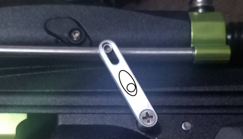

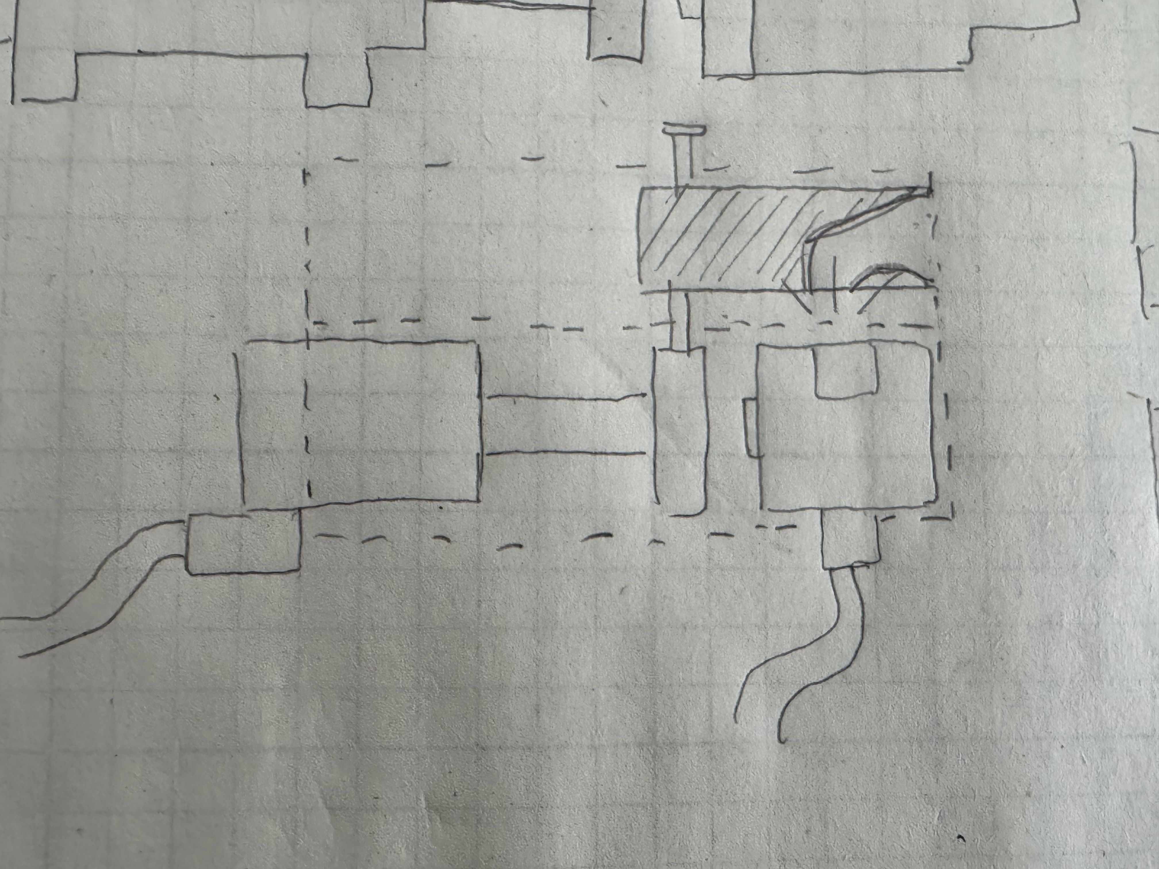

          I've been thinking about a Spyder build where the ram is concealed in the rear of the top tube. The ram would operate the bolt, which is connected to the striker. A 3way will fit in the trigger frame, and possibly an LPR as well. The skeepier the look the better.
          • tyronejk
            tyronejk commented
            One potential issue there is getting enough force through the striker since it's off-axis. Pushing too hard/fast could cause binding in the bottom bore and slow down the striker.
          • hunter47
            hunter47 commented
            Binding is exactly the reason why I wouldn't want to do that.

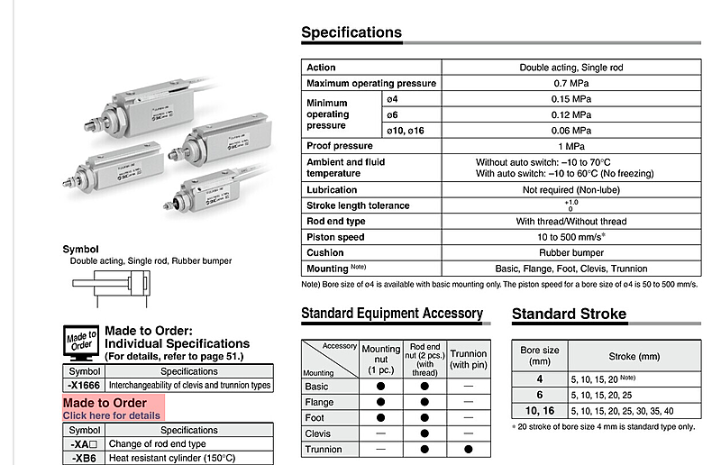

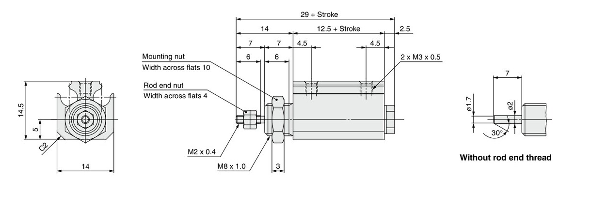

            I've just been looking around and SMC has an interesting offering - unsure if this has the force I need it to have to break the valve open. Again, my engineering domain is in electrical, all I know about physics is F=ma lol
              Force/momentum to open a poppet valve is hard to figure out. I remember asking around before and the answer I got was "eyeball it". So basically use existing platforms as reference. Luckily, with the Laz valve, there's a lot of references of what hammer/spring combos, operating pressures, and chamber volumes people are using.
              It looks like piston speed here is a concrete spec, but piston mass matters too for opening a valve. That will probably have to be a separate component, since it may be hard to get a piston with a specific mass spec'd out.
                Yeah, also why I'm sold on the Laz valve.
                I will need to make a hammer/bolt carrier anyways to link the bolt to the piston. This will be where I can tune mass.
                There's a lot of variables here, though.
                My initial thoughts:
                1. Know pressure range + chamber volume for laz valve
                2. set HPR to floor of range
                3. some sort of hammer on rod end, there is a maximum allowable kinetic energy that the piston can handle so I guess it's that number - bolt weight to just max it out.
                4. Drive at 0.5 MPa (figured operating slightly below maximum gives me tuning margin)
                5. Tune dwell → velocity reaches equilibrium or starts diminishing → minimum viable dwell
                6. Raise HPR until good velocity is reached
                This is obviously extremely simplified, but I'm interested in hearing if this is a bad plan.

                  Don't forget to consider flow rate to the piston. You can drive it at 0.5 MPa but if you don't supply enough flow, you'll limit the velocity of the hammer.
                  Otherwise, I think you have all the important considerations listed.

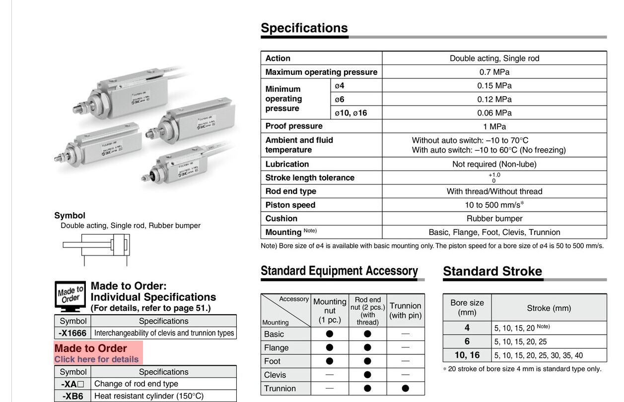

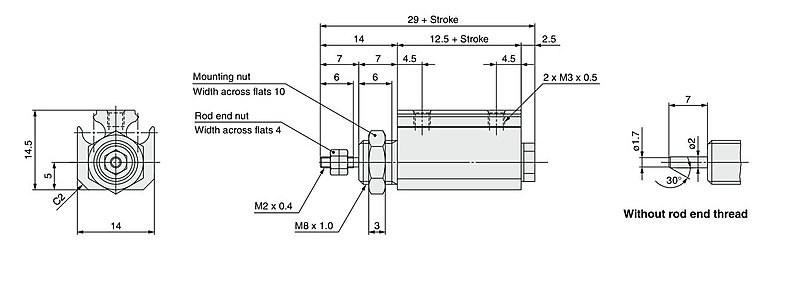

                    Using ZDSPB's autococker bodies for a start. Tried with both the CJP2 and the CJP-Z valves. The CJP2 is a dual action, whereas the CJP-Z is a FASOR design.
                    I'm liking the CJP-Z form factor more, but I am concerned about the spring return force.
                    One thing to note is that the cocker bolt requires at least 50mm of travel whereas the pistons only do 15-20mm of travel (15 for CJP-Z, 20 for CJP2), so I'll need to create a lever linkage of some sort. First thought is a 2nd class lever based on the auto-trigger designs of stack tube pumps, mocked up below:
                    image.png​ ​​

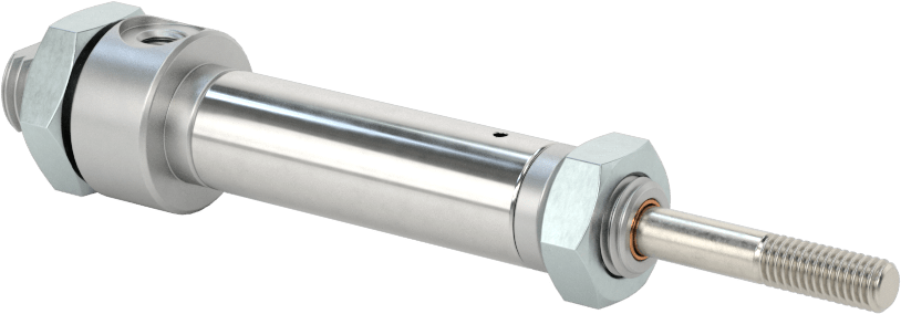

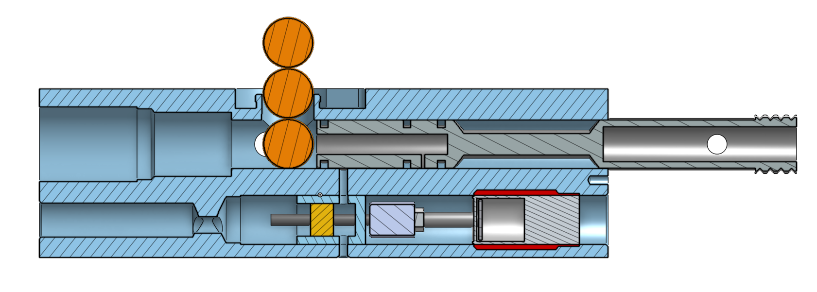

                    Using a IMI Bimba MA-500 with 1" stroke, looks to fit much better and I think I can fashion a bolt carrier/hammer much easier with this cylinder design.
                    The only problem with this cylinder is that one of the ports goes straight out the back, so the hose routing will be a particularly interesting problem to solve.
                    I'm thinking I'll need to get a 1.5" stroke model to make this more easily work with a halfblock bolt.

                      Woof... the IMI Bimba cylinder is ~$200 compared to the CJP2 which is ~$50.
