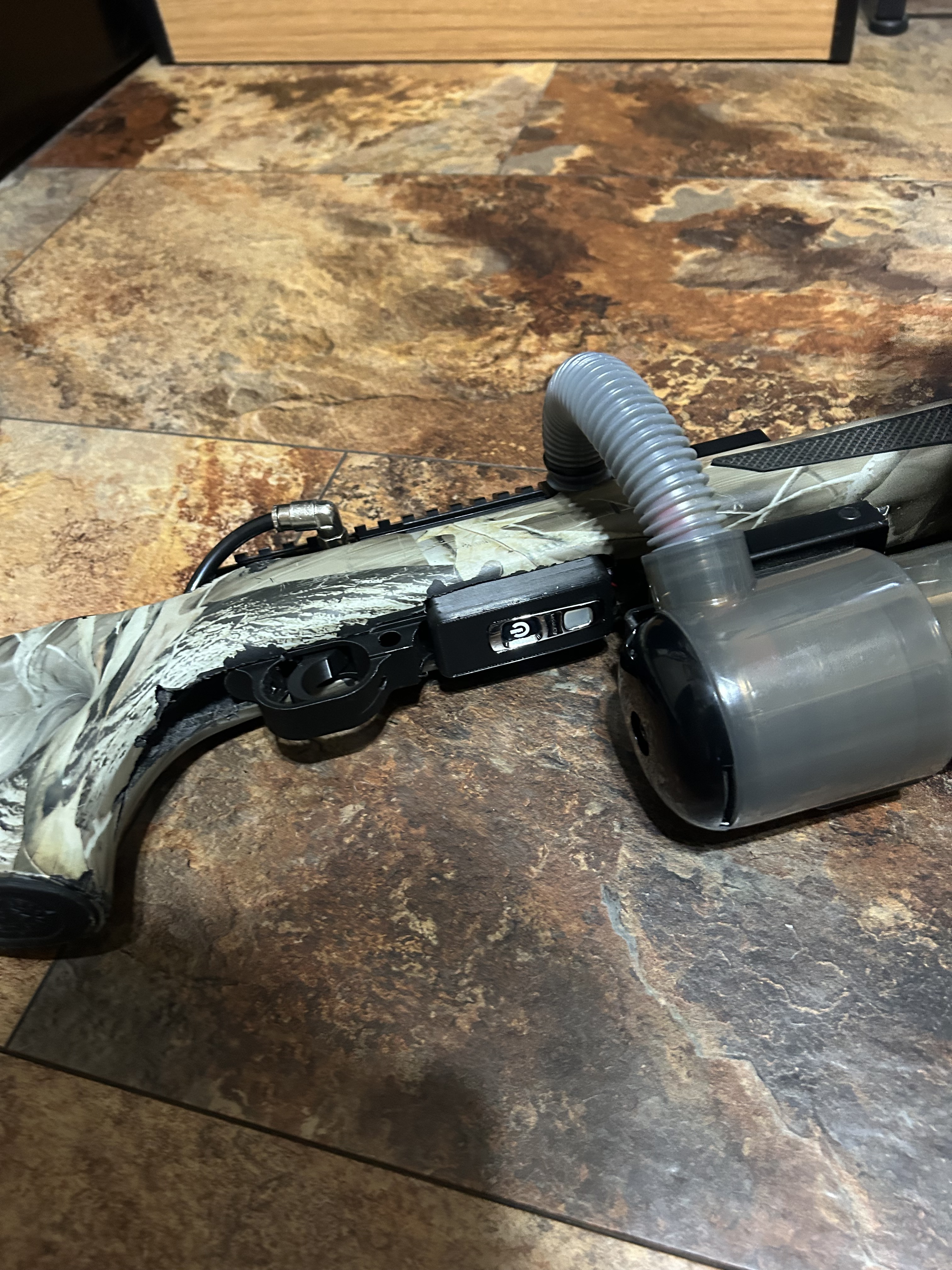

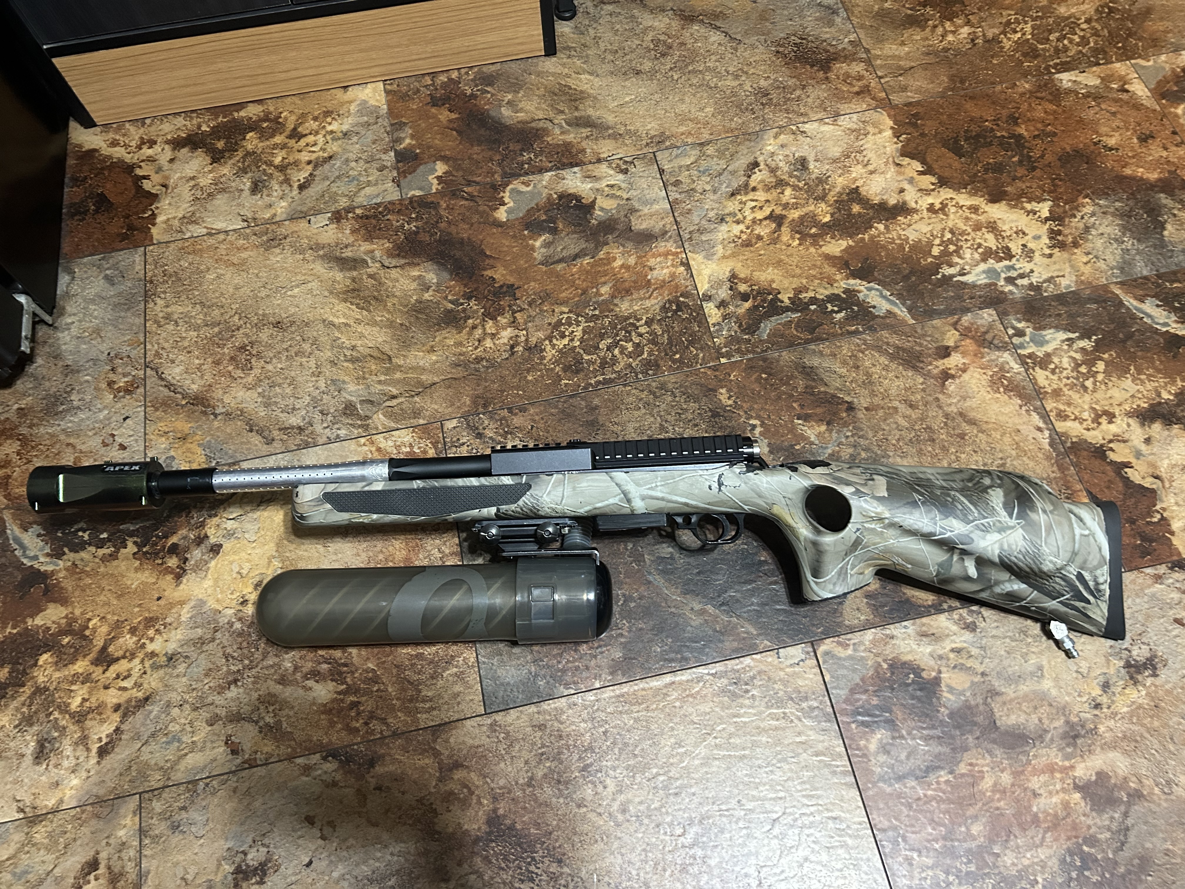

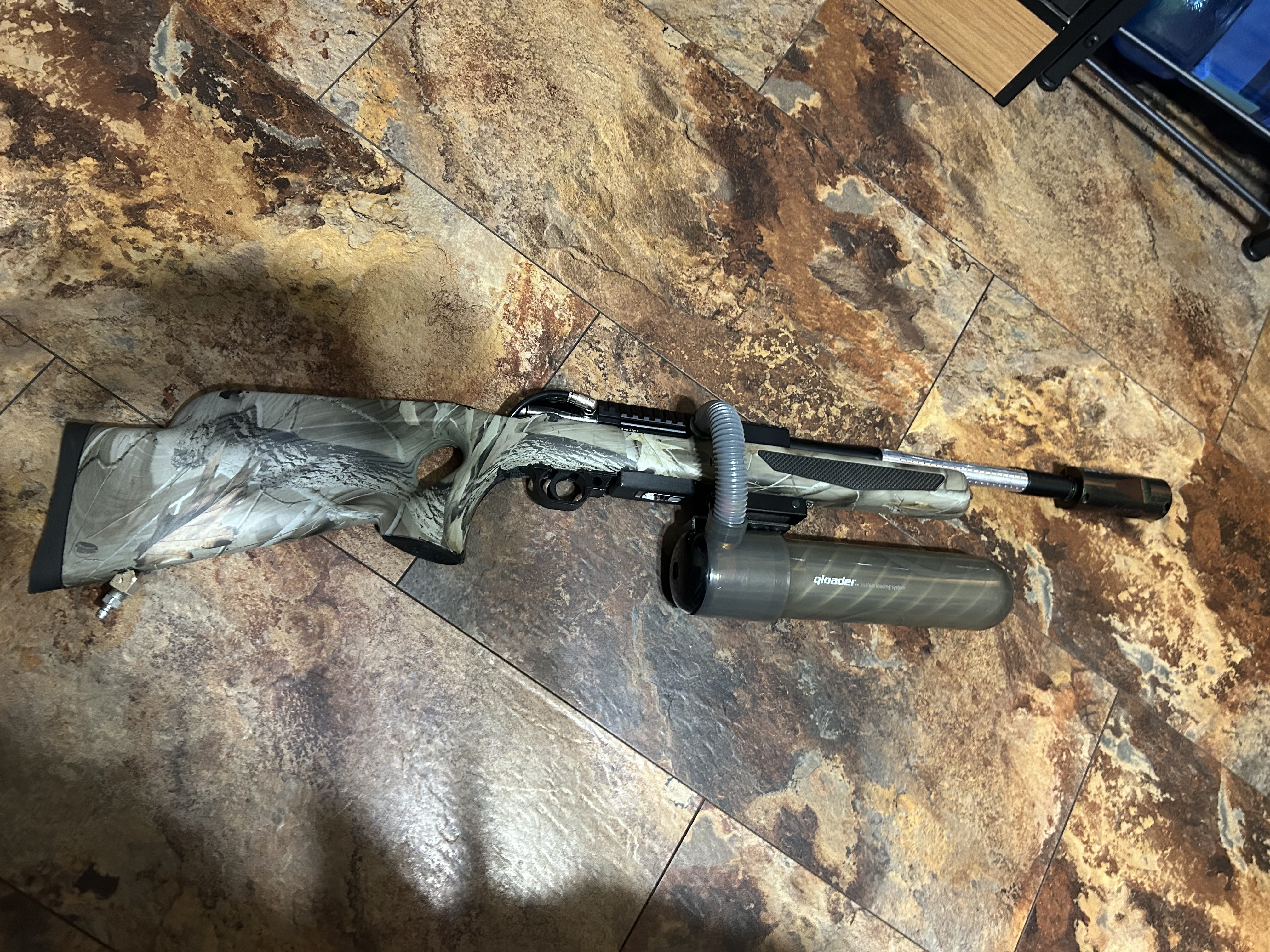

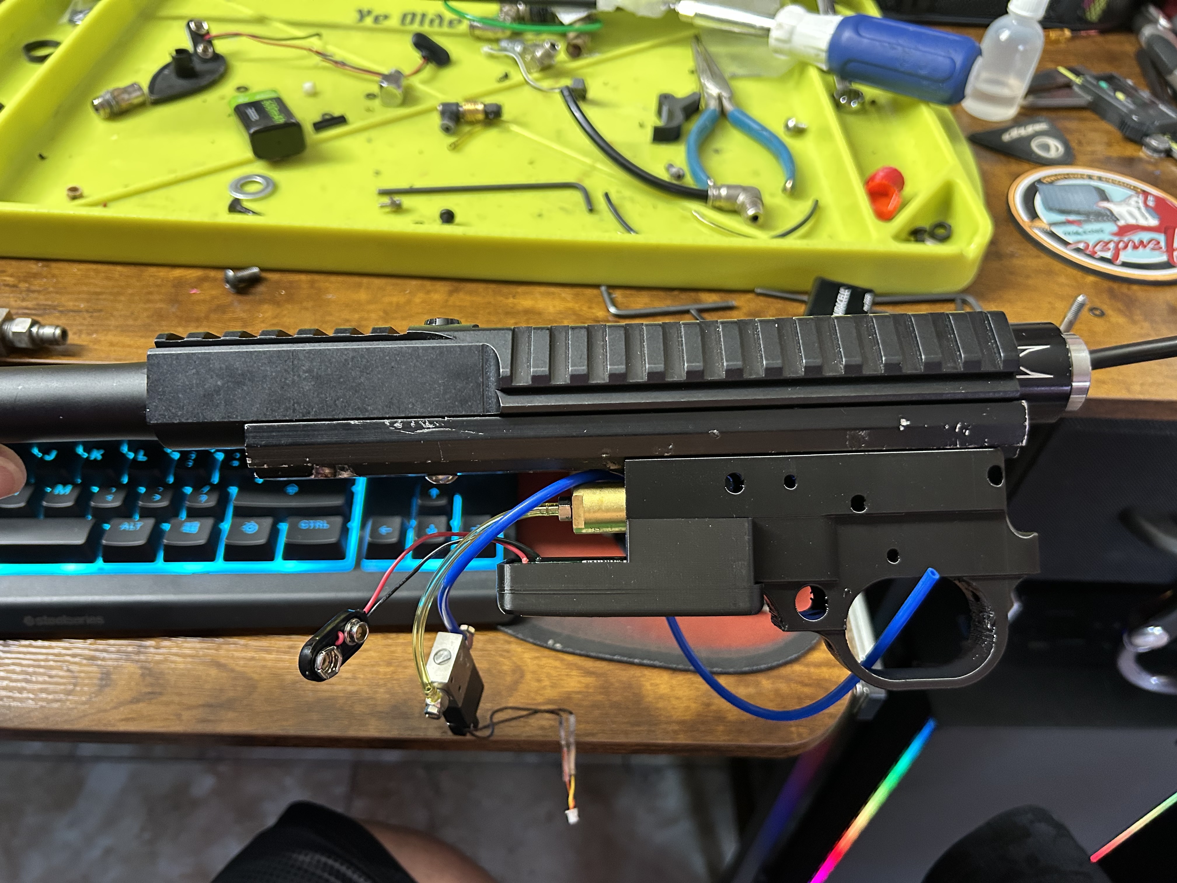

    OK another project mostly finished.. some minor tweaking is needed but overall it’s functional and fun to shoot!

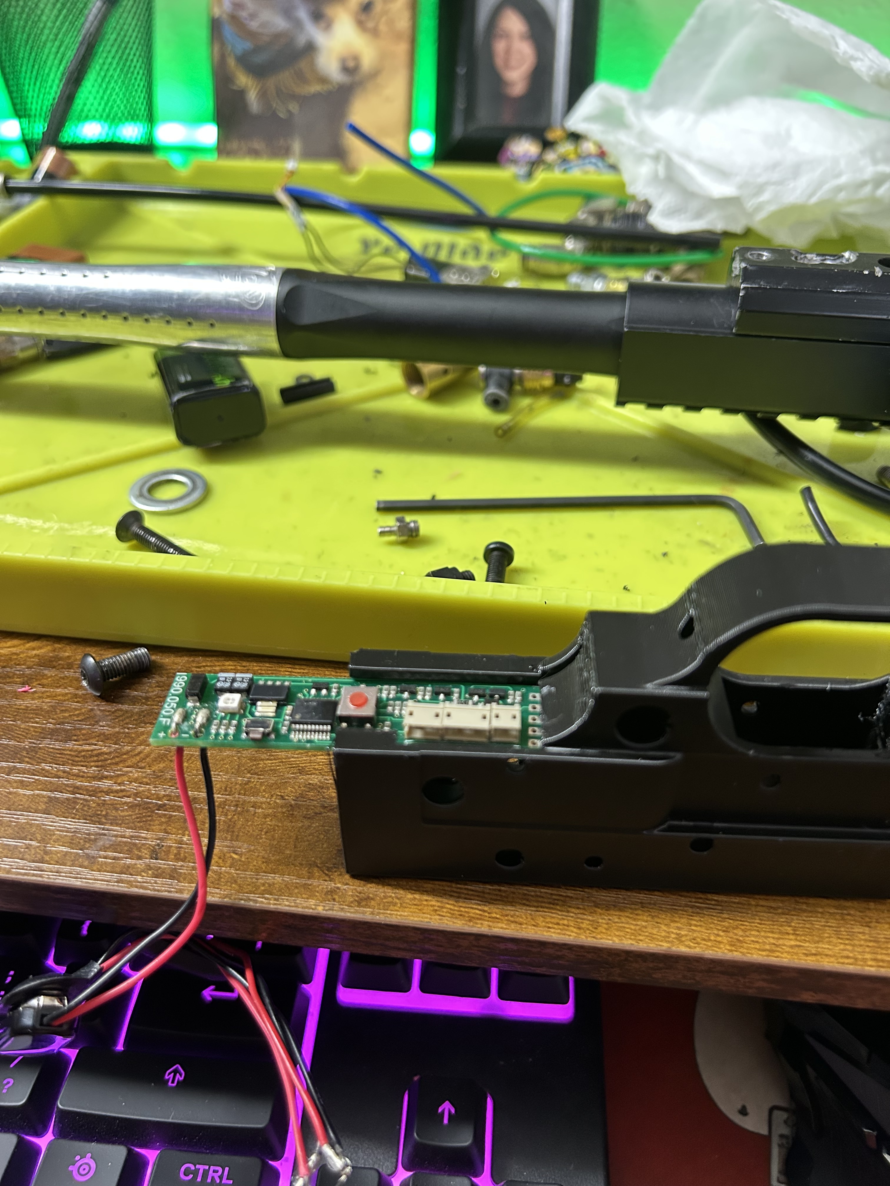

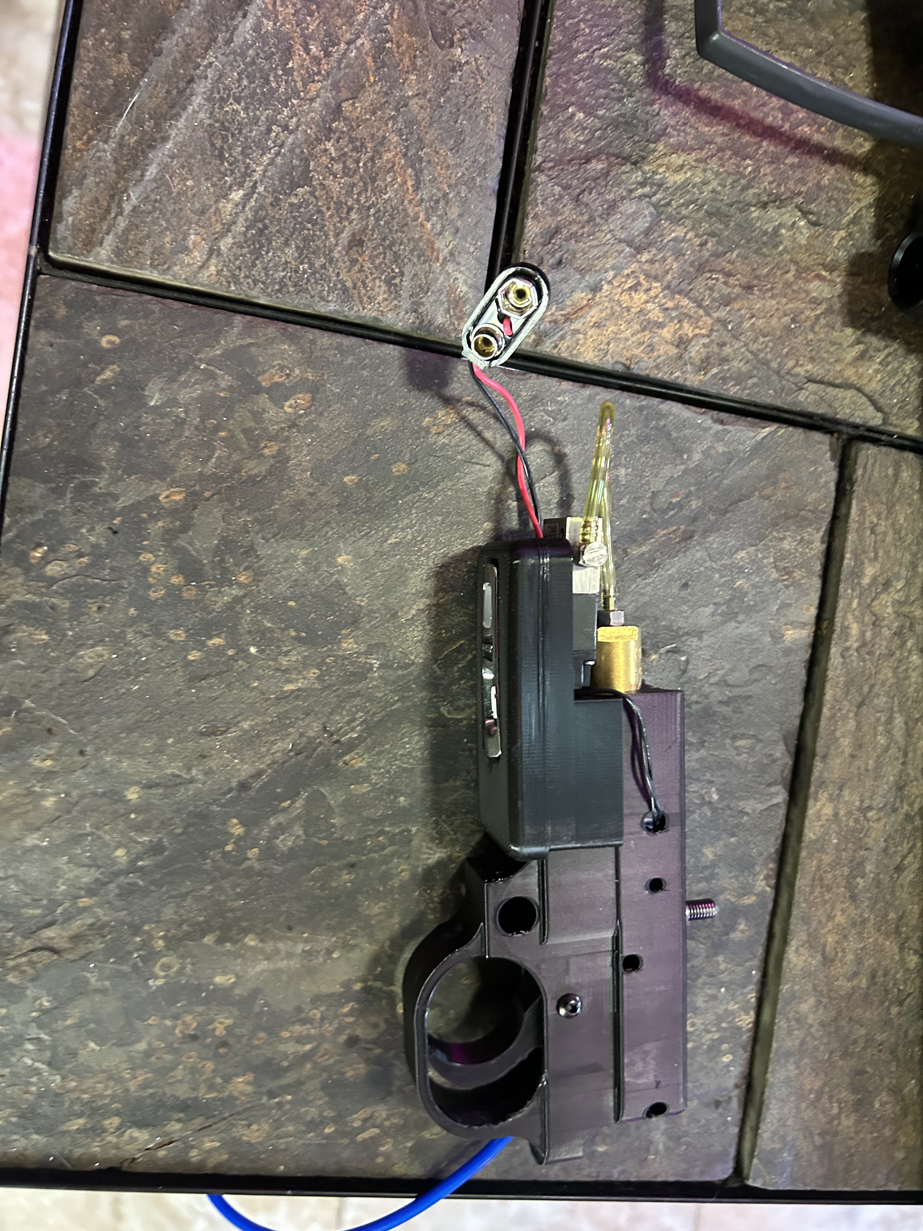

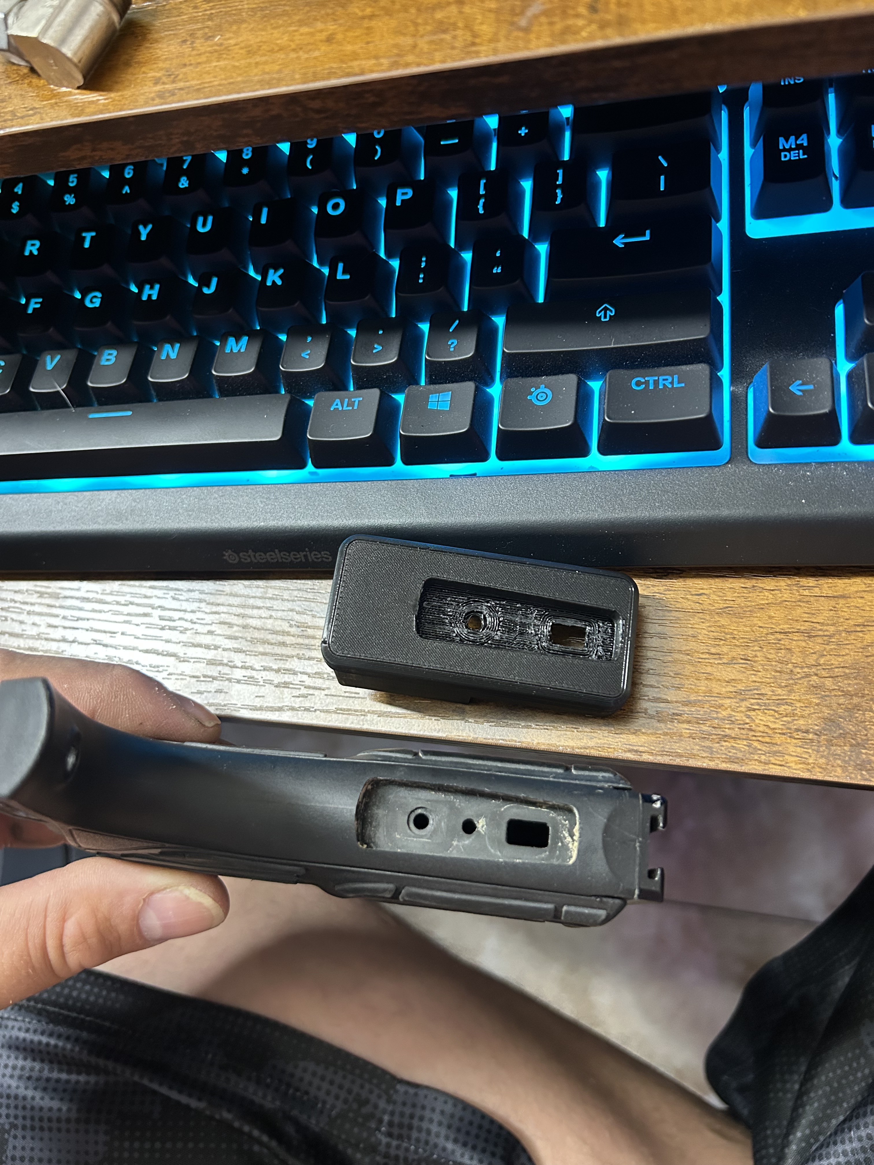

    What I’ve got here is a tac one automag with x valve, set up with an etha board. Board is controlling a mac33 solenoid and a clippard actuator. There was a step file on thingy verse for a dummy trigger housing for a Ruger 10/22, So I uploaded that into fusion360 and made a bunch of modifications to it, so it would hold the trigger switch, the actuator, and the board. Then I designed a cover for the board that I modeled after the back of a planet eclipse, etha grip. I push fit the button housing from the Etha into that so I can turn the board on and program it on the fly. The LPR and macro Line fittings are hidden in the Butt of the stock.
    a few weeks ago there was a guy local selling a Palmer’s blazer on marketplace. Although I wasn’t interested in buying the blazer, I messaged him something like “ A guy with a blazer is bound to have some other cool old-school stuff” I met up with him and bought a never before used Q loader, set up and a few other things. definitely a ton of work into this, but it’ll be fun to play with at scenario events!
