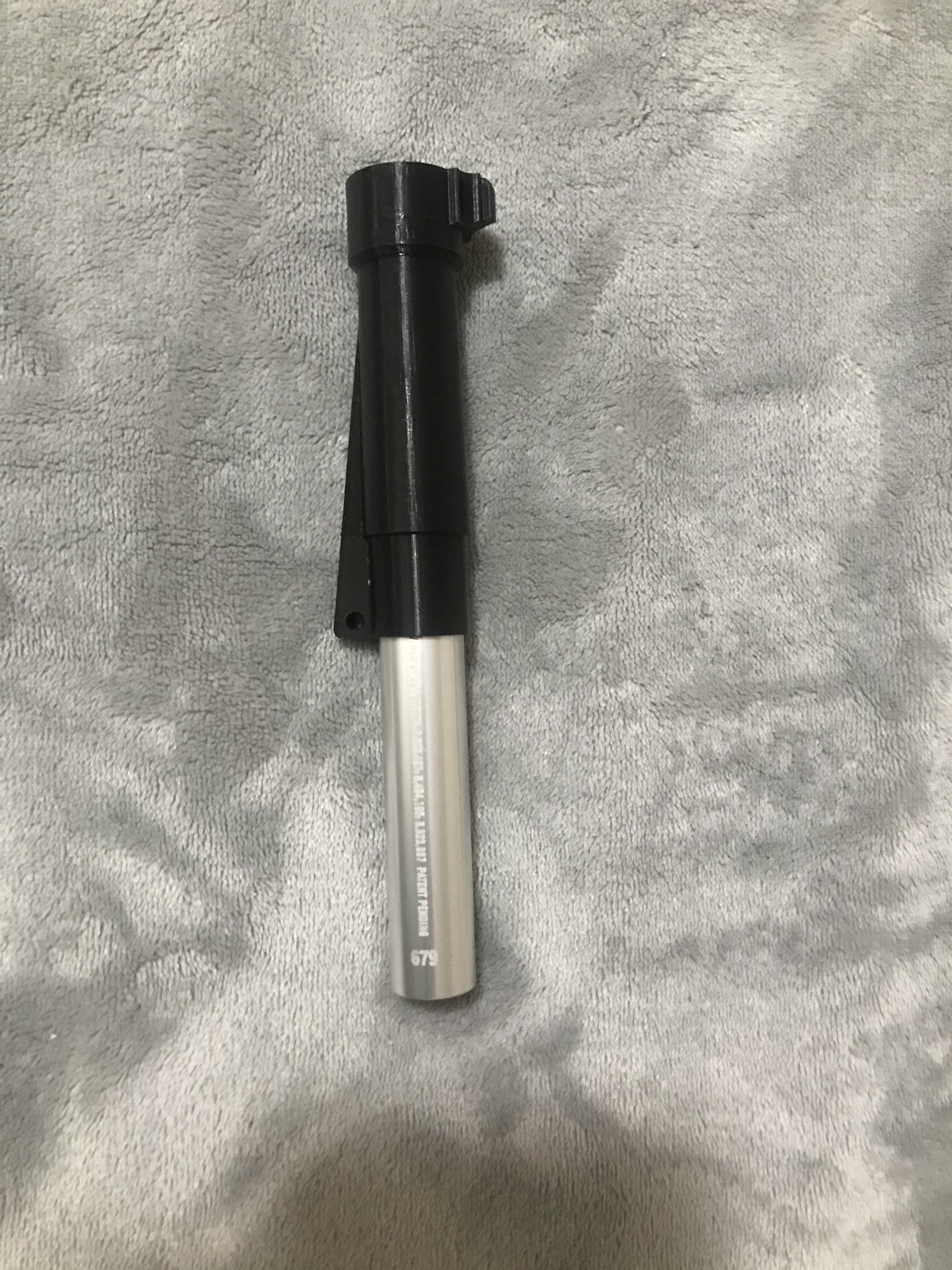

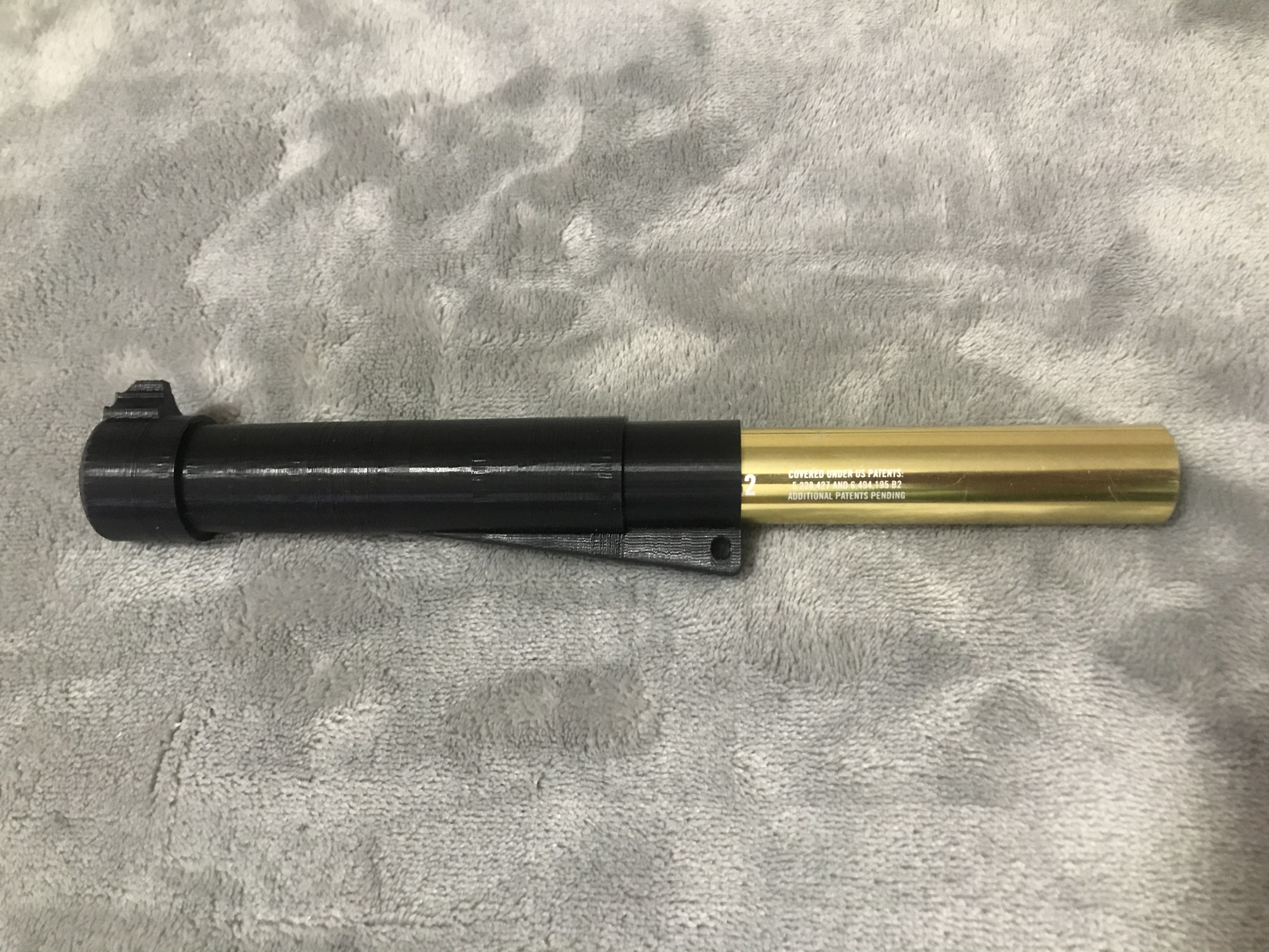

            • AmericanPaintball
              AmericanPaintball commented
              I actually am in the middle of making the freak kits for these, very simple. I have a few options done so far. the standard freak insert is a bit shorter then the stock barrel, so the insert stops about 2-3" short of the end of the barrel.
              I did order the Freak XL insert and now the barrel is about 1.5" longer but the insert goes all the way to the end.
              I also created a short stub, basically removed the barrel tip, and increased the diameter and threaded it to fit the freak front. This actually turned out alot better then I expected, although printing that fine of threads I will be curious how long they hold up. I think they are good but would be leary about putting them for sale, as although if careful you should be fine, you would get someone that would overtighten and strip them out and blame the design.
              I am now working on the Freak XL for the Comp.

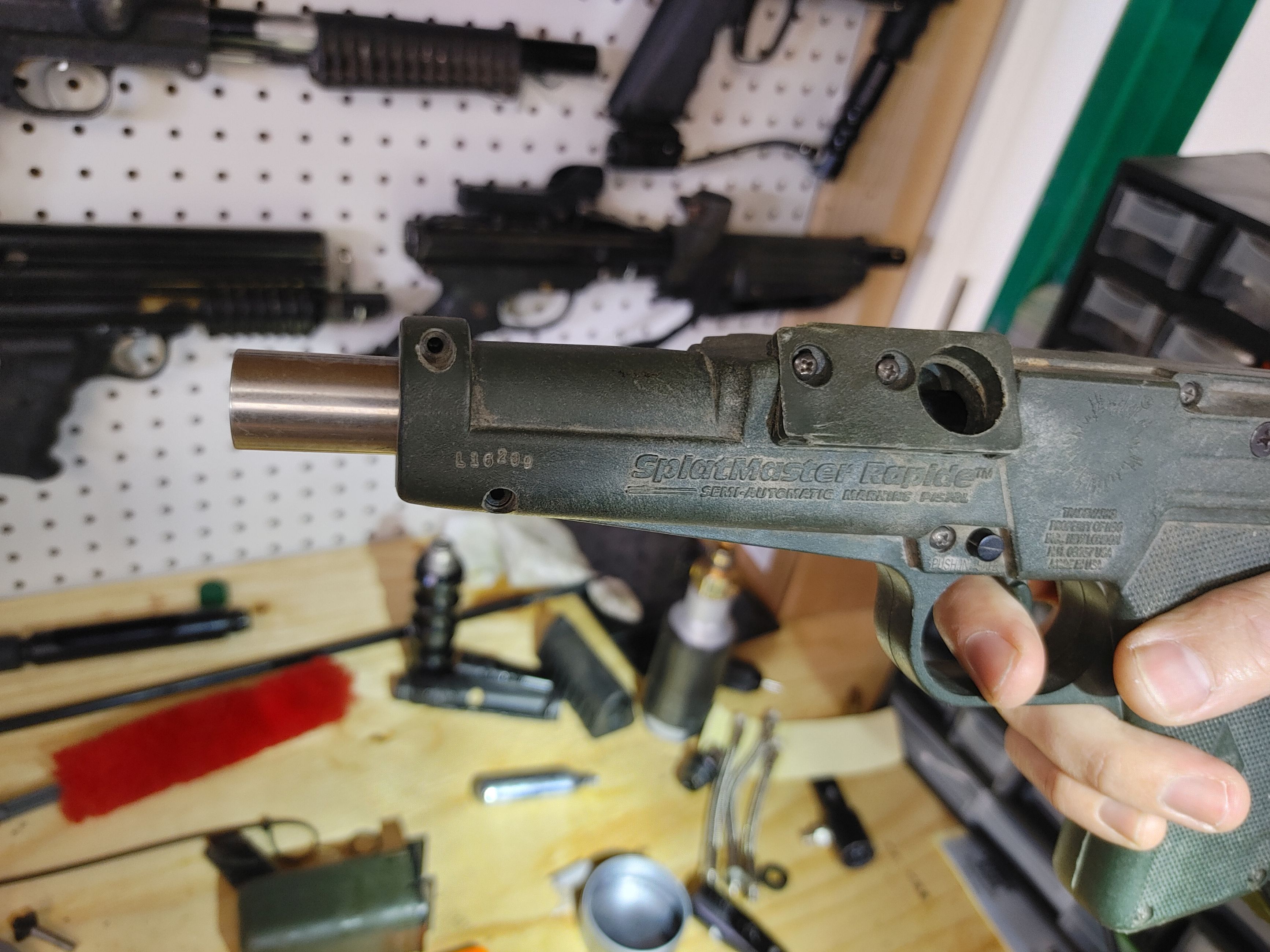

            Originally posted by XEMON
            Ive thought about pulling the brass liner and try to push a freak insert in there, but didnt thought about 3D printing a barrel ... May have to give it a shot ...
            I just tested with a freak insert and it fits perfectly. The bolt enters about 1/4 inch into the freak insert, just like it enters the brass barrel. This freak insert is extremely small bore though I don't remember exactly. I'll check shortly when I take the gun apart again.
            The OD of the freak insert is about 1/8 inch too thin on each side for the shells to hold it in place - this probably wouldn't be the case if I had a plastic barrel shroud.
            I wrapped the barrel with electrical tape until it fit snugly, but a thick spacer / shim would probably be better.
            It feeds / cycles but I have a valve leak so I can't comment on efficiency, velocity, or accuracy.

                • 30
                Here are some of my finished 3D printed freak barrels
