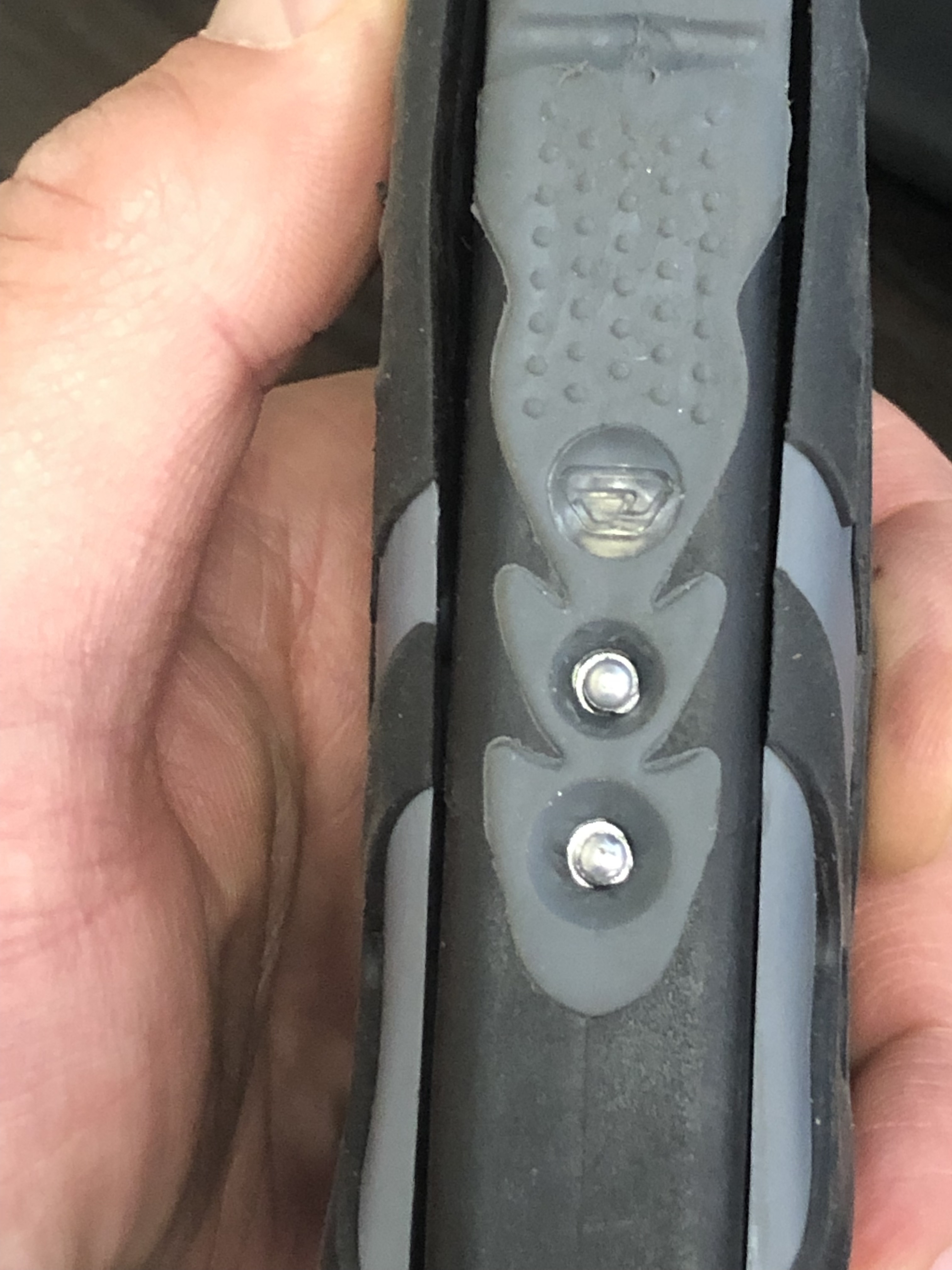

    So you know the buttons on your old 07 or 08 PMR? Of course not, because yours have fallen out somewhere, too.

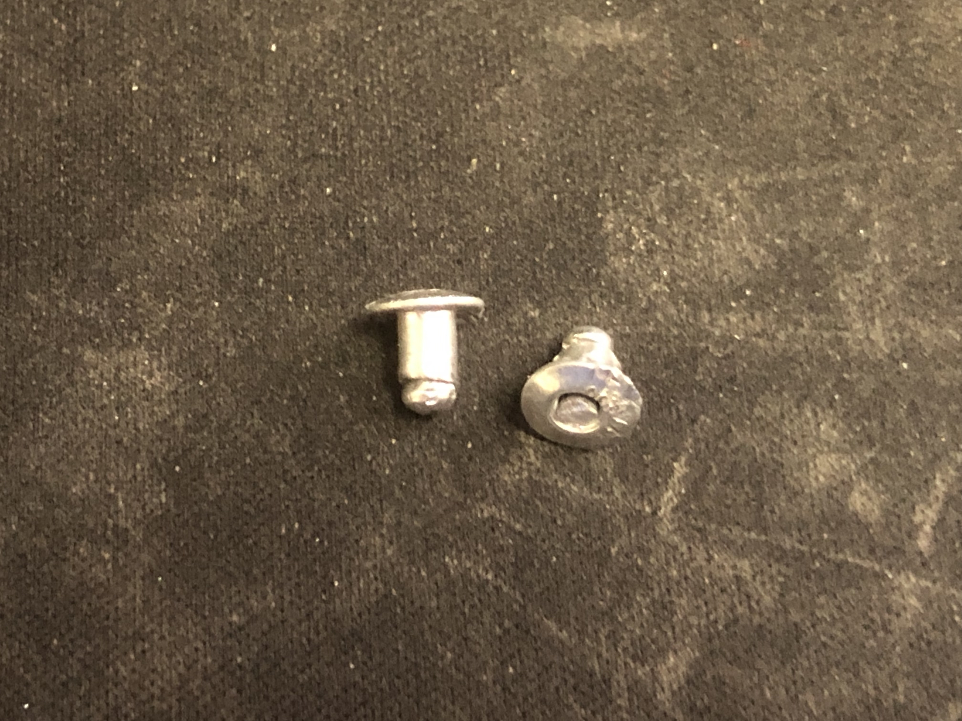

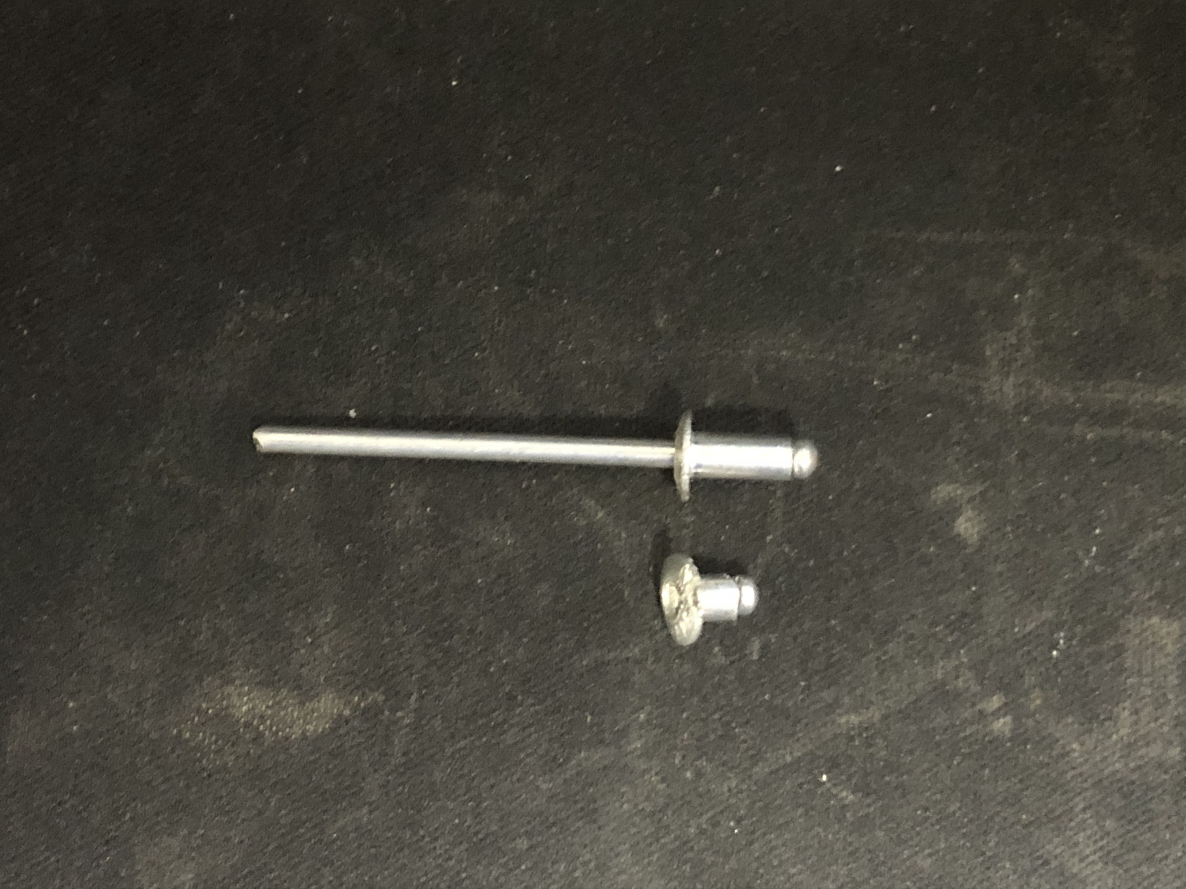

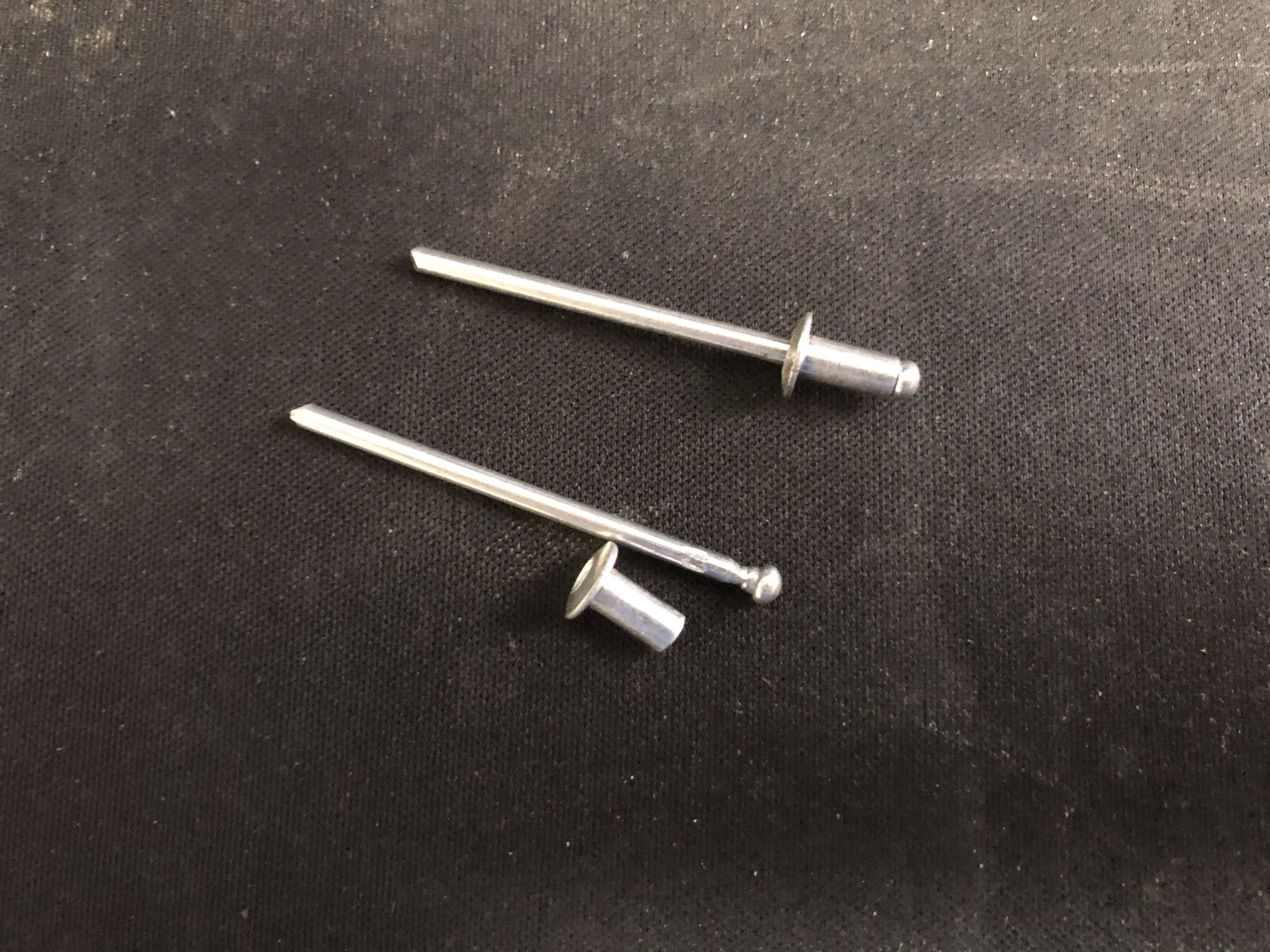

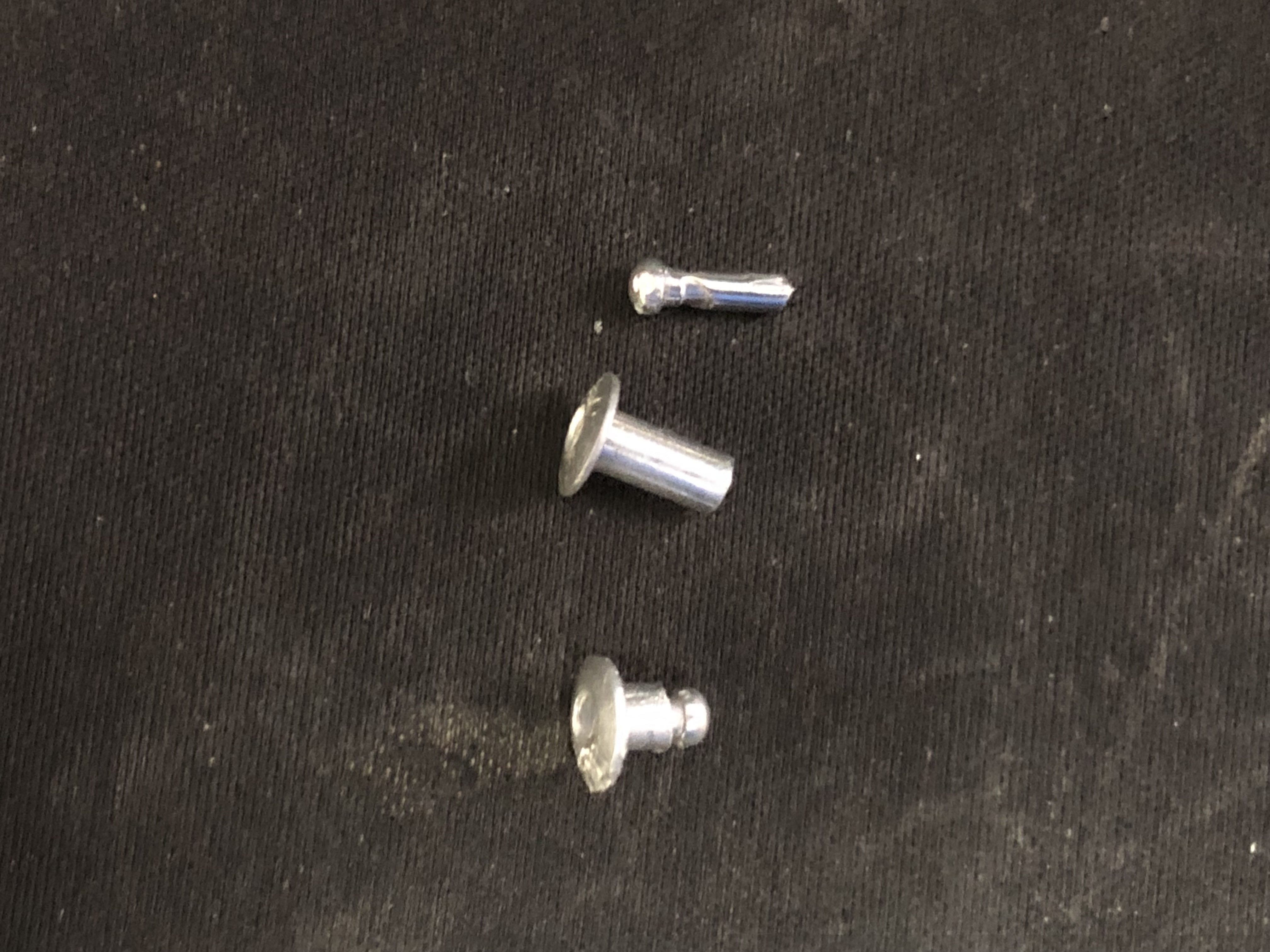

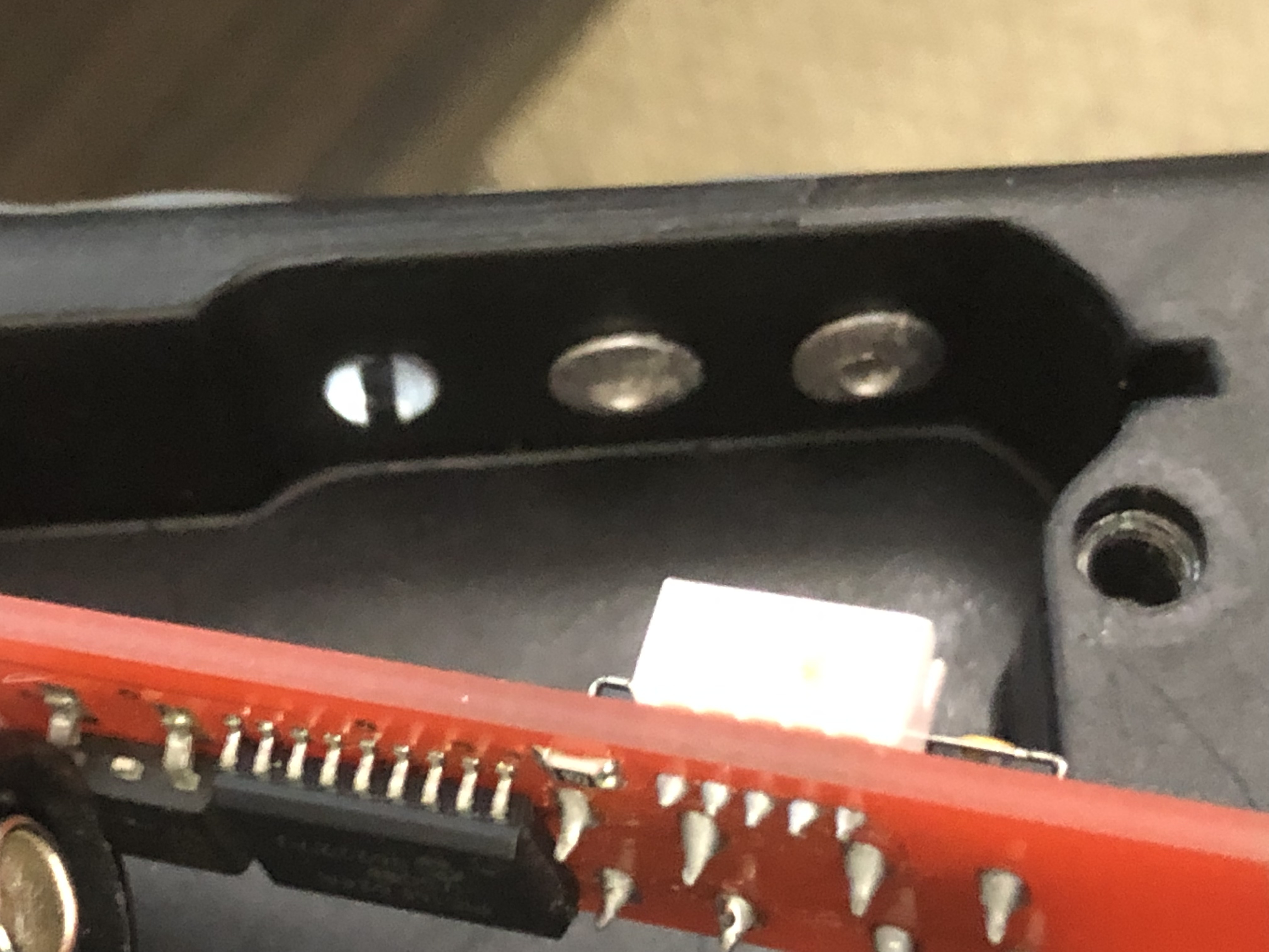

    I got tired of using an allen key to use the board, so I made my own buttons. I found a few small rivets in my tool kit and separated the sleeve from the shaft. Then I ground down the sleeve and shaft to just under 1/4” and pressed them together again, testing the length to ensure I wouldn’t depress the buttons with my palm during intense games.
    Are they custom anodized to match the color scheme of my gun? Nope. But they’re cute, cheap, and they work.
