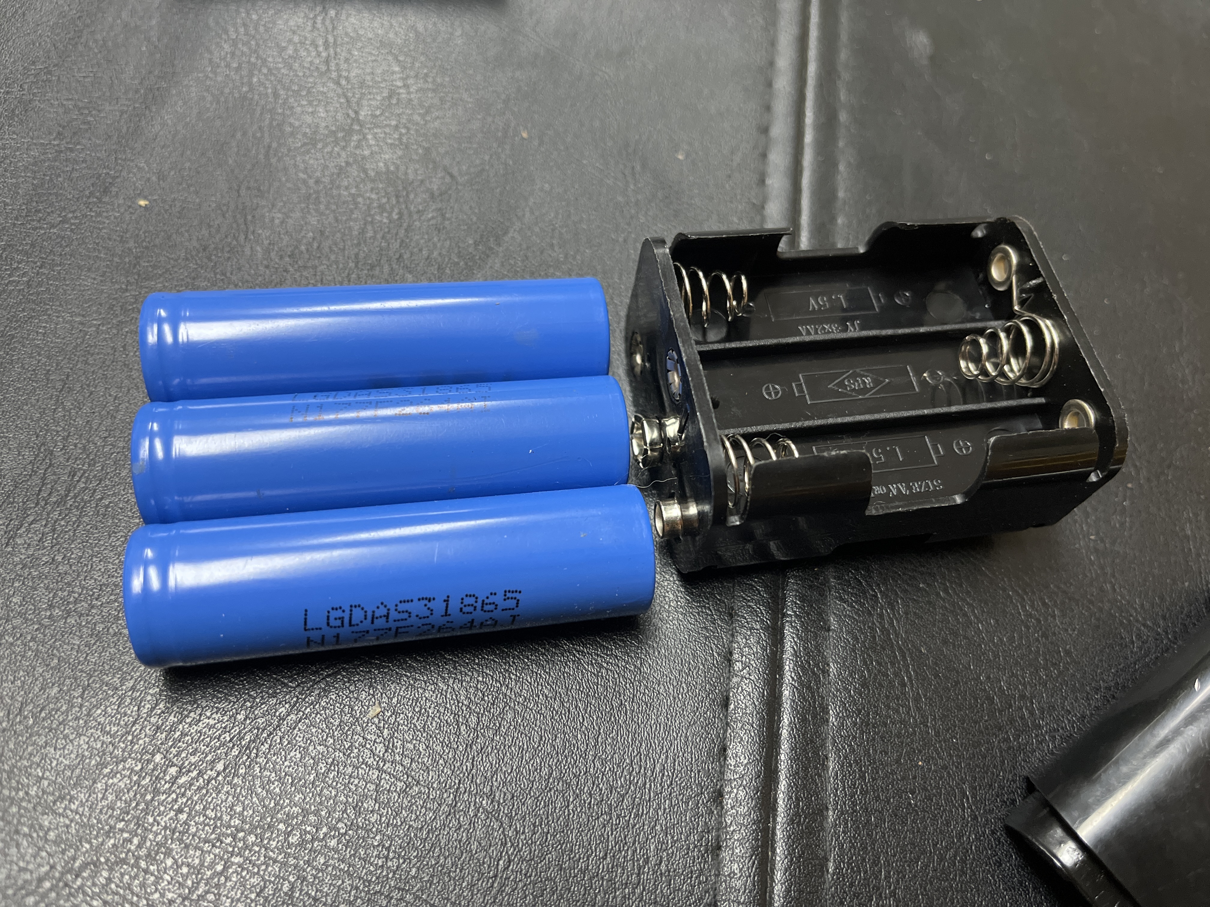

    Months ago I picked up some Halo B loaders (not v35) in a Craigslist purchase. I absolutely loathe the idea of using throwaway batteries and it would seem the Halo does not like being used with 6x 1.2v NiMH rechargeable batteries. Almost right out of the gate I got low battery lights, and it wouldn’t feed.

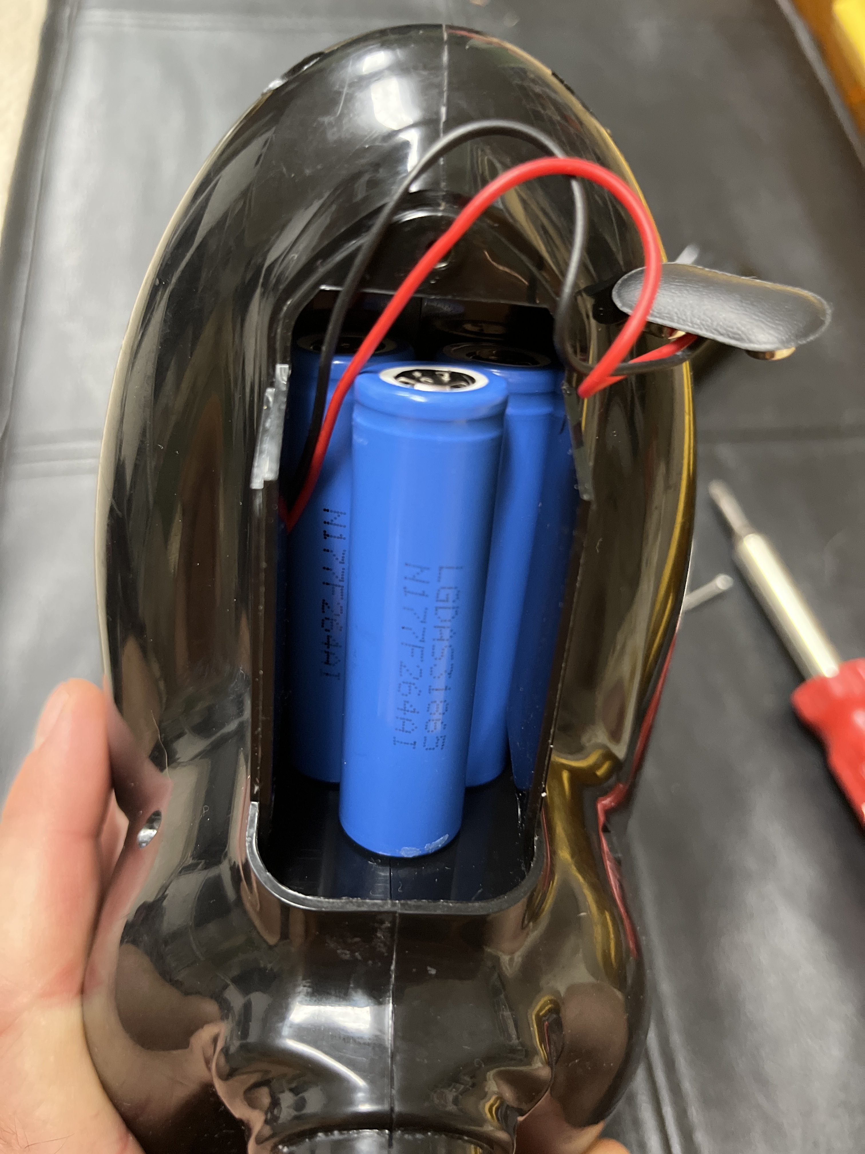

    So I’m looking at another option: I have a crap ton of 18650 batteries pulled from old laptops. Three of them fit with room to spare in the Halo battery compartment, and all I believe is needed would be a regulator that can handle the needed amps to bring the voltage down to 9v from the 11.1v that three of these would output. A 3D printed harness would make battery swaps easier.
    Anyone know of the current draw for the Halo? I have some batteries that were pulled from power tool packs, but they tend to have lower capacity than healthy batteries from laptop packs (which conversely have lower output).
