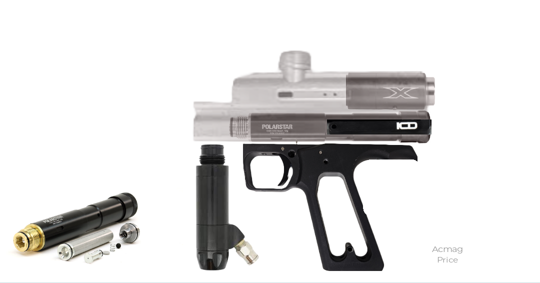

    Prototype of a Co2 operated AC+mag, pneu frame, icd quick change..
    For entertainment only

    Co2 on an Xvalve?
    • Price
      Price commented
      Maybe, using the polarstar apparatus
      ....' it is commonly known that you should not use CO2 to power an HPA engine since if liquid CO2 gets down-stream of the regulator it can cause a spike in pressure which is unsafe and can damage the sensitive components of the engine. So how is it that we're making something like this? Our CO2 inserts are specifically designed to allow you to safety run your HPA engine off of CO2. These inserts feature an integral expansion chamber, anti-siphon system, 5 micron filter and check valve to prevent liquid CO2 from entering the regulator regardless of the rifle's or air rig's orientation. As an added benefit, the internal check valve also prevents gases from escaping the expansion chamber ..'
    • Toestr
      Toestr commented
      The CO2 condenses in rt mags because the flow rate is so high through such small passages. Not sure there's anything that could prevent that.
    • Shane-O
      Shane-O commented
      Toestr, thats not really a problem, the real issue is the RT valve actually warms up as you shoot a string. So it will raise velocity (on HPA) as you are shooting it. So with Co2 it can increase the pressure even more due to Co2 properties. In a pump configuration, it will work fine, best bet is to use a reg and cut the Co2 tank pressure down to 550psi or so. at that pressure Co2 has a hard time staying liquid, at ambiant temp.

      I know you said it was for entertainment.
      first thing I see is adding a lot more weight to an automag when most want to shave it down. Even cocker guys trynb for slimmer body.
      the other, aren't most fields, markers and players using air. Only ones I see using co2 are stock class players and outlaw fields.
