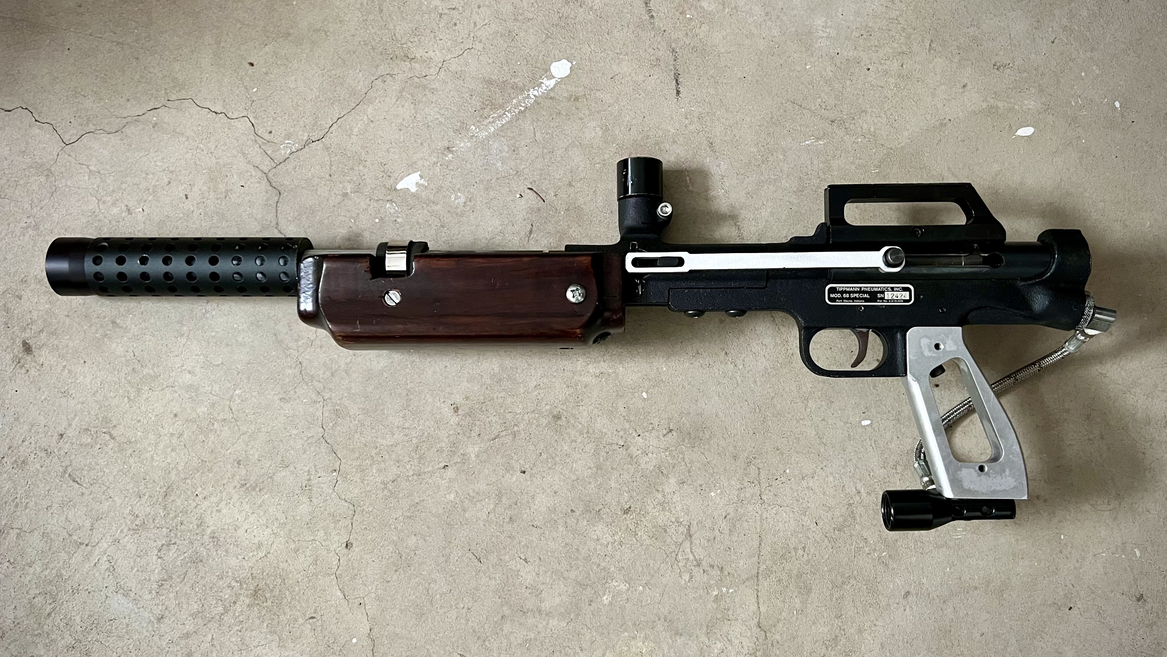

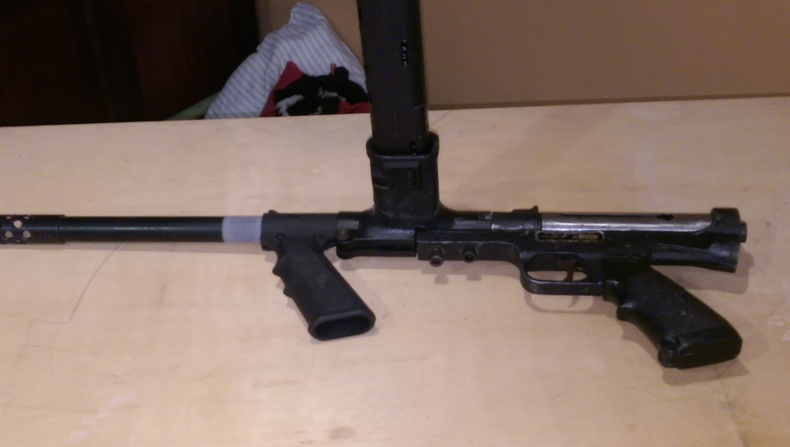

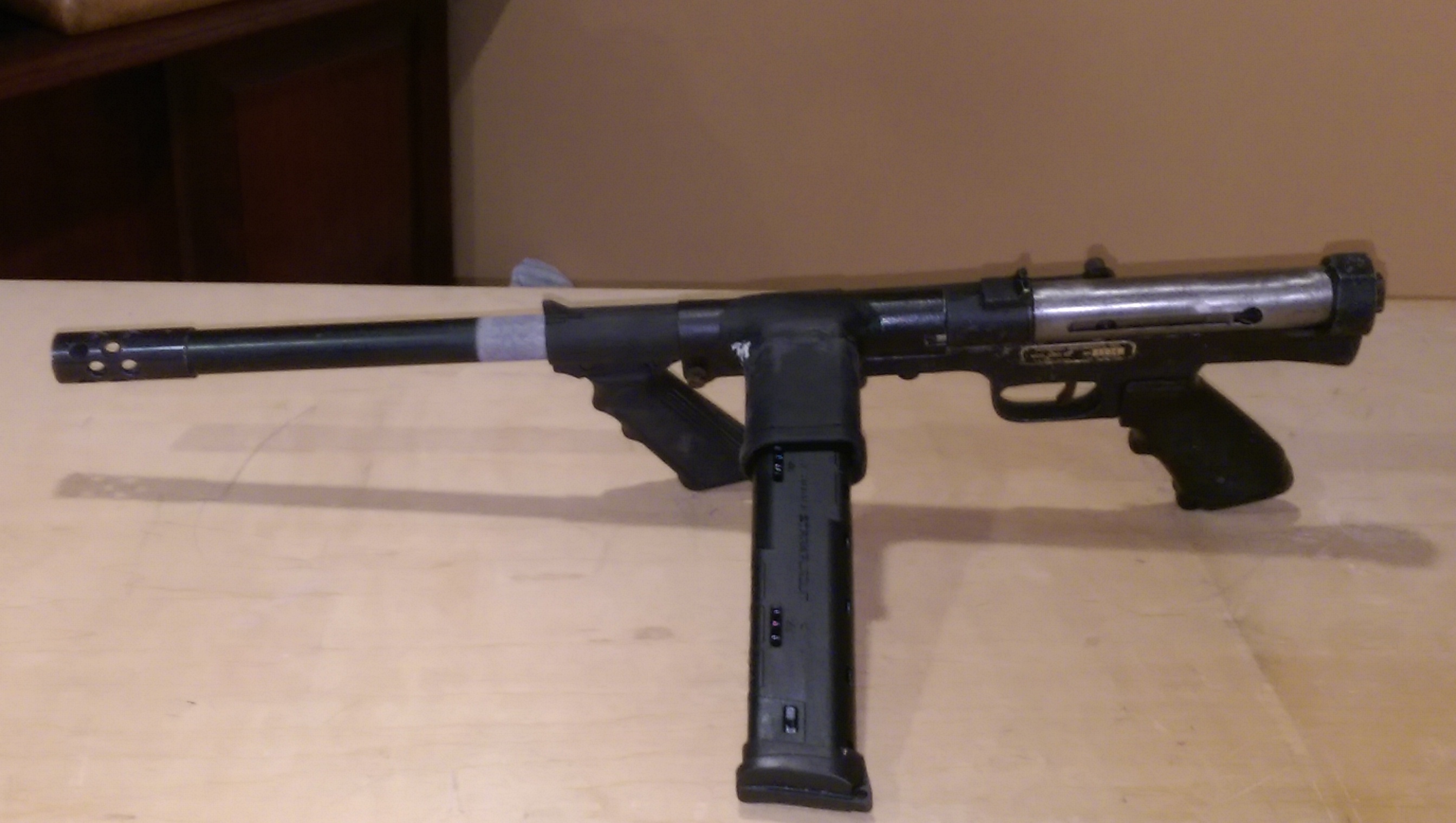

      I reverted a 68 special back to an SMG 68 using TiPX magazines instead of the plastic clips. If bulk CO2 is hard to access, the HPA conversion becomes absolutely necessary. Making yours bottom feed will be easier than a left side feed. I was working with Ty on a replacement 3D printed front with the integral magwell. We had some issue with the 3D printed plastic holding up to the impact of the gun function. I would love to see what you come up with.

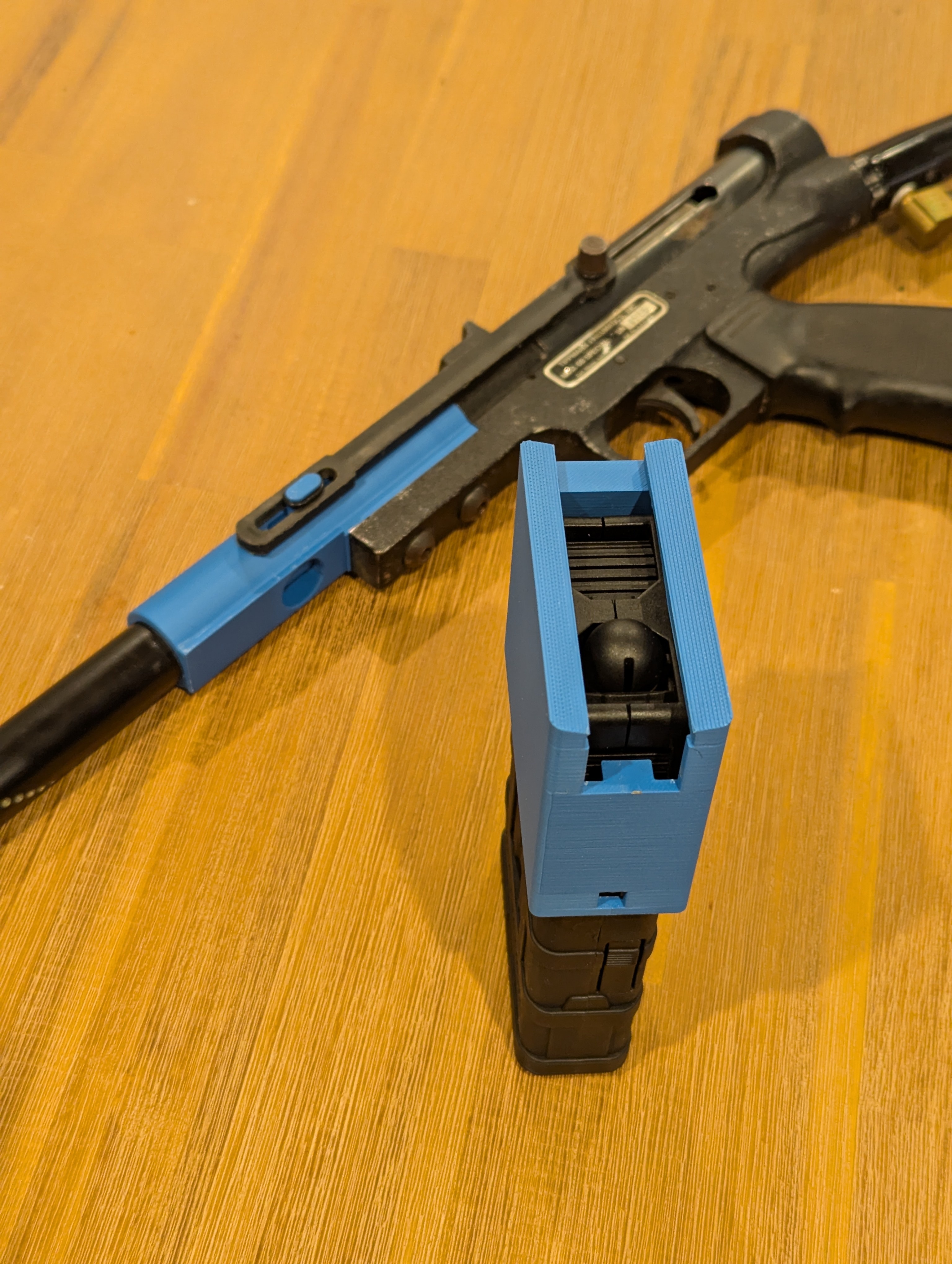

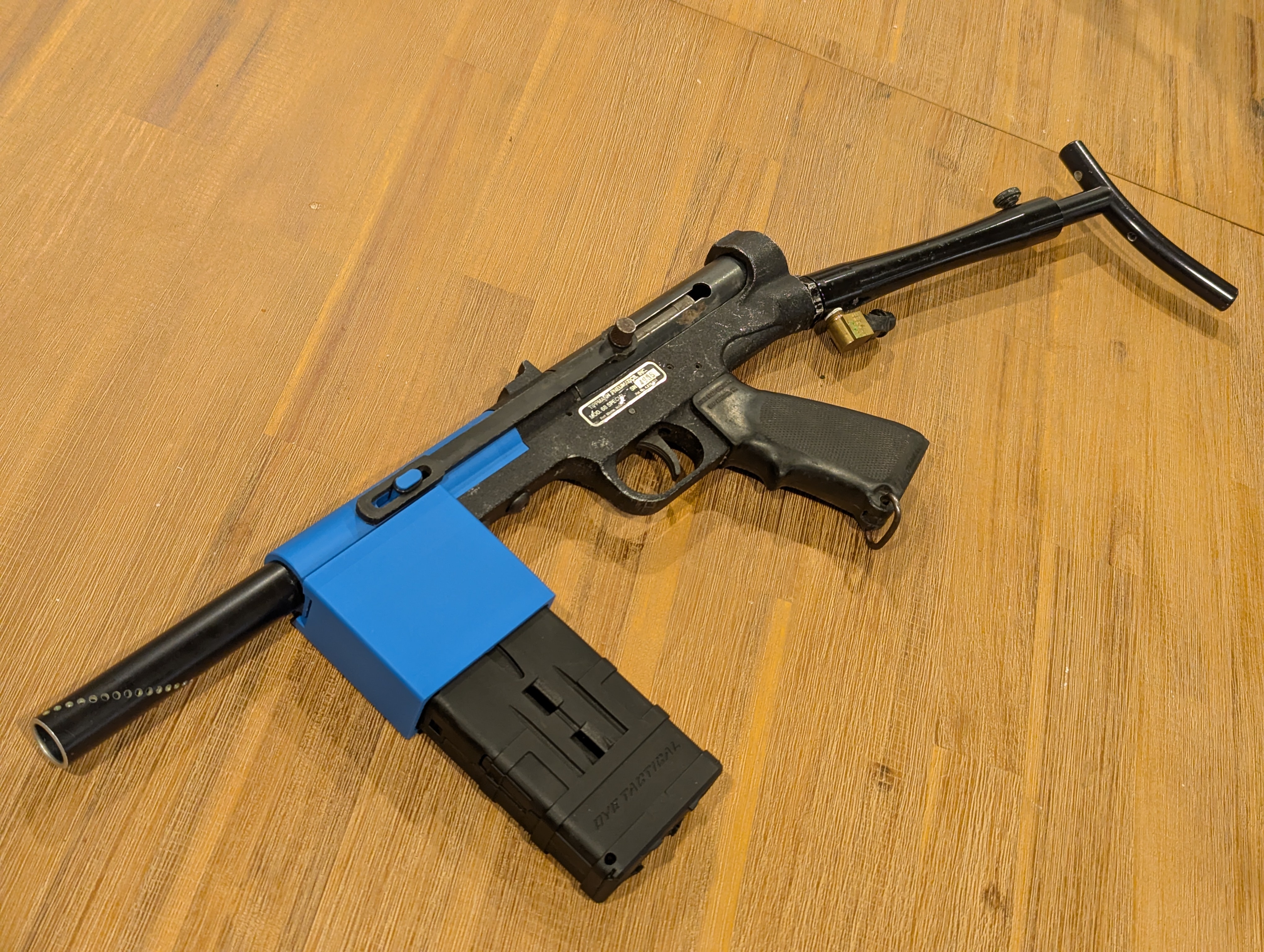

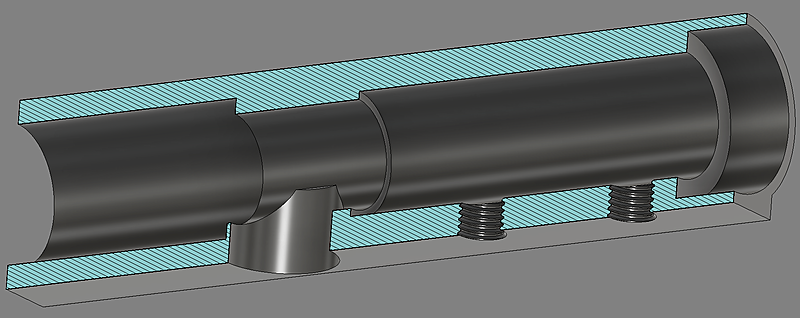

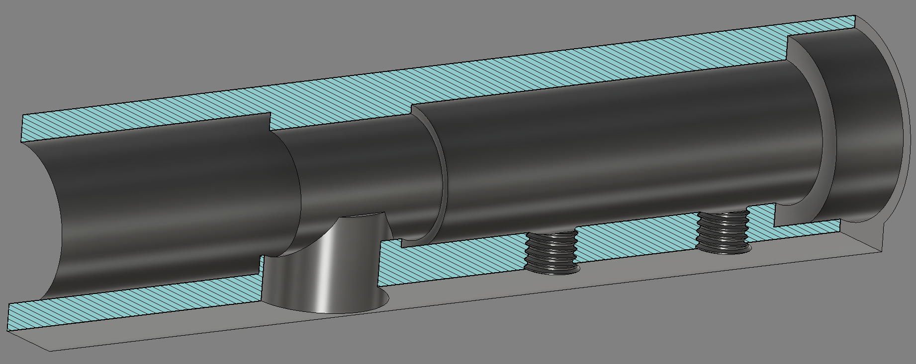

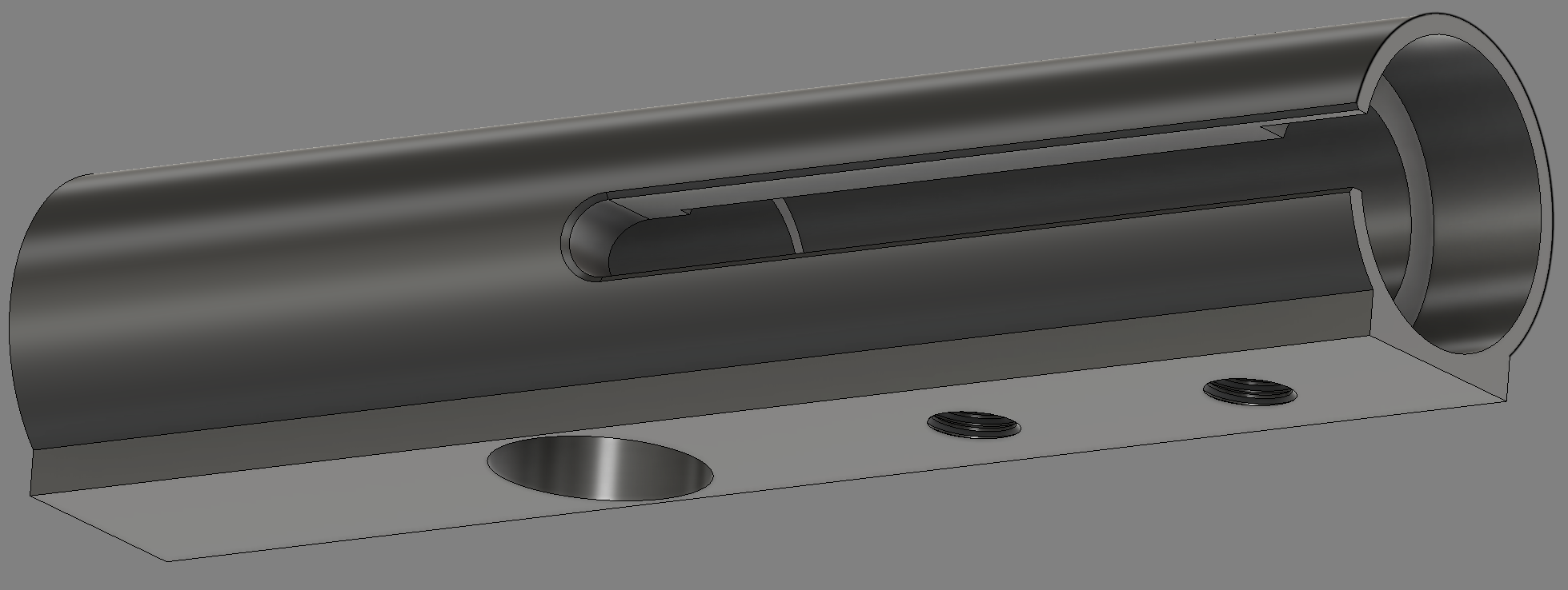

        Here's the first cut testing out some critical dimensions. Need to open up a couple bores a little larger, but importantly, the mag well opening seems to be in a good spot, and the screw spacing is correct. This is essentially just a cylinder with a rectangular base added. I'm considering turning that upper part out of aluminum, as it contains the mounting bolt threads and carries all the valve impact load, and then using a plastic spacer underneath similar to cocker to Sheridan frame adapters. The only question about that mixed material rail interface would be whether you actually get decent clamping force, or if it'll just slide around under there due to low stiffness, resulting in the two bolts taking all the cyclic loading in shear, which could work in the short term but might cause weird issues and failure later on. Could also potentially use brass and solder or alumaweld sticks...in which case I'd make the rail out of the same material and braze/solder it on.
        I'm not liking the step up/down that the bolt has to go through. Assumption was that I'd have to turn down the front 3/4 of the bolt. A printed bolt might actually work just fine here, as I don't think forces are very high what with the floppy noodle plastic cocking arm. That would let me run a single diameter bore the whole way and prevent possible hang ups as it moves through.
        That leaves developing magwell dimensions and figuring out how to attach it. Could either integrate it with the plastic rail, or bolt directly to the upper, which seems more robust from gut feel.
        Side note: The fact that Fusion's modeled 5/16-24 threads actually came out usable blew my mind...printers are so much better than they were when I first got into the hobby 12+ years ago.

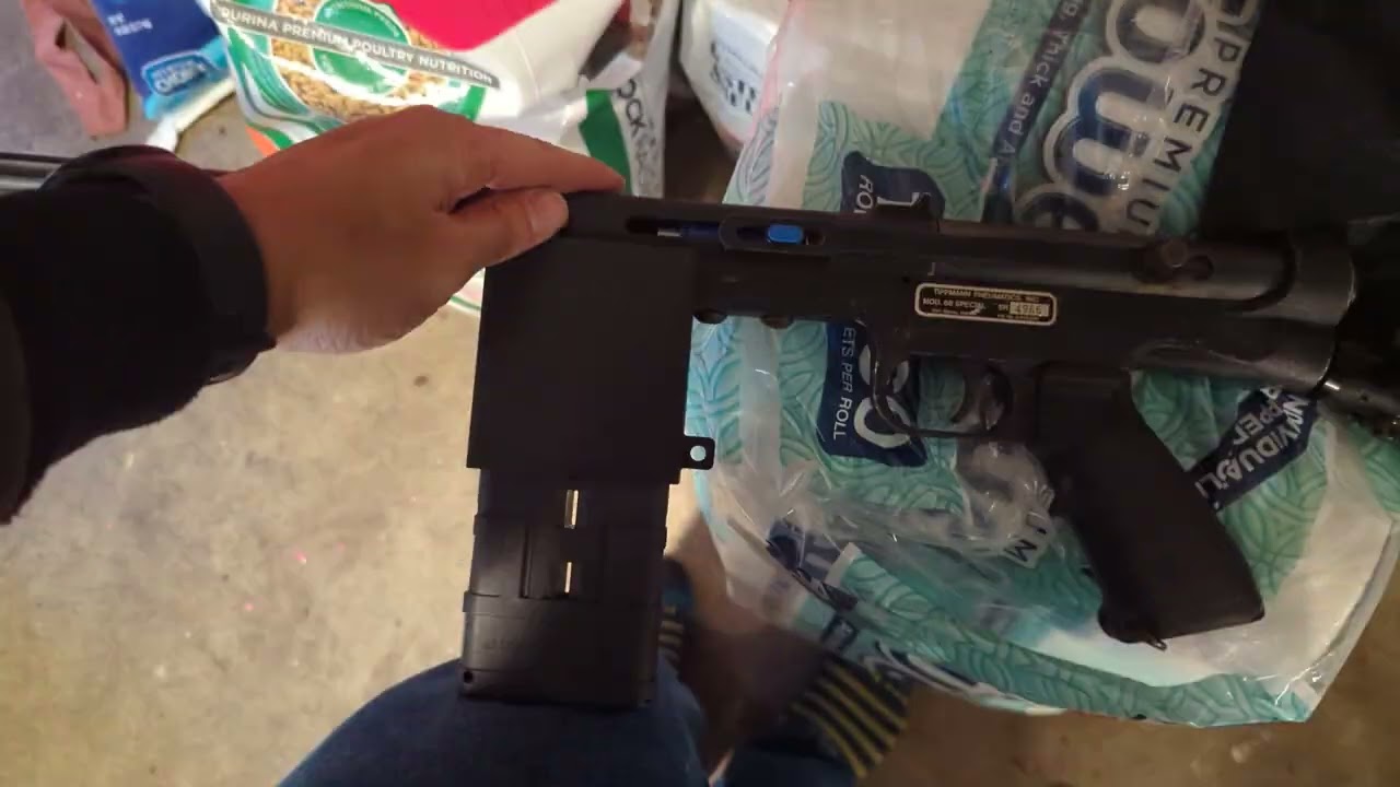

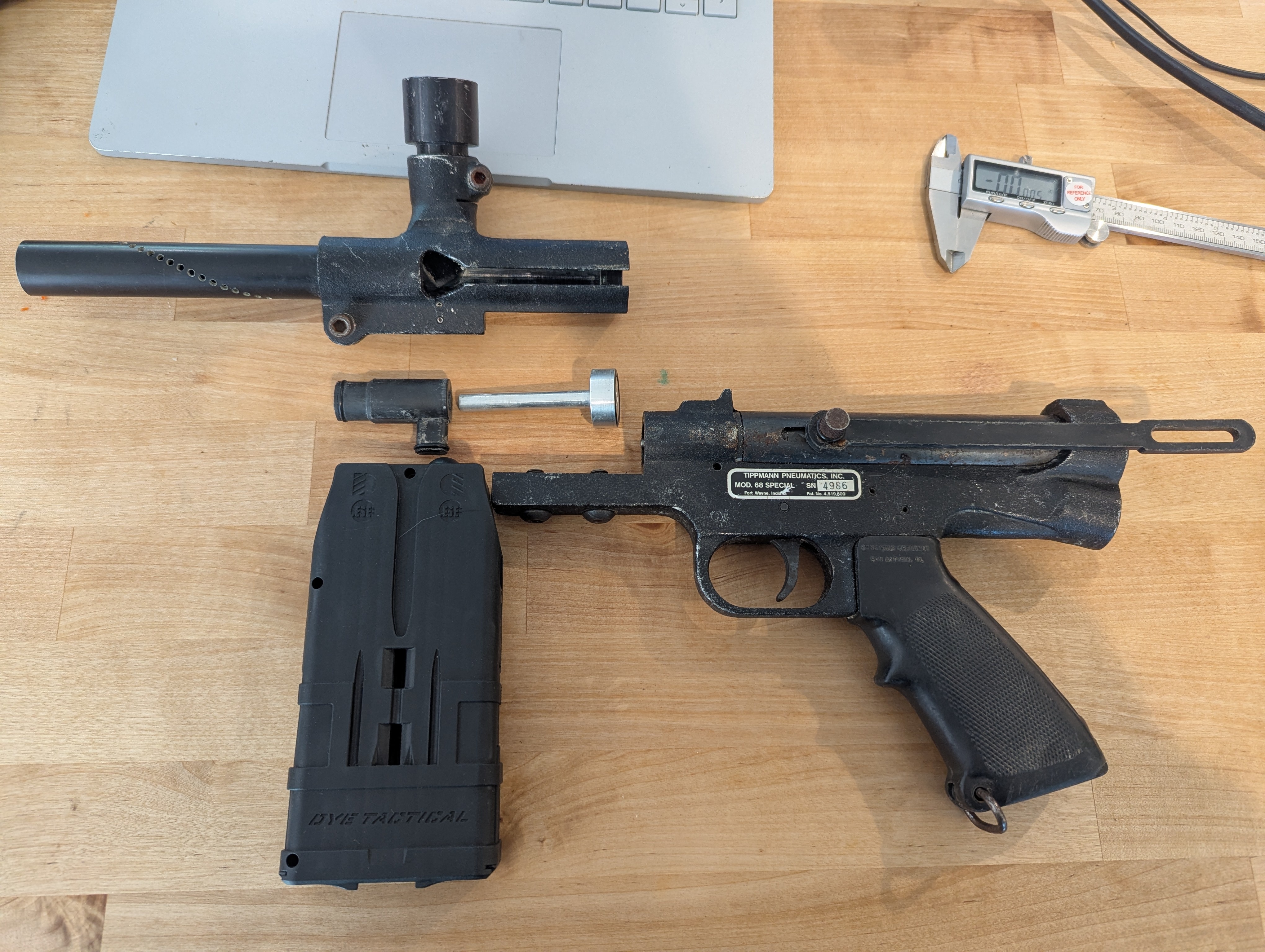

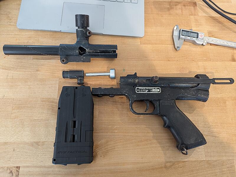

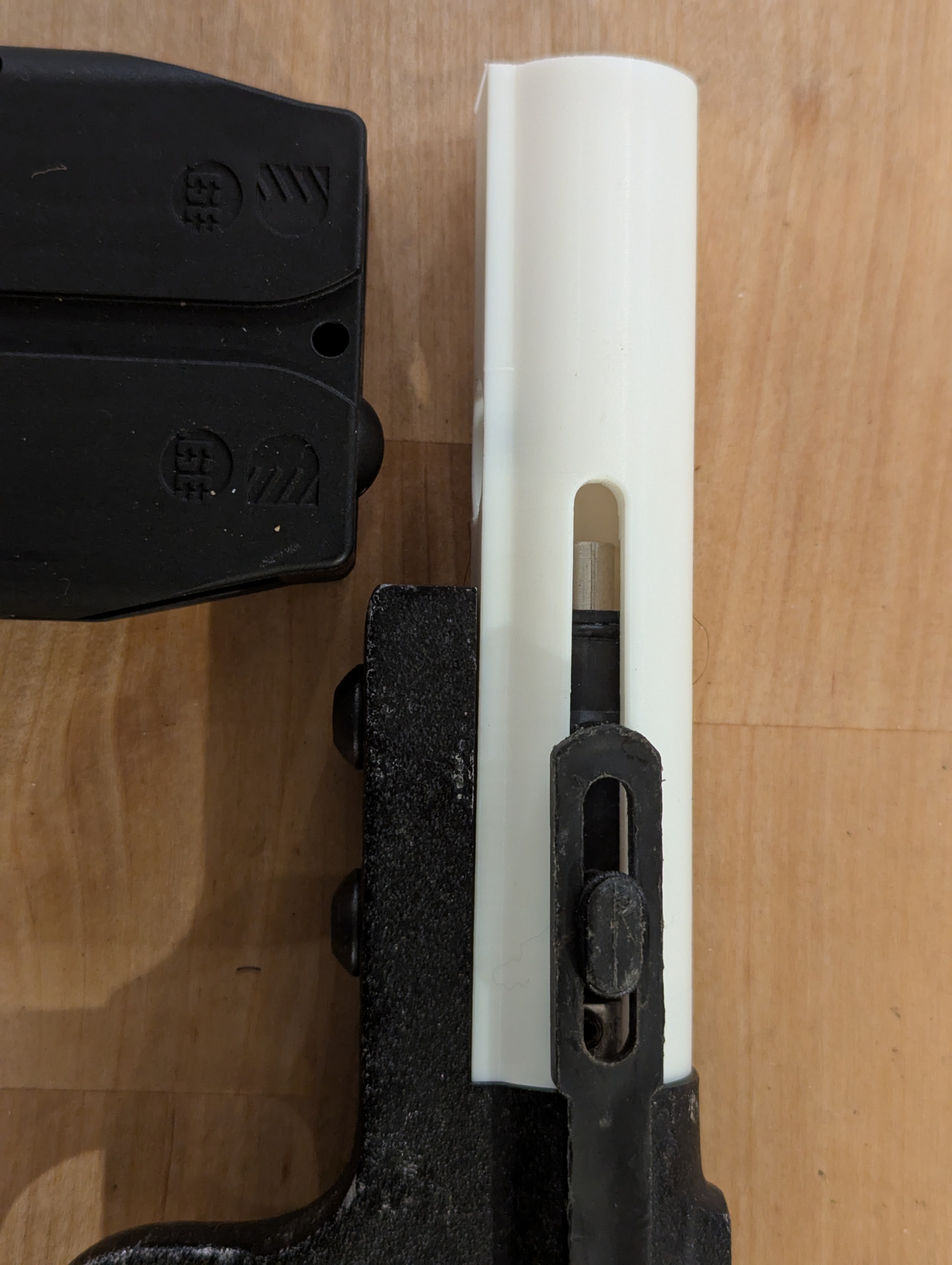

          Body geometry is pretty close, but needs a barrel retention mechanism and a little more inner diameter clearance for the bolt. I'm on magwell attempt #2. Needs a couple tweaks and a release lever. The two parts are separate right now while I dial in magwell placement, and then I'll try printing a one-piece body with magwell.

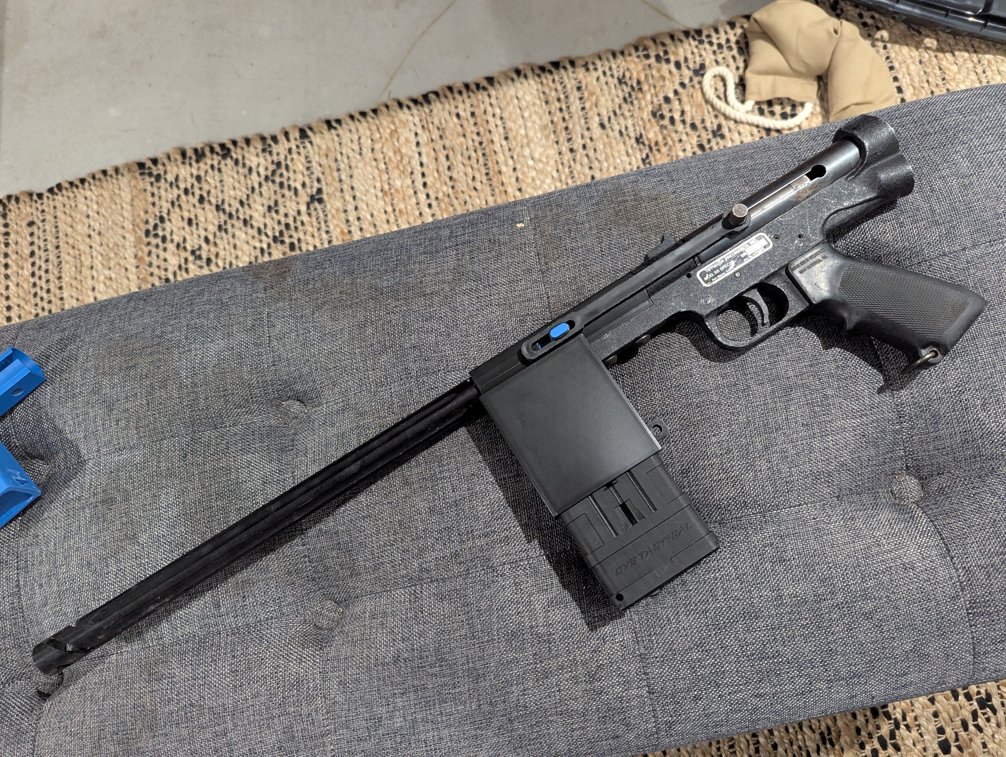

              Here's the prototype shooting, albeit in bolt action form. Probably a combo of the bolt being a little too tight, and the modern HPA bottle. I'll have to see if I can find my siphon 7oz.
              The barrel is a slip fit, there's no detent yet, and the mag release still needs a lever, BUT IT SHOOTS!
