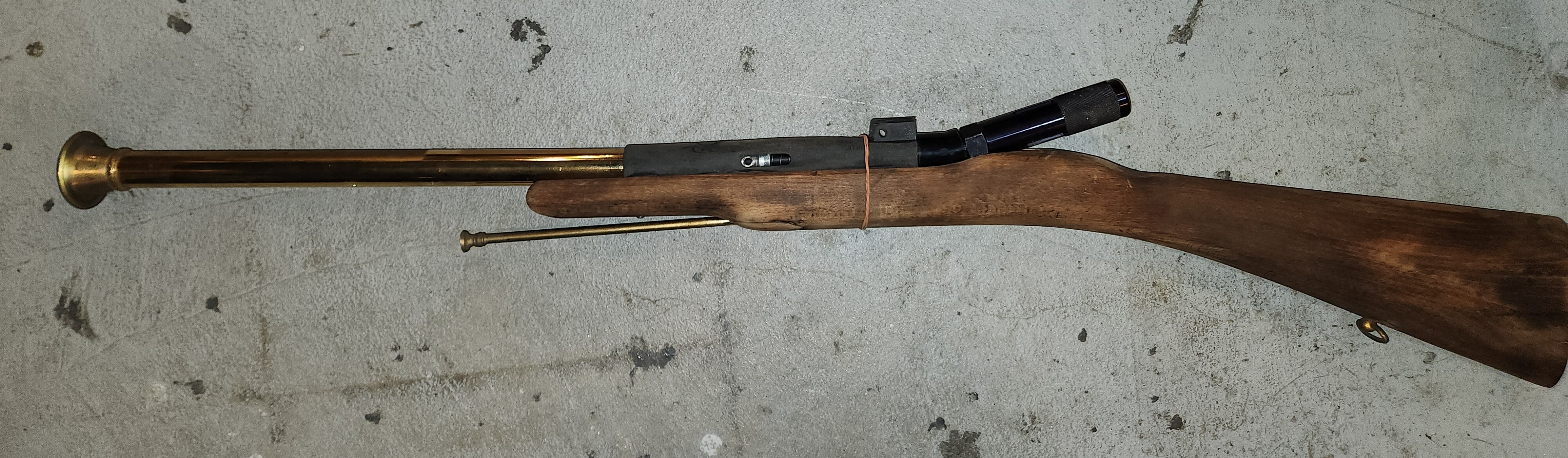

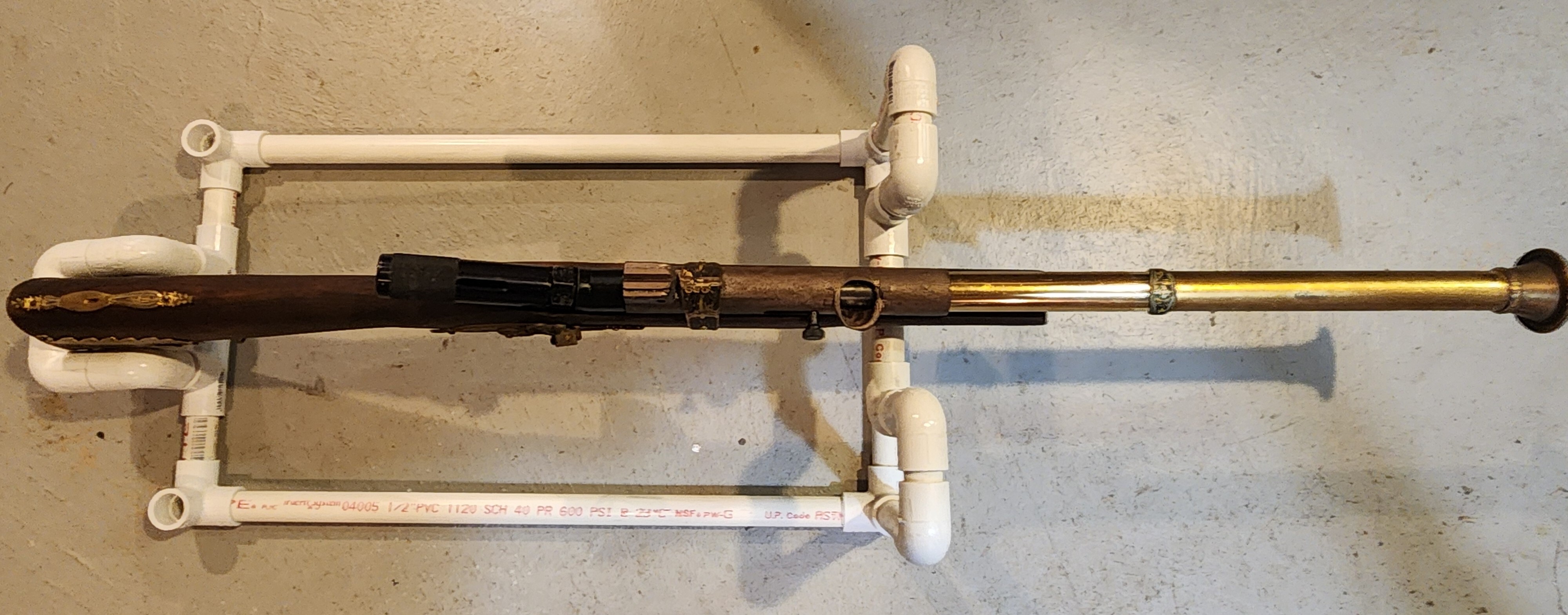

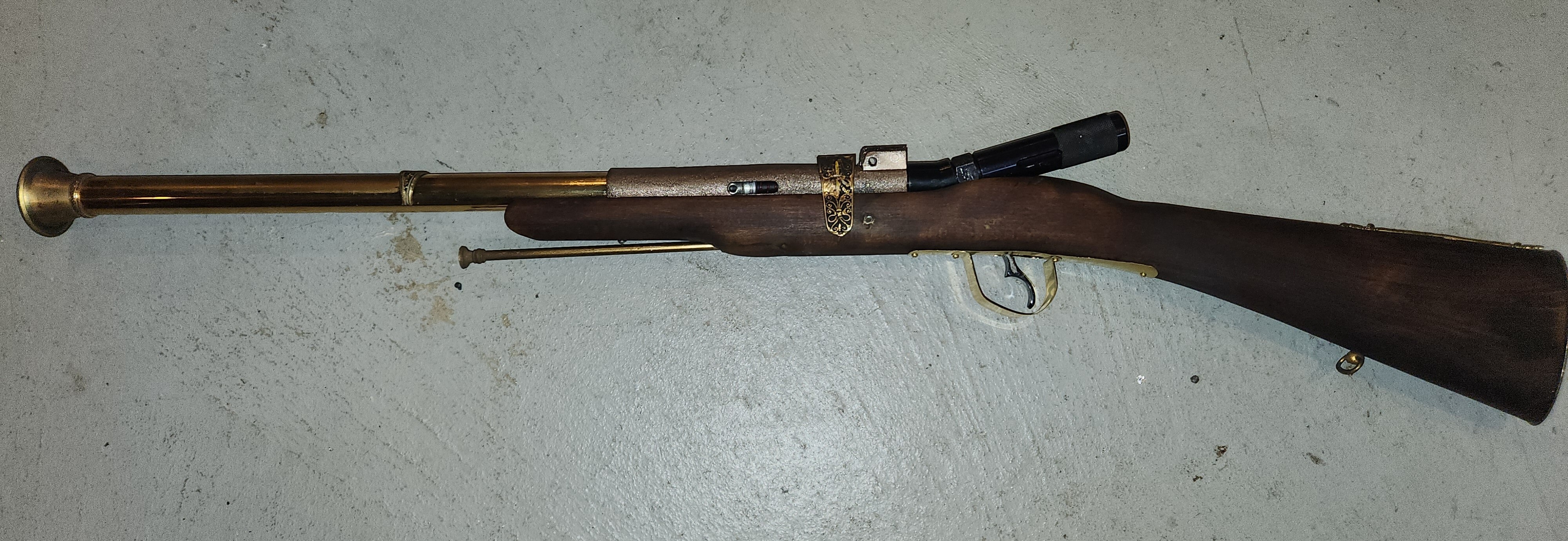

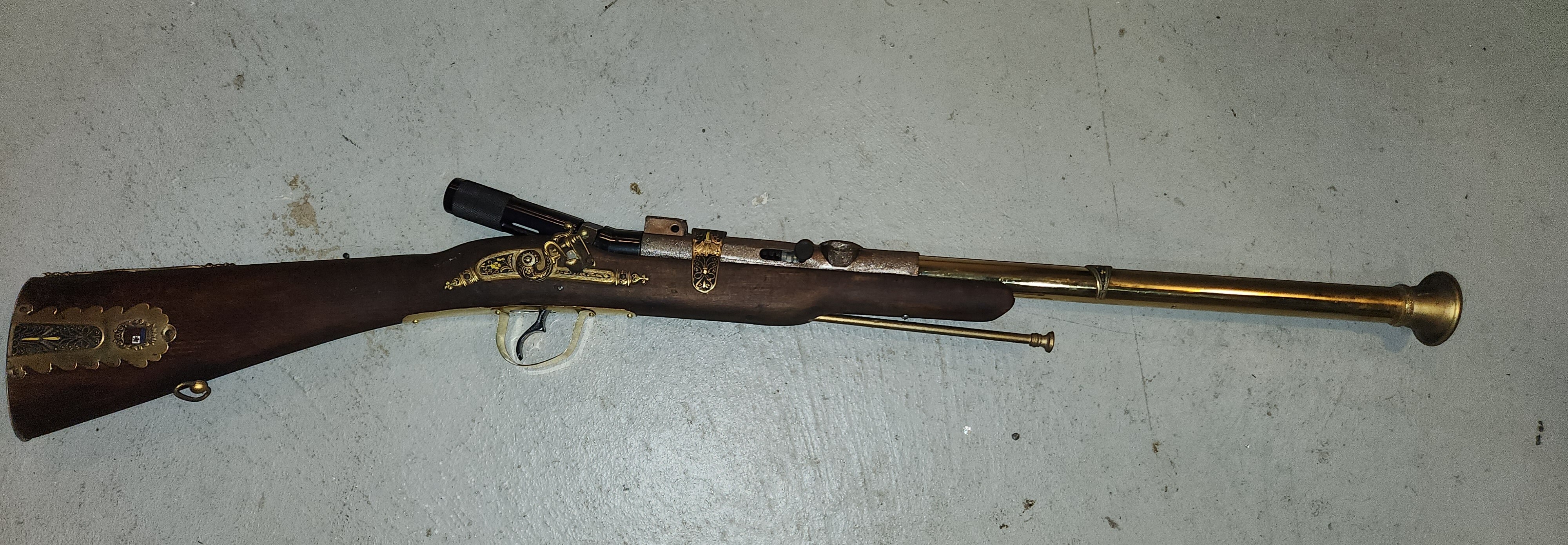

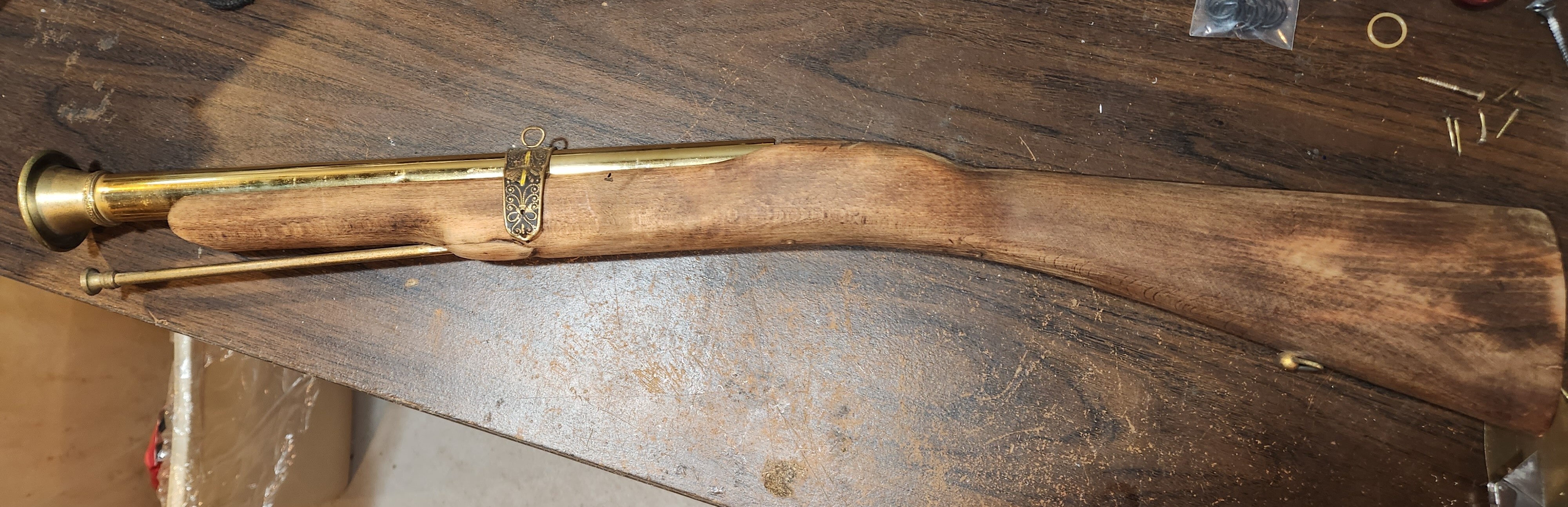

    I found this blunderbuss wall art on Shopgoodwill.com and then the voices in my head started telling me to buy it. Then the voices told me to make it into a functioning paintball blunderbuss. My lack of good judgement and self-control decided to listen to those voices. So here we are. This hopefully will be a nifty Blunderbuss and not just a colossal Blunder and total Bust.

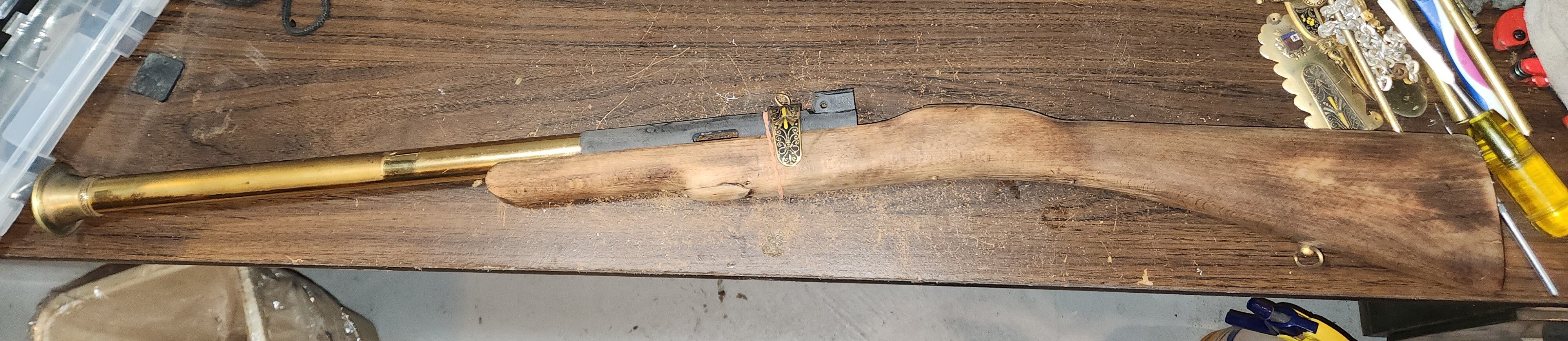

    I began with removing all of the trim and the barrel. Then I modified a Tiger Shark upper body. Modified the ASA back and flipped it upside down. Notched the stock to secure the upper body. Created a tighter bore inner barrel, threaded it to match the Tiger Shark body. The brass barrel slides over the new inner barrel.
    Thats the start. Next up is create a trigger system. Then stain the wood and reinstall the decorative trim. Create a new trigger guard. And finally, test it.
    Pic 1,2 are of the original wall art design
    Pic 3 is first step in layout
    Pic 4 is marker mark up, less the trigger

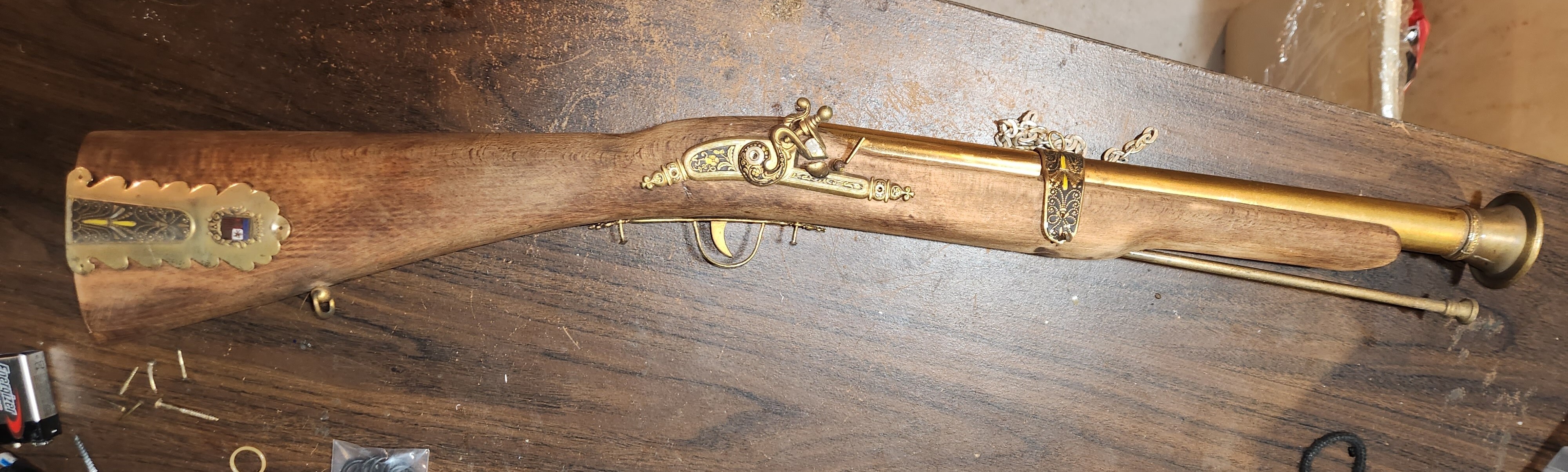

    Well, it is done. This is a completely ridiculous and highly inefficient marker. Obviously, this was not intended for speed ball or any game in which you plan to run the field. It's perfectly suited for the truly special people who love to field bazar markers. It also fits in with pump games. The trim and embellishments are from the original wall art. The Trigger guard is my own handy work. The trigger is a modified double trigger that I bought from Ebay. The stock was modified to allow for the 12-gram bucket changer. I then had to drill the stock for the trigger and channel the stock for a transfer rod to trip the sear at its forward location. The inner barrel is a thin wall pvc pipe with a 0.68 inner diameter. I threaded the pipe to match the Tiger Shark body threads. The outer brass tube and bugle end is from the wall art, and slides over the pvc inner barrel.
    This beauty fires round ball and First Strike rounds.

        Performance update.
        Fires FSR great. Struggles getting velocity with undersized round ball. Currently no way to freak the barrel. This means I will be patching the round ball to get the best fit and velocity. Yet one more step toward the truly absurd. Taking it to Ganza stock weekend.

          I tried some tweaking of the barrel, with little change. When I first created this, I reamed the air hole in the power tube to increase air flow. After the barrel test did not show market improvement, I revisited the valve air flow. I filed the valve lip and then wet sanded the file marks. This exposes more of the air hole. If you plan to do this, it would be best to use real tools, like a lathe. Hand filing and sand leave a lot of room for a poor seal.
          The valve mod has helped with velocity. Accuracy is still dependent on the paint and the operator. I highly recommend the valve mod when using the Tiger Shark as a starting point.
