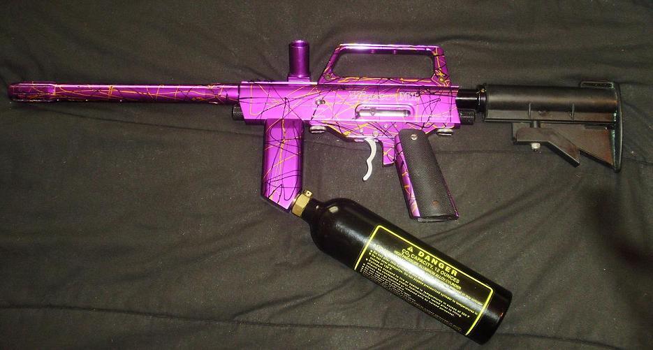

      Yes, the foregrip has a built in ASA. Here's a picture of one I used to own (in rare Purple Tiger splash)...

      It's sized for common CO2 tanks. The gun will run fine off a high pressure HPA tank, but those tanks are fatter and might not fit in such an orientation.
      With the tank at such a pronounce downward angle, and the foregrip acting as a very large expansion chamber, these run very well off CO2. Almost impossible to get them to pull liquid from the tank with normal use, so no random spikes in velocity.
      Internally they're a stacked tube blowback, but not spyder spec'ed. Closer to F1/Raptor with a small diameter valve and hammer, but really well built. They have their own boredrop twist lock barrel like an Automag, but not compatible between the two.
