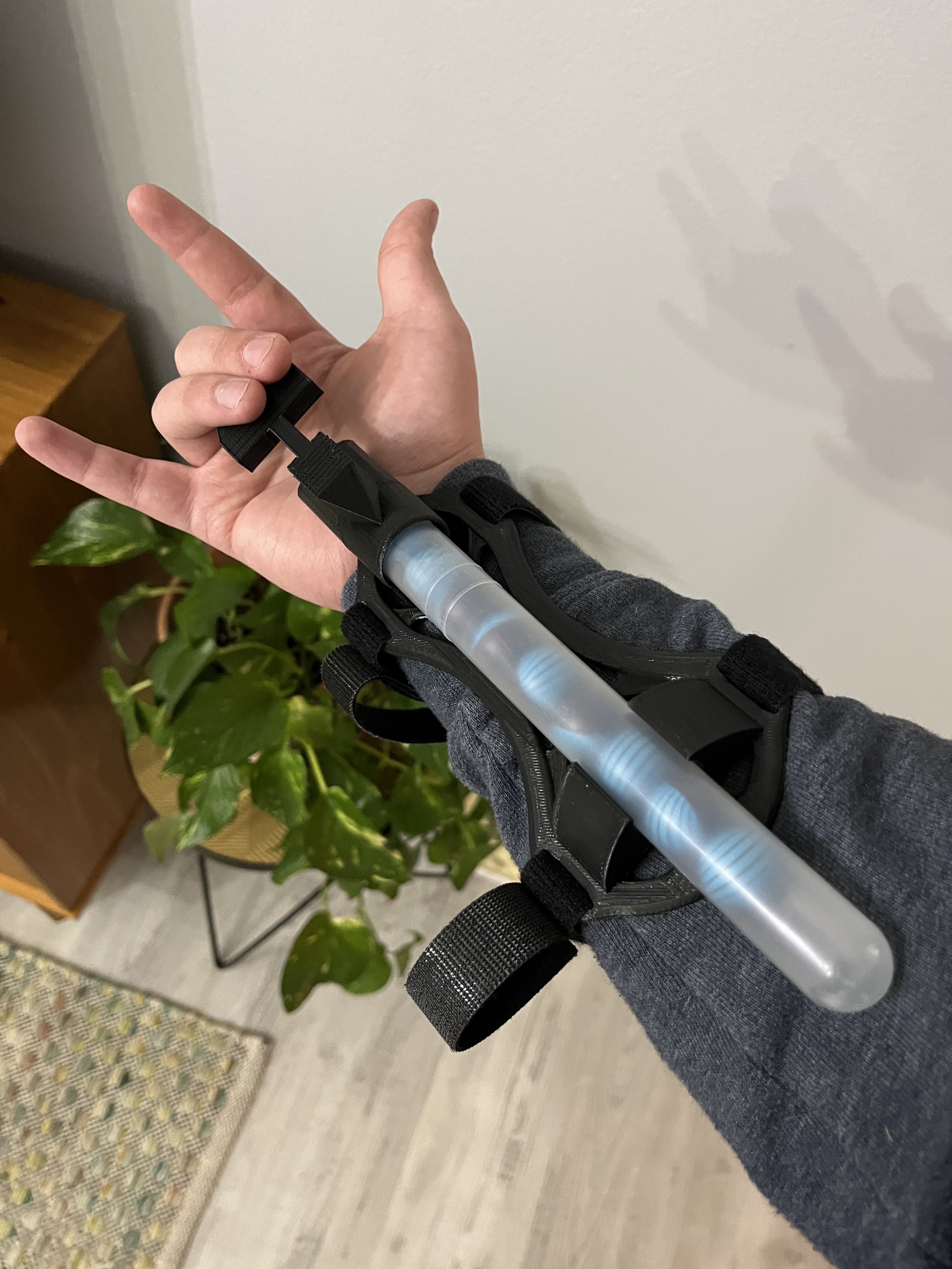

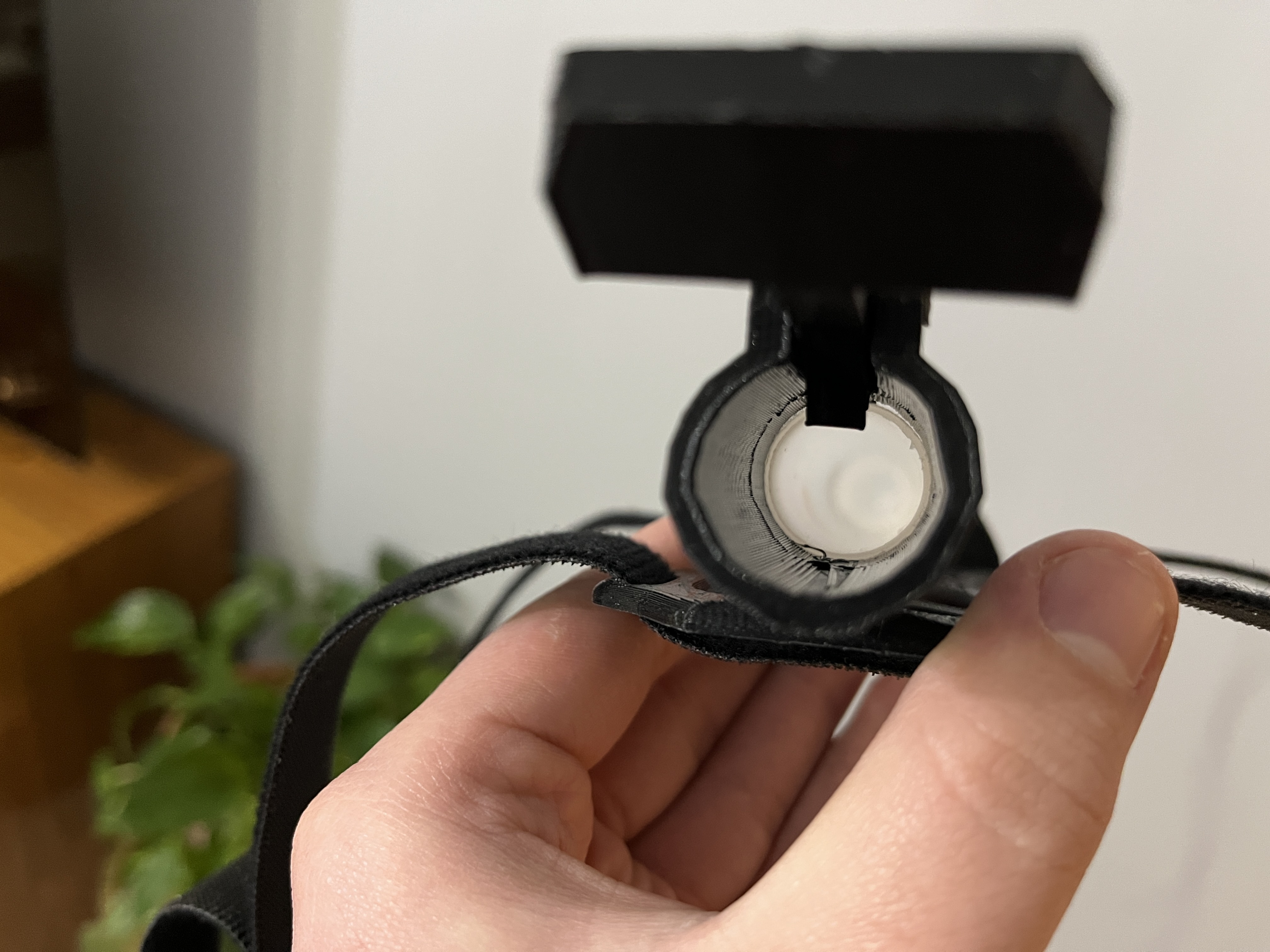

              Definitely agree with procarbie. The inner diameter of the feed is just a touch tight and won’t accept the 10 round, so it falls out super easy. Not sure if the designer just had smaller 10 rounds to build from, but I’m going to try to shave it down.
              Second problem is how easy it is to dispense more than one ball. Not sure of a solution just yet, but right now I’m getting 3-5 each time unless I’m trying really really hard and have my hand slightly raised.
              Last potential issue would be durability of the hinge. Being plastic I don’t foresee much forgiveness if the arm saw some left or right force.
              All that being said, it feels great on the arm, the lever placement is at a natural spot, and it’s such a fun concept. Also already seems to help speed up slingshot reloads. A few tweaks and it would be golden. Will probably be a while until I actually get a chance to play with it, but I’ll update if I’m able to modify it.

                Yeah I was a little let down on dispensing mechanism, it’s just a little piece of plastic that makes contact with the paintballs, which makes it super touchy and at times it was failing to retain the paintballs on one of mine (the other one was fine so I’ll just chalk that up to a defect). I think a lot could be fixed by extending that interior plastic retaining piece, so it dispenses individual paintballs easier and holds back the rest more securely.

                This is such a cool idea, and I really like the wrist dispensing part. The more-than-one ball rollout should be easy to fix if a 2nd lobe is added to the arm inside the ball channel, and move the pivot point between the two lobes. I'm psyched to see what you come up with!

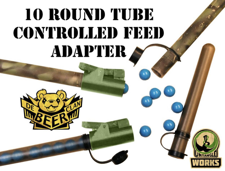

                  The Untangleworks dude also made a STL for a 10 round tube dispensing attachment, they look to be perhaps a little better constructed?
                  https://www.printables.com/model/879...d-feed-adapter
                  https://m.youtube.com/watch?v=MMI7MKud6MA
