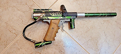

    The valve has 246 lasered on it. It also says rated 3000psi. Can you not use this with a 4500 tank? .
    Untested, condition unknown, need maintenance. No case, tools etc.

    You realize that 3000 and 45000 psi are TANK pressures and not output pressure, right..?

      automags are designed to be able to handle tank pressures as a safety measure. The idea being that if the tank reg fails and that pressure reaches the marker it wont blow up in your face.

        Just so it's crystal clear: Yes you can use this with a 4500 psi tank.

          You just wouldn't want to use it with a 45000 psi tank.

          That's an old promag valve
