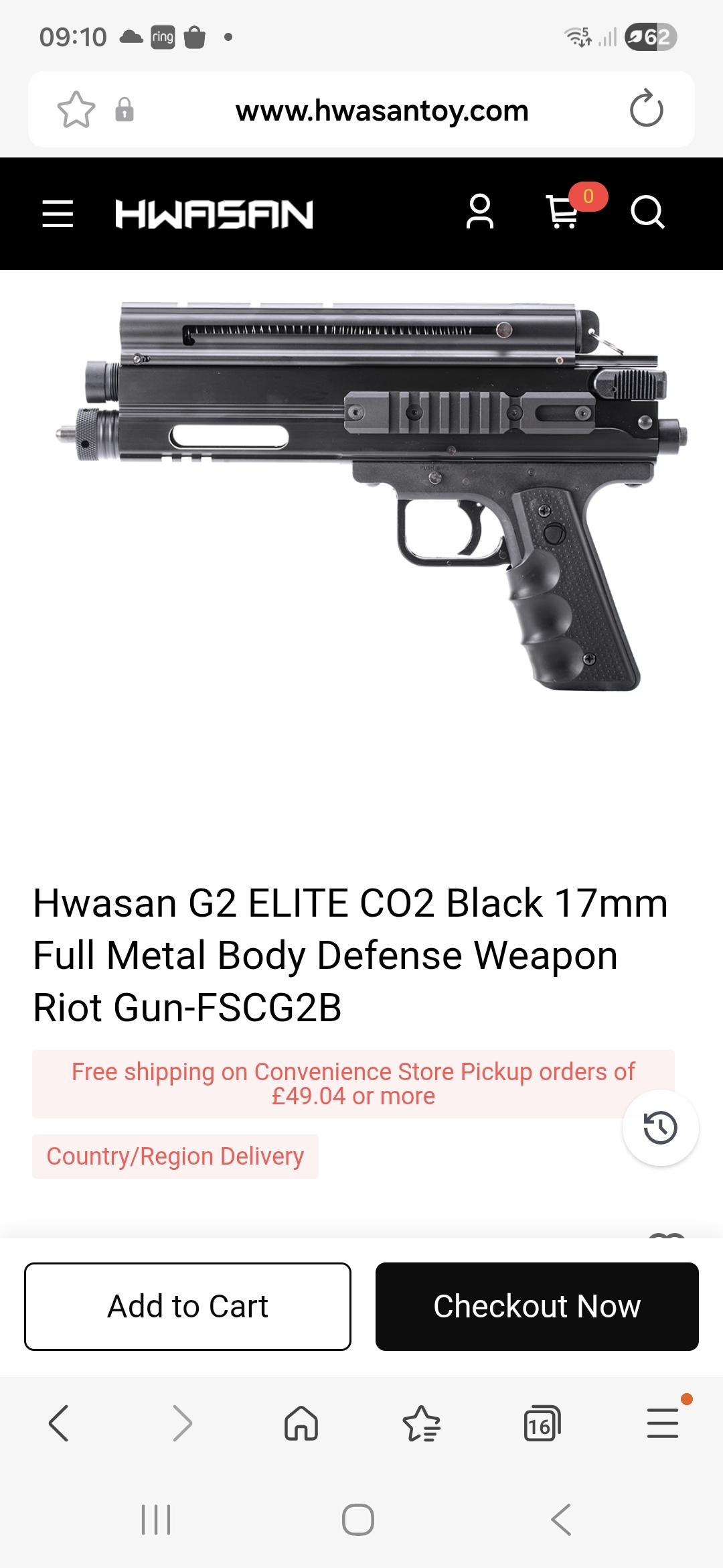

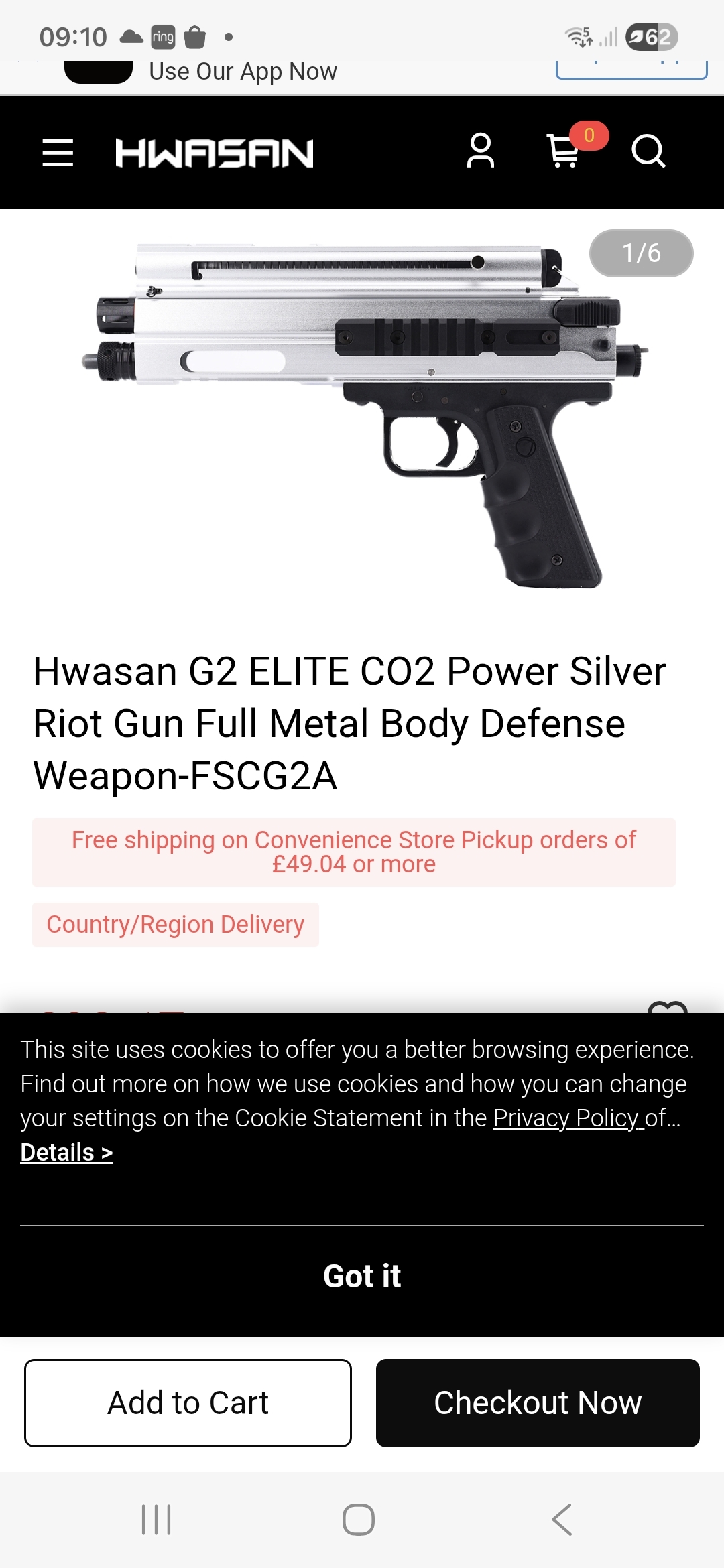

        Ive been wanting one of these for a while. The manufacturer mostly makes airsoft replicas and their madmax double barrel shotguns are very good. The only thing that has stoped me ordering one is that i am worried about the packaging and manuals that may or may not come with them. If you go on the manufacturers website they are marketing them as riot control guns not paintball markers. I live in the United Kingdom so if one goes through customs/ boarder force and it has packaging and litriture talking about riot control or home defence etc then it gets confiscated, destroyed and i get a knock on the door from the police. If anyone on here buys one please post pictures of the box and every thing that comes with it. I'm 39 now but when i was a teenager i worked for years as a paintball marshal and carried a zeus g2. I have fond memories of me and my fellow marshales taking pop shots at each other across the fields whilst running the games with these. A lot of the others also had delt 68's. Unfortunatly 2nd hand zeus pistols are very hard to come by in the UK. ive been looking for years. If i could just see the packaging first i might take a gamble and order one.
        • Svman730
          • Apr 2025
          • 16
          • Kent United Kingdom
          Link to manufacturers website
          https://www.hwasantoy.com/v2/Search?q=G2&shopId=41348

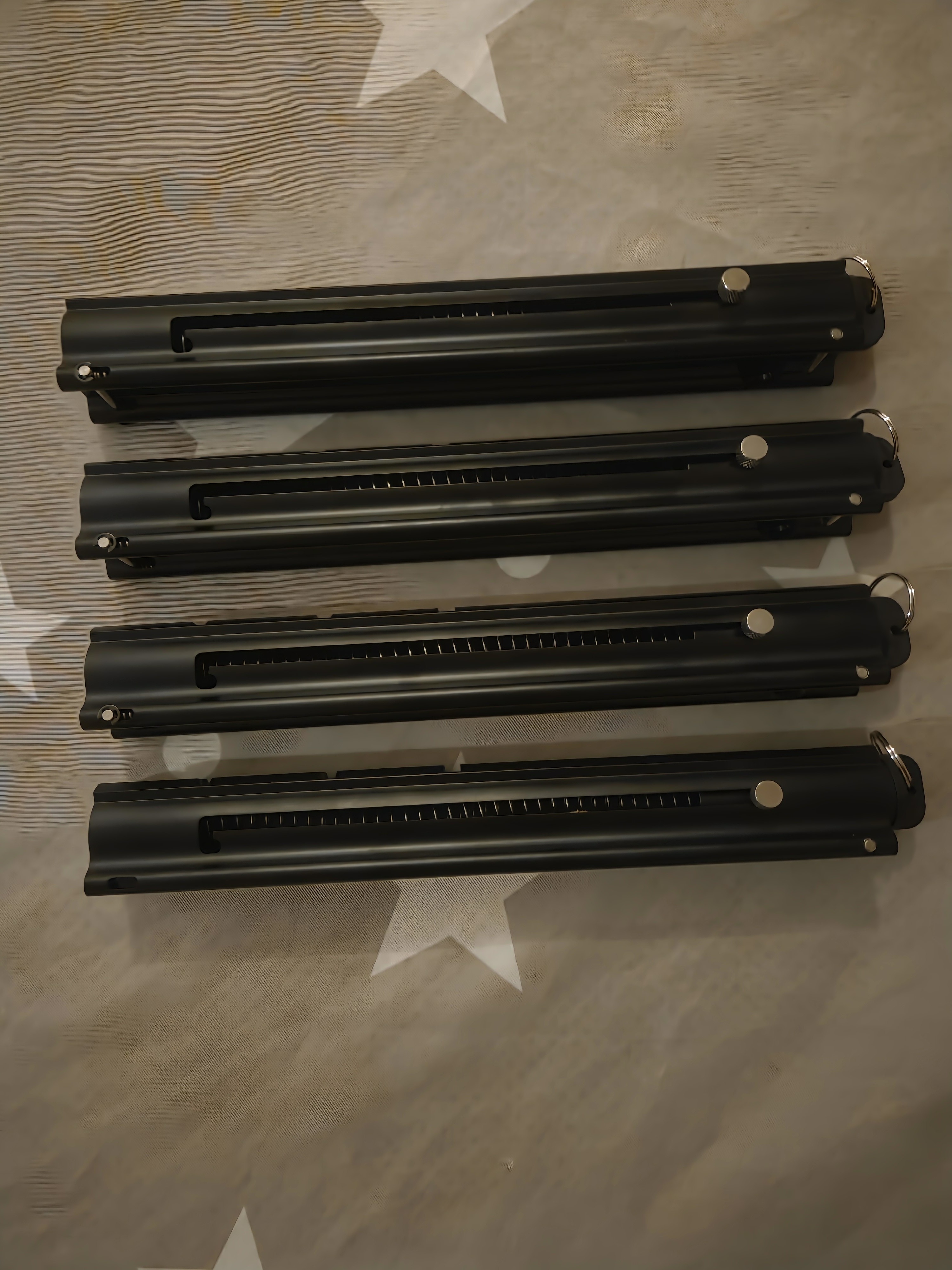

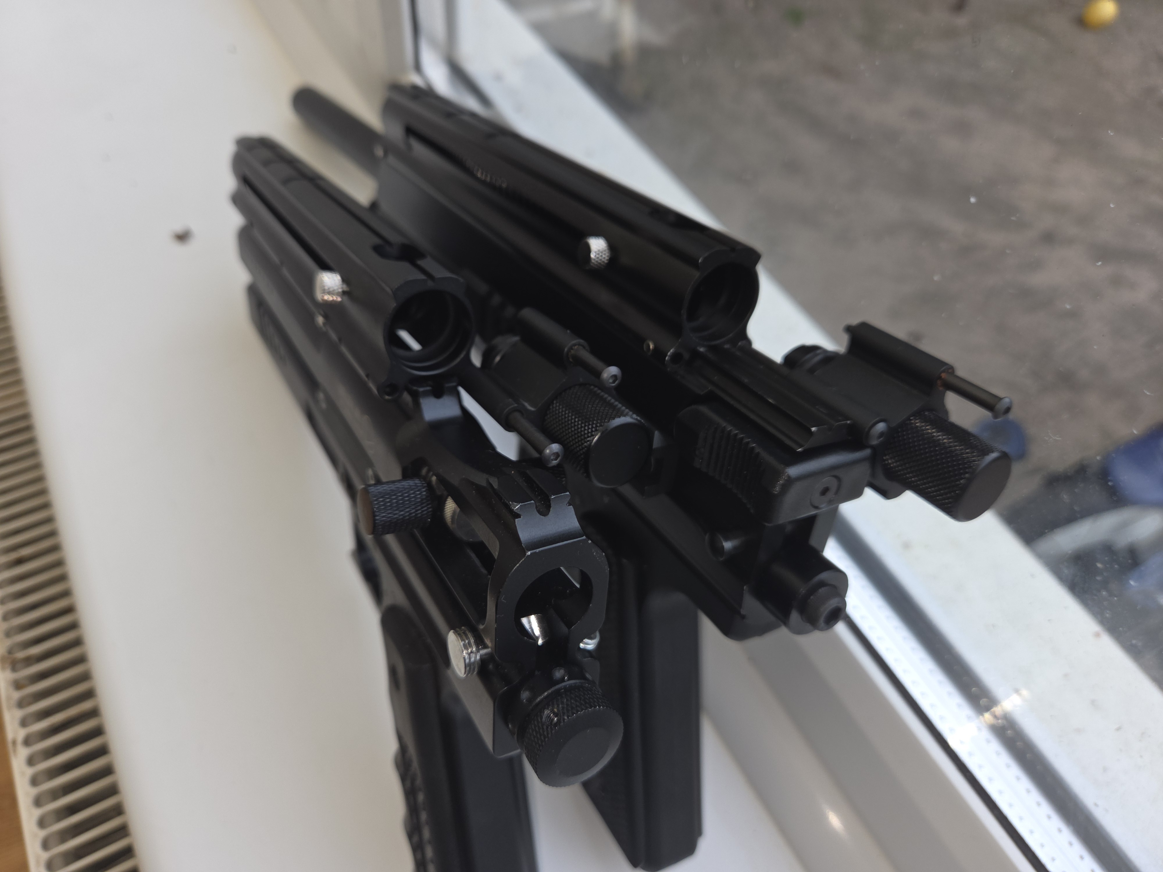

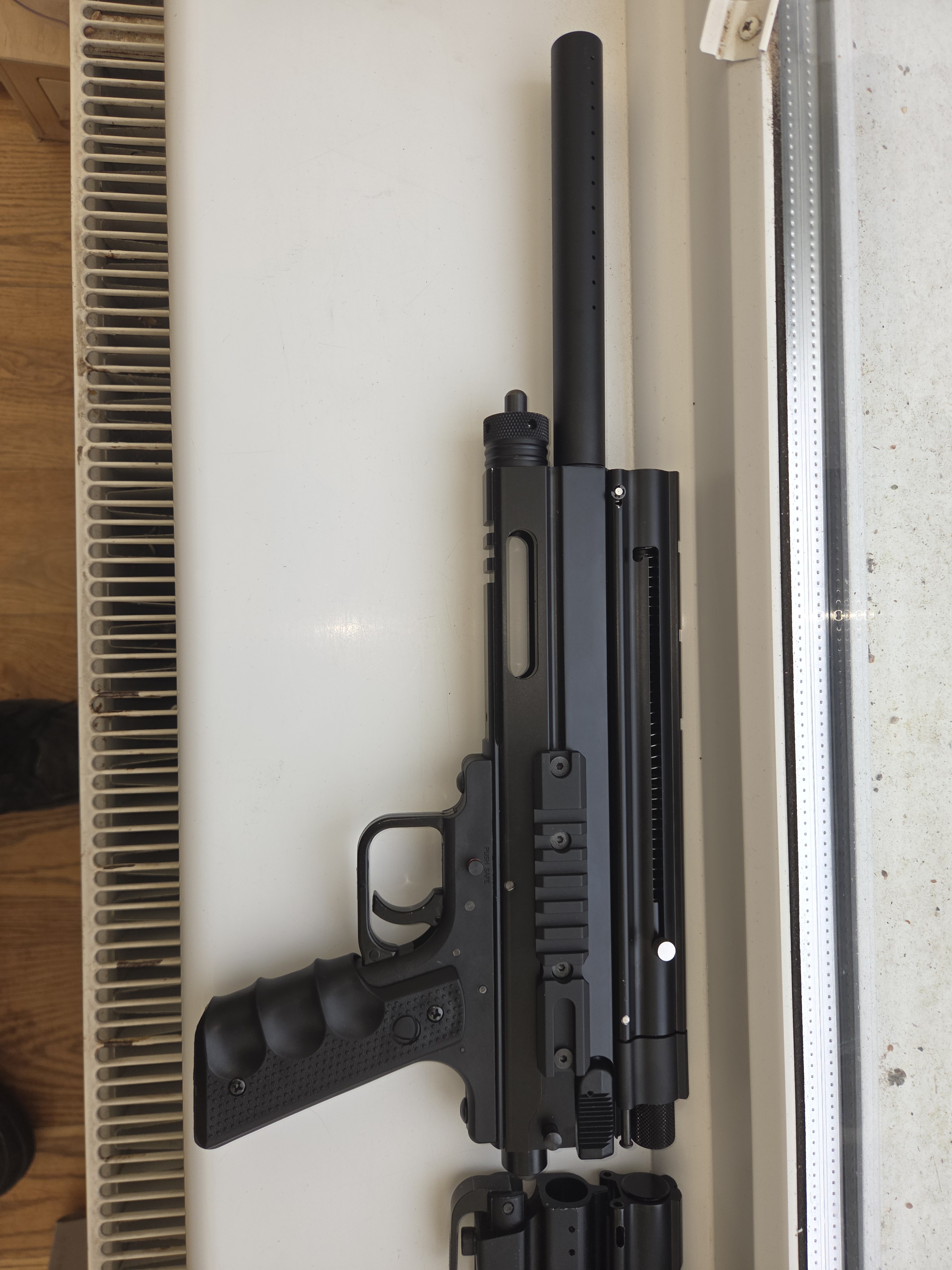

            20251224_233849.jpg ​ So you can buy spare mags from these direct from the manufacturer through one of their websites called BCS Airsoft

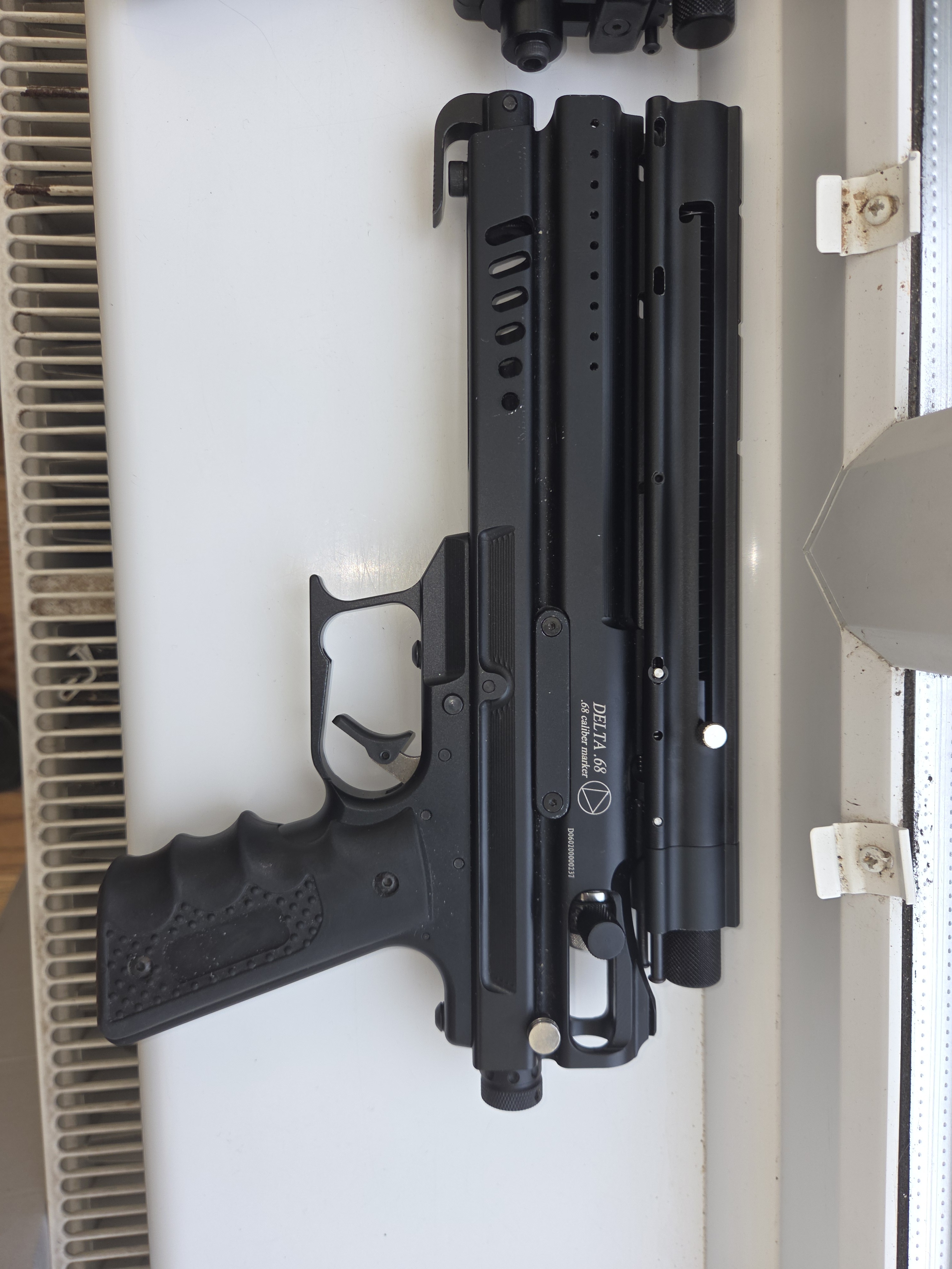

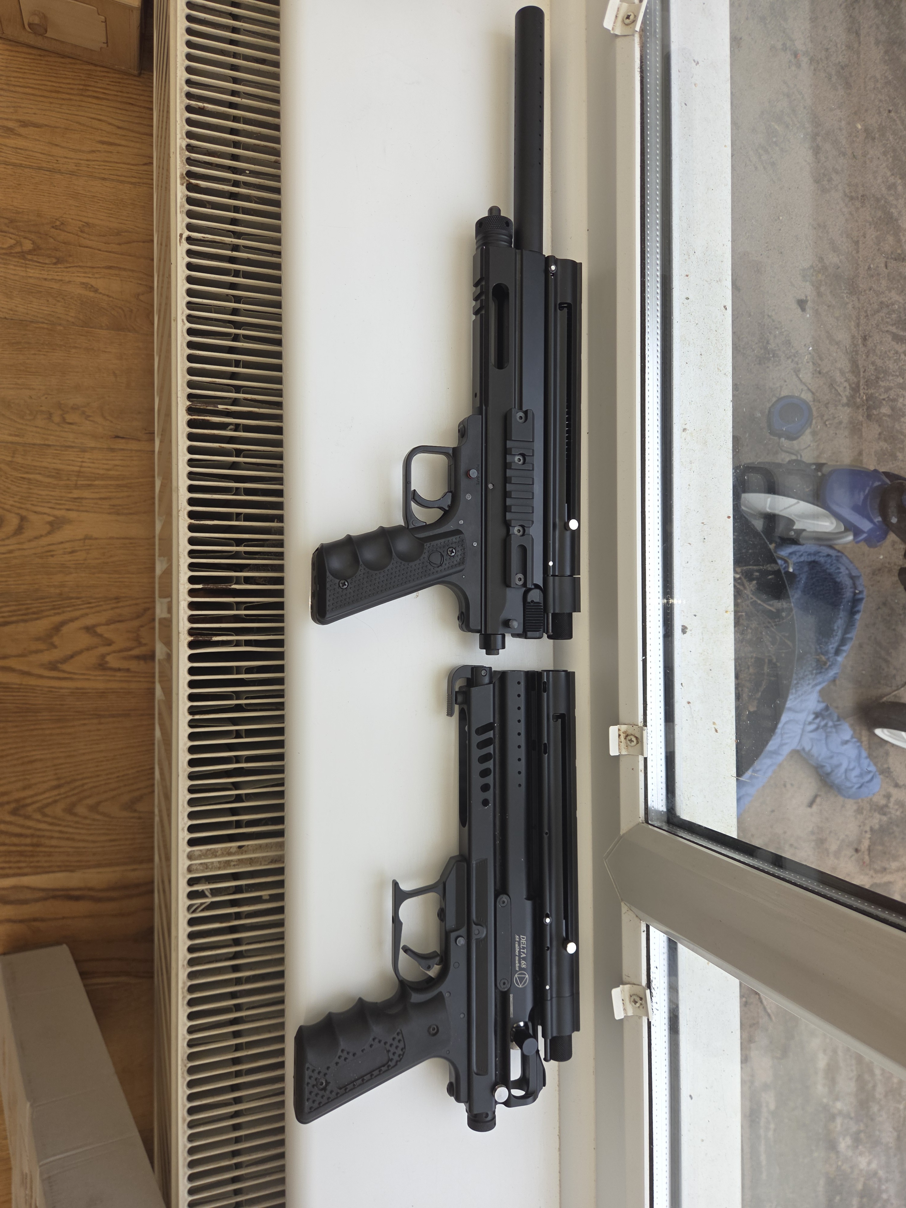

                      Ive got a whasan g2 now so if anyone wants me to measure parts to check if they will fit the og armotech i'm happy to do so. I do t have an armotech to compaire though. Ive also found a sorce for the quick caps and an alternative manufacture of the mags in Taiwan.
