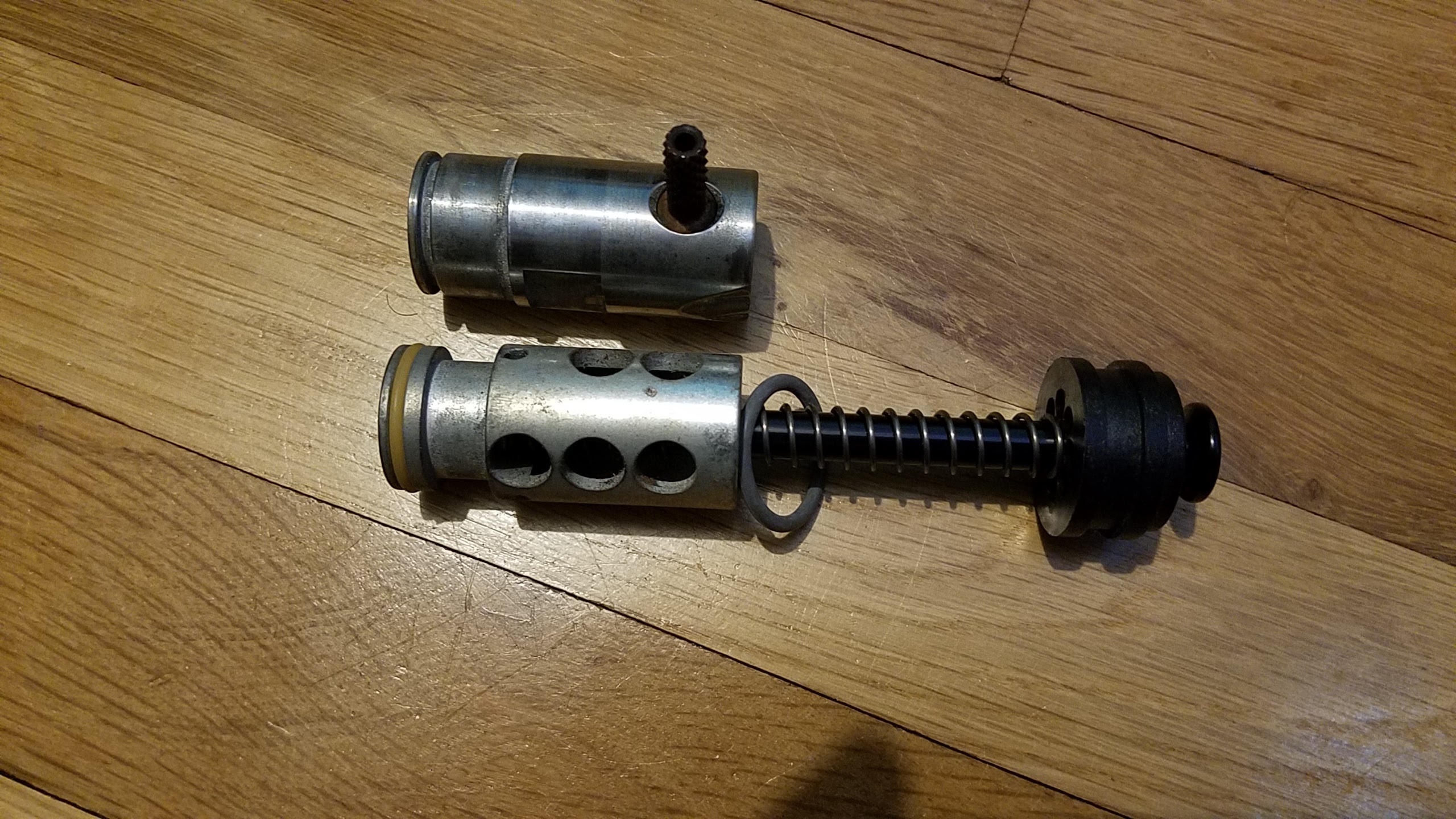

        I got a question for you LPK users - is there a way to use the original back cap and side cocking setup or does the hammer require the rear cocking?

          Not sure about using the included hammer with side cocking, but using an aftermarket lightened hammer will allow you to.

            You can use the LP bolt with side cocking. The bolts are the same starting point, with some extra machining on the lightened one.
            Click image for larger version  Name:	20210107_190233.jpg Views:	0 Size:	1.02 MB ID:	76737
            The LP bolt has the two added top holes, the two front through holes, and the extra necking at the front with the O ring. The LP bolt doesn't ship with the aluminum insert found in the standard bolt, which I believe helps keep the spring from fouling inside the bolt. You can just move that aluminum billet over from the standard weight bolt. It needs a touch of file work as they skipped one of the cutting operations on the inside of the LP bolt, and the aluminum core doesn't fit inside by about 0.020" or so.
            The total reciprocating masses are:
            Standard - 150 g
            LP - 102 g
            LP Side Cocking - 122 g
            For reference as far as mix and match goes, weighed individually (but included above)
            Side Handle - 14 g
            LP Handle - 17 g
            Aluminum Core - 20 g
            Edit: There is a small aluminum ring inside the LP hammer that the spring sits on that I didn't bother to weigh separately. Also I did not include the respective springs as reciprocating mass, and they do have different spring rates as far as I know.

              Wouldn't the rear cocker aluminum piece somewhat if not totally negate the difference in weight between the side cocking LP hammer?
