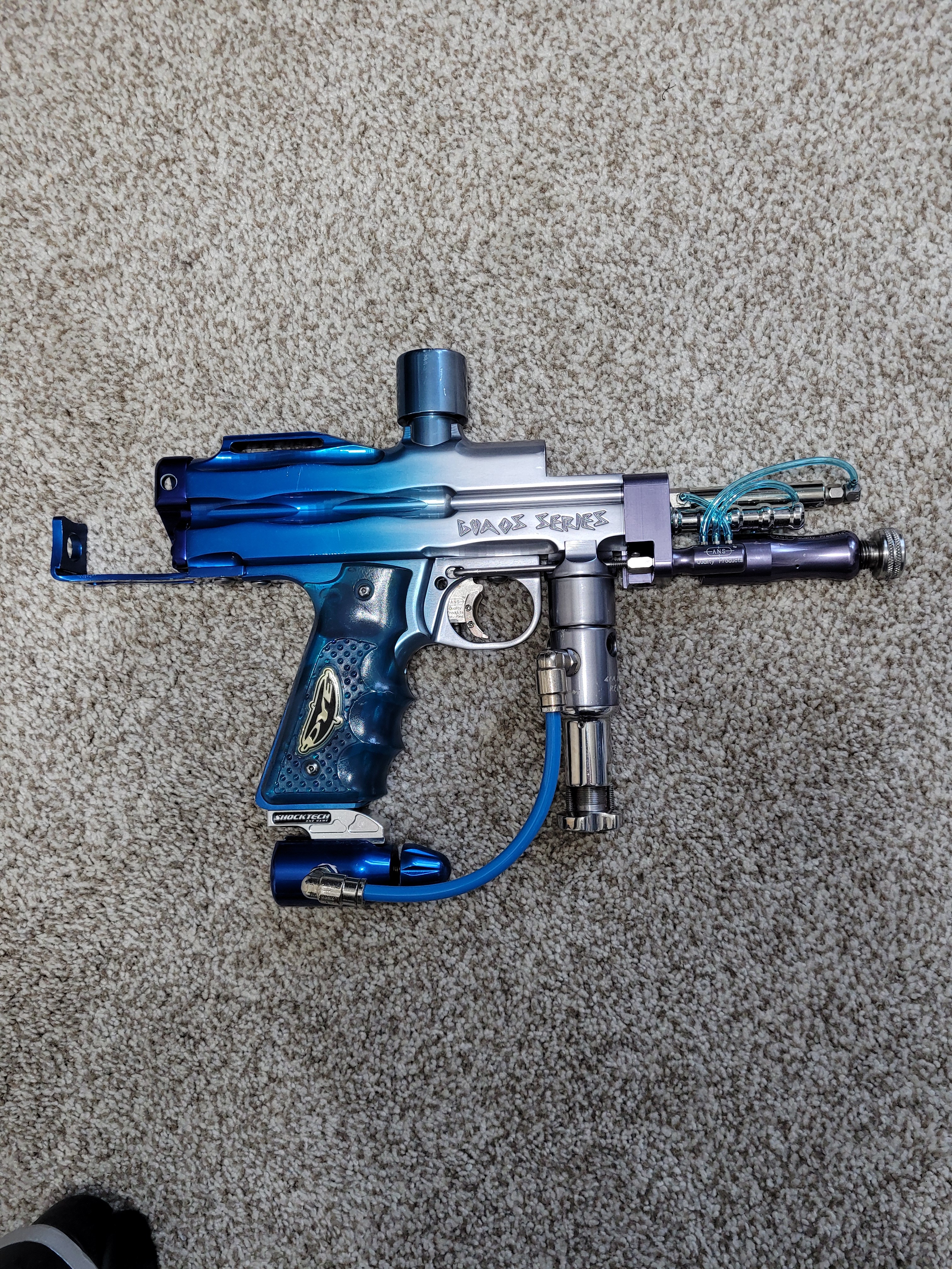

    Decent price on a fade GX cocker

      I bought it 😅 beatififul color and it has the cobalt front pneumatics which I might steal for an all cobalt color build in the future. This one stays in the MCB community! 😊
      Edit - if you're curious, I offered $217 on it, seller accepted, total cost was $245 shipped. Great price for this one! Seller has a few other cockers, might accept offers on them too.

        That's my favorite color combo for these. I always thought these were really good looking guns. Hope you get it up and running and on the field!

        Glad this went to a good home. I always thought ANS made great stuff, maybe it was marketing. I still say the body looks great.

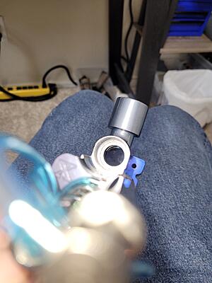

          This one appears to have been a total bust. I finished rebuilding it only to find that the feedneck has been jammed in further than it should be and is blocking the bolt. Can't get any bolt to work because the tube is blocked by the feedneck. It's a press fit feedneck and it was sold for parts so I'm screwed. I don't think it's fixable.
          And i already rebuilt the whole darn thing, lmao. Just my luck! Adding "check bolt clearance" to my pre-rebuild checklist 😅

            Nothing a little dremel action cant fix.

              Mmmm... it's pretty far in there, I don't know if I would be able to grind that much material in that position. I could try but that's a tough one 😅 would definitely butcher the inside quite a bit to open it up enough. There's a decent amount of exposed feedneck

              Oh absolutly. My comment was mostly in jest. You would probably develop a bunch of blowby/blowback issues also if you fudged up the breach that bad.

            It didn't get pushed too far in, it spun. If you need help let me know. It will need to be pulled out and pressed back in and loctited in place.
            If you want i could feedneck mod it as well while it is here.

              Hey man! I had no idea you could pull the feednecks and re-press them! You're the man! I'll reach out to you via email, I had contacted you about something else already. ❤️💖
