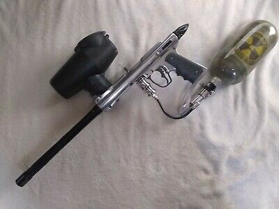

    <p dir="ltr">This was built for NXL mechanical division. All factory internals, all new Tippmann o-rings, new sear and sear spring, new main spring, original valve spring and  polish bolt, polished internal slides and polished valve, moved charging handle to top, installed limiting screws on trigger, small Tech-T hair pin, Lapco Big Shot barrel, Pachmayr one piece grip, cut down thru handle, 32° velocity adjust back plate, cut off all unnecessary weight, dry weight 5.78 as in photo. Field tested and very efficient on air. Only uses 800lbs of pressure per 350 hopper.Probably the last lightweight  working 3000 psi carbon fiber tank on the planet and it has over a year left on it. Marker has no safety for trigger adjustment, safety is putting bolt forward.</p>

    thats a pointy boi

      It is pretty cool custom work. Reminds me of those inline Sheridans, like an XTS.

        I really like how they moved the cocking handle to the top, haven't seen that one done before.
          • 6380
          That’s cool. Did they ever make a center feed 98 body?
            Carp commented
            I've only ever seen custom modified ones.

          Rufus Dawg made a vert feed neck conversion for 98s. Pretty hard to find now. I think Doc Nickel posted pics a custom one he did.
