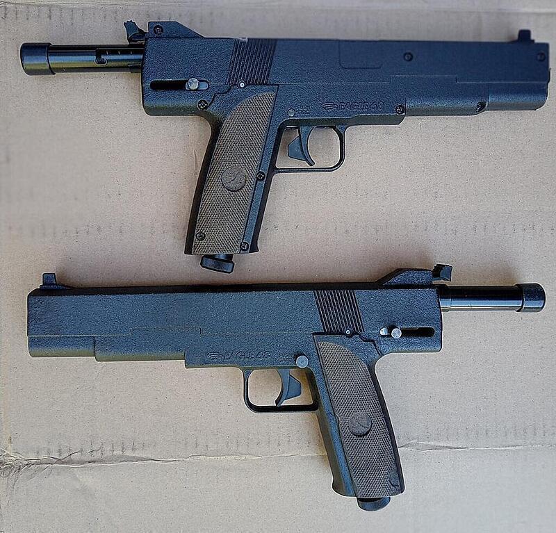

    What Eagle 68's could be if properly reinforced and modified​:

        It was a long tedius process to do these 2, and I probably would not want to ever do it again.
        Matched pair of Brass Eagle “Eagle 68” pistols
        Filled in all empty spaces inside with Epoxy Steel (lots of it), to reinforce the weak plastic bodies
        Removed self tapping screws and used machine screws and countersunk nuts (filled in holes)
        Sanded down body graphics (left "Eagle 68" intact)
        Body painted light textured black
        Painted grip panels textured tan (to look like separate wood grip panels)
        All new o-rings, and lubed properly (Brass Eagle originally recommended transmission fluid!)
        CO2 plug painted black
