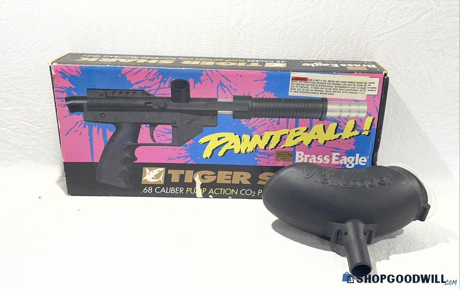

    Brass Eagle Tiger Shark
    https://shopgoodwill.com/item/273741735
    image.png​
    7 days to bid!

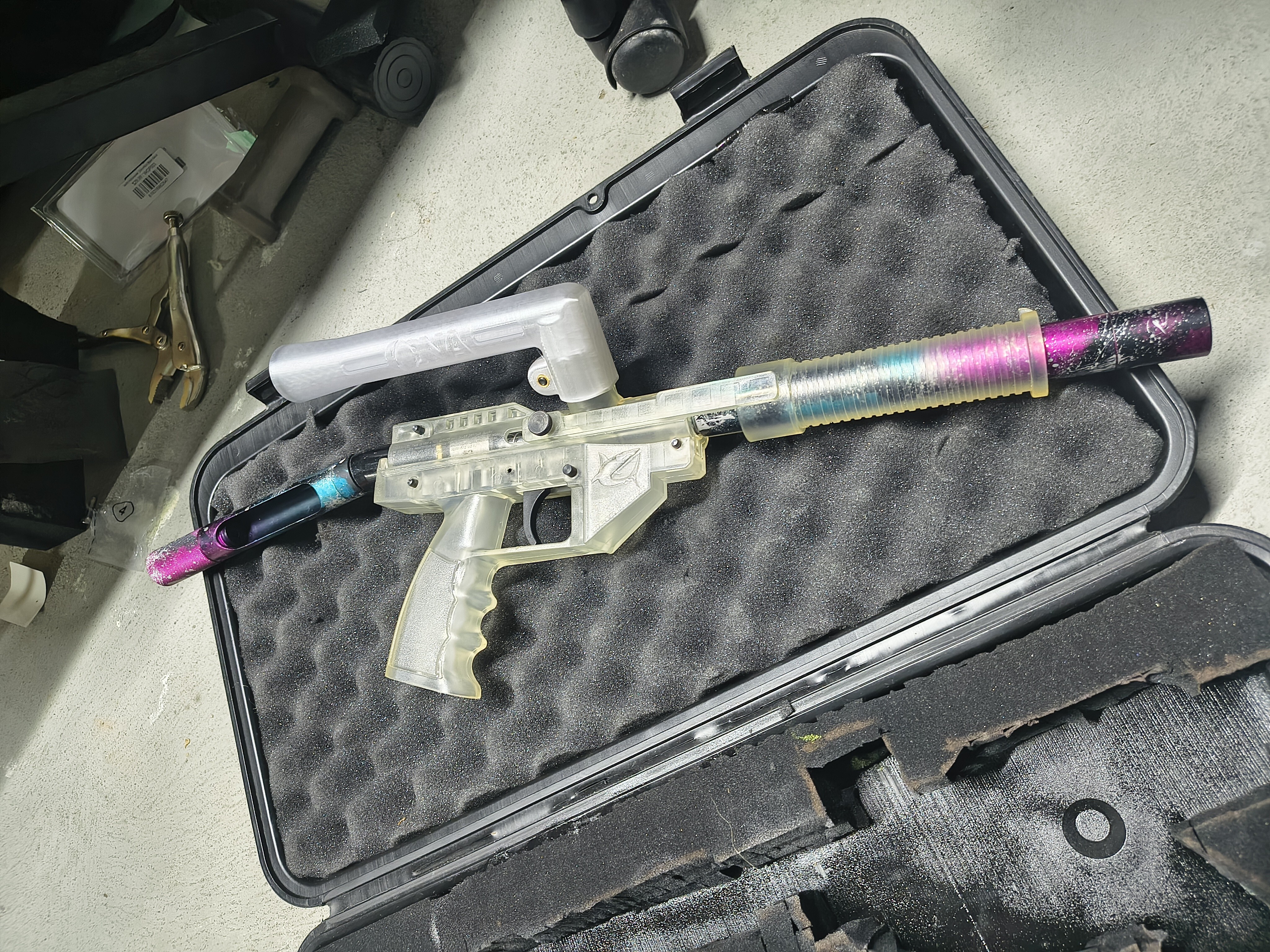

        These are criminally underrated if you get one of docs XL freak barrels or have a machinist bore a stock barrel or use a raptor(?) barrel with a cut down shank. I'm also waiting for results from BMC but an adjustable velocity bolt looks might feasible.
        They're lightweight, with the pull pins require just a wrench for full disassembly, and are a nelson. On top of that since they're dirt cheap and made of plastic they make really fun, cheap and easy projects.
        Here's my favorite shark, I also just ordered another one of docs barrels to make an FSR single shot shark out of. But here's my favorite tigershark for inspiration.
        Collection
        GITM based out of Warzone RI
          Together ape strong
          https://i.imgur.com/3MZrDsb.jpeg

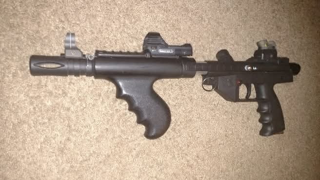

            These markers have such potential if you just take time to tweak them out a little bit... This was one of my last ones I had and as Jonnydread can tell you it was smooth as butter.
            • Impactfour
              Impactfour commented
              Beyond springing and polishing do you have any recommendations?
            • Chaos
              Chaos commented
              Drill out the pump arm screw holes, shim the holes with nylon spacers and then replace the pump arm screws . I did that to that one and used 007 pump arm screws. Gets rid of the slop in the pump stroke.

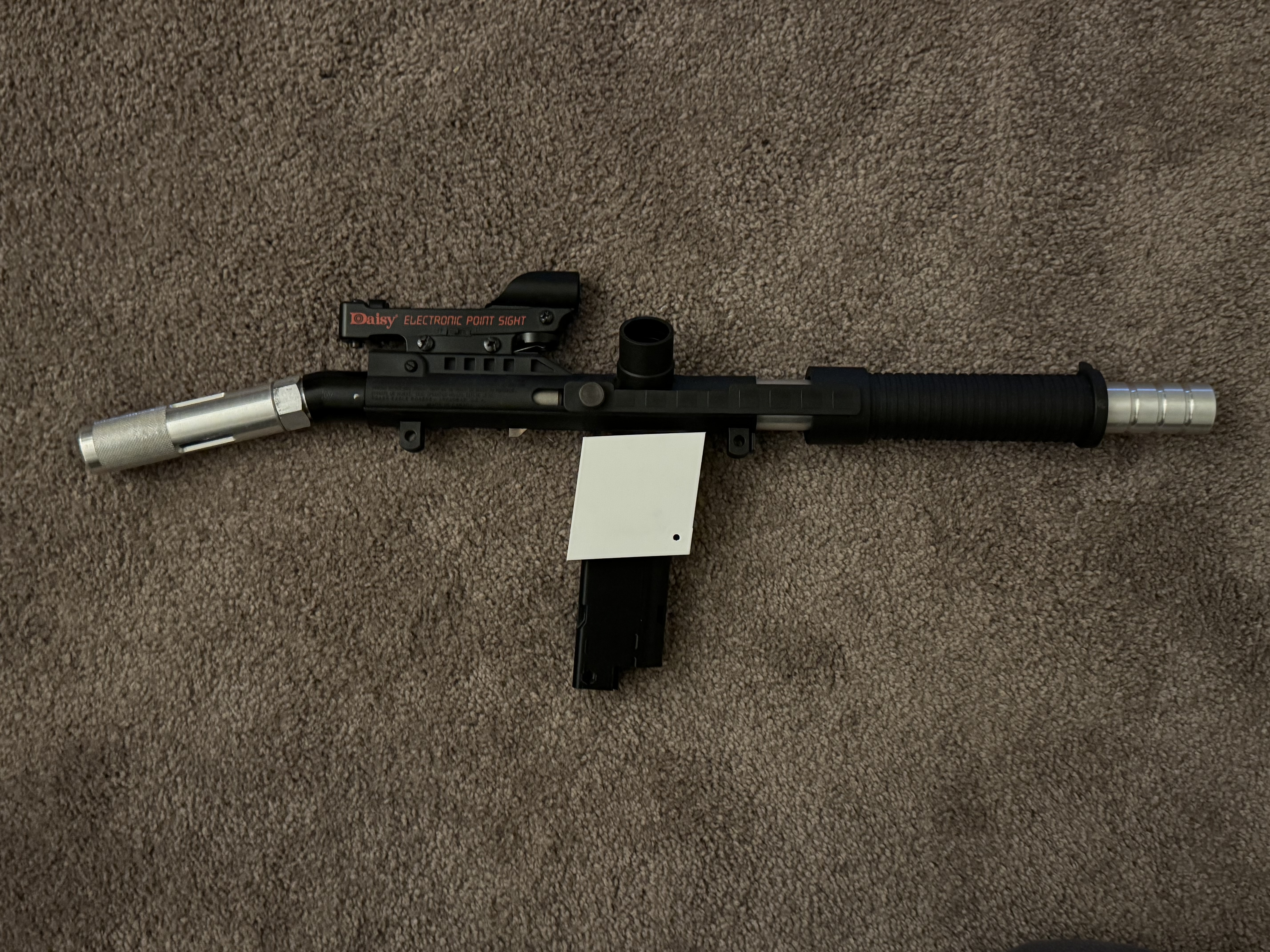

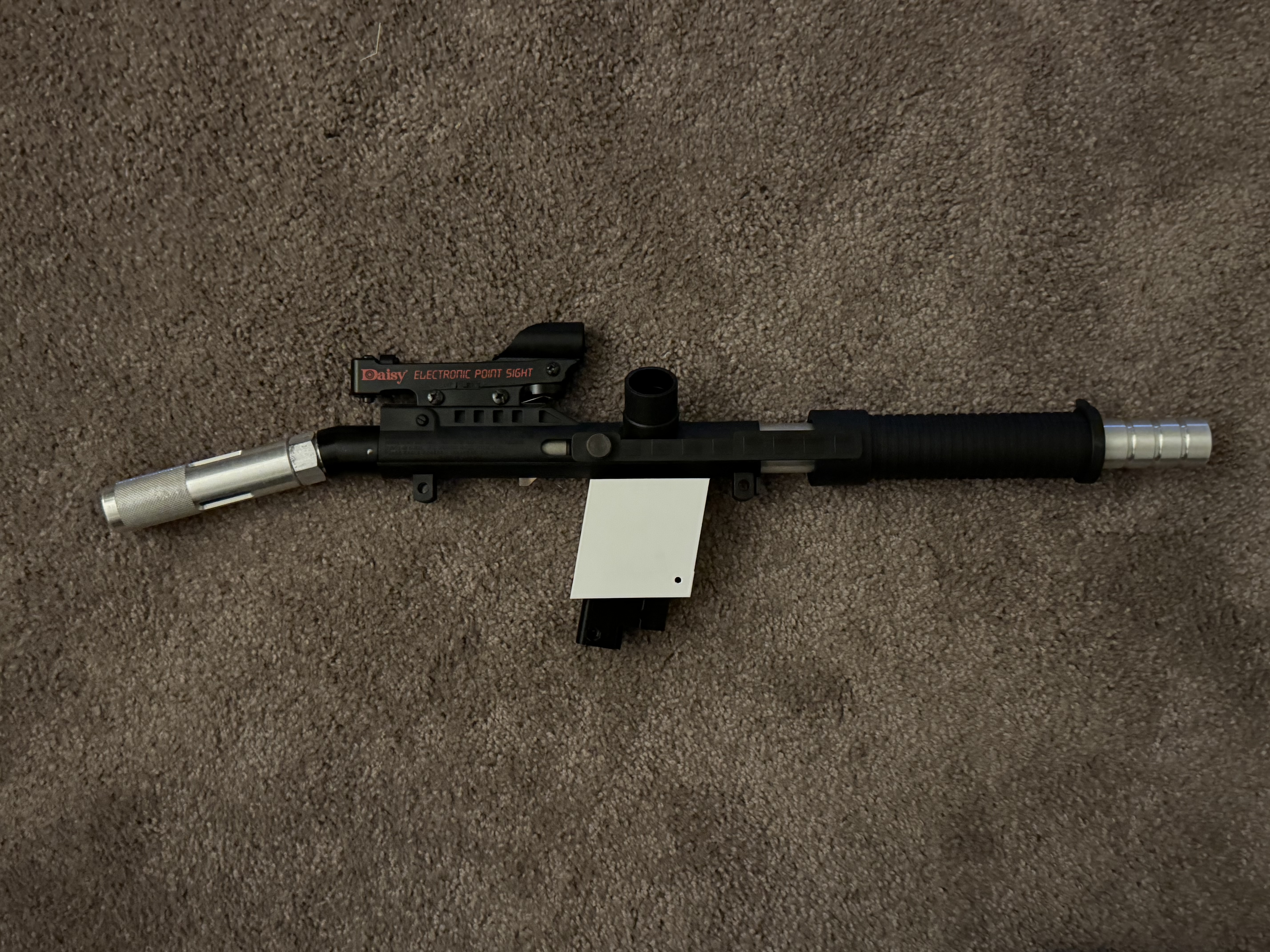

                Well I may have lost out on a $10.99 + $14.00 shipped Tiger Shark but I did get a $35 shipped Tiger Shark with a Daisy red dot!
                https://www.ebay.com/itm/227269127448
                • hunter47
                  Too many activities
                  • Jul 2026
                  • 48
                  Having naughty naughty thoughts...
                  But first, internals need a cleaning - powertube is gummy, probably from the bolt oring that is absolutely disintegrated.
