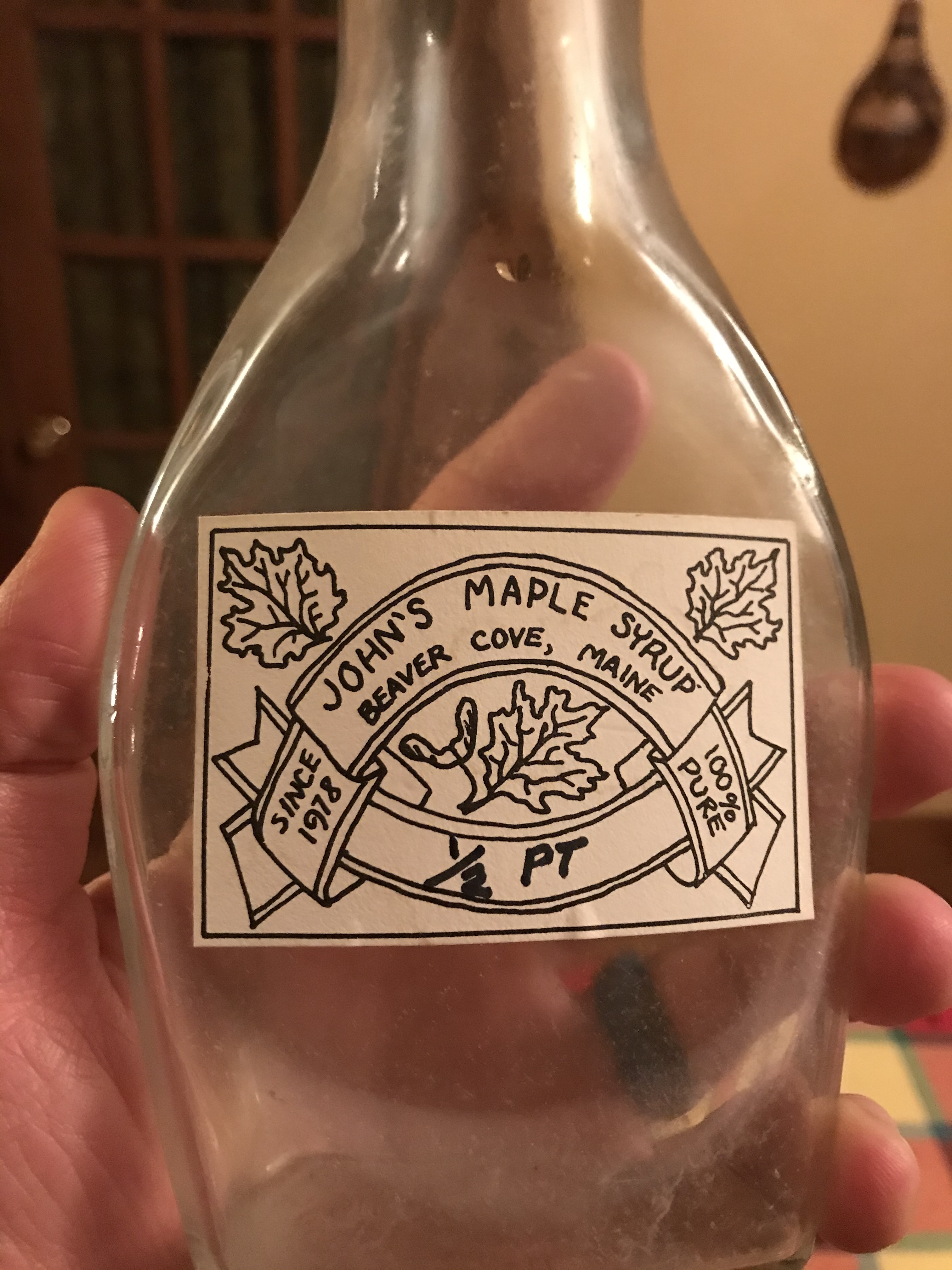

    First bottling of the year:
    I purchased some "flask" style bottles as I thought these would make good items to put in some gift baskets around Christmas time. Instead of just buying some item that someone probably doesn't need, we (my parents, wife, and I) have been giving home made baskets to people. Jams, jellies, syrup, whiskey, pickles, sauces, etc - You get the idea.

                      You need labels for those bottles? I can print you some stickers, removable ones if you'd like.

                        His stickers are top notch. I’ve had him do several runs for me and I will have him do more in the future.

                          why yes I am in need of some new labels. Had some made a couple years ago off of etsy will drip you a line.
