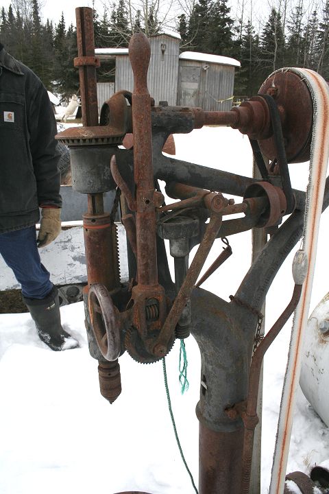

        There's a ton of how-tos out there, and it's easy. I turned this, which had been out in the Alaska weather for a decade...

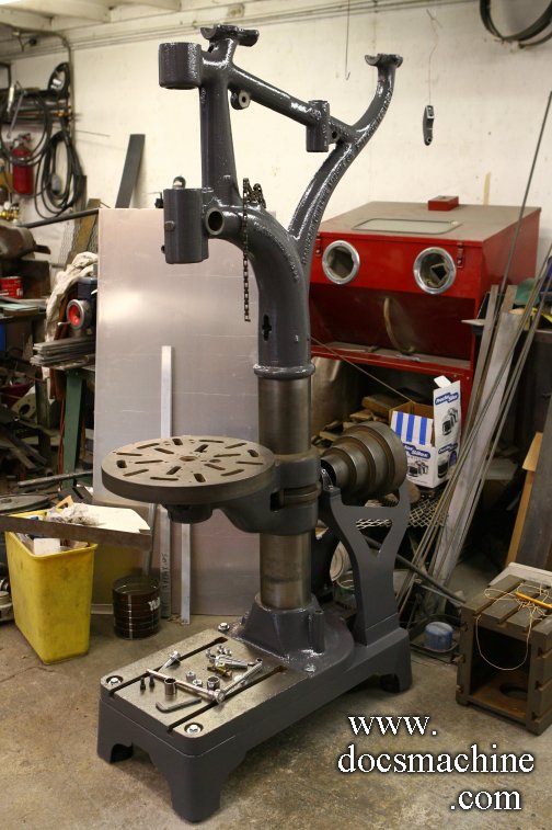

        Into this (still not done yet.)
        It can't, obviously, put metal back, but it's great for getting rid of the rust. For smaller parts, I'll still use white vinegar or Evap-o-Rust, but for the big parts, electrolytic is much cheaper.
