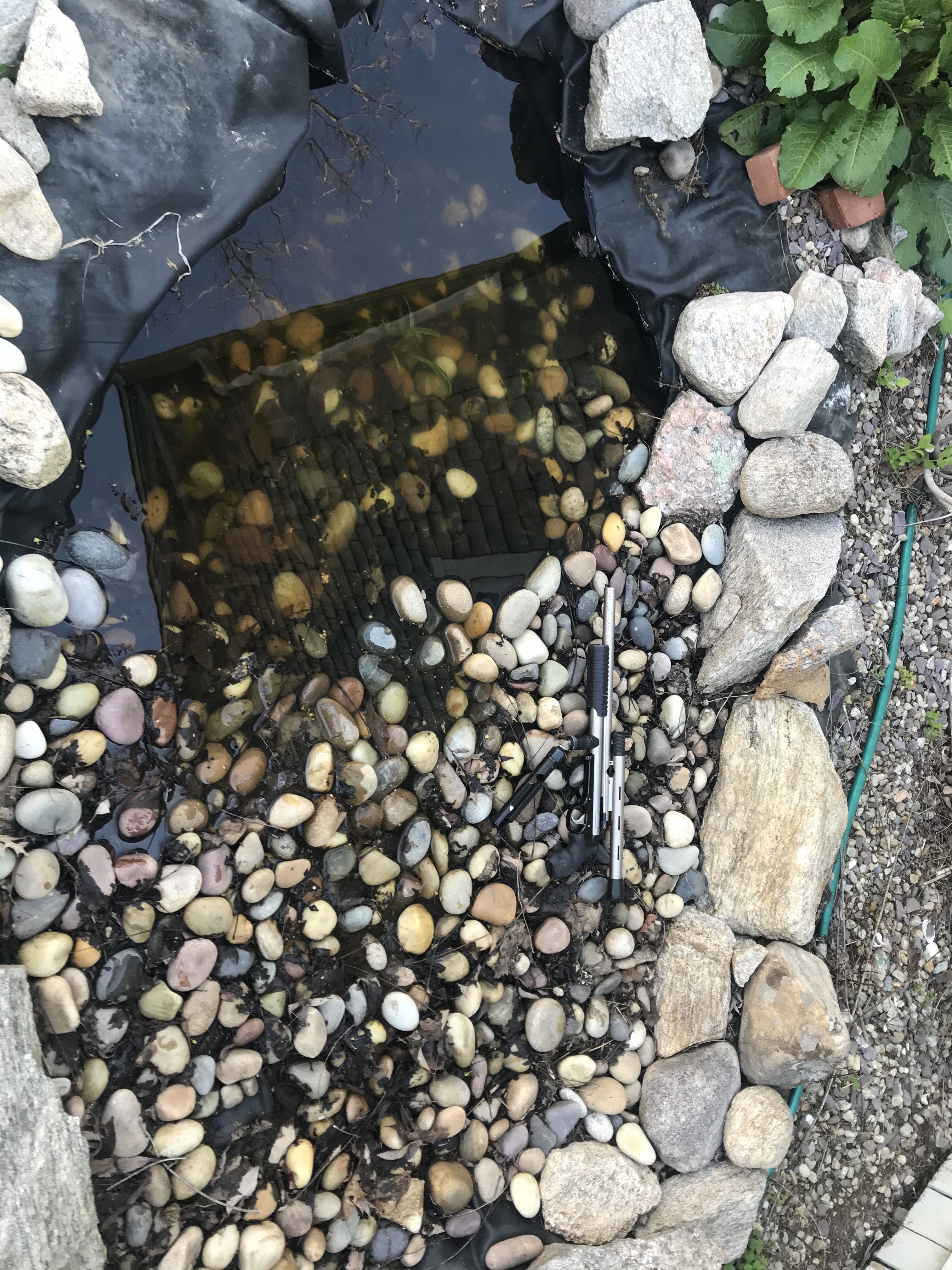

    Hey folks,
    We have a little man-made goldfish pond on our property. It it fairly small, and slightly over 1' deep at the deepest portion. The previous owners used a small water fountain pump to circulate the water, but it got clogged up with duckweed and shit the bed. I would like to get a relatively powerful, outdoor-use pump that either doesn't clog easily or has a easy-to-clean filter on it. We are not planning on putting fish in the pond, but I would like to keep the water well circulated to avoid mosquitos and allow birds, etc. to use it. Does anyone have a recommendation? I don't care too much about aesthetics, function first.
    Thanks!

            For the pic above, something in the range of 4-500GPH that could push a 6-8 ft head should be fine. You'll want a head height rating higher than your application calls for, pre-filters jam/clog and you'll need more power to compensate or flow will stop.
            Aeration with a fountainhead will also increase the rate of water evaporation. Running a pond pump dry could mean instant death. A float valve attached to a garden hose works for keeping the water level high enough.
            If the water feature is very shallow, be careful of vortex forming on the pump input if you run the pump submerged. If that starts happening you need to increase water depth, change orientation direction of the input pipe, use a lesser powered pump, or run the pump inline exernally and add plumbing.
