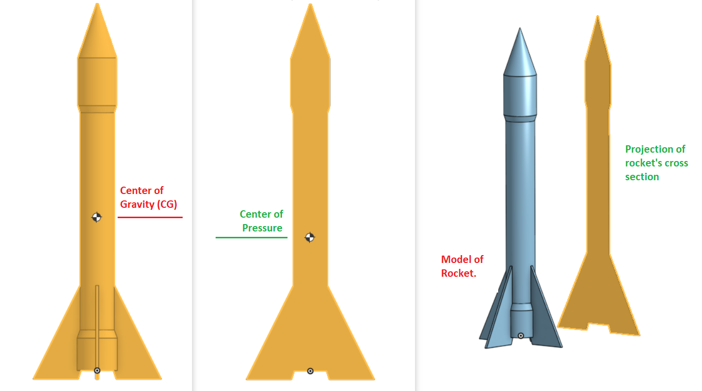

        If you can model your rocket in a CAD program, one that can tell you center of mass, it can help you determine your rocket's stability.
        - Find the center of mass of your rocket = Center of Gravity (don't forget to model it as hollow in the right places, and with engine in place, etc.)
        - Make a thin extrusion of the cross section of the rocket and find the center of mass of that extrusion = Center of Pressure.
        If I remember right, you want your center of pressure to be below your center of gravity.
