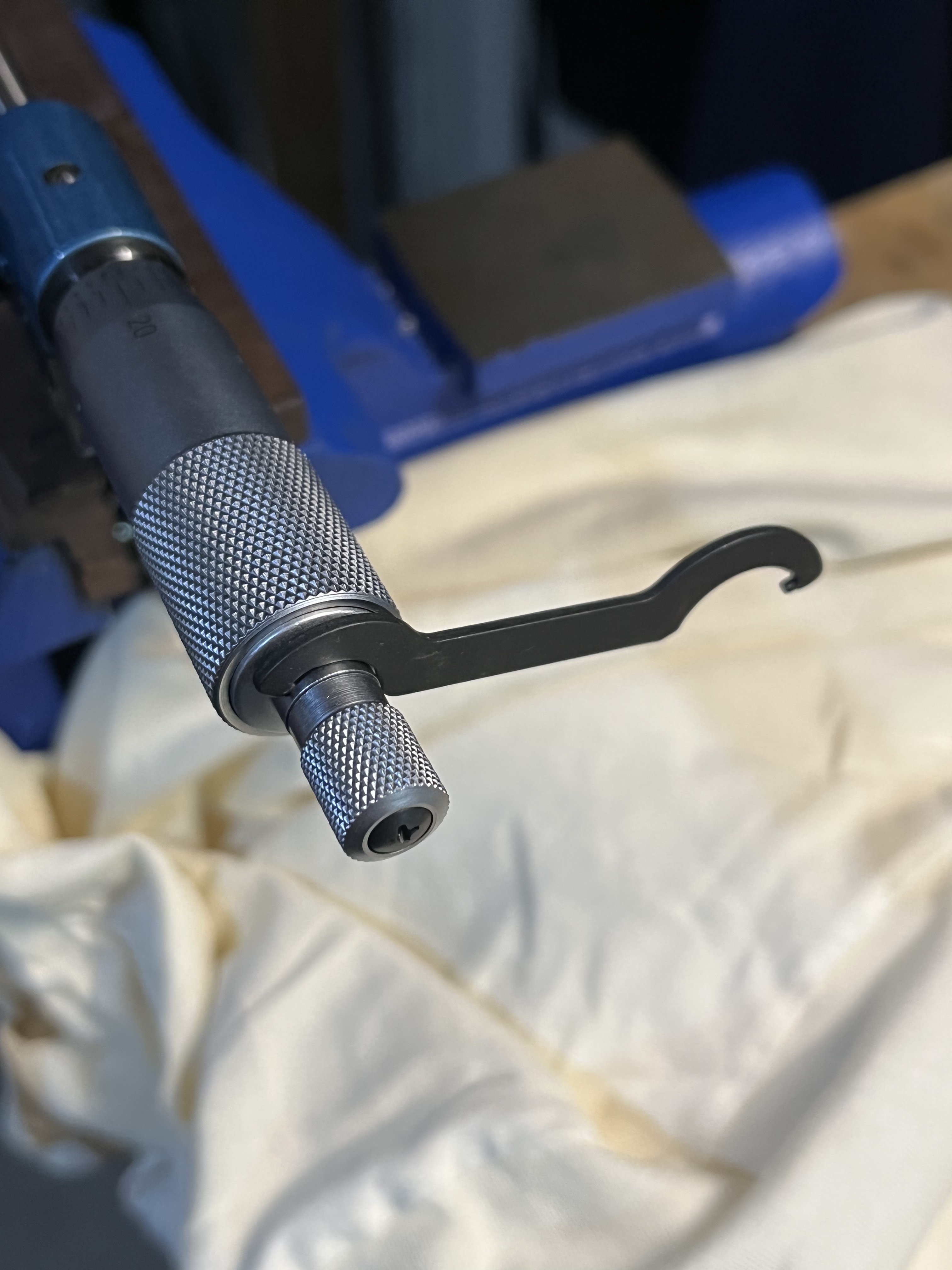

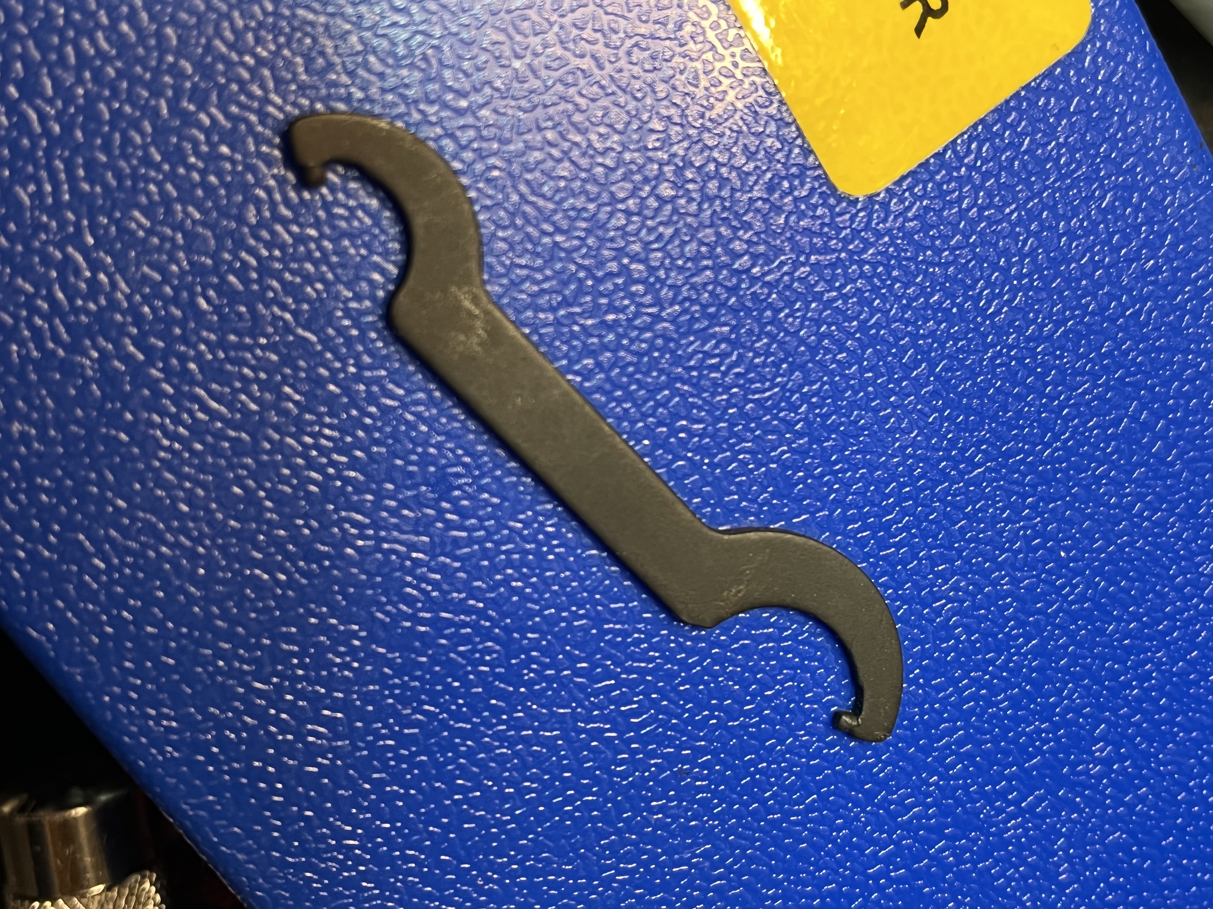

    What's the name of this wench?
    I need to buy a set of these wrenches for a new tap die kit I just got, but I don't know what they're called. The only one I have came with my micrometer. Any help?

    Spanner wrench.

      Yup a spanner wrench but if looking for them on line look for "hooked" spanner wrenches. I have a set of adjustable hooked spanners from SKF that I keep on hand but I also have a bin of ones that came with various tools and in particular pneumatic regulators they seem very common in pneumatics.

    If the design calls for a spanner it is usually included in the kit.
    You best bet is to just buy the size you need or an adjustable spanner close to the diameter you need to use it on. Also when buying make sure you know the pin diameter on the tip. I have bought spanners before only to find the pin size was wrong.

      Great info! Thanks for all the help.

        Depending on what your doing with it there are companies that make spanner wrenches with replaceable pins, your can swap with a set screw.

          I’ve never seen an actual set of these. I have one for adjusting springs on the Miata, one for my mic, like you, one I use at work for tightening down various things to the chassis dyno, etc. Everything that needs one comes with one, from my experience.

            That's probably true with quality tools. My micrometer isn't top of the line, but I didn't skimp either. So it came with one.
            But I didn't get a spanner with either my milling machine or my metric die set, and those were more, umm, bargain buys. So it's probably one of those "you get what you pay for" situations.
