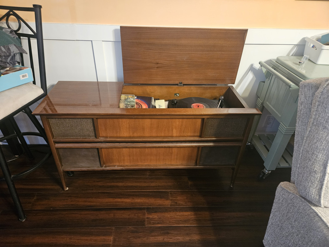

                        For my wife's Christmas present this year I bought, refinished, and re-fitted this old mid-century RCA record cabinet.
                        I know next to nothing about audio gear, so my build was very simple. The factory 9x6 speakers were poor, there were only two, both 2-way units with woofers and mids. I replaced them with Infinty Reference 3-way car speakers of the same size. The factory amp and record changer were still mostly working but didn't do what I needed, so I disconnected the amp and left it in place and replaced the record player with an Orbit U-Turn, mostly because I had limited space to work with and needed all the controls to be upward-facing.
                        The guts of the unit are an Arylic A50+, which is bluetooth and wifi capable. Using a phone app it does all the usual streaming tricks. It has its own remote but I used a cheap IR-extender gizmo glued to the bottom so that the unit can stay hidden deep inside.
                        Wife was thrilled and I'm overall pleased with how all this stuff works together. Speakers sound great but there's a quiet but noticeable hiss from the amp if there's no other sound. I've tried multiple speakers and wiring solutions but nothing has totally made it go away. There's always enough noise in the living room between the fan, A/C, and toddler that it's I usually can't notice it, and no one else but me seems to even be aware the hiss is there.
                        The other neat thing about the Arylic stuff is that I bought another, cheaper Arylic (no amp, just audio out) which I've used to rig up the outdoor sound system that came with our house. Now I can listen to a vinyl record and have it play either indoors, outdoors, or both.
