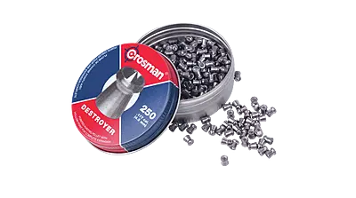

      I don’t have experience with any .22 pellets. But I’ve used a .177 air rifle with these destroyer pellets for the past 10+ years on pests, they do wonders.
      I’ve taken down countless squirrel, chipmunk, raccoon, groundhog, muskrat, skunk, possum etc. Basically any animal that tries to get in our garbage cans or near the house.
      Maybe you can get similar in .22?
        Those pellets work great at lower velocities. They get a lil unstable at real high velocities. They do hit and carry energy well. The flat face really spreads out on impact. I find it hard to hold a good group at range with that shape especially the faster you shoot them.

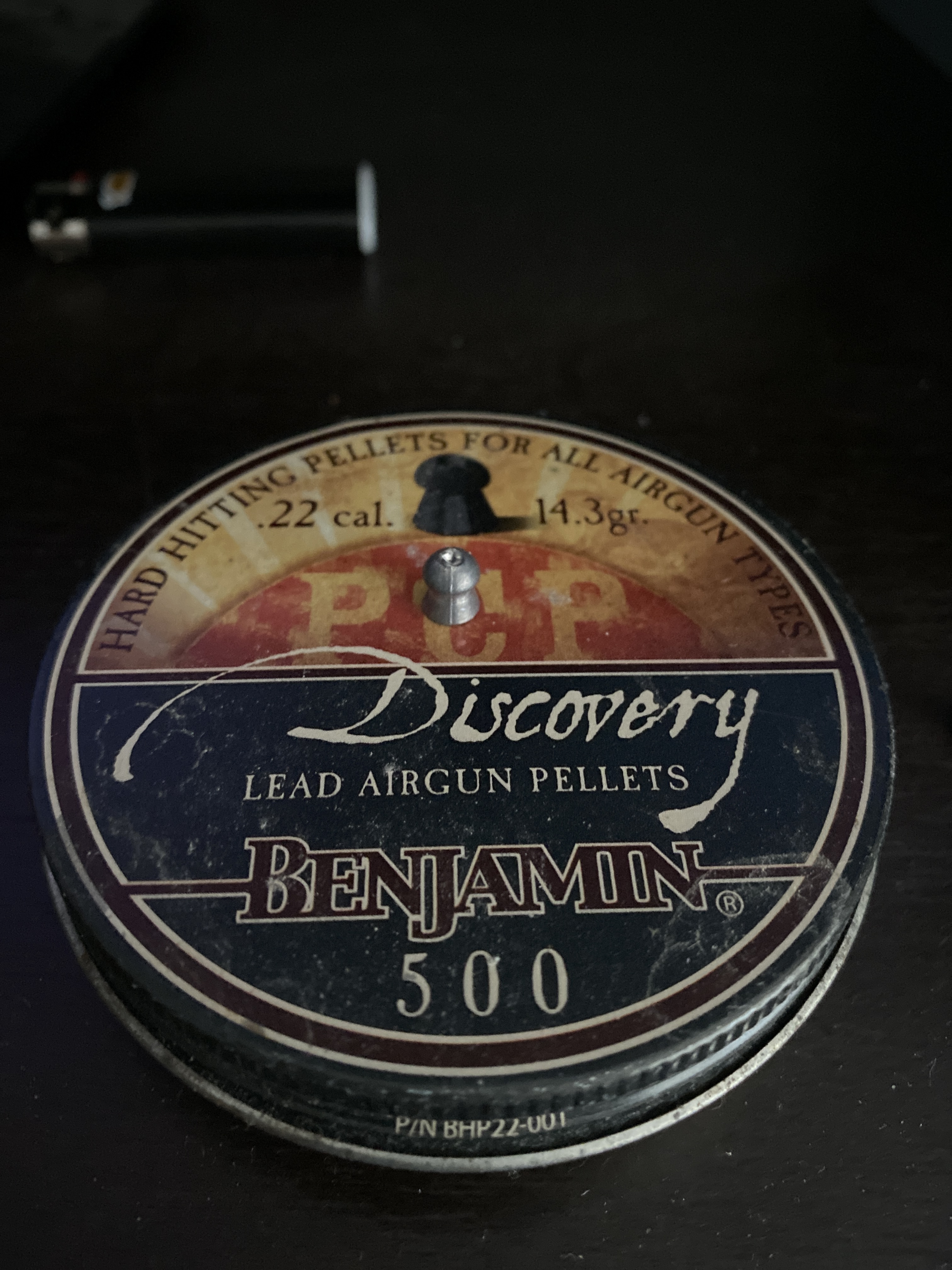

      I have this one in .22 and I really like it. Mine just has a camo stock, But it’s the same thing. Works fantastic. I tried a few different types of ammo I only buy the match grade now. It’s very very accurate and slays large critters one shot out to 50yards no problem. Dead accurate to.
      https://www.pyramydair.com/product/benjamin-trail-np-xl-air-rifle?m=2052&page=1&query=benjamin+trail+np+xl+air +rifle&lang=en&searchConfigId=643645070c547549270c cc15
      I found these to hit wicked hard and shoot super accurate and consistent.

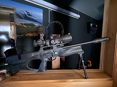

            Depending on how deep you want to dive I into Air Rifles. I have a Walther it has an internal HPA system and takes magazines. Its super short bullpup design makes it very maneuverable for hunting. I use it for squirrel and small game and it shoots amazing.
