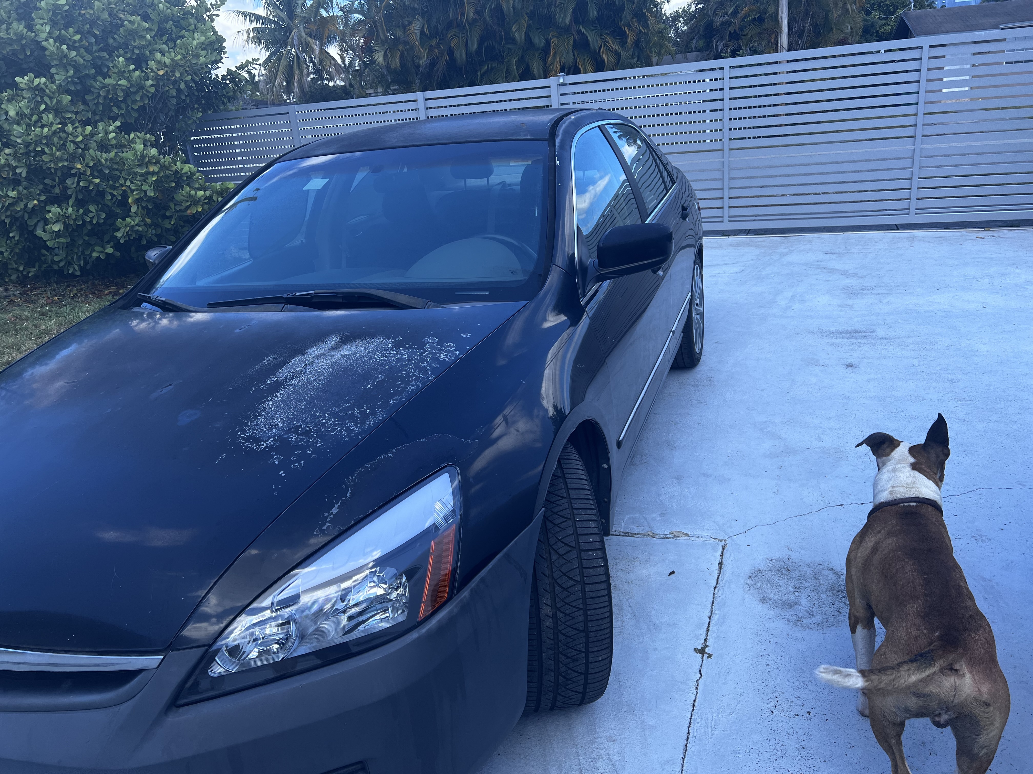

    Hey, I need to paint a project car (7th gen Accord) and I need some recommendations and advice. Disclaimer: I’ve never painted a car before or done any sort of body work. I have been reading online and it looks like my best option is an orbital sander? With 400-2000 sanding pads?
    The clear coat is bubbling and flaking all over and there are sunspots exposing the bare metal. It’s pretty bad. But since it’s a project car that I am gifting to my aunt — and the car isn’t worth anything to begin with, I’m going the DIY route and spray painting it using the high-grade automotive paint. Even if it doesn’t come out perfectly, it’ll still look a hundred times better that what it looks
    like now.
    Any suggestions are appreciated.

    I haven’t done it on a whole car. I have a YouTube degree in diy paint though, lol. You are polishing a turd. You are right. Tape tape tape, then sand sand sand, tac tac tac, and then paint. It will look 1000x better.

        I did prepping part time for a automotive painter (he did a lot of big rigs) many decades ago in HS and the prep work and cleanliness are the most important parts of a paint job. Jack would make us start all over in the prep work if he had a hint we rushed anything. Be patient, let the sand paper do the work, we were never allowed to use machine sanding too easy to screw it up. learn when to do dry and wet sanding they both have purposes. Clean, clean, then clean some more. Take time masking and be detail oriented (razor blade is your friend). That bumper is plastic so there are additives for the paint to make it more flexible once it cures.

        Main thing is prep it all in the prep work. Honestly it might be better for you just to get a cheap HVLP sprayer from harbor freight. You will go through a ton of rattle cans it’s going to be a lot more costly.
        I have seen some great jobs done with just standard spray paint. But there is a lot of sanding between coats. Watch some YouTube videos.

          To go along with what Chuck E Ducky is saying here getting a "cheap sprayer" or borrowing one is the way to go. You can spray outside just got to do it on a very calm day, watch your over spray, and keep the surface as clean as possible. You can setup tarps as a wind block to make an ad-hoc paint booth. Also if you go the way of using a sprayer, find a automotive paint supplier and go talk to them they are usually pretty helpful with recommendations on paint and additives based on your project. Hell they might steer you away from base coat clear coat and go to a single step paint for a project like this. It has been years since I've done any serious painting so I expect there are options out there I am completely unaware of so talk to a good paint shop to get some advice.
