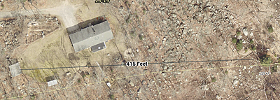

          And both feel obviously wrong. One is barely longer than a football field. The other is over half a mile.
          I think the lower number is closer to the truth. My home field is about 400 feet long, and I can shoot from one side to the other if I angle up a bit. I usually fire a few shots at the start of every match hoping for a lucky hit. I'm not shooting at 45° though. Maybe 30°? So I'm gonna guess that 500 feet is closer to the truth.
          Edit:
          I got more curious and looked at this projectile trajectory calculator from Desmos. I got about 470 feet. BUT I had to guesstimate a bunch of the values, so who knows how accurate that is.
