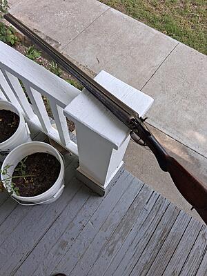

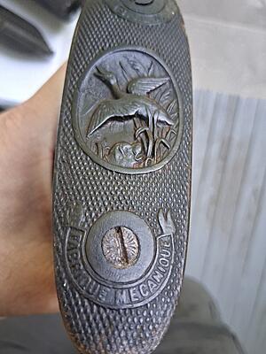

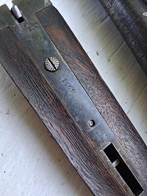

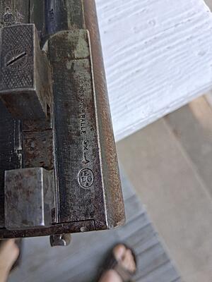

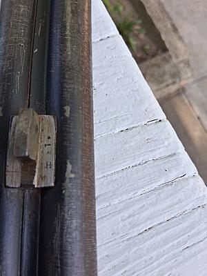

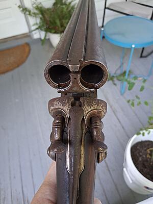

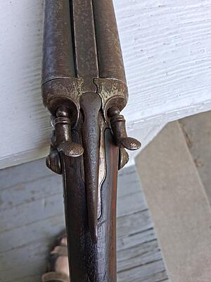

            Hoping this works. (Not used to new phone.)
            Hmmmmm... Not all pics made it, but enough to show the wall hanger.

                Sweet mercy that is beautiful
