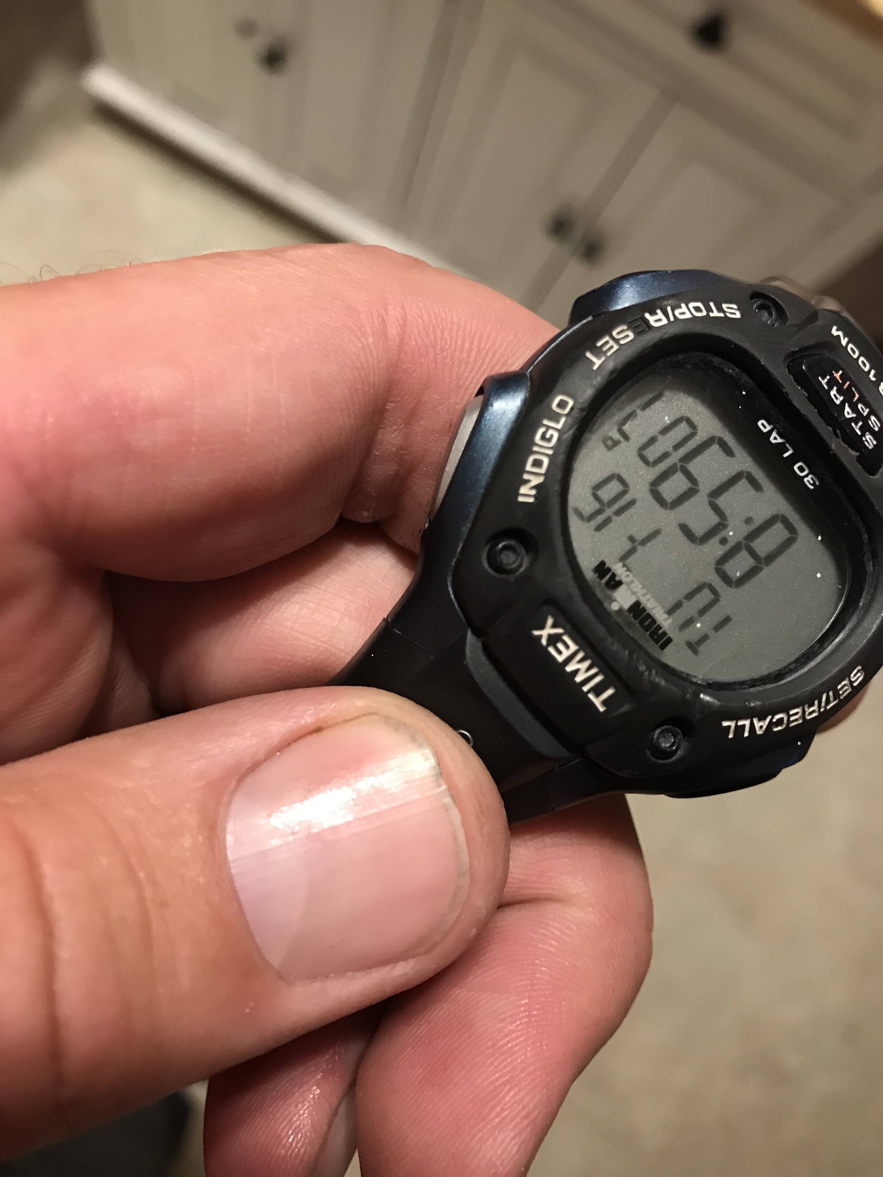

    My son has a Timex watch which he loves. Due to gunk getting in and around the buttons they stick and their functions cannot be used. Any suggestions to resolve this? No banana for scale.

    take it apart and clean it, you should be able to unscrew the backing, dump the guts out and clean around the buttons.

      Seconding. If it was me, I'd try and take it apart, take the battery out, then lightly scrub where needed with a toothbrush and ~90%+ ISO alcohol.

    Had the same issue on a Suunto core. Gotta take it apart and clean the buttons.

      Thank you for the advice. He'll be getting a crash course in taking apart his watch then.
