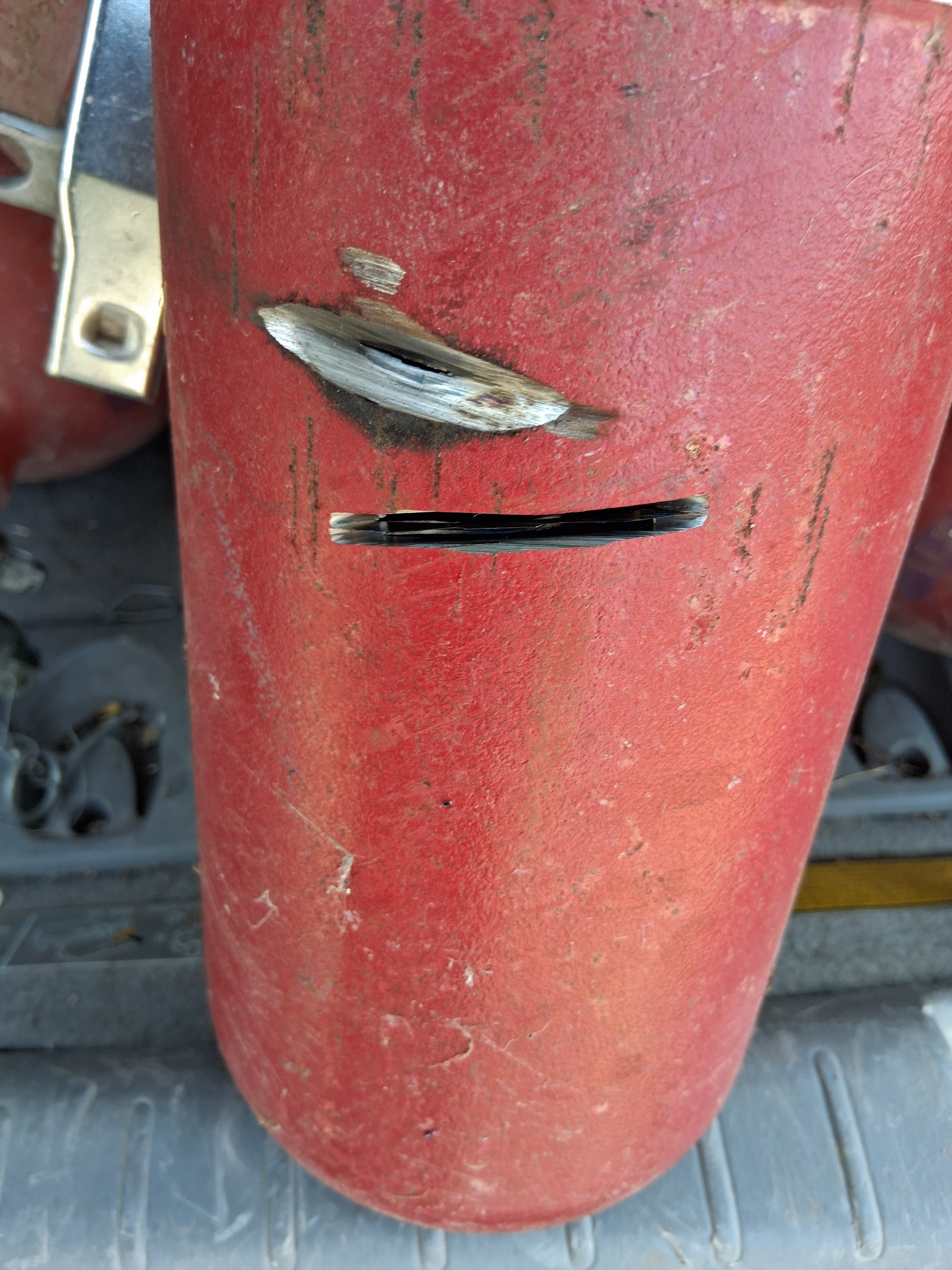

Several years ago I bought a DualSaw CS650 Destroyer when it was on sale. This is the big brother to their original counter rotating blade saw. I don't use it very often, but it is very handy for certain metal cutting jobs. The counter rotating blades work as advertised... no kickback.
In the photo the top cut is obviously from an angle grinder. The bottom is front the DualSaw. Not only is the cut cleaner, but it is much faster. (When extinguisher cylinders are decommissioned you need to immediately see that they can no longer hold pressure. The cut is much easier than jury rigging a way to remove the valve body.)
