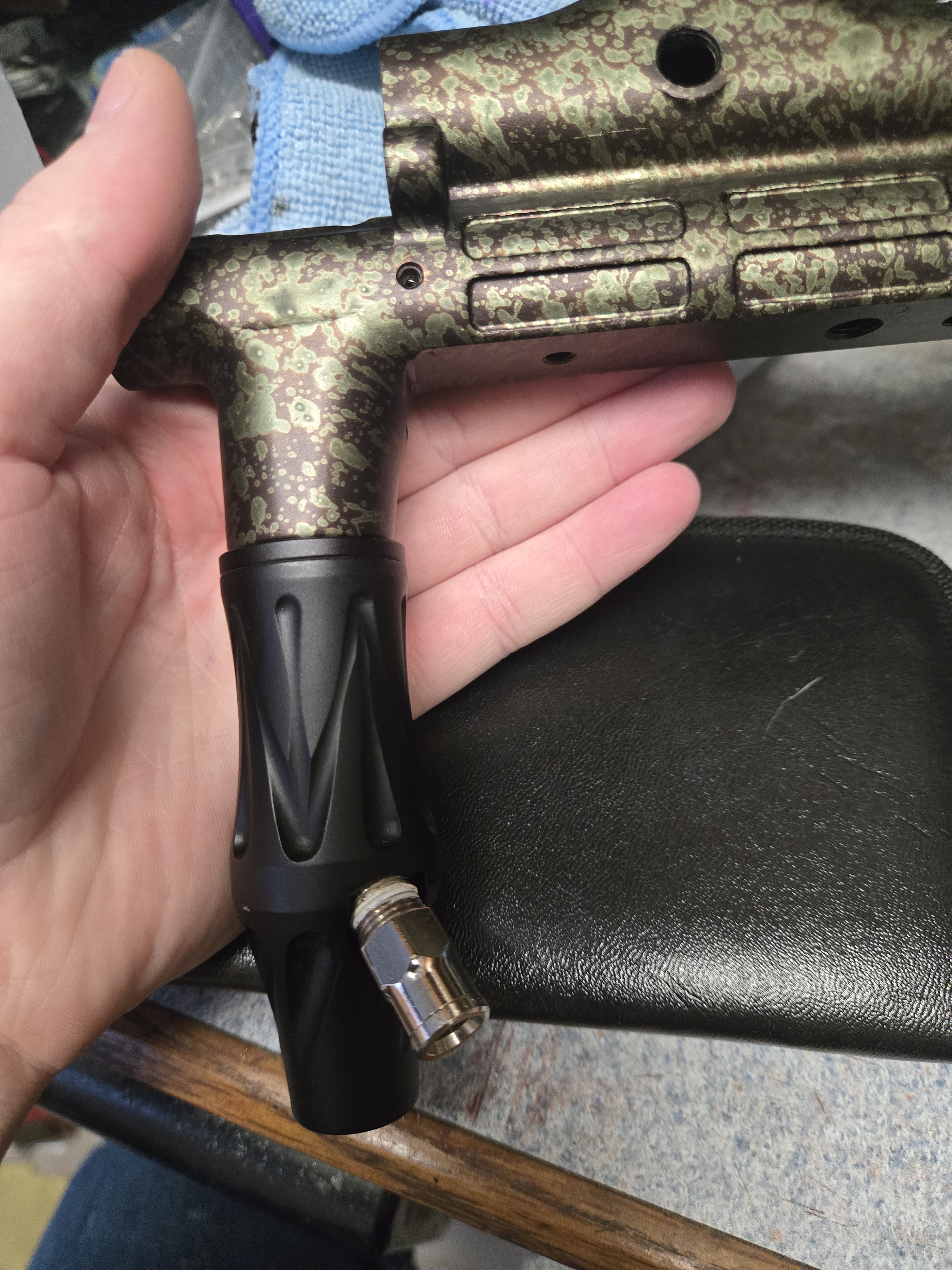

    I was wondering how I could get the fitting for this hpr to line up where I want it to

    I use spacers t he at ninja used to sell for their tank regulators.
    That or just rotate the hpr to where you want it. When it airs up it should be stable.

      You can try to stack a tank o ring in your vasa. Then just clock it back a half a turn and plumb it.
      I've done this, those shims are like the perfect size for it, just make sure they don't block the transfer hole into the marker
      Last time I tried this the o ring bunched up and stuck down into the regulator, basically it completely slipped out of place
        Try a 90 duro oring?

          Big ass o rings till you find the right one.
          Yours is in the worst possible spot though. Almost a whole rotation away from flush to get it right. I'd try to get a different black magic reg and hope for better luck with the thread alignment.
          If it was me I'd use it with a side port CP ASA and it would have an intensional direction from reg to the ASA.
            No actually, I didn't even think of that I'll try it next time

              Also Buff_phroggie those regs, the top portion is threaded into the reg body, between that and the ASA thread into the marker, have you cranked down on it enough?

                Everyrhing just showed up, and appeart to be tight as I can get it by hand
