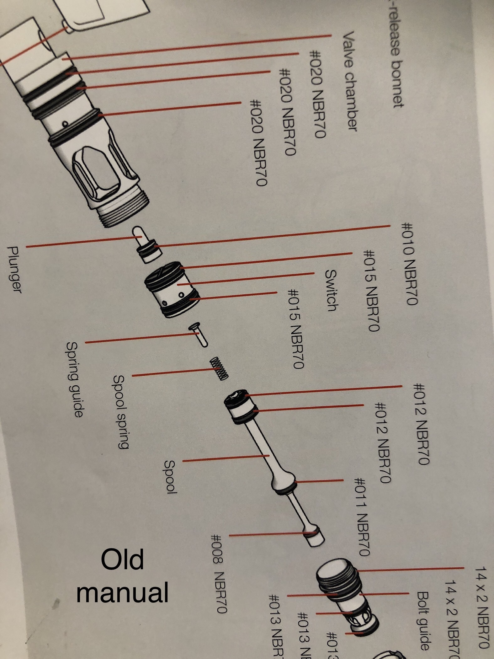

    I just wanted to post this incase someone ever has the same issues as I did.

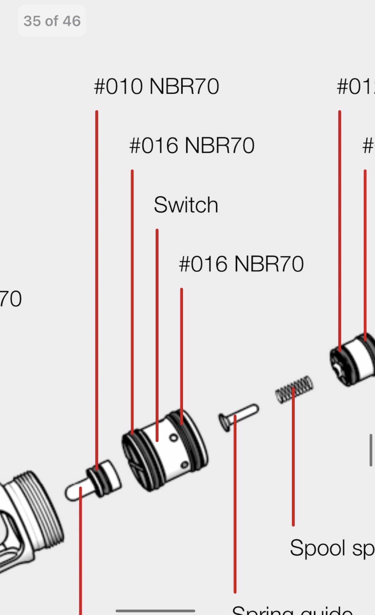

    My original Gtek when converted to Gmek was having issues either shooting full auto or wouldn’t fire at all. The valve would just off gas the air and wouldn’t make it to the bolt. The problem was in the “switch” my old manual shows #15 o rings
    the manual online shows #16 o rings. Changed them to #16 It works great now, also deadlywinds makes a hair valve for the original Gmek and its butter.

      I had that switch issue on my 170R a while back. Took forever to notice the typo for 015 and 016 orings.

        I think it was in a jack wood video too, where he mentioned it. Good call out though.

          Oh good catch. I ended up buying an entirely new switch for my gmek
