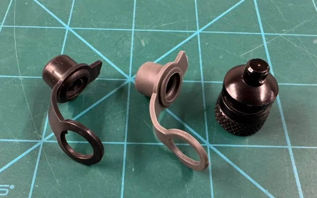

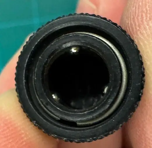

          old aluminum 32 degrees or maybe was extreme rage brand is what you want. It's not magnetic but a ball bearing collar ring thingy.
          Click image for larger version  Name:	fnc2.webp Views:	0 Size:	16.2 KB ID:	759700
          Click image for larger version  Name:	fnc.webp Views:	0 Size:	51.3 KB ID:	759698

            I like the cheap ones like you're already using. I do have a spare quick-connect (metal, like what Carp posted) if you want it for the cost of postage.
