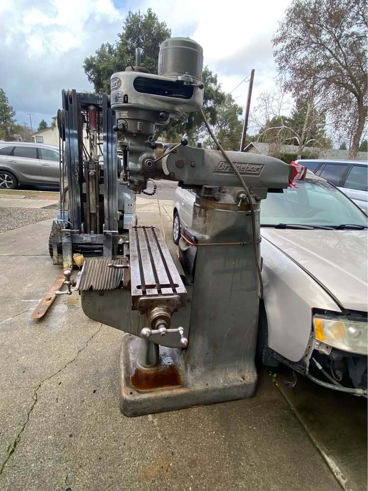

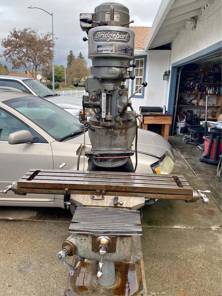

    looking for opinions from the MCB community. 3 phase bridgeport - $1500. forklift onsite to load big bonus.
    been keeping my eye out causally . what am I looking at here. I know very little. Mainly can it be upgraded a little over time to things like digital readouts etc? or will it be a colossal paperweight. I have other uses for it at my business besides paintball - we do allot of mold-making and the ability to slot and suface things would be great.

    Preface: I'm not a machinist and have never owned a Bridgeport, but have a lot of time on them from engineering school.
    You should be able to put DROs on these pretty easily. I think 4/5 of them at my school were equipped with DROs. I would also get one for home if I had the space (or got rid of my lathe). From what I've researched, these are still good machines and generally better made than the new imported machines in the same price range. But being old machines, they likely have decent wear in the ways and bed and may not hold the same accuracy as new machines (unless you re-grind or scrape the ways).

    Looks wet? Not sure you could give me a machine that has water puddles on it. I don’t want a machine to be the project, but that’s up to you.

          First off, the key issue to ANY machine is condition. The highest-quality brand in the world does you no good if that particular machine is badly worn.
          The flip side of that is, buying pretty much any used machine- especially a cheap one- means there's going to be wear.
          On the third hand (I flunked anatomy class) just because it's worn, doesn't mean you can't do good work with it. It just means doing that good work isn't as easy. My first mill was a badly worn JET mill-drill, and that was good enough to launch my biz.
          Being out in the rain tells me the seller thinks so little of it he doesn't care- so take that as a red flag right there. Check the slide ways- heavy scoring and gouges? Pass. Light but smooth wear? It can be usable.
          One of the biggest benefits of a Bridgeport, unlike a large number of other machines, is that parts are widely available, news and used. You can get aftermarket power feeds, spindle bearings are easy and comparatively inexpensive to find, leadscrews and nuts can be had new or used, you name it.
          By contrast, I have a Spanish-made Exacto mill, made by a company called Anayak. Replacement parts simply don't exist. No one parts them out, no one sells new parts, etc. (Save for common bits like belts, bearings and bolts.)
          It's also worth noting that my Exacto was literally thrown away- junked because it was damaged and they didn't want to fix it. I fixed it and repainted it, and now it's a pretty damn nice machine. Not saying that's going to be the case for that Bridgeport, but that you can get a deal if you're willing to put in a little work.
          On the 3-phase, even if you don't have native power, it's easy as pie to convert. I don't have 3-phase and more than half the machines in my shop are 3Ph, up to an including the 10HP Springfield lathe. Most everything runs a VFD (variable frequency drive, which also adds things like soft start, variable speed and near-instant reverse) and a couple run on a 5HP rotary converter.
          And finally, if it works, and you have need/use of a mill, ANY mill is better than no mill. If you're trying to launch a business with it, you might be a little more discerning, but if you want to get into the game and not break the bank, that doesn't look like all that bad a deal. I'd snag it, clean up the rust and the ways, lube the bejeebers out of it- and buy more bejeebers to boot- plunk on a 2HP Automation Direct VFD, closely inspect and regrease, or replace, the spindle bearings, throw a $400 Chinese glass-scale DRO on it, a cheap import 5" vise, and go to work.

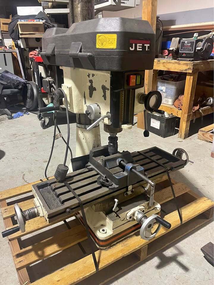

            that said, this also popped up on FB marketplace locally.... this is what got you started!? 1,500 seams steep considering the bridgeport....

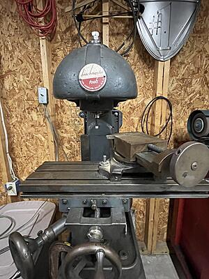

            I ended up going with this old benchmaster from 1947. It weighs about 350 pounds all together and does everything I've wanted to do paintball projects wise. I think I paid 875 for this one on marketplace at the time and took another couple hundred to get a collet set and some mill bits and been playing with it since. If i was looking for another mill or recommending one, I'd say try to find one like this.
                -Mine was an older variable-speed model, but yeah, basically an R8 mill-drill.
                As for the cost? Chances are that M/D has considerably less use, and thus less wear, than the Bridgeport. But, speaking personally, with only a few exceptions, I'd personally rather than a lightly worn Bridgeport than a near-new mill-drill. Or rather, any knee mill rather than a round-column mill-drill. I fought for years with trying to hold or re-find "zero" after adjusting the head height on a M/D.
                Either one of those machines would likely serve you reasonably well as a 'starter' mill.
