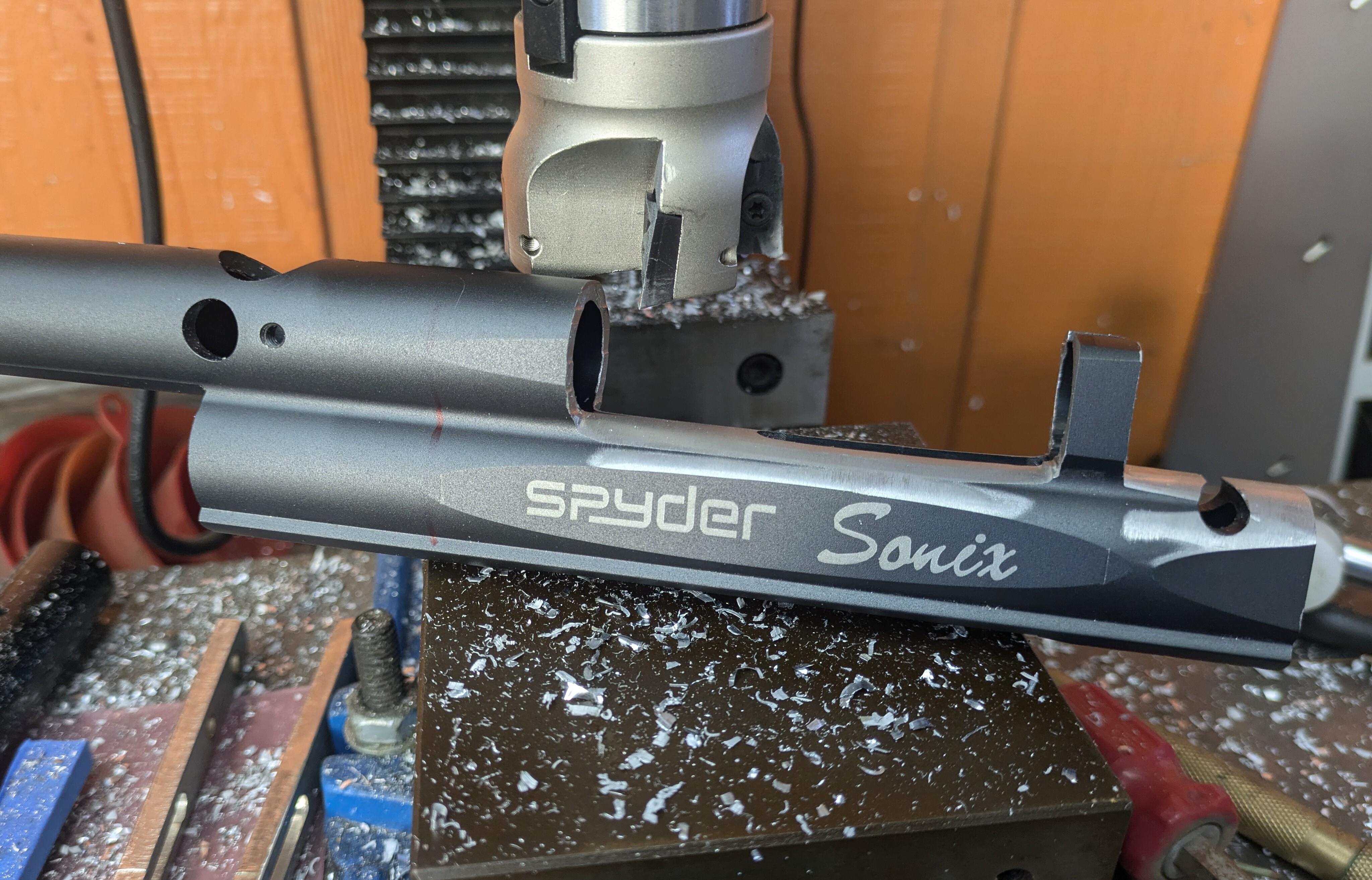

    Got the body cut up, and had to smooth the back of the bolt out so that brings me to 3.
    I didn't do the window around the hammer because the test spider body I had laying around ended up in the scrap ... Didn't want to take the risk to scrap this one too 😅
    This is before deburring and smoothing things out.

      Wow this looks so cool!
      XEMON commented
      Thanks
      I'll take a picture with it re-assembled for record

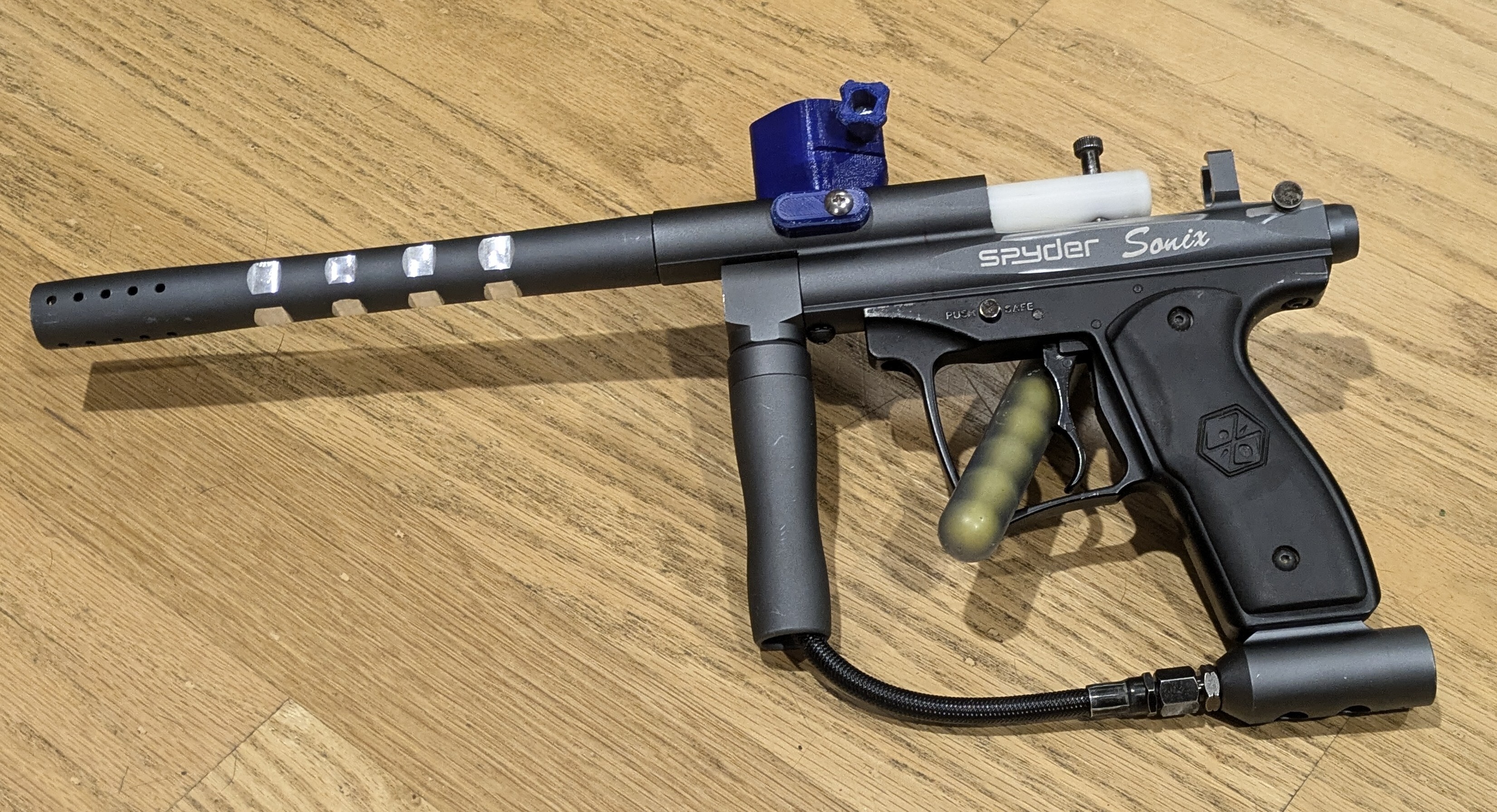

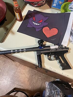

        Not quite finished, but can ya pickup what I’m throwing down?
        A stroke of luck, my millenium frame wasn’t playing nice with my victor spump, but found a better home here anyway. Gonna use the HPR so we can put in the softest hammer spring someone else included.
        I love the 3d print feedneck but I had a spare sconi one that a new player can do new player stuff with haha.
        I seem to be last in line, but I feel like we need more input, so I am gonna tell the fellas at the local field to bring parts to our next meeting on January 11th.
        That will give me a good chance to test our little Frankenstein in battle and shake out any potential issues.
        Then I’ll clean and degrease it as much as I can, and send it disassembled to KMDPB
        If you want to help out without getting your fingers dirty, it could still use a nice ASA, some panel grips like hogue palmswells, or a meme bolt

        I love it! The single trigger frame looks great and the metal feedneck is definitely nicer than my printed one 🤣. I only have spare non-nifty ASAs.
