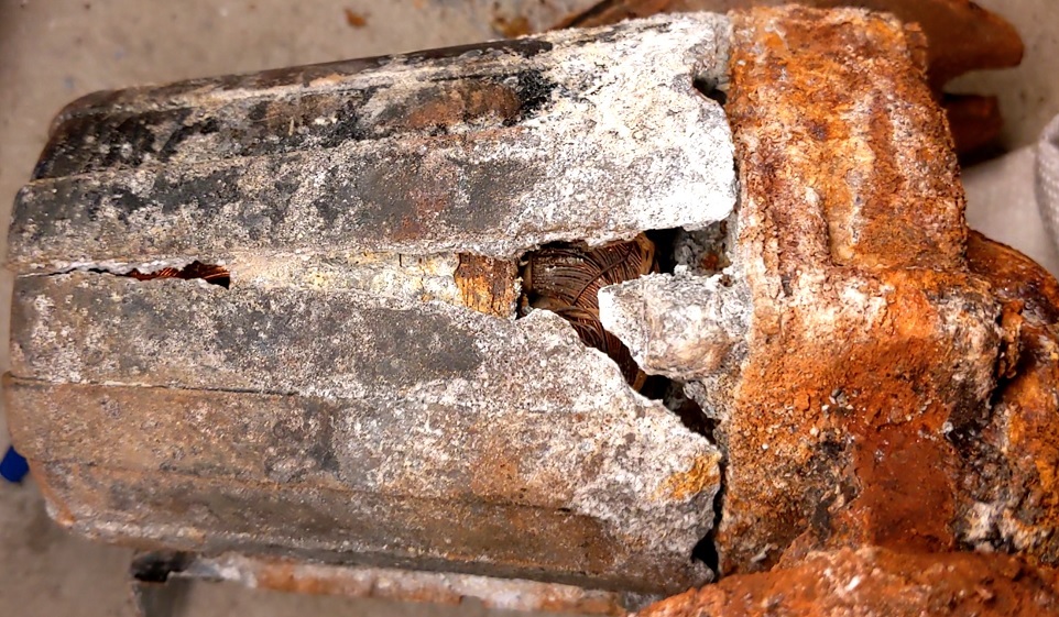

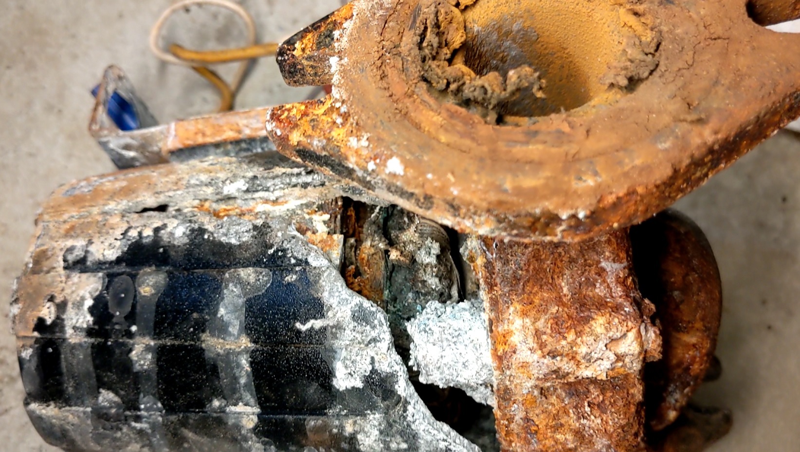

            I just finished swapping out the circulation pump a moment ago. All is running well. It was working surprisingly well off of gravity feed only. Check out the state of the pump I removed... I'm now thinking this entire house has been just gravity feeding for a long time.
            I didn't have the parts to replace the flanges like I wanted to - and add a shut-off valve between it an the boiler - so I had to resurface the existing flanges and hope for the best. Seems to have worked a treat.

              Dude: that's amazing that the thing was even running! if the pump is that sour I'm guessing that you would be better suited to start debating how to re-work that system. as for the Trane systems, if you can go out and find the product number and serial on the information plate on the pump system outside you can identify if it's capable as a heat pump (or can be converted) or if it's just a refrigeration unit.
              Also: as long as your system isn't leaking and water is circulating I wont worry about it too horribly much. if you notice a TON of water hammer in your baseboards (bang, bang, bang!) you need to purge the air from the system. Hopefully that isn't the case.

                Sadly there wasn't a way to shut off water from the system. The only valves within the closed loop at all were the zone control valves... so pretty much the entire system drained just so I could pull the pump off. Took quite a while to bleed since there wasn't a drain or outside access within reach of a hose. I was carting buckets about 80yrds away. Probably best not to dump all of the sediment and junk into the septic anyway. The bleed water was black...black as night. Probably conductive and magnetic; ferrofluid. Had it running somewhat clear by the time all of the air was out. The last boiler I had didn't have a functioning air bleed because it was installed without a vertical columnto collect air. ಠ_ಠ I was pleased to find that this one works well for getting out the remaining little bubbles. It's silent now, so I'm not even going to bother checking the baseboards.
                With the old pump, we had a ~8deg differential between bedrooms on a single zone, and now there is a 2deg differential. I'm seriously doubting that old pump was working since we first moved into the house. What's frustating is that the aquastat was replaced a year or so ago and they hooked it up to this pump.... there's no way that much corrosion happened due to a seeping leak in that amount of time.
