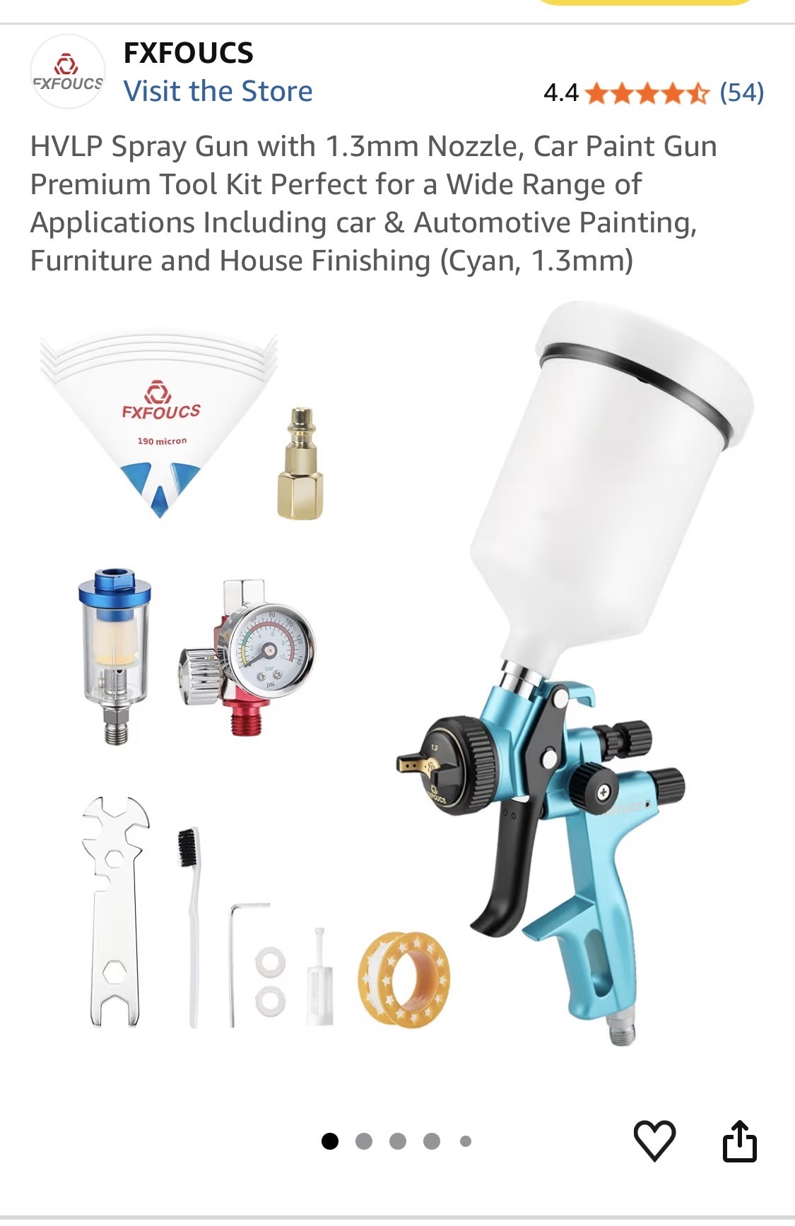

    Hey, can you guys help me figure out how to hook up an industrial/automotive spray gun to an Iwata compressor?
    i believe the compressor is 1/8 BSPT and the gun is 1/4 NPT?
    The Amazon listing doesn’t say but they all seem to be 1/4 NPT:

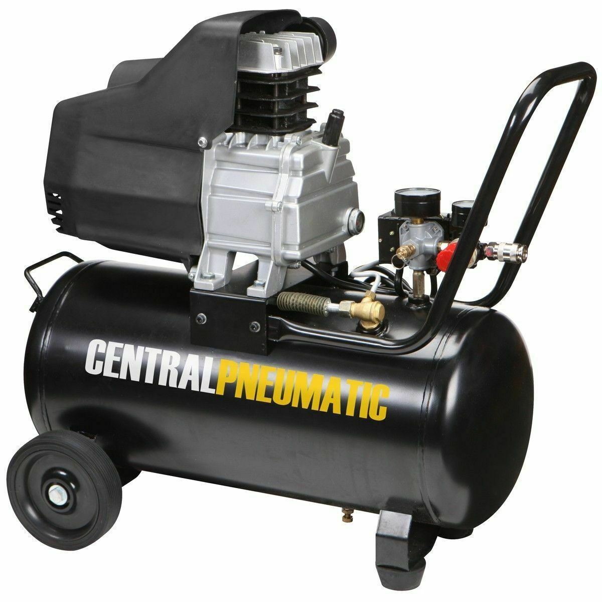

          Click image for larger version  Name:	IMG_6241.jpg Views:	0 Size:	123.4 KB ID:	825417I’m not a professional painter but I’d just use a normal Harbor Freight compressor with the biggest tank on it I could afford/made space for. Such a thing would also work for an an airbrush as well but it will be louder than hell. For my airbrush I have an Iwatta Silver Jet but for anything bigger I’d use something very similar to this.

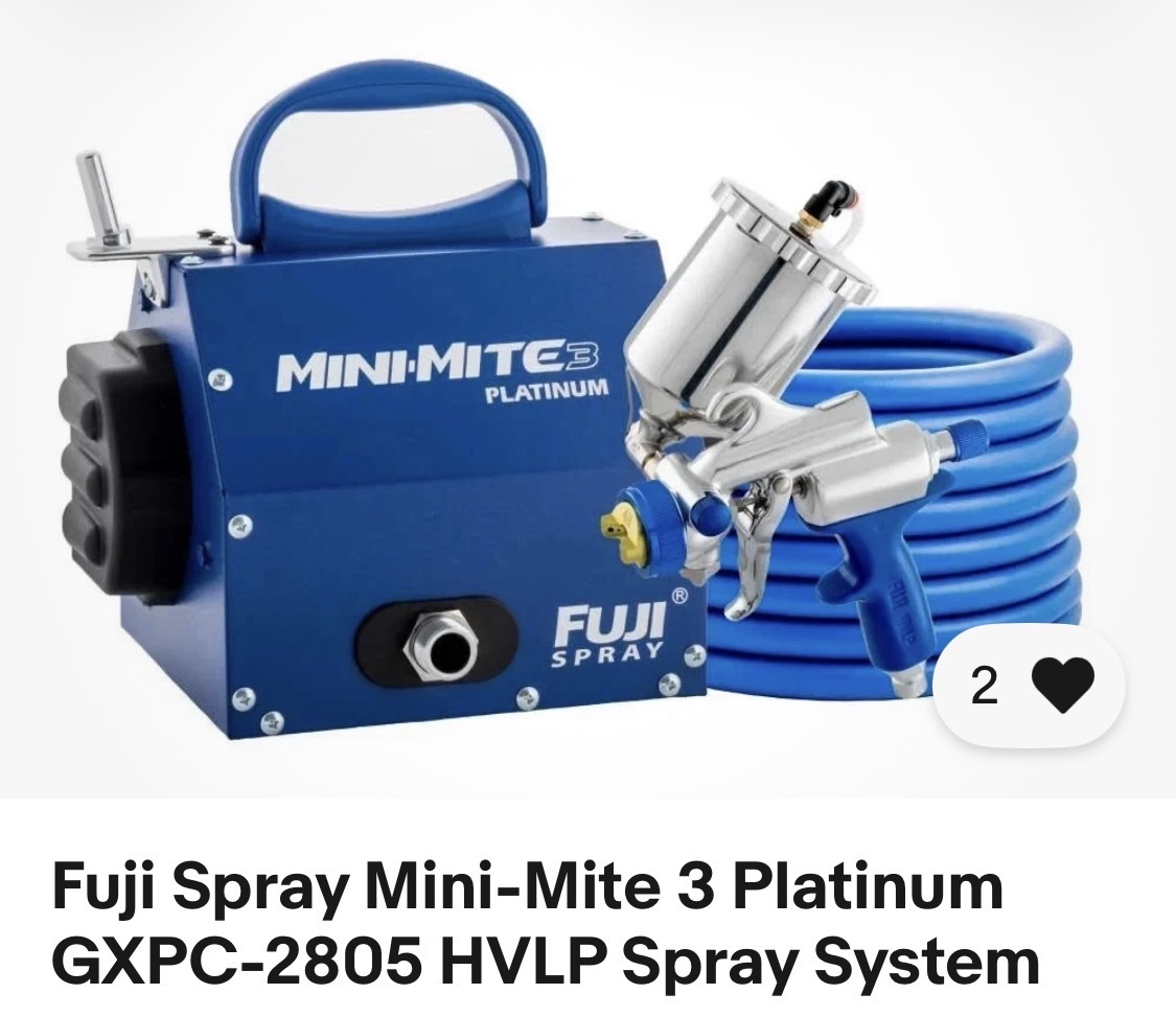

              Which Fuji model did you get? flyweightnate I read up on them a little. They’re highly recommended, it seems. I wasnt expecting to spend that much on one — but it might be worthwhile to just bite the bullet for future projects.

                I have an older 3-stage (Q3) and it's pretty good for laquers, etc. and quality oils; alkyd hybrids work with some care. Latex needs 4 or 5 stage, but a cheap $100 Wagner is good enough for walls.
                The Fuji guns are excellent. Far less overspray than most compressor guns. I did cabinetry with mine and it was far better than I - all issues were user error.

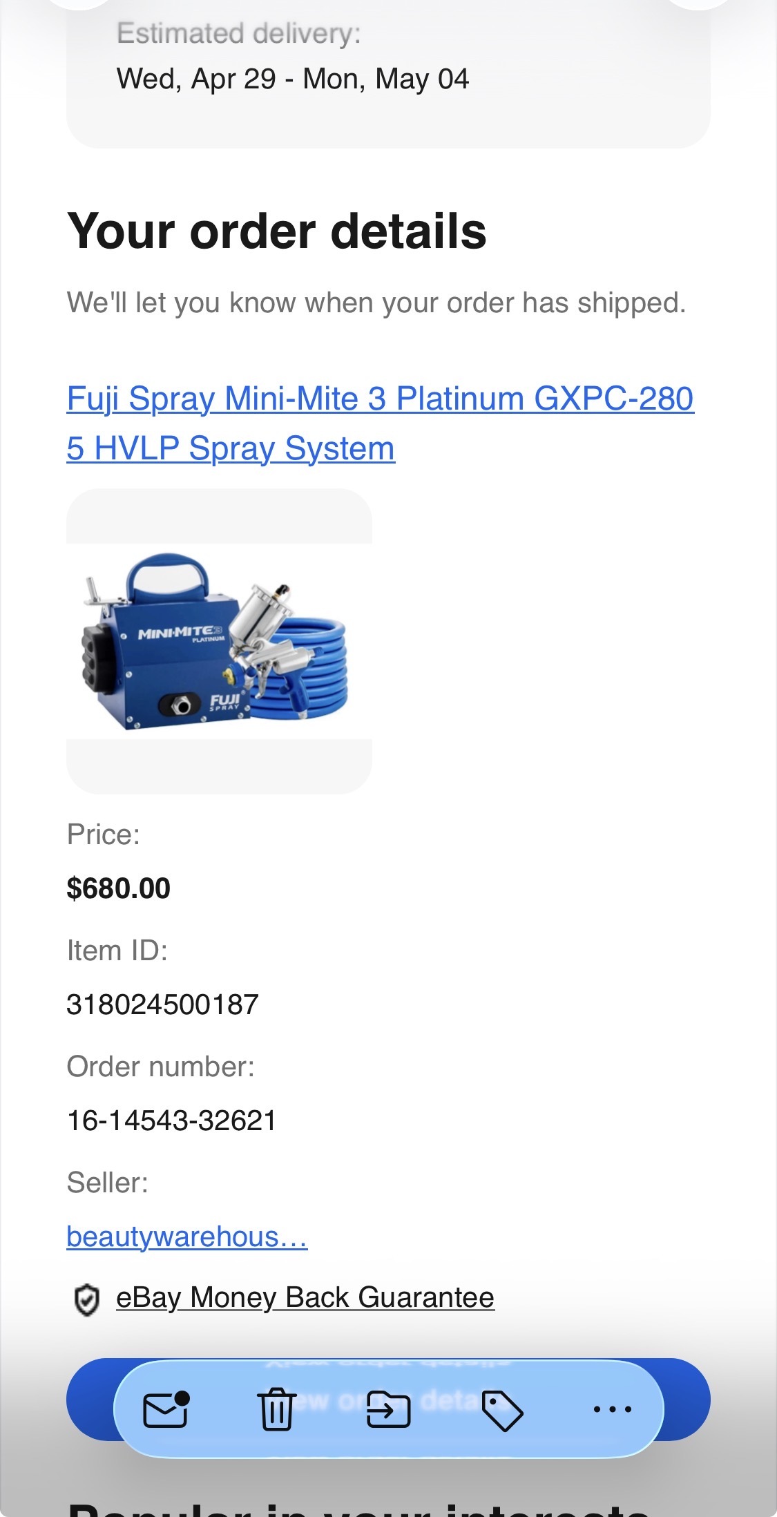

                  i got a good deal on a Mini Mite 3 (new/ open box) but it has the gravity spray gun with the side feed?
                  I noticed this particular one has three different spray gun options. Is there one you think is superior?

                    Gravity is great for most situations. It just needs to be refilled more often, but cleanup is far less complex. No siphon tubes, strainers, check valves, etc.
                    Compared against spending at least that on a compressor that can run a typical gun, I think you'll be pretty happy.
                    That part number is for a 5 stage. Might be worth checking which air cap it comes with; matching the air cap and needle to the product is key to get the best possible finish. The more stages, the wider the range of caps it can run.
                    Phelps Refinishing was THE place for Fuji gear and advice but he fell ill and may have died; I'm not sure exactly where they wound up.
                    Edit: 1.4 (standard) appears to be the recommendation for most good paints and lacquers. Smaller (1.0) is for dyes and waterborne clearcoats, varnishes, etc. Bigger (1.8) for latex and primers.
                    Get a Ford #4 viscosity cup and thin to empty at 25 seconds or less, and it'll be right for the standard nozzle. If it empties in less than 8 seconds, you need to drop a nozzle size. 8-12 seconds, start considering it.
