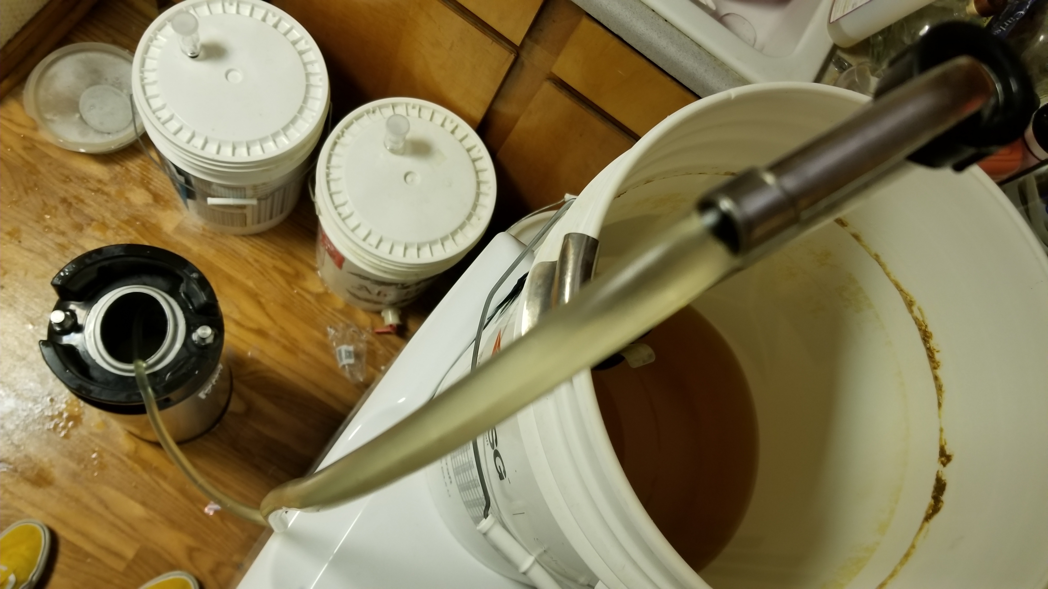

    Kegged some New England Cider tonight. She hit about 11.4% abv.

      OG 1.085, FG 0.998. 5 gal of fresh press cider plus 5lbs of honey, Safale US-04 yeast. A cider Ben Franklin would love.

      Does it taste like it’s 11%?
      For my hard cider I only use apple juice and it ends up in the 6.5-7% range. You can’t taste the alcohol and it goes down smooth.

      This one tastes of crisp, tart, green apples, with a very faint honey wax late finish. It hides every bit of that 22 proof 😎

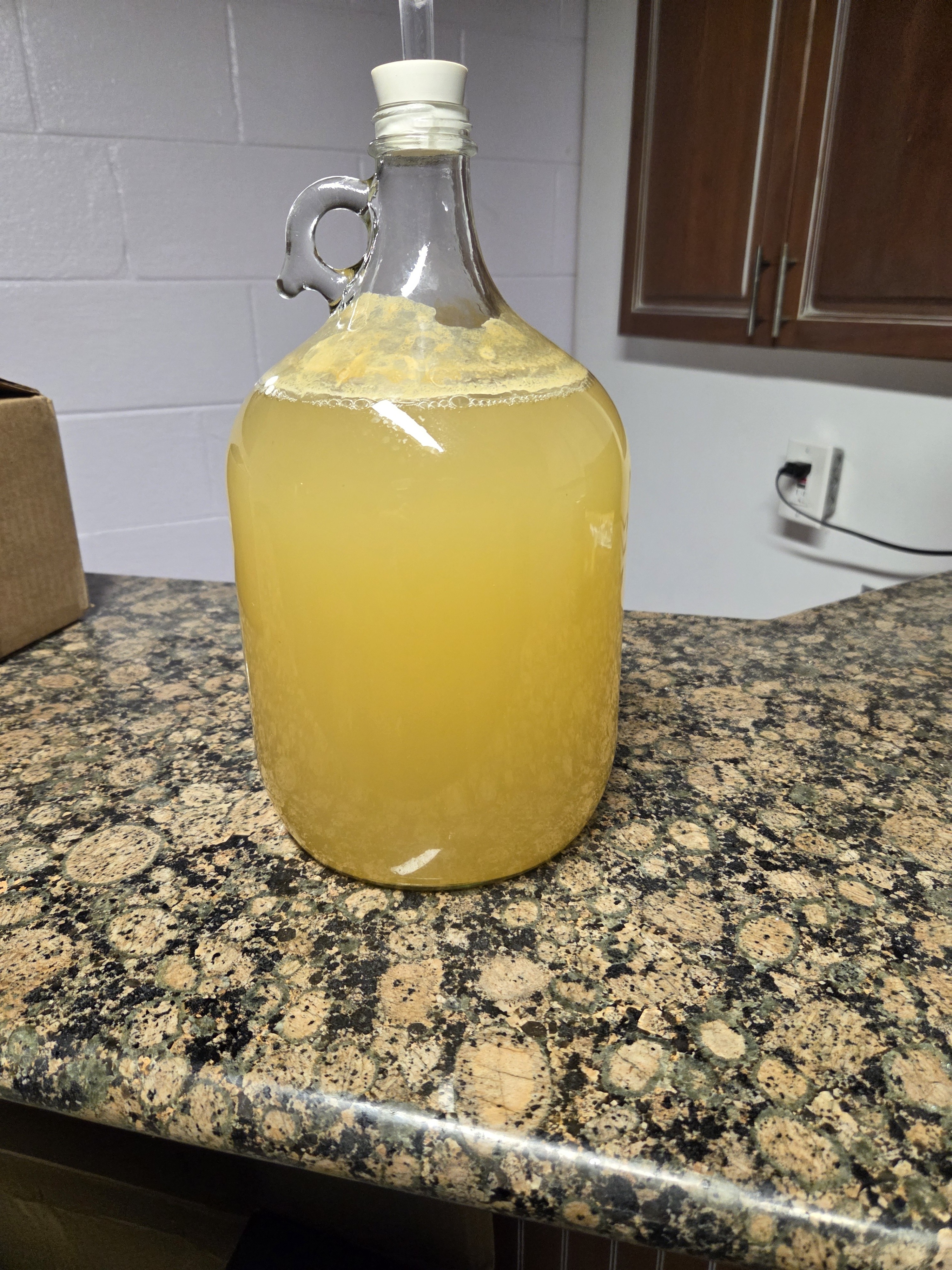

    This cyser has been going for a little over a week now, first ever mead. I didn't get a SG of it when I started (I'll probably start using my hydrometer on the next go around.)
    2.5 LBs of local sourced honey
    1 gallon of local cider
    D47 Lalavin yeast
    I had a few blowouts the first 3 days of brewing(Going to start going to buckets for primary fermentation going forward.)
    Plan is to throw a few cinnamon sticks into the carboy on the last week before bottling for a little spice.
    Debating on nabbing some buckets soon to start the next batch! and maybe another carboy or two!
      Alexndl commented
      At my home depot they have food grad 5 gallo bucket. You can drill a hole in the cap to install your airlock.
      I also have a 3 gallon fermonster and I really like it. They are easy to clean and last long.
      See link for product reference but I did not bough it there as I used a Canadian distributor
      https://www.brewhardware.com/product...fermonster.htm
    • zinger565
      zinger565 commented
      So GotMead.com does have a calculator that can be manipulated to figure out a sort of "expected" OG. Assuming your local cider was the average 1.055 SG (based on various brewing books and my own personal experience), adding 2.5lbs of honey gets you in the neighborhood of 1.145

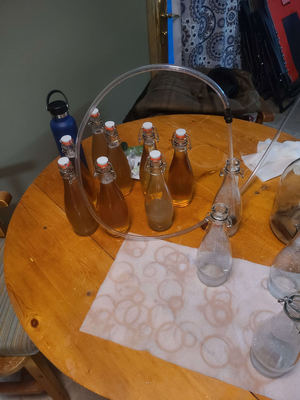

      Hopefully bottling this bad boy tonight! It cleared up quite a bit!

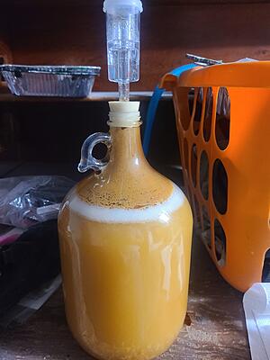

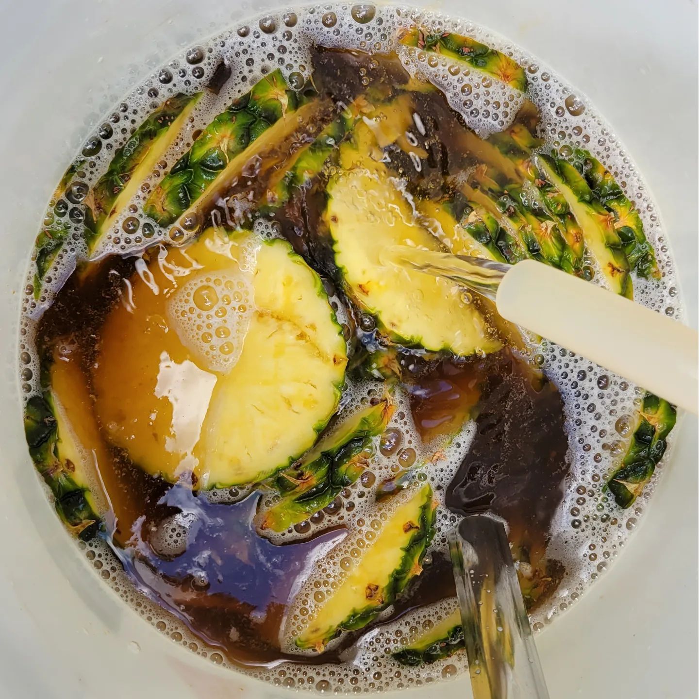

    Been brewing a bunch, but this one is just fun. Tepache, a naturally fermented beverage from the wild microbes on the skin of the pineapple. Typically low abv like kombucha, this one has a bit of extra sugar and some Sav Blanc yeast added in.

      I'll have to pick your brain about this one. I tried making it last year and it didn't ferment properly.

      Throwing a pouch of wine yeast (QA23) and some pectic enzyme to break down the fruit helps.

    The tepache I made ended up at 5%. I didn't calculate any of the sugar from the pineapple so it was probably a little over that. It makes a nice refreshing summer drink.

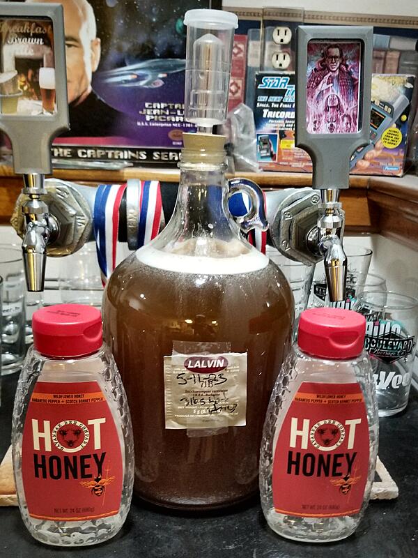

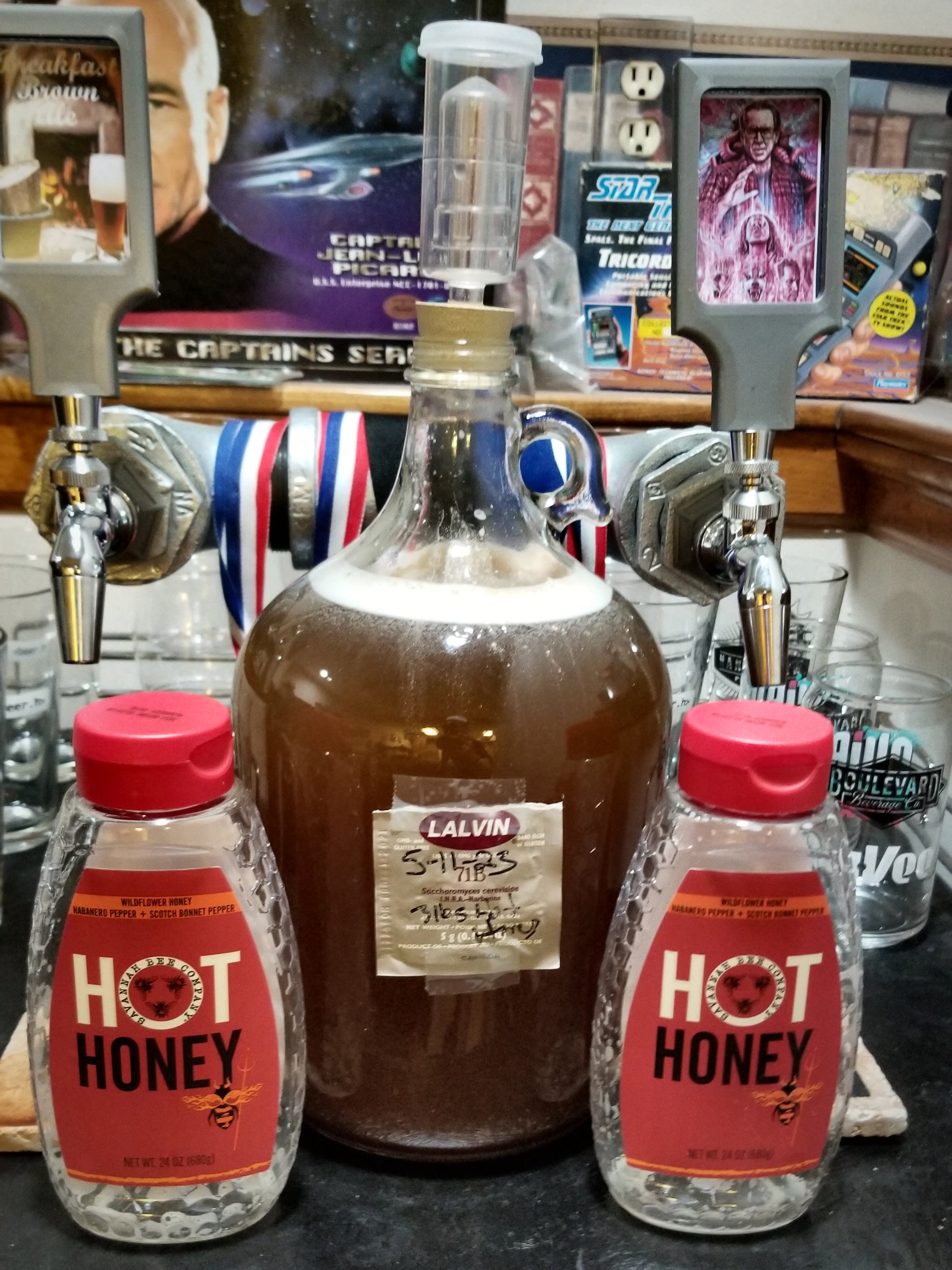

      Found some "hot honey" at Costco so I said "why not" and thought I'd roll a gallon mini batch of capsicumel.

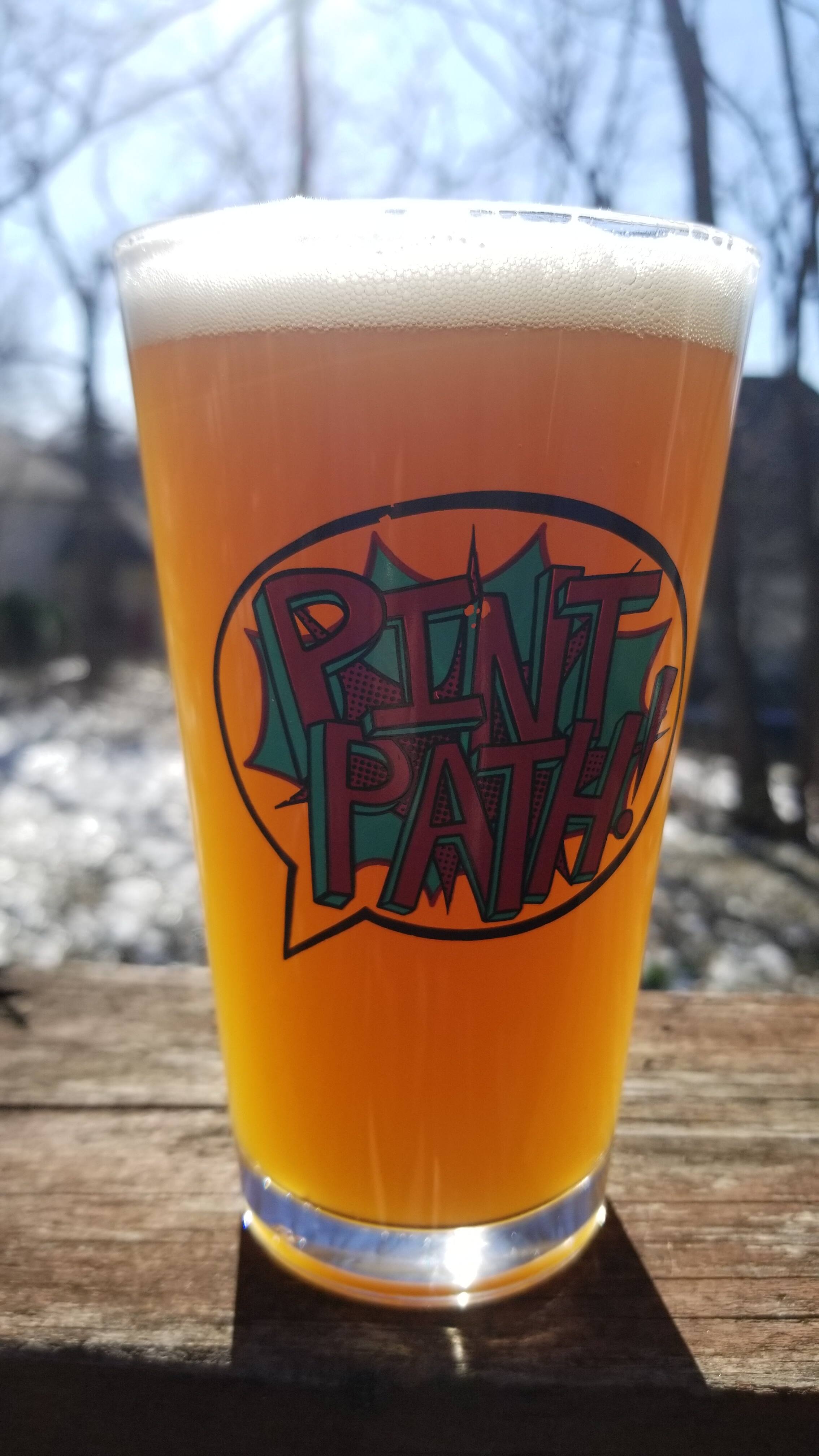

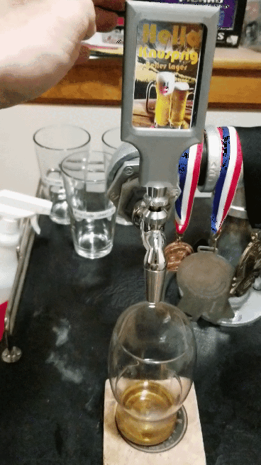

        Dropped a German Helles on tap yesterday. This was a room temp 34/70 lager. Who says you need a fridge to make good lager

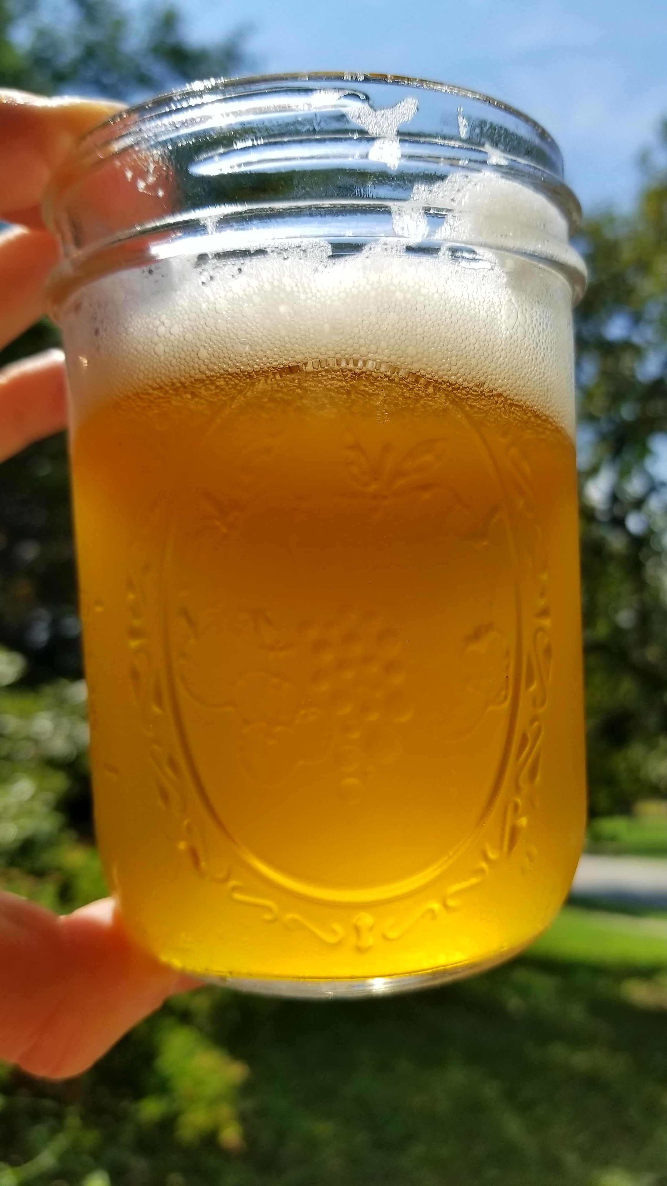

            The Tepache turned out great. A smooth kombucha like funk and crisp pineapple flavor.

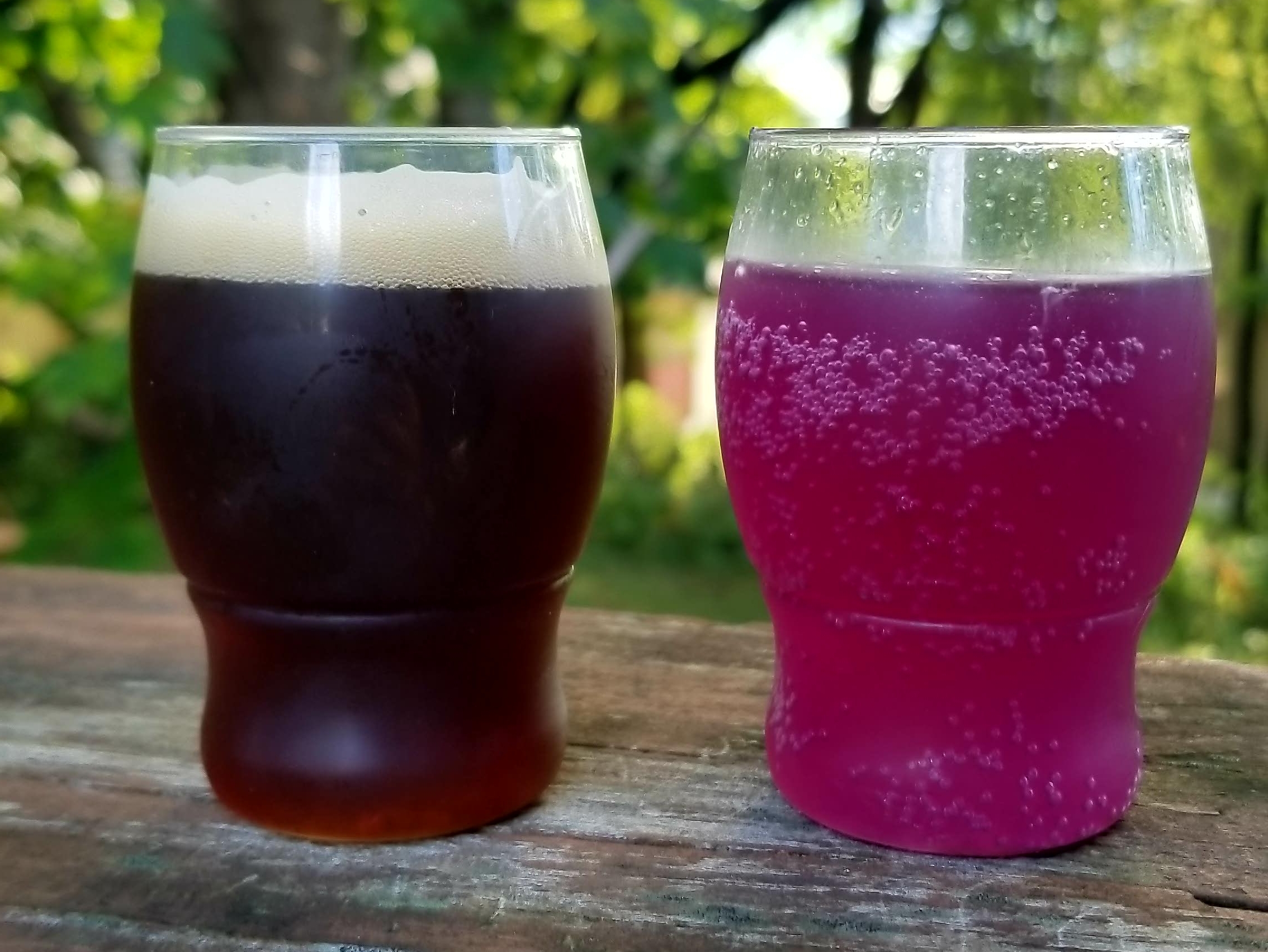

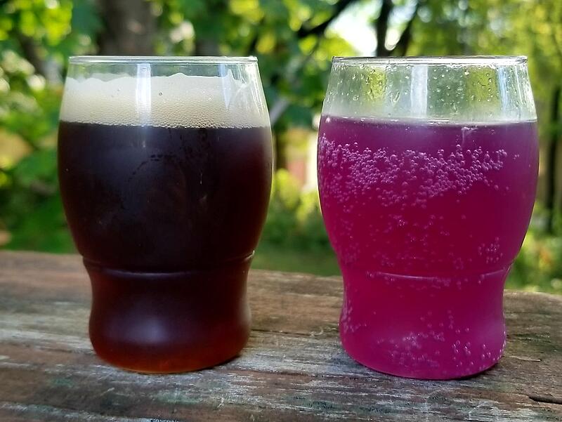

              Sampling some beerfest giveaway brews to make sure they're good to go. A Dark Czech Lager and Citrus Ginger (with Butterdly Pea Berry tea) seltzer. Both crowd pleasers.
