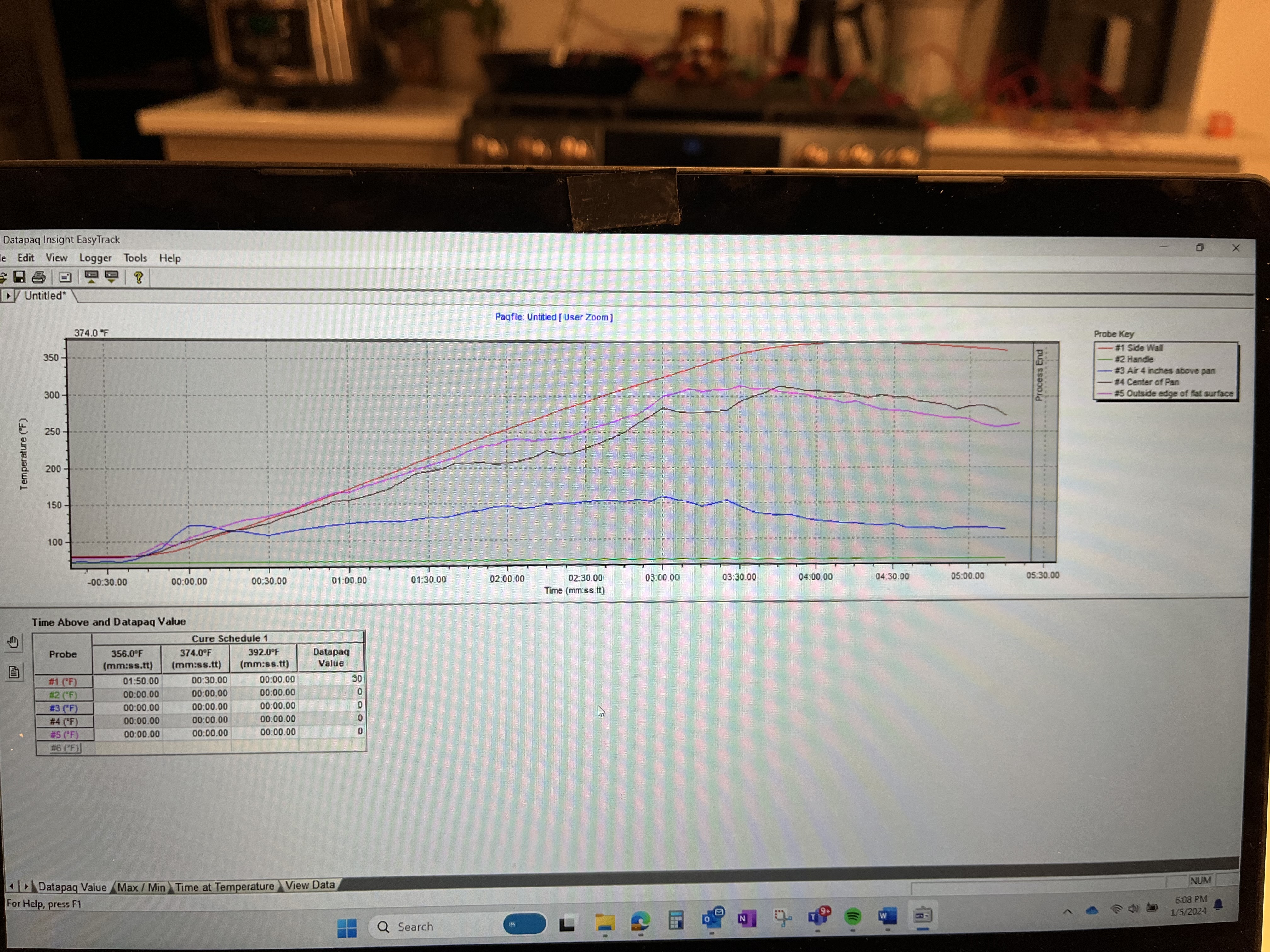

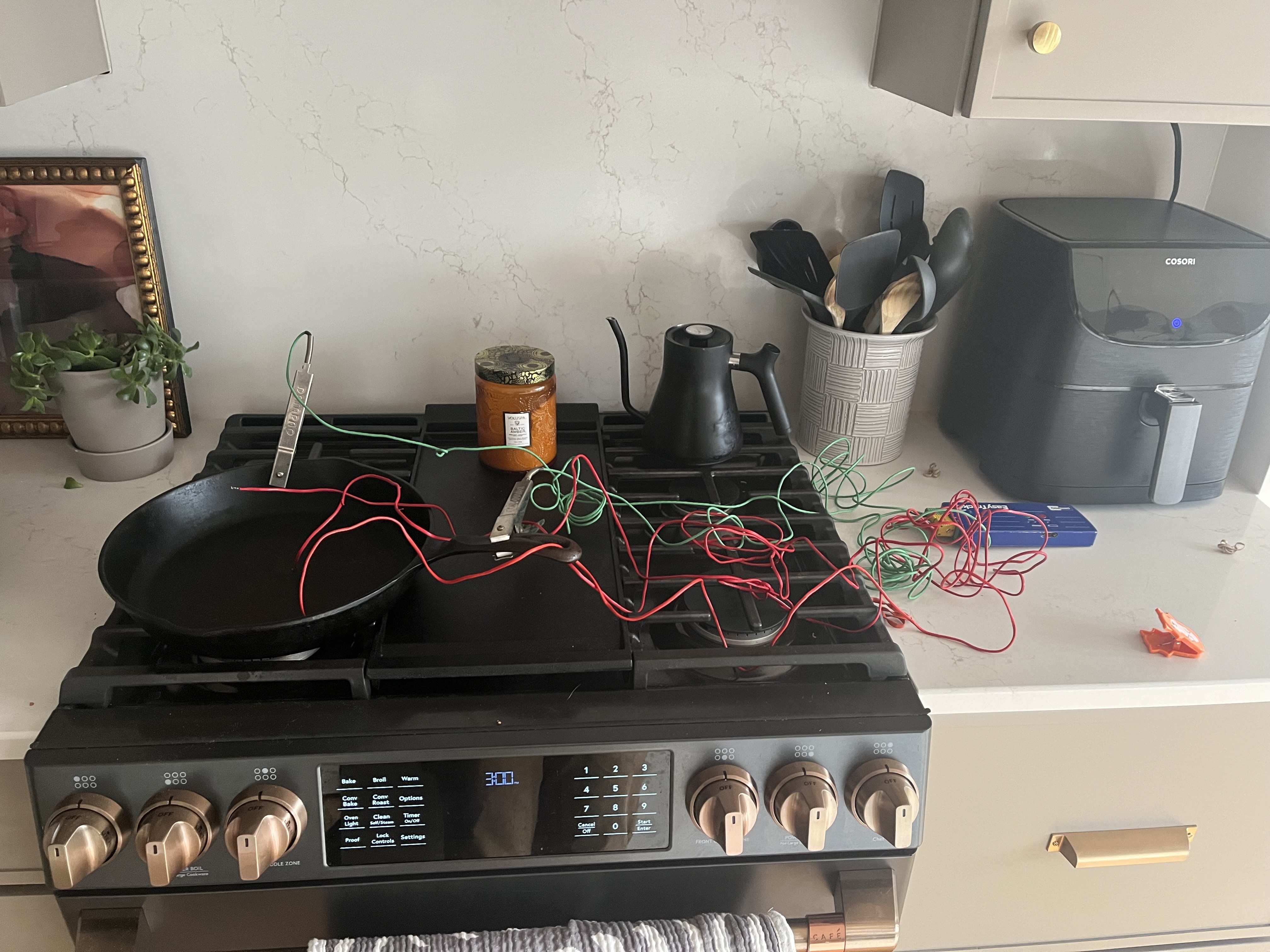

    I have this pan that Ive had for years and use all the time. I also have this high temp thermometer that I use for work, and I had to bring it home to solder on a new 9v holder. So I tore apart a DXS pulse to scavenge a 9v holder (p.s. if anyone wants most of a pulse, it’s yours for shipping costs) and had to test my work.
    I put a thermocouple on the handle, side, center of cooking surface, edge of cooking surface, the air temp above the pan, and outer wall of the pan and heated it up till it started smoking. Then cut the heat (around 3:30) and let it cool for a while.
    Anyway, it looks like the cooking surface does heat pretty evenly. I think that the walls heated up way faster because they’re a thinner gauge metal.

    If it’s heavier it will heat more evenly since the heat from the burner moves into the pan more easier than into the air, and heat from the bottom of the pan moves to other areas of the pan more easily than into the air. That’s the main mechanism at work, although other factors apply.
    Alloy pans are lighter, less massive, fewer electrons to spin up, meaning they absorb heat easily but also work great as heat dissipation to the air. They will heat up faster but shed more, taking heat from the food in theory.
