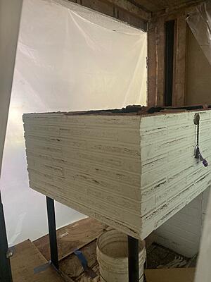

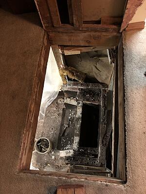

    I’m posting this here because the project was way more expensive than I had anticipated.

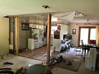

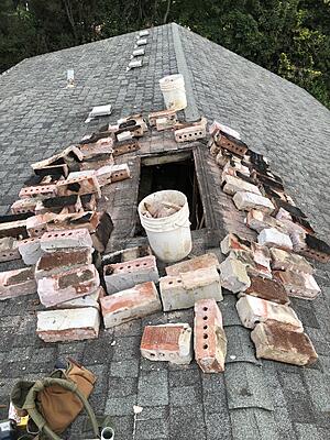

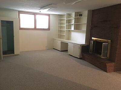

    Over a year ago I started taking out my massive brick fireplace and chimney stack. It was about 9 degrees off square (for aesthetics I presume) and was ~3’ x 5’ (~1x1.5M). This was an inefficient use of space, didn’t heat the house, and looked really outdated.

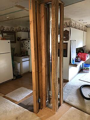

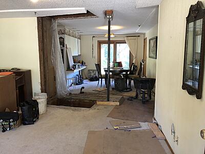

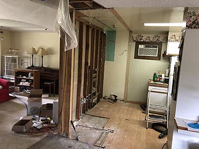

    Turned out the upstairs ceiling was supported by the bricks, and the wife wanted to remove the wall next to it (it was the back of the kitchen, where the original owners installed the laundry hookups.
    • Needed an engineer to spec out beams and posts to support the ceiling
    • ran the plans through the permit system,
    • relocated the laundry to the garage,
    • moved the water supply and drain/vent about 6’ (2M),
    • bring the holes in the roof, ceiling, and floor back to square,

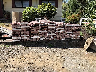

    • dispose of the bricks (thank you, Craigslist!),

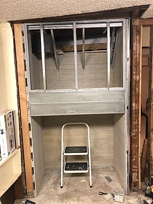

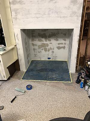

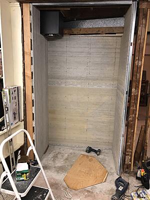

    • figure out which wood stove (1) is compliant with the new 2020 EPA high efficiency standards, (2) would legally fit in the cavity left by the old fireplace , and (3) heat the whole house (only one checked all boxes: the Lopi Evergreen)

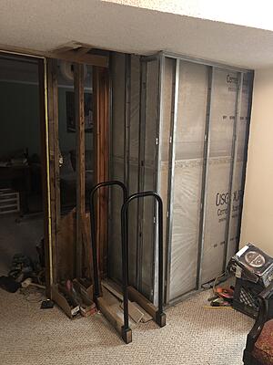

    • designed and built a non-combustible wood stove using metal studs and cement board,
    • painted it with silicate paint because the wife wanted it to look like drywall,
    • tiled the floor with slate (thank you, Craigslist!)
    The architect/engineer was about $6500, the stove and chimney were about $4800, and other supplies probably another $1000. So glad it’s done.
    I just lit my first fire today after removing the first bricks in August of 2021.

      Yeah, you can share the post. The biggest expense was for engineering, and that was a surprise expense. Everyone we spoke to, including a chimney company that quoted us $7k to remove the bricks for us, said “no one would have built the house to rely on the brick for support. Go ahead and remove it.” Only partway through did we realize it was load-bearing for the structure. I did my own work aside from the engineering, so framing, electrical, plumbing, roofing, etc. Saved a bunch of cost but extended the length of the project since I have a full time job.

      If our fireplace had been square with the house and hadn’t created so many choke points at common pathways through the kitchen, dining room, living room, and hallway I would have kept it and put in an insert instead. I love the look of brick and miss it some. The modern look is pretty bleak by comparison, but it’s what the lady wanted.
      Overall I like the change to the upstairs in how much more open it is. Downstairs I would have preferred a brick surround, but I’ve got wood heat and am happy w it. This isn’t our first home and we’ll be here a while.
