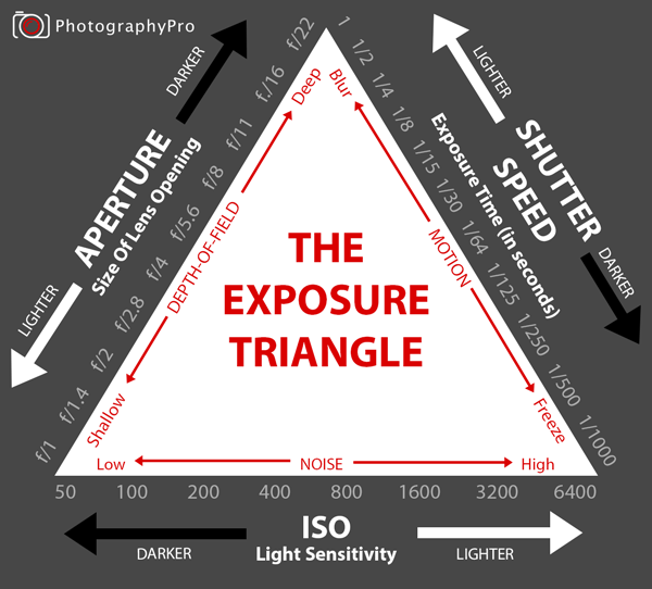

      The three settings to worry about for now are ISO, Shutter Speed, and Aperture. These three together make what people call the Exposure Triangle.
      So lets start with the easiest, ISO. It's a measurement of the sensitivity of your sensor. A bigger number means more sensitive, so the picture gets brighter, but also more noisy, sometimes almost looking like static on the image. In general you want this set as low as you can with out making your image look too dark. For now you can leave this setting on automatic and let the camera pick, but keep an eye on the display to see what it's using. If it keeps jumping up to 6400 or higher when you focus you may need to adjust a different setting, since all three in combination effect the image brightness.
      Next, Shutter Speed. A measurement of how long the shutter is held open when you take the picture. This is measured in fractions of a second. 1/1000 is very fast, and fast moving subjects will appear to freeze in time. But if it's dark out the shutter will need to be held open longer to let enough light onto the sensor. Too long a shutter and you start to get motion blur, or even just blur from you unable to hold the camera still. So faster is generally better. I normally leave this one on automatic until it starts to cause issues. Often I'll accept a darker that usual image as long as it's nice and sharp over a bright blurry image.
      Finally, the one that confuses people the most, Aperture. It's a measurement of how big an opening there is on the back of the lens. And most lenses have an aperture that can close, making that opening smaller. The number, F5, F1.8, etc. but also shown as 1:5, 1:1.8 and so on is based on some odd equation I don't particularly understand, but it boils down to smaller number equals bigger opening. So when you close the aperture the number goes up. Yeah, confusing. So if your image is too bright you can close the aperture, letting less light through, and darken the image. But Aperture effects something else, called the Depth of Field. It's how much of the image is in focus based on distance. A more open aperture (smaller F number) means stuff closer or farther away from what you've focused on will be more out of focus. You want a fancy portrait shot of a person with that fancy blurry background? You need that F number to be as small as you can manage. A big landscape image with stuff both close and far you want to be able to see? Close that aperture down (bigger F number).
      So to summarize, Low ISO = darker, les noisy image. High ISO = lighter, more noisy image.
      High shutter speed = darker, freeze time image. Low shutter speed = brighter, motion blurry image.
      Closed aperture (bigger F number)= darker image, sharper backgrounds. Open aperture (smaller F number)= brighter image, blurry backgrounds.
