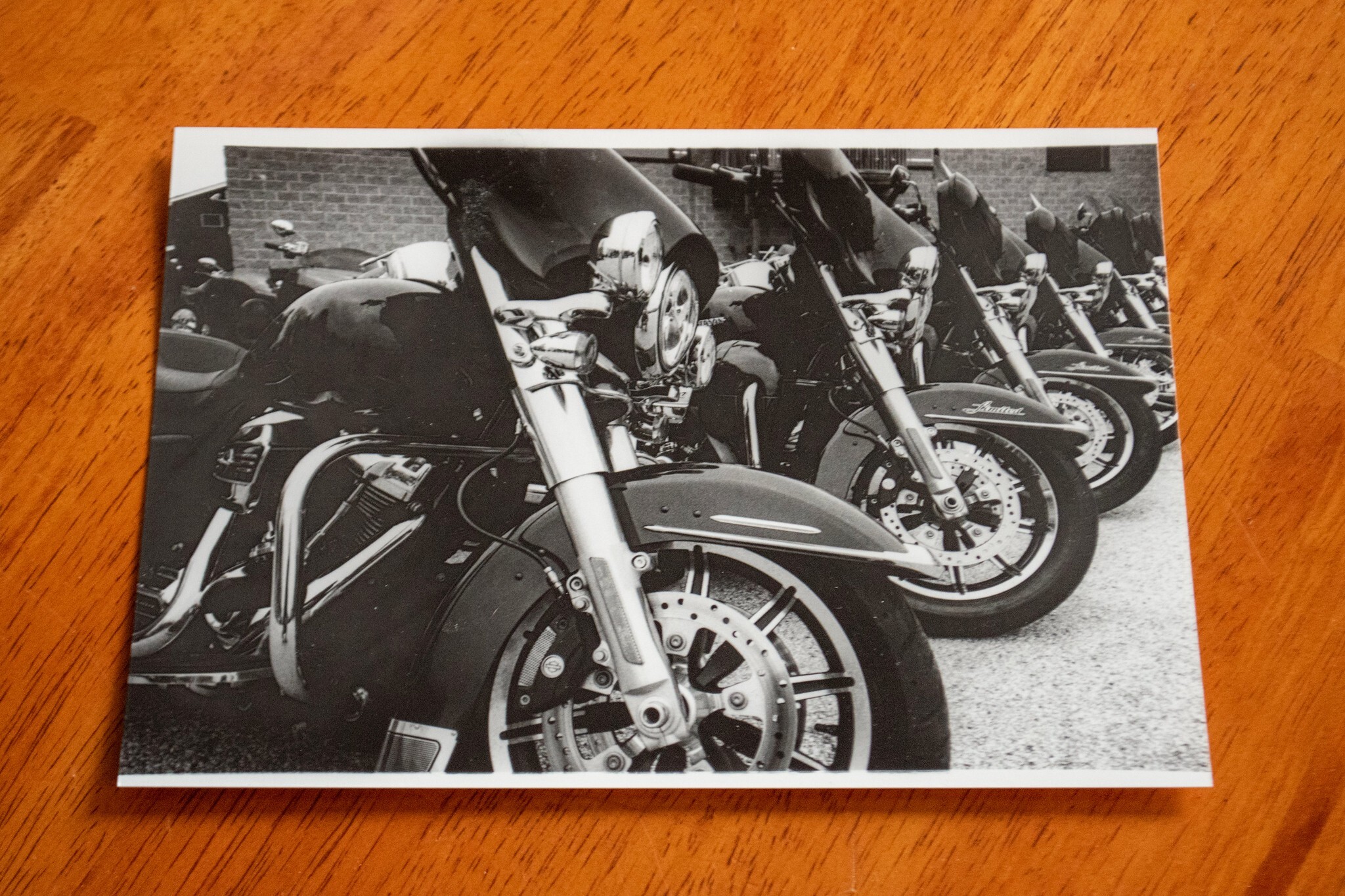

    Roughly a year ago I purchased an enlarger. For those that are not familiar, it is a device with a lens that will shine light through your film negative so you can transfer it onto paper. You Need to develop the paper similarly to the way you develop film.
    I ended up making a make-shift dark room out of an indoor greenhouse and made sure to block out all the light. So far it's been working perfectly. After about 6 tries I finally was able to put this to paper
    The blacks are still a little too dark in areas so I need to cut the time down, but for my first real go at it with only basic knowledge on even what I'm doing, I'm happy with how it came out.
    I realize where my issues are and have some new items coming in to assist me and should be here on Wednesday so I can try this again.
    So this was in a film camera, I developed the film and now I put that developed film onto paper. Amazing all the steps that was once needed to put an image onto paper.

    Nice job, as I said before I loved doing dark room work. A journal of settings/timings and results will help you in the long run and performing test sheets where you do multiple exposures on one sheet of the same image with notes about setting is also good practice. Just remember every time you change paper lots and manufacturers you may need different exposures and times in the baths to get the same results. As an example I like Fuji paper if I wanted a picture to look older then it was; it tended to have browner tones instead of stark blacks.

        I can't recommend enough a stack a heavy paper (old/developed paper works great) with a pair of scissors, some tape and a few things wires to make mask on the fly ... Allow you mask some light from some areas in the middle of the exposure. That was you can manage the difference in contrast.
        Also, does your enlarger have a color head?
        The lens on the enlarger also makes a difference in tone and sharpness...
