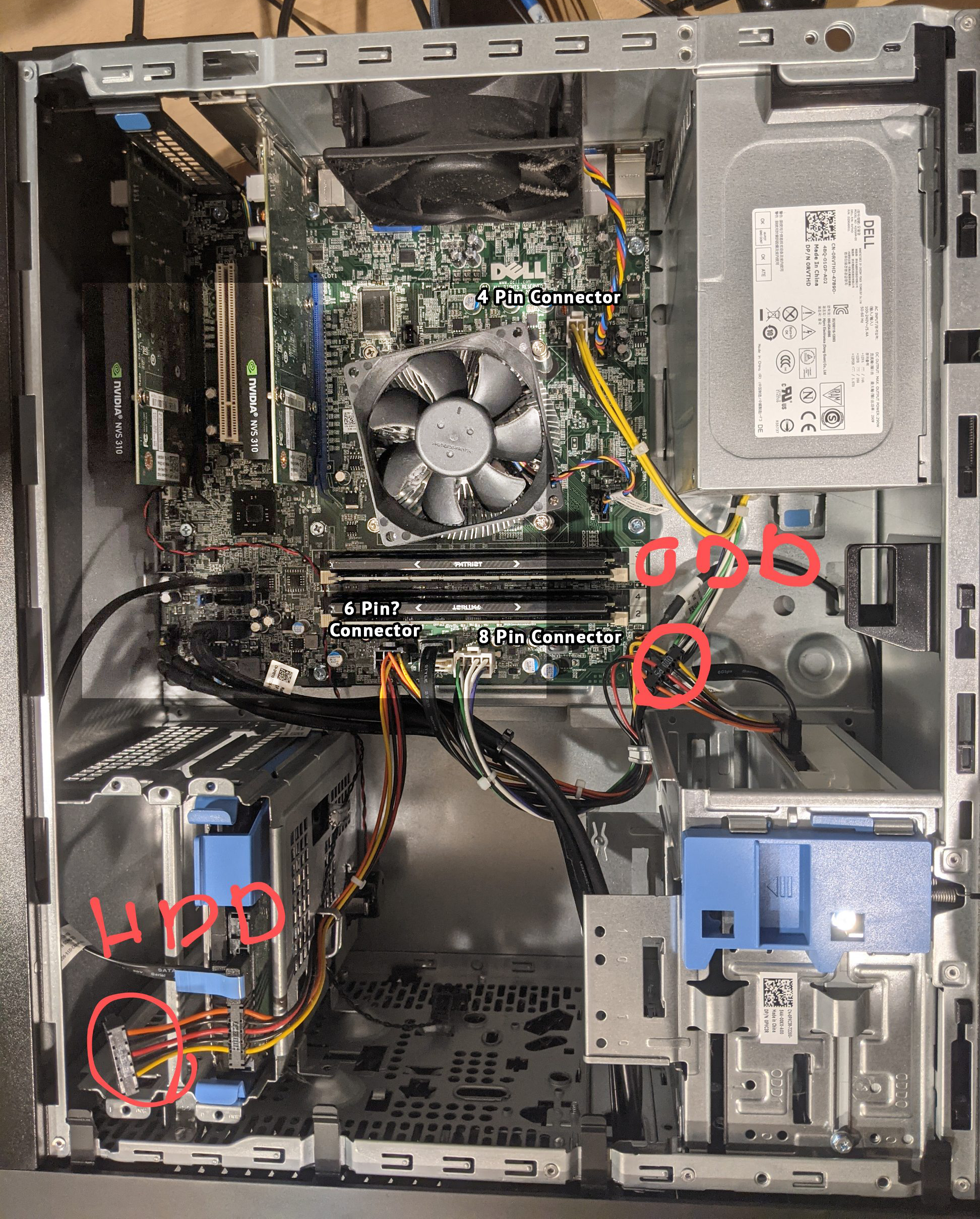

          I was off a little- it is a Dell Precision T1700, not an OptiPlex. Currently has dual Nvidia NVS 310 cards and was built as a Revit/CAD workstation. Photo of the insides attached- it was sent via text, so apologies on the potato quality. I tried to lighten up the area below the video cards and added a couple notes.
          Thanks 🍻

            So server boards are unique. The Spec sheet for that model shows it can run a 150w card in the Gen3 PCIe slot. So technically it could power a GTX1660ti which is a 120w card just from the slot.
            No additional cables needed.
            https://i.dell.com/sites/csdocuments...-Sheet-tab.pdf
            I could be wrong but that's why there is a 6 pin going from the motherboard.
            On standard motherboards the PCIe slot is limited to 75w, but like I said server/workstation boards are very different.
            If it has the xeon e3-1200 as stated in the spec sheet I'm not sure how well it will game. Xeon can be quality CPU's for gaming but they are geared toward accuracy and not so much speed.
            I'd grab only the GPU and see if it works. The PSU is a 255W Gold rated unit. It should power a Xeon, SSD, and a GTX 1660ti just fine.

              He has tried installing the new card and it didn't boot- i'm presuming because there wasn't enough power.
              This is just a work from home system- no gaming being done. All of his gaming takes place on a table top so not too worried on that end. The upgrades are just trying to squeeze some extra performance for Revit without resorting to a new PC.
              Graphics card is an MSI GeForce GTX 1650GTX 1650.

                It won't blow up. It should boot just fine. When you run a program that requires power from the GPU and there is not enough either the GPU driver will crash and you will get black screens which may recover back to windows, or the system will shut down. No risk of damage or anything like that. It will work or it won't.

                There are various sets of adapters that you can (attempt) to use in order to bring a "normal" PSU over to (some of) the Dell units. There are also adapters for (some of) the Dell units that you can use to power on and utilize a standard motherboard, which is what I recommend in this case if even worthwhile to find one for the CPU.
                TBH, keep the (presumably working) Dell in place for sale and start working to budget a standard configuration system.
                I would say that if you insist on staying this course do a search specific to your model and adding GPU. A lot of other stubborn and/or budget bound people are sure to have done it.
