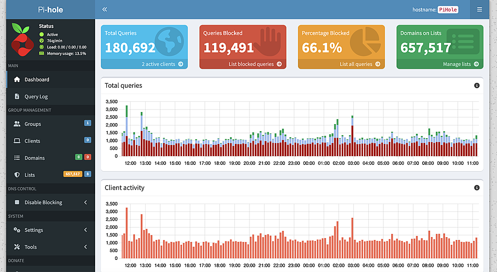

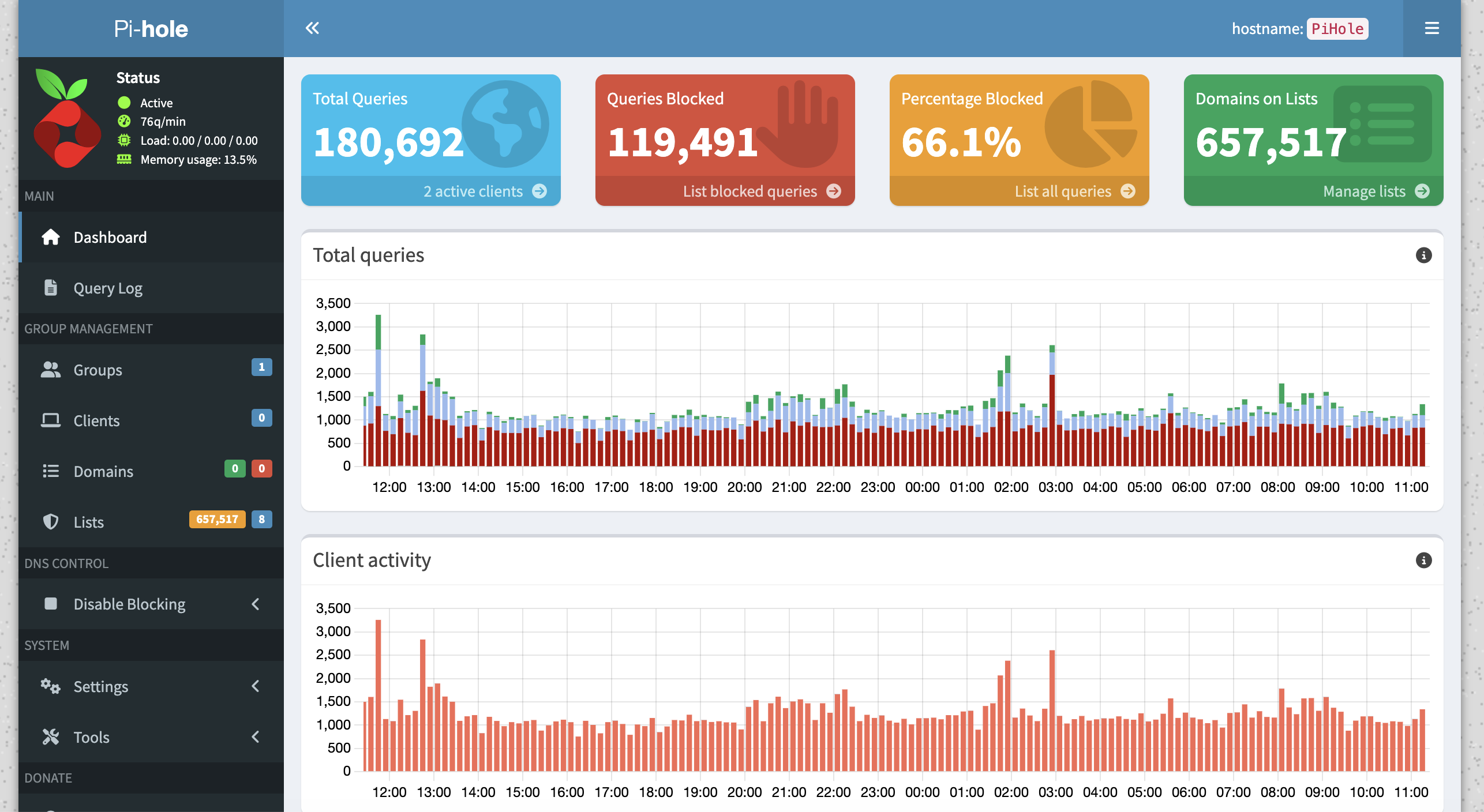

    Just take a look at this photograph
    Okay, no really... Here are the stats:
    What does this mean you ask?
    My network is trying to ping someone else's server all night long to the point even Lionel Richie would be jealous. Most of the network traffic is from Netflix oddly enough so I looked into it. Apparently Netflix pays smart TV companies for their logs and traffic so they know what you're watching. Sometimes your smart TV's collect more than that!

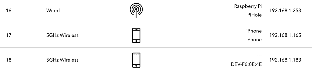

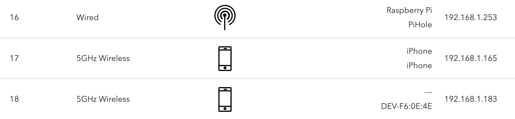

    Log into your Router
    Your router should be 192.168.1.1
    Your username and password will probably be on the router, or it will allow you to set it up. Do that. Log in. You should now be able to see "Connected Devices"
    From here you can SSH into your Raspberry Pi and install Pi-Hole.
    *WARNING* Geeky Stuff Ahead
    SSH (you can download an SSH client such at Putty) or use Terminal if you have a mac - into your Pi using: ssh 192.168.1.253
    which is the ip address we found by looking on our router. Use the password you set up on installation.

    Now I can view my admin screen and dashboard at: 192.168.1.253/admin - and you'll see the screen I posted as the first image. Ok, not that image, the second image.

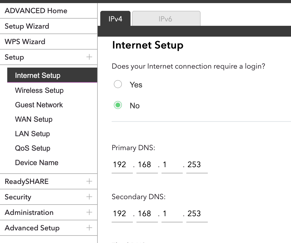

    You now need to point your router to your pihole as a DNS server. Remember how we logged into the router? Now do that and look for the advanced section and DNS.
    Mine is here:
    Change your Primary DNS to your Pi-hole IP Address.
    Change your Secondary DNS to 1.1.1.1 or 8.8.8.8
    Those are legitimate DNS hosts and you'll what it to those as a back up in case your pihole fails. You can see I did not do that, I'm all in as I made a few more modifications after all this that is way beyond the scope of this post.

          Also 66% is INSANE painthappy.

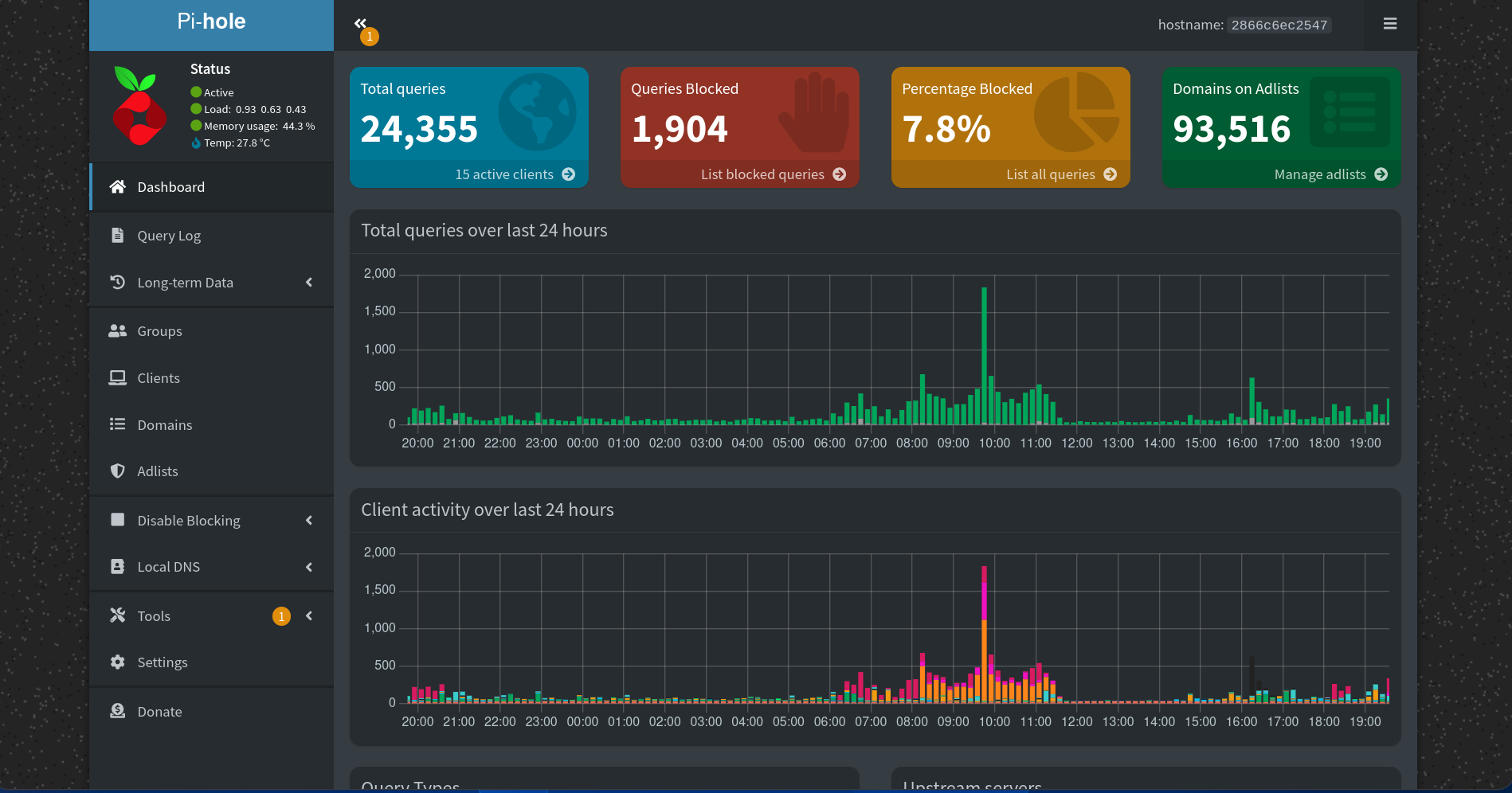

                  Originally posted by RAZRBAKK
                  I support this message.
                  We also have different lists. I have 650,000+ on my block list and you have under 100k. I posted my lists that I use in the first post if you want to have a look at them.
                        I actually updated mine shortly after because I realized I was running an older config. Added a couple of yours to see how they do.
