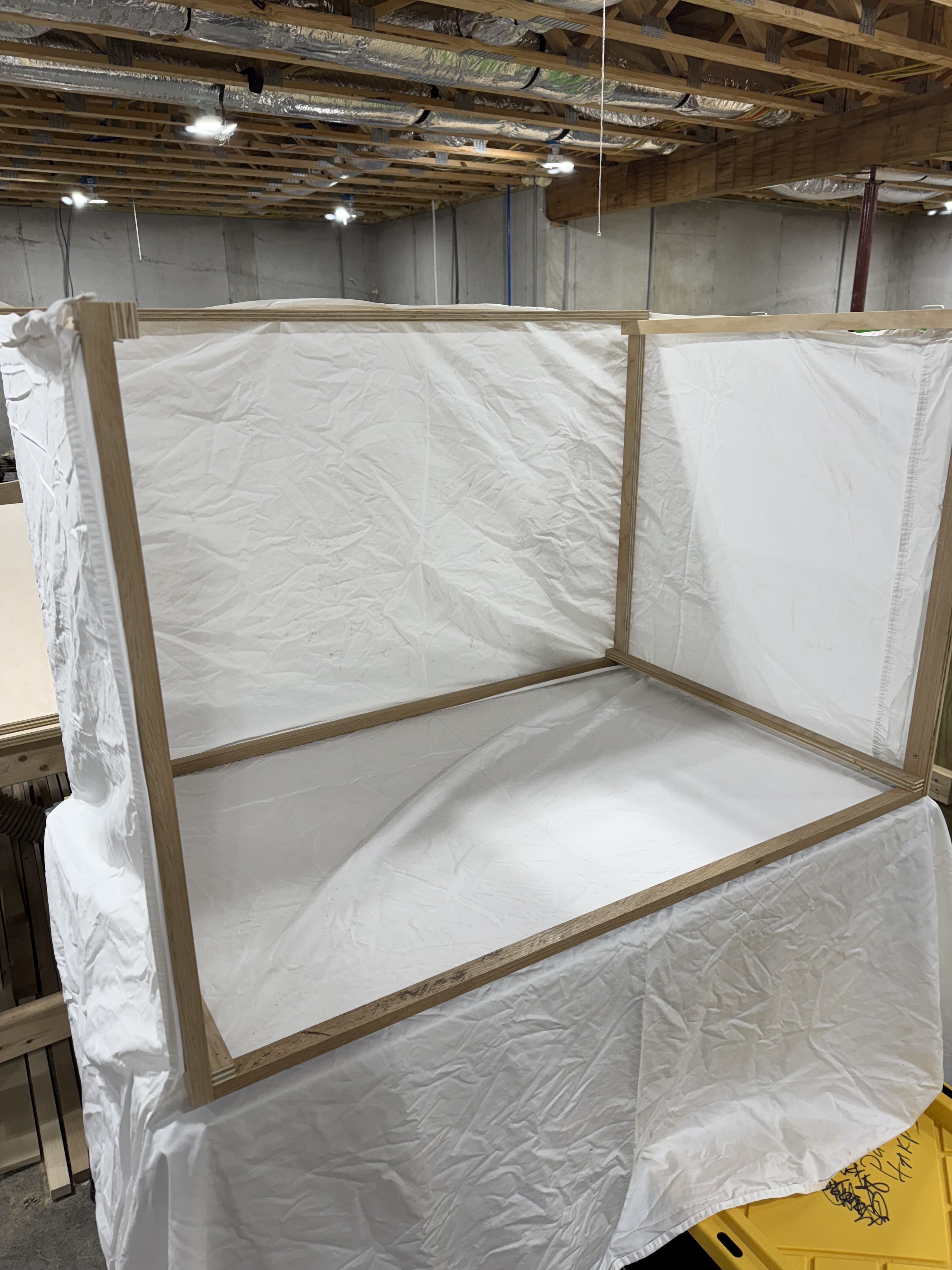

    Figured I’d share my experience painting my first body, I am NOT an artist at all.

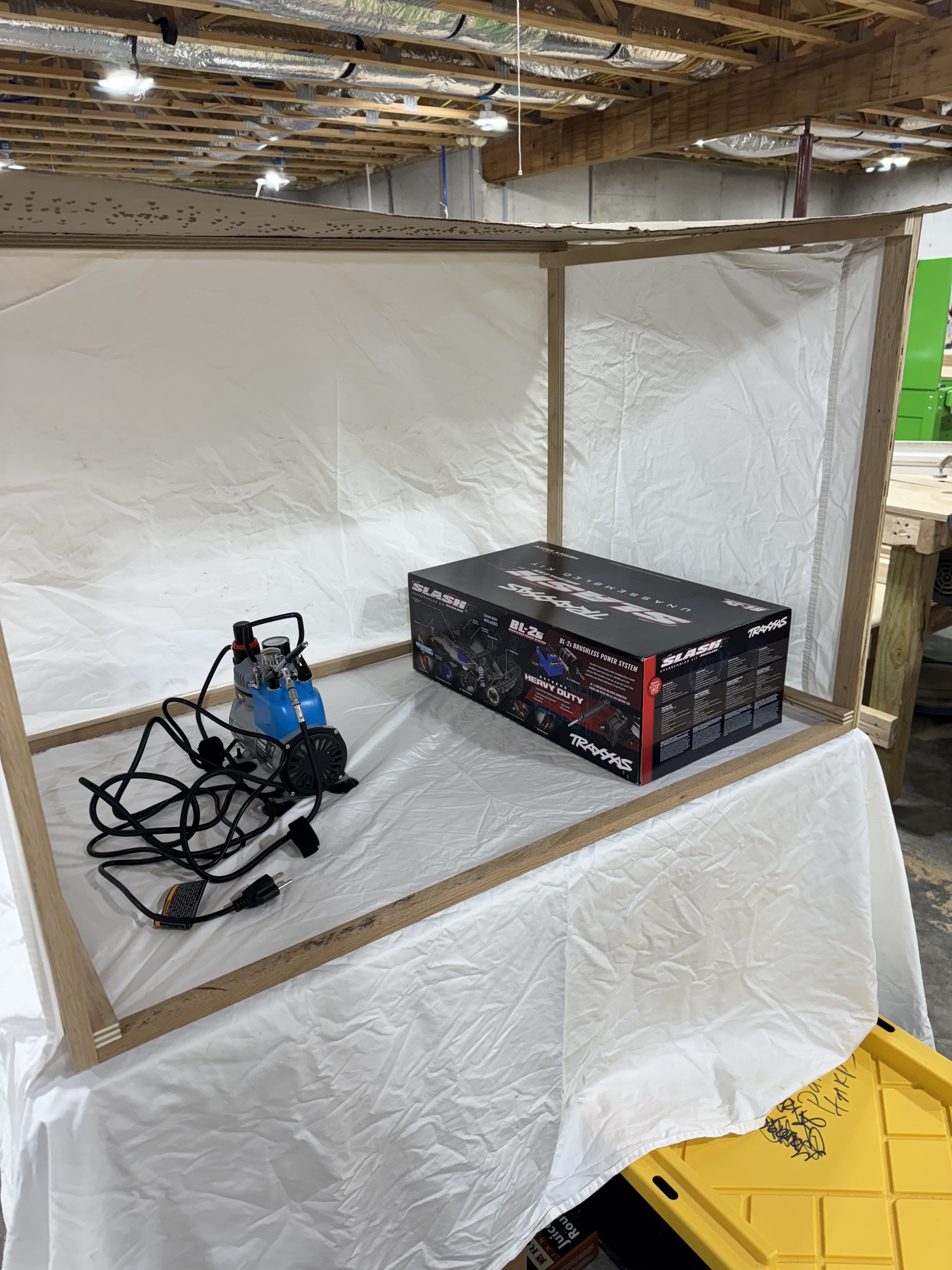

    Today I finally had some time to make a quick little paint booth. Will be using a harbor freight airbrush. I have a bunch of very nice createx colors.
    The actual painting will start tomorrow, I’ll be sure to post updates!

    I just broke out my mini compressor to start speed painting some tabletop minis. I love that spray booth, it’s my next step in my setup as well. Excited to see how things go!

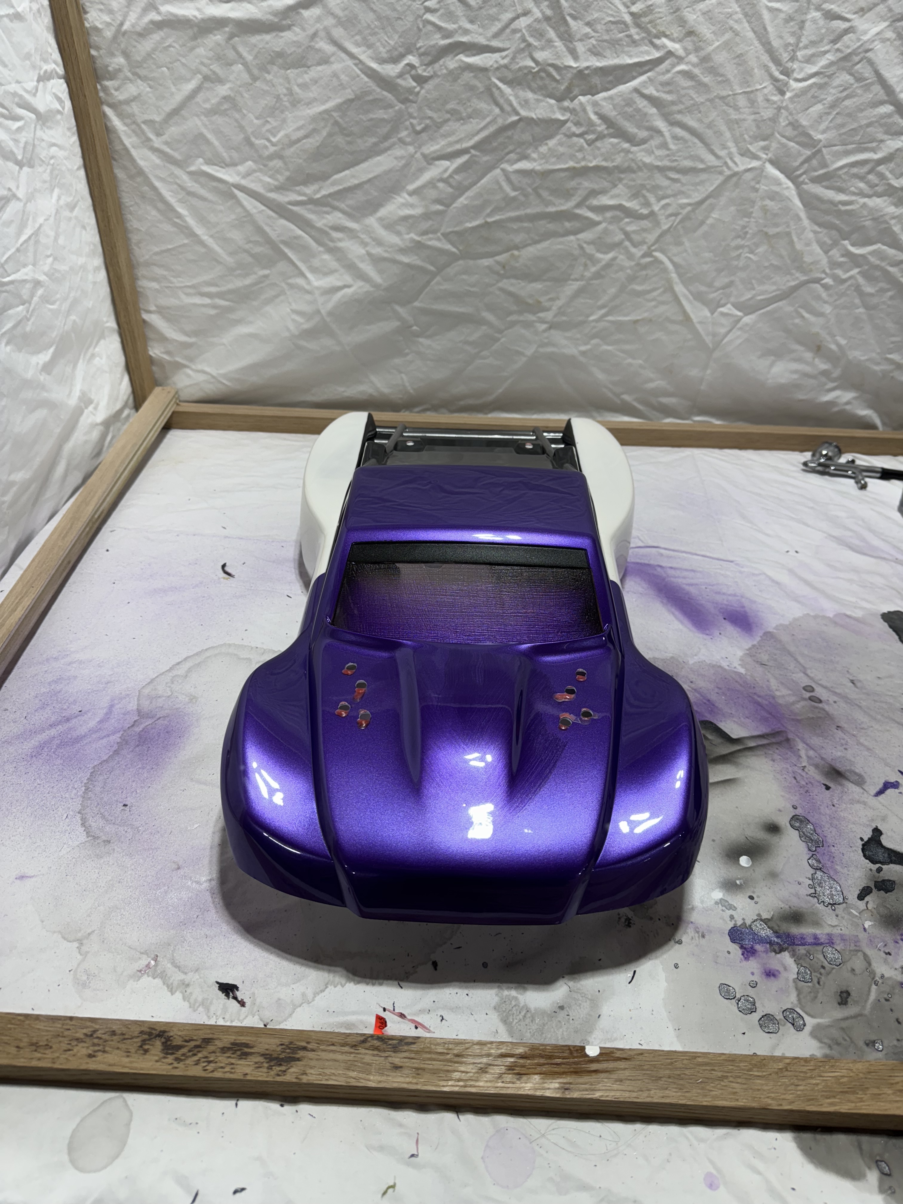

        Going a little slow since I have a bunch of stuff going on. Finally got the liquid masking all done. Tomorrow I will attempt to cut out my first section and lay some paint. I’ll take a pic once I get started!

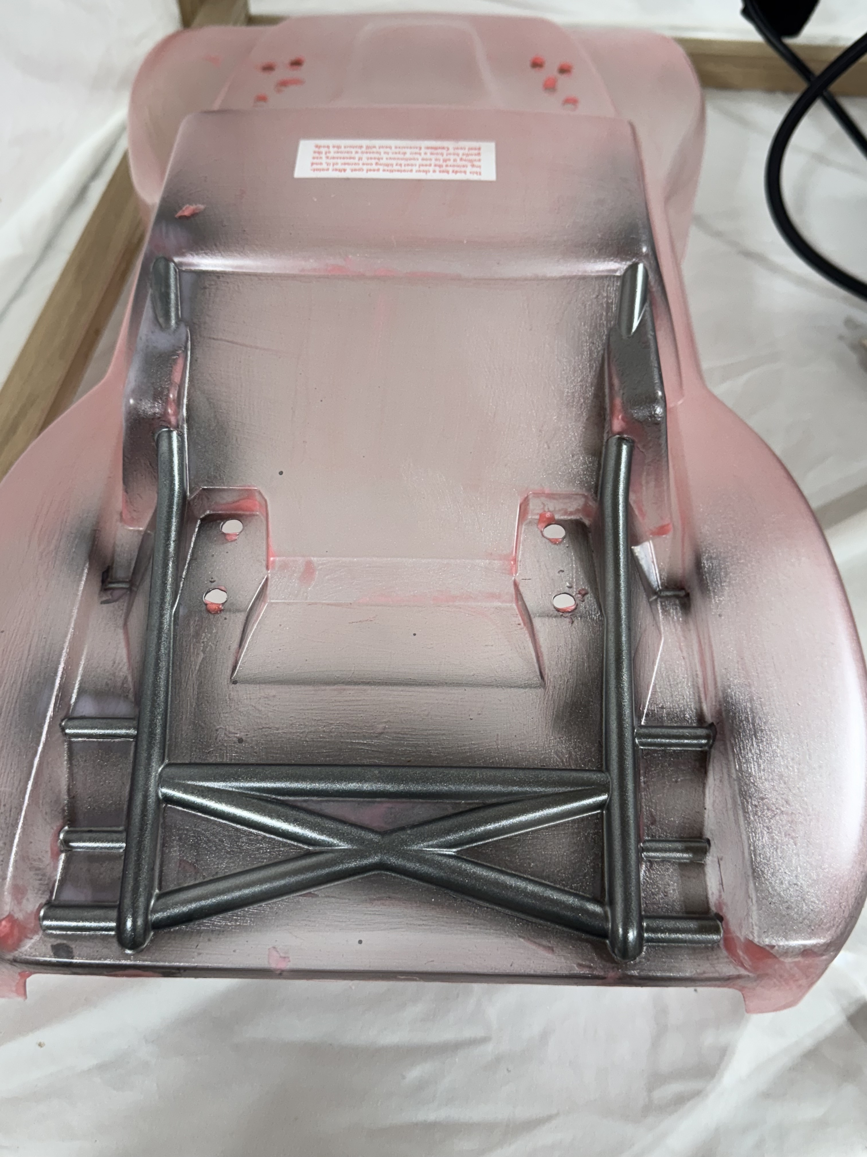

          Got the rails painted, need another coat tomorrow

            I have to confess I don’t quite get what I see here. This is a clear body, right? So you should be back painting it, right?
            It looks like you painted the outside, which normally has a protective film on it. Did you paint the protective film? It looks like the sticker explaining this is still in place.
            Maybe I’m confused. I’ve never built anything from Traxxis.
            EDIT: I see what looks like the mentioned liquid mask coming up through the holes so I guess you’re on the right track. I was confused. I’m not used to seeing overspray on clear bodies except from underneath. I just use tape.

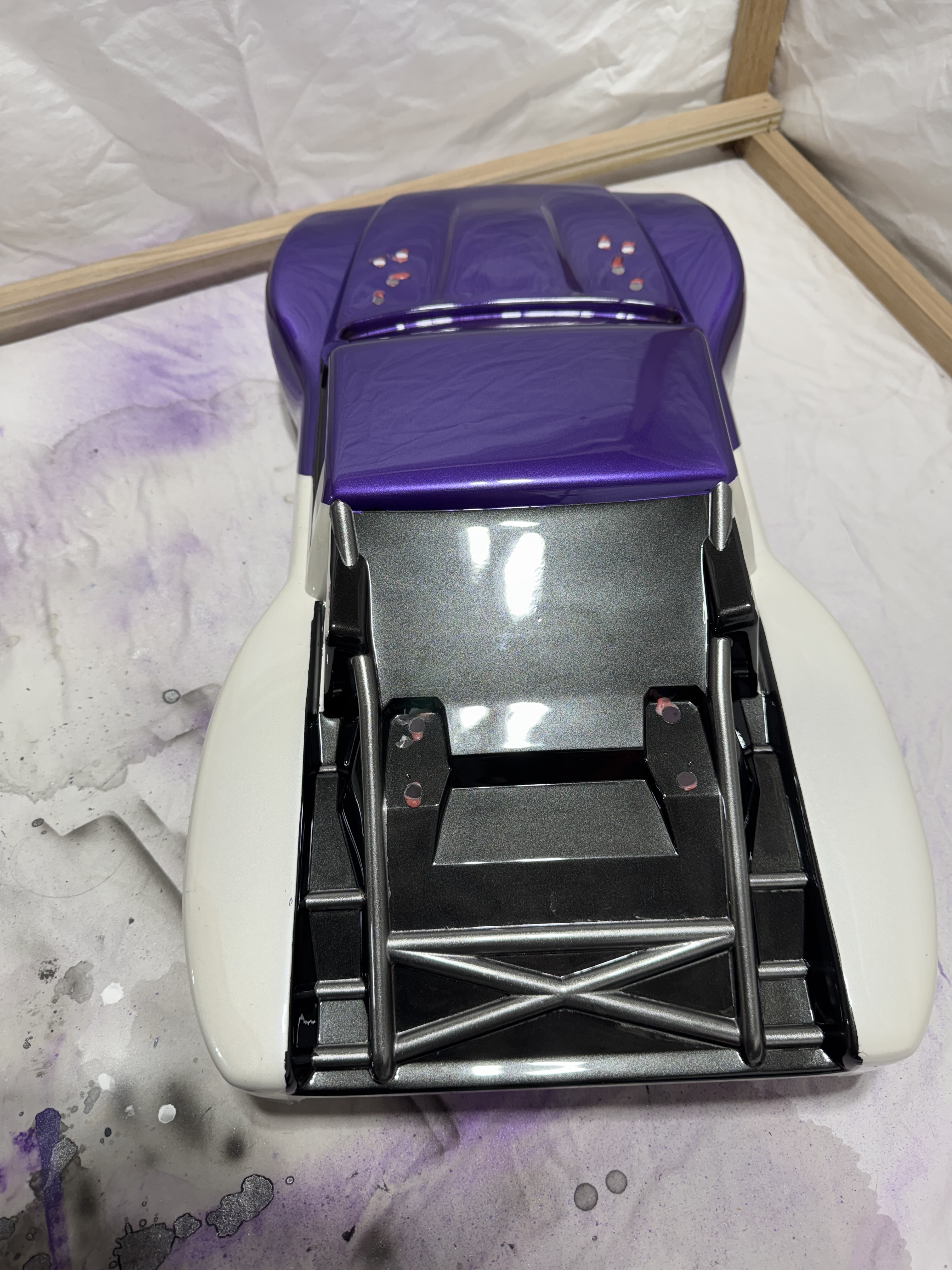

                  Not sure why yall assumed it was painted on top when it’s a clear body lol
                    I was confused because I’m looking at overspray from the outside which is only ever the case when one uses clear liquid masking which I never have for an RC body. It looks *exactly* like it was sprayed from the top. Normally I’d see tape through the clear instead of overspray.
                      • 6182
                      Yeah I agree. The pink hue of the body makes it look like it is being painted on the outside

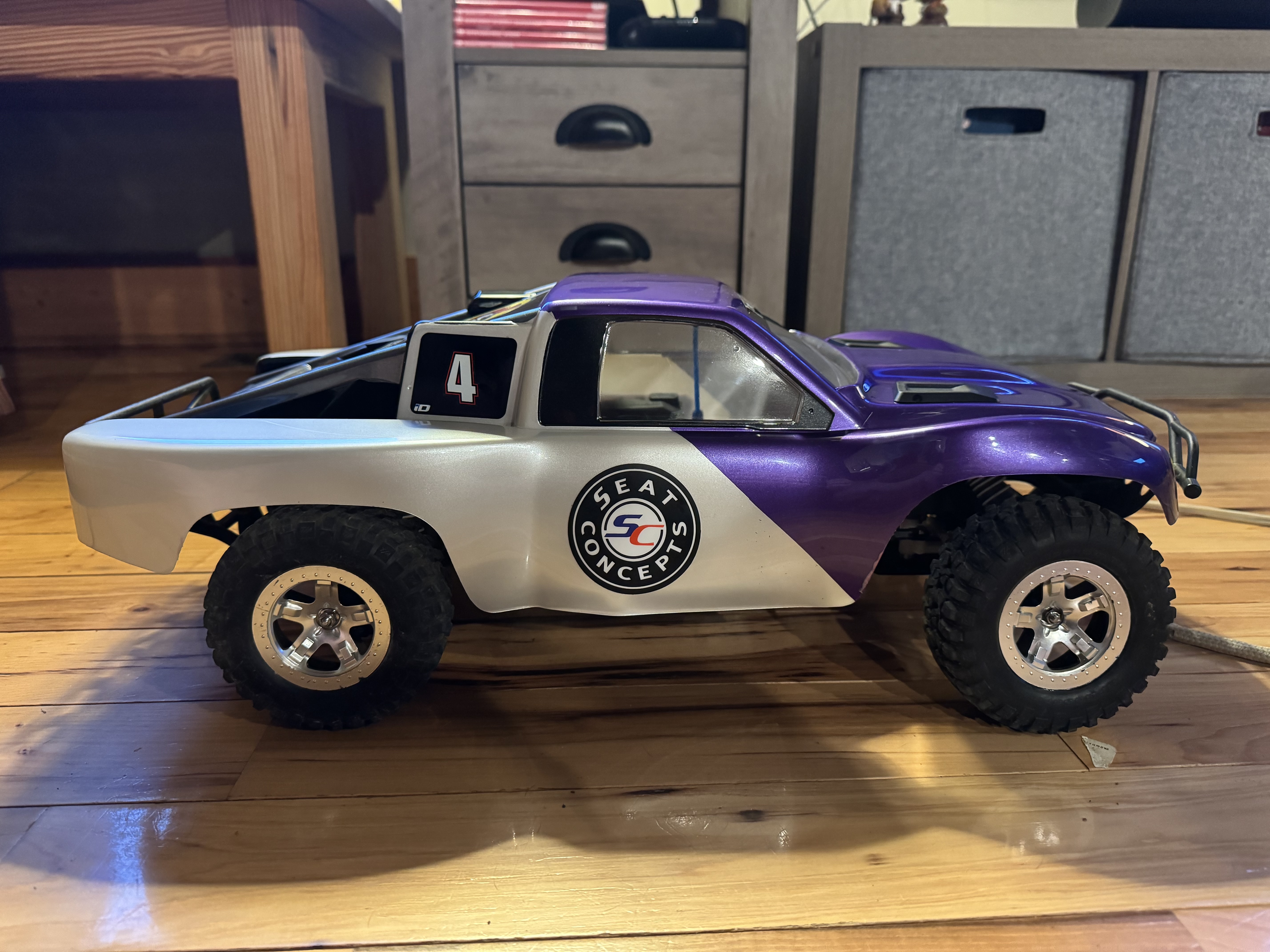

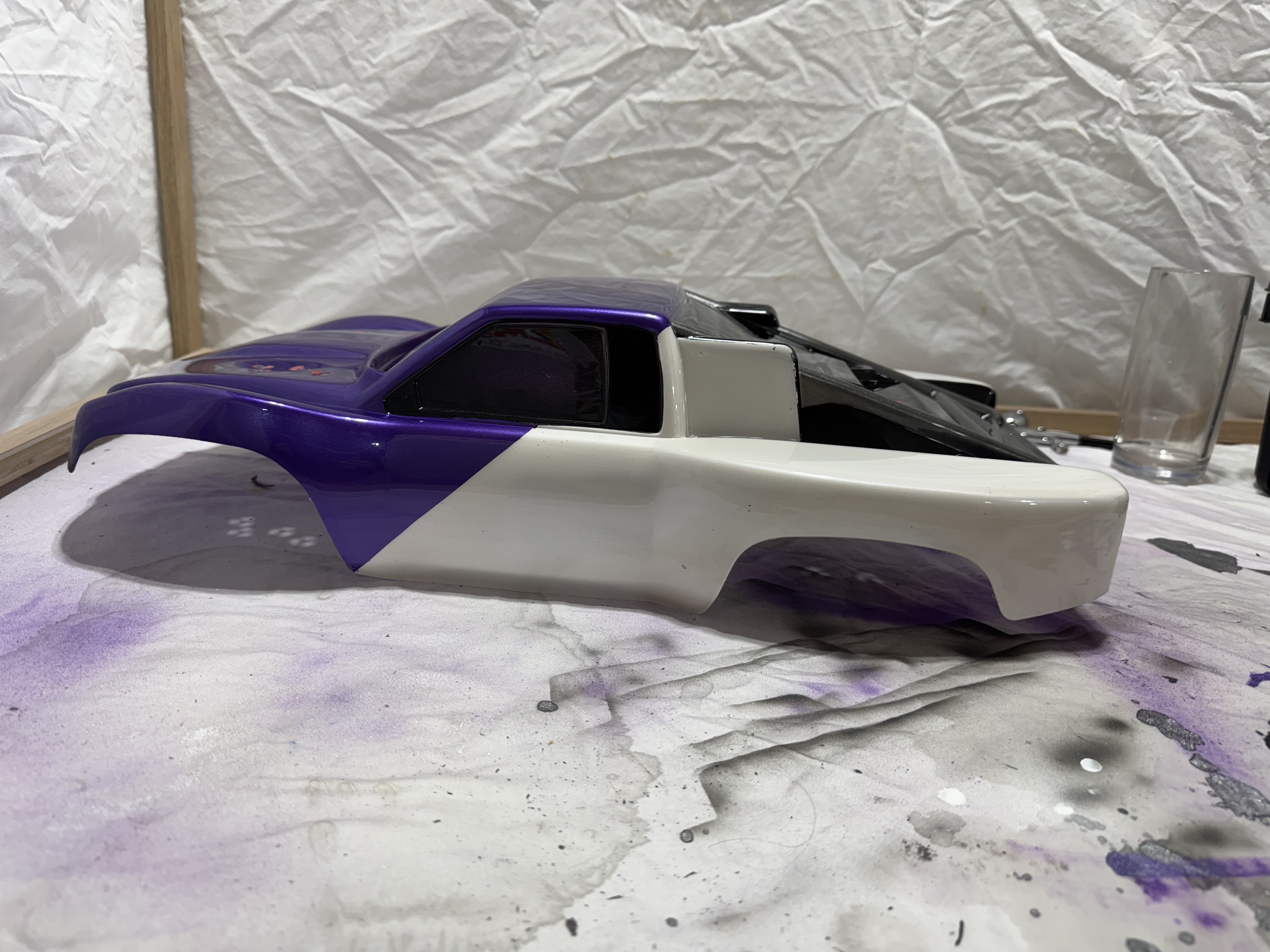

                        Finally done. Some flaws im not quite happy with of course, but considering it was my first airbrush and really my first art project im happy with how it came out. Time to fuck it up racing!

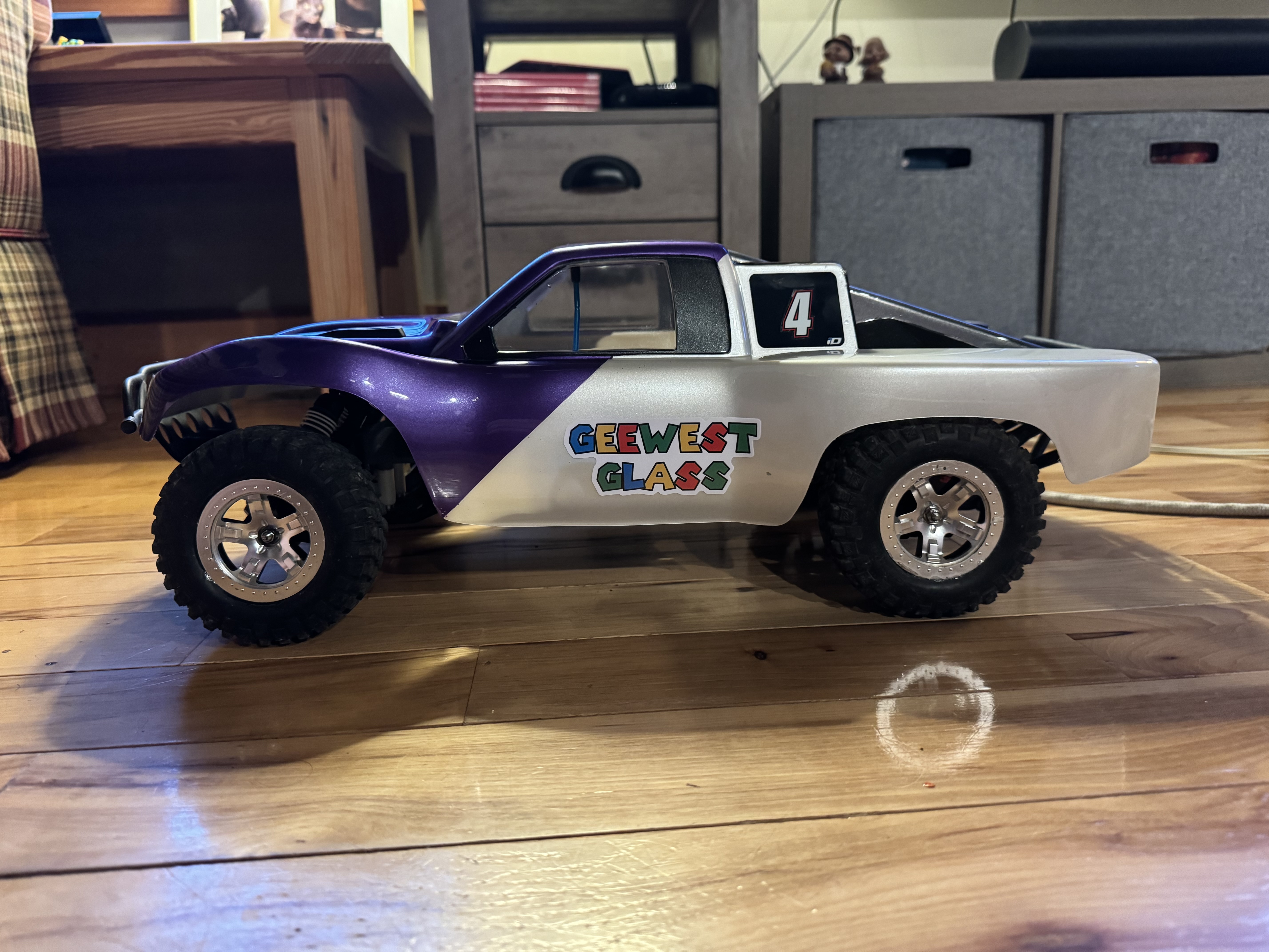

                          Look great, now it's time for some decals and numbers 😀

                        Ready to go tomorrow. Heading to a track for the first time to just practice. Let’s go!
                        • Cal440
                          • Nov 2022
                          • 274
                          • Michigan
                          Looks like you're ready to go. Don't forget the at track pictures
